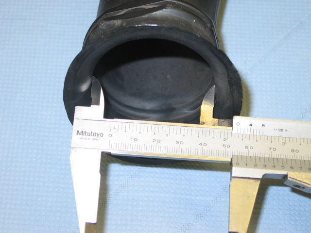

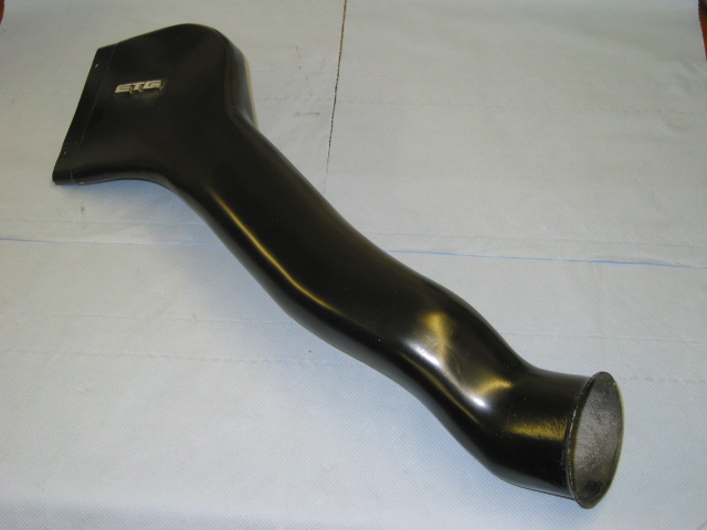

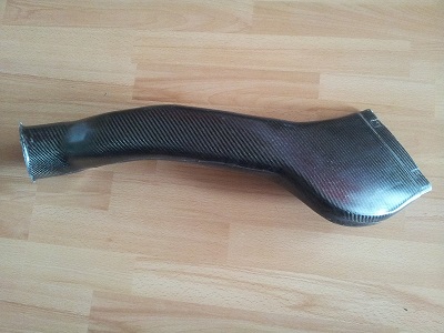

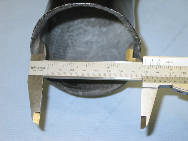

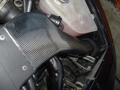

Here’s some more snorkel information from them:
It’s a carbon fiber snorkel for $450.
