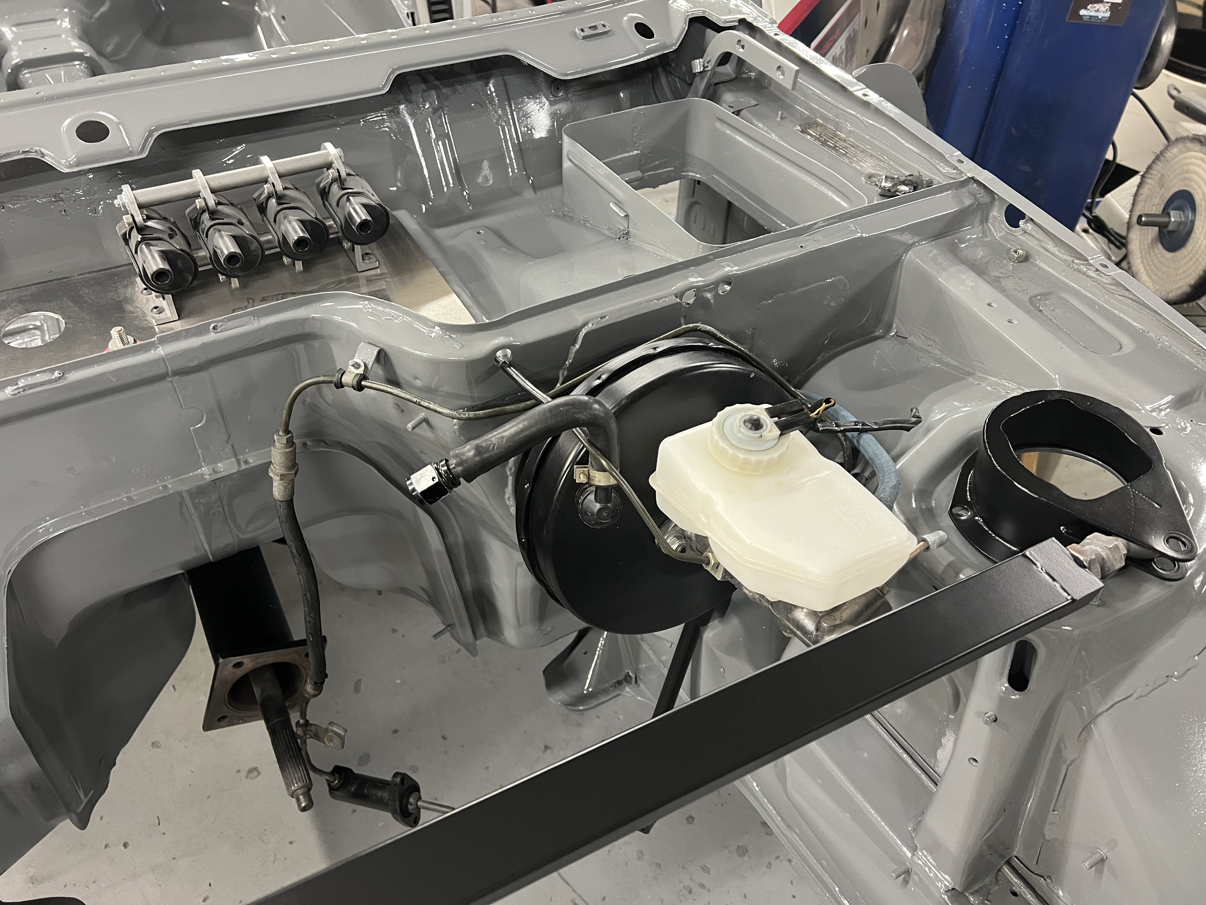

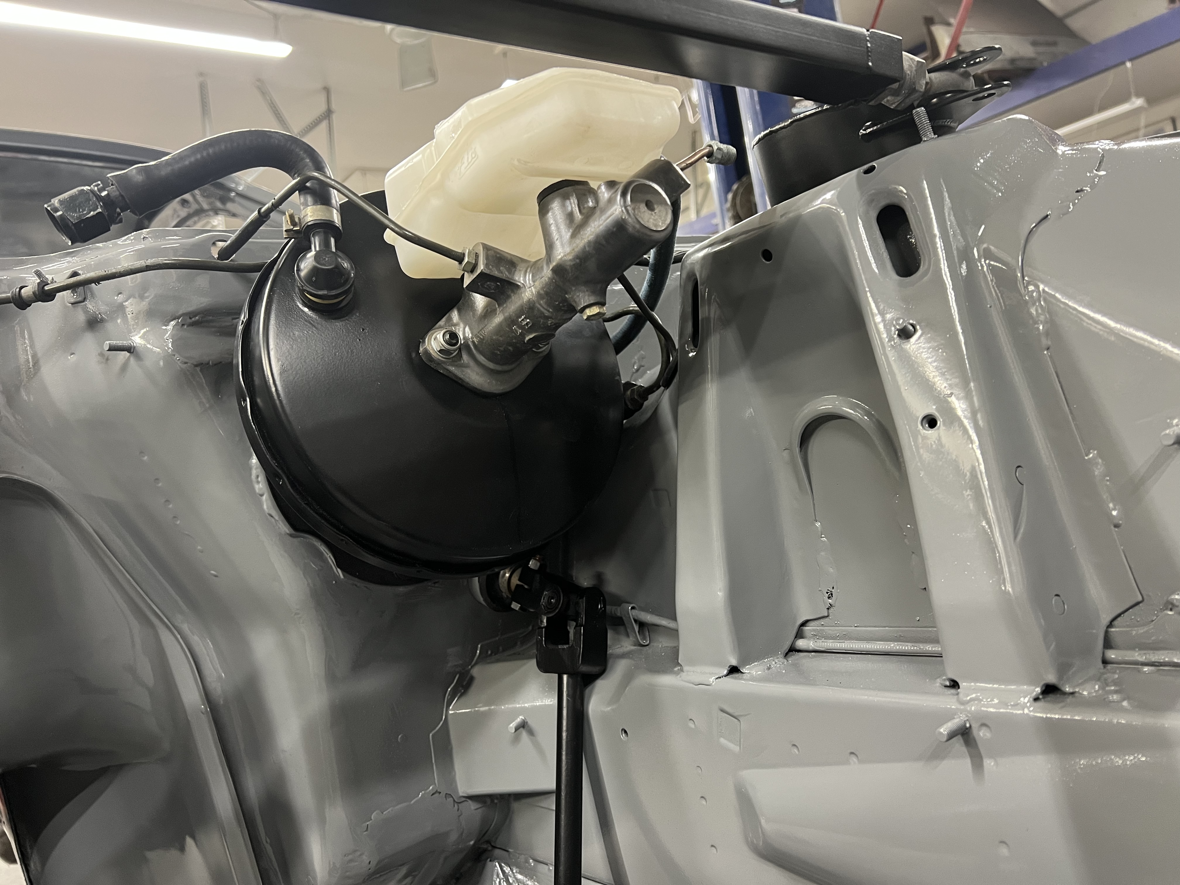

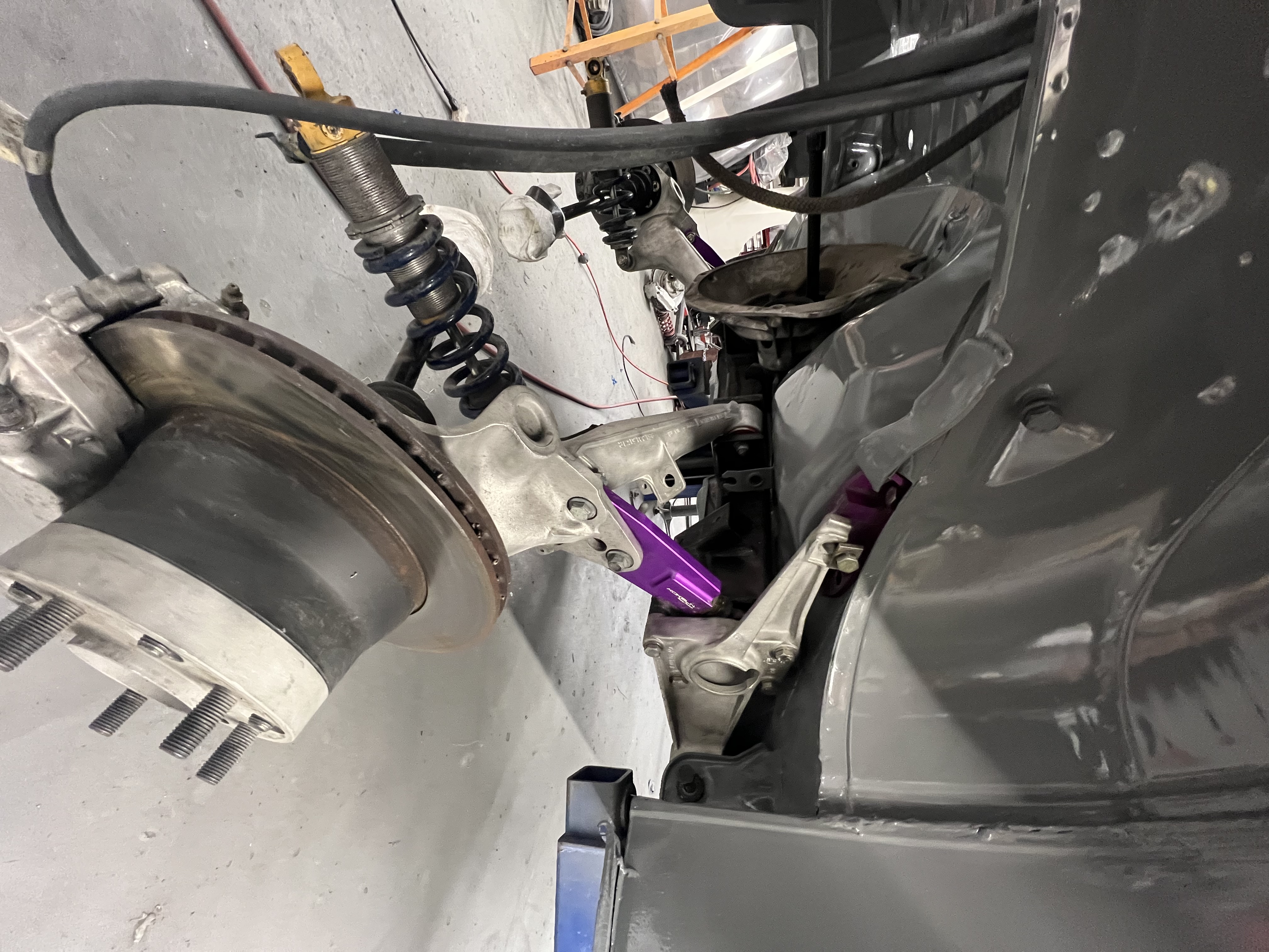

Starting to put some clothes on the naked body!

Looking good! I guess you don't need the central fuse box -- just stand-alone harness and hand-wired bare essentials?

Yes, all stick wiring is gone. Stand alone and AIM race dashboard. Rewire the brake lights and fuel tank level, everything else is run by the Link engine management system.Tom wrote: Sun Jan 08, 2023 7:24 pm Looking good! I guess you don't need the central fuse box -- just stand-alone harness and hand-wired bare essentials?

and its away from the heat! also blocks off the cabin when the HVAC stuff used to be. The round hole is for a 47 pin harness connector.
