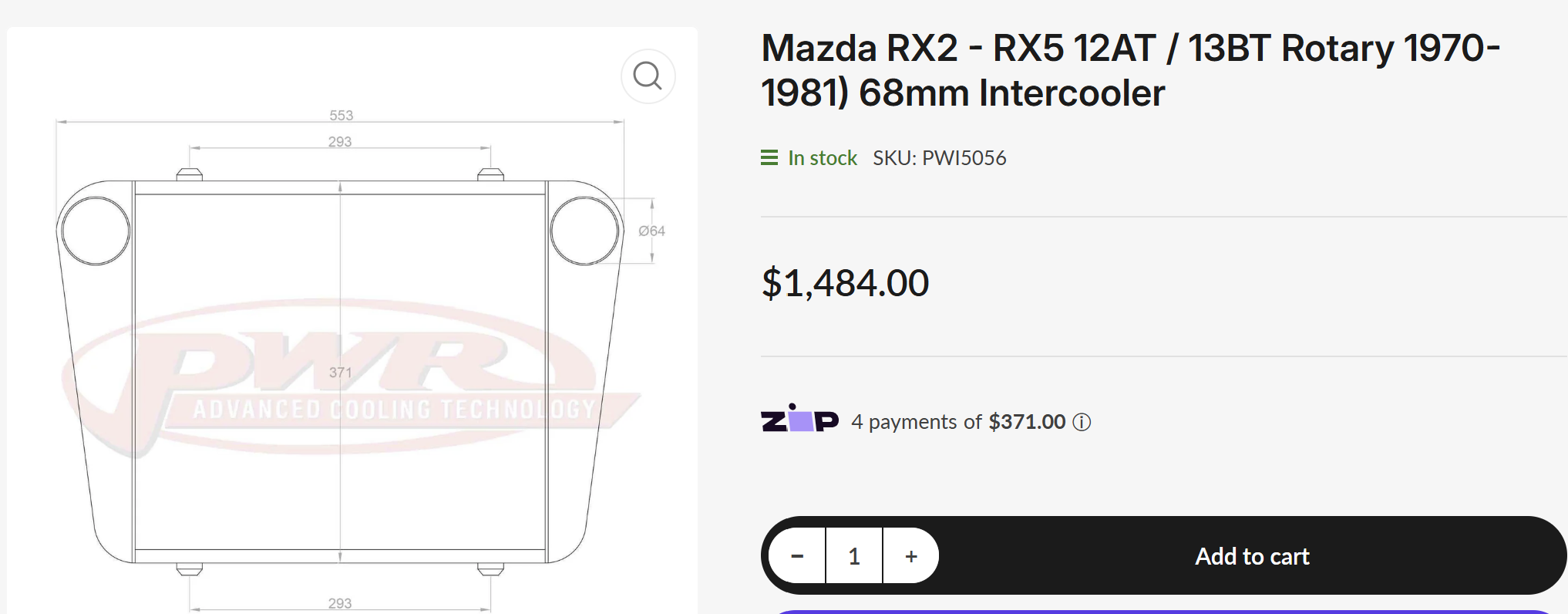

Out of curiosity Thom, is this the intercooler you've based yours off?

@Bergerac, no my intercooler is a 100% custom unit based on a drawing supplied to the fabricator. They said it will support around 600hp due to the relatively thin core, needed to minimise cutting into the front cross brace. I'm curious if the limited flow resulting from a supposed 600hp ceiling might be a contributing factor to the high-ish IAT observed in the log file previously posted. If any of the observations made in post #97 are remotely correct then perhaps the larger turbo is just working in its optimum output range with boost pressures starting at 26psi.

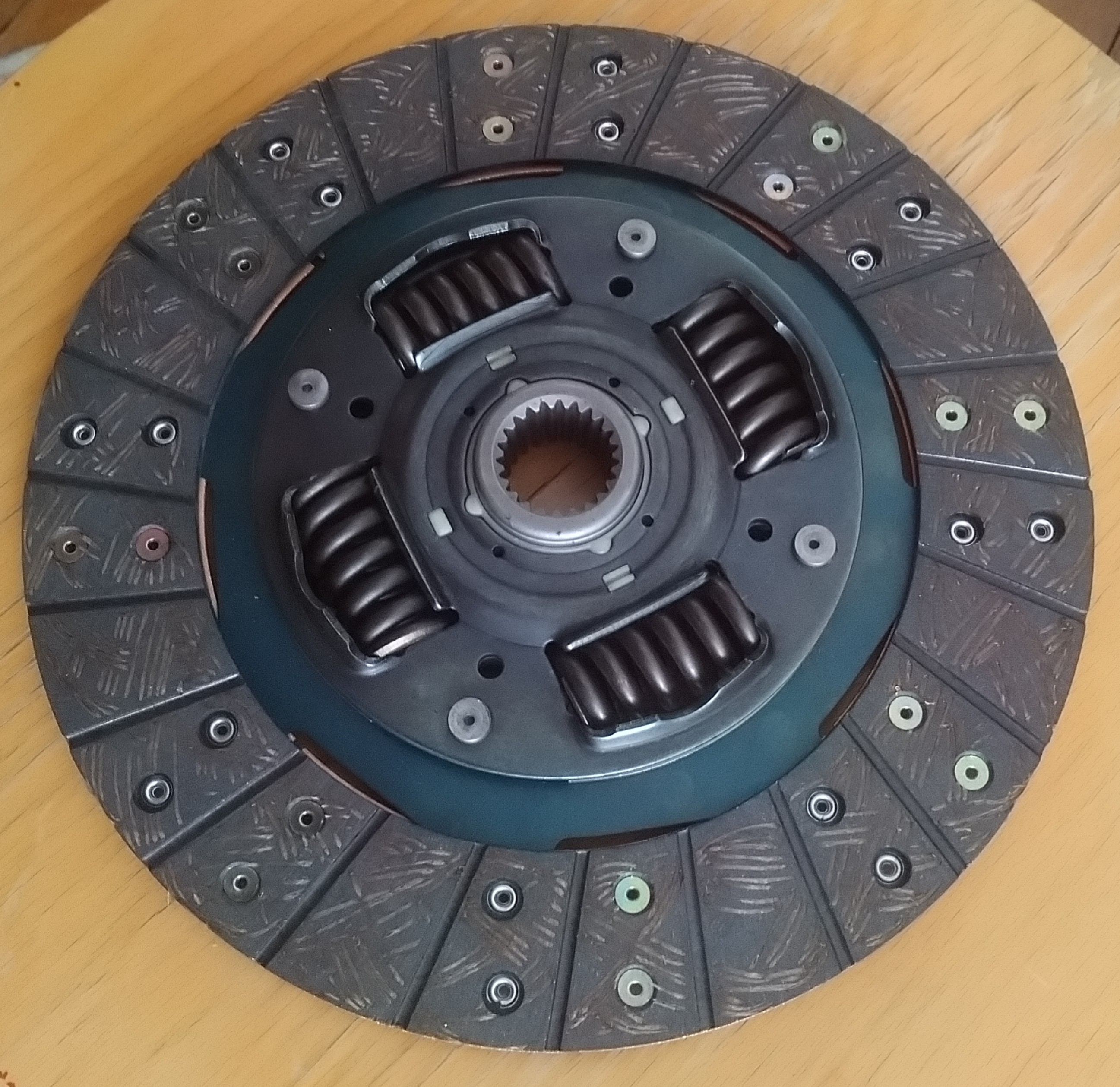

A new clutch disc from South Bend is on the way.

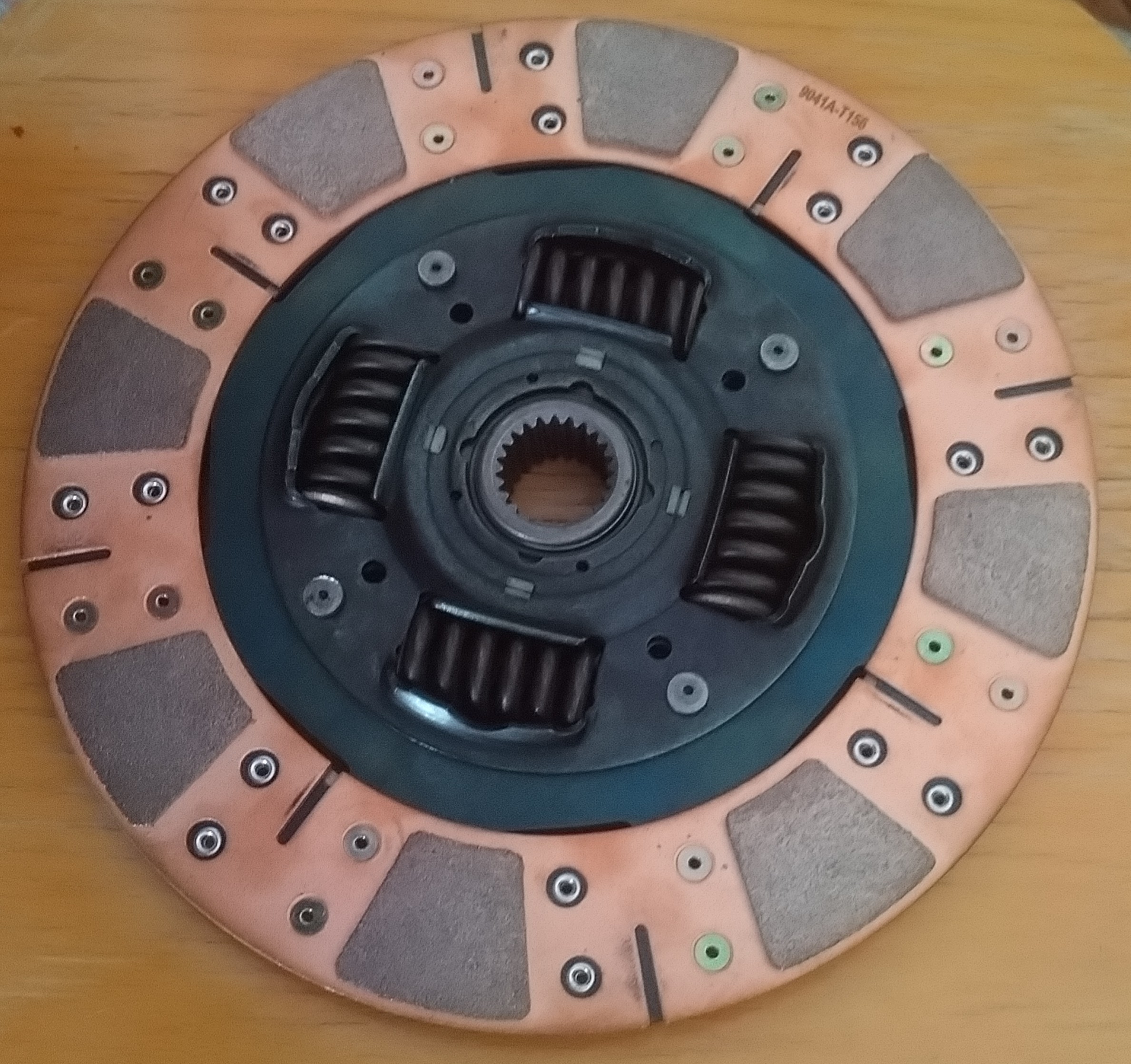

The new clutch disc from South Bend is here. It is a dual friction unit with organic on the PP side and ceramic on the flywheel side. Now to find the motivation to tackle the job... :?

That looks more aggressive than the one I used. Is the 'puck' side 'feramic' (sintered iron) or actually ceramic? I don't actually see that disc matching any of their advertised stages -- is it a one-off?

I suppose it is a one-off. The puck side is ceramic, not feramic. They never mentioned feramic during our communication, probably due to the torque rating I required.
