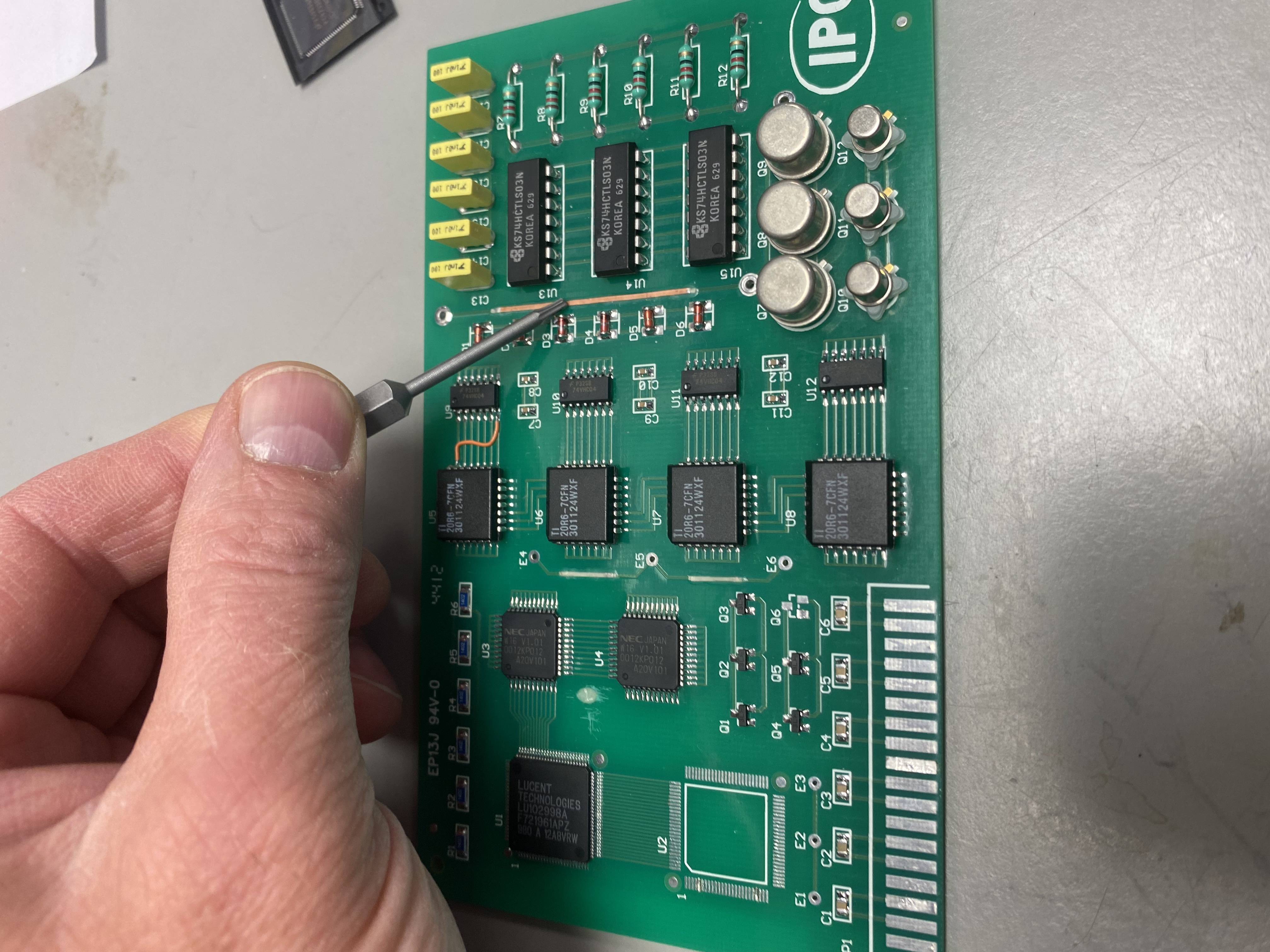

We have solder trace repair materials for board repairs.
Clean up the old stuff
Flow some solder along with the trace wire product then conformal coat
The trace I am pointing at with the bit is an example of a test training board.
That piece was flowed with solder and copper trace added.
