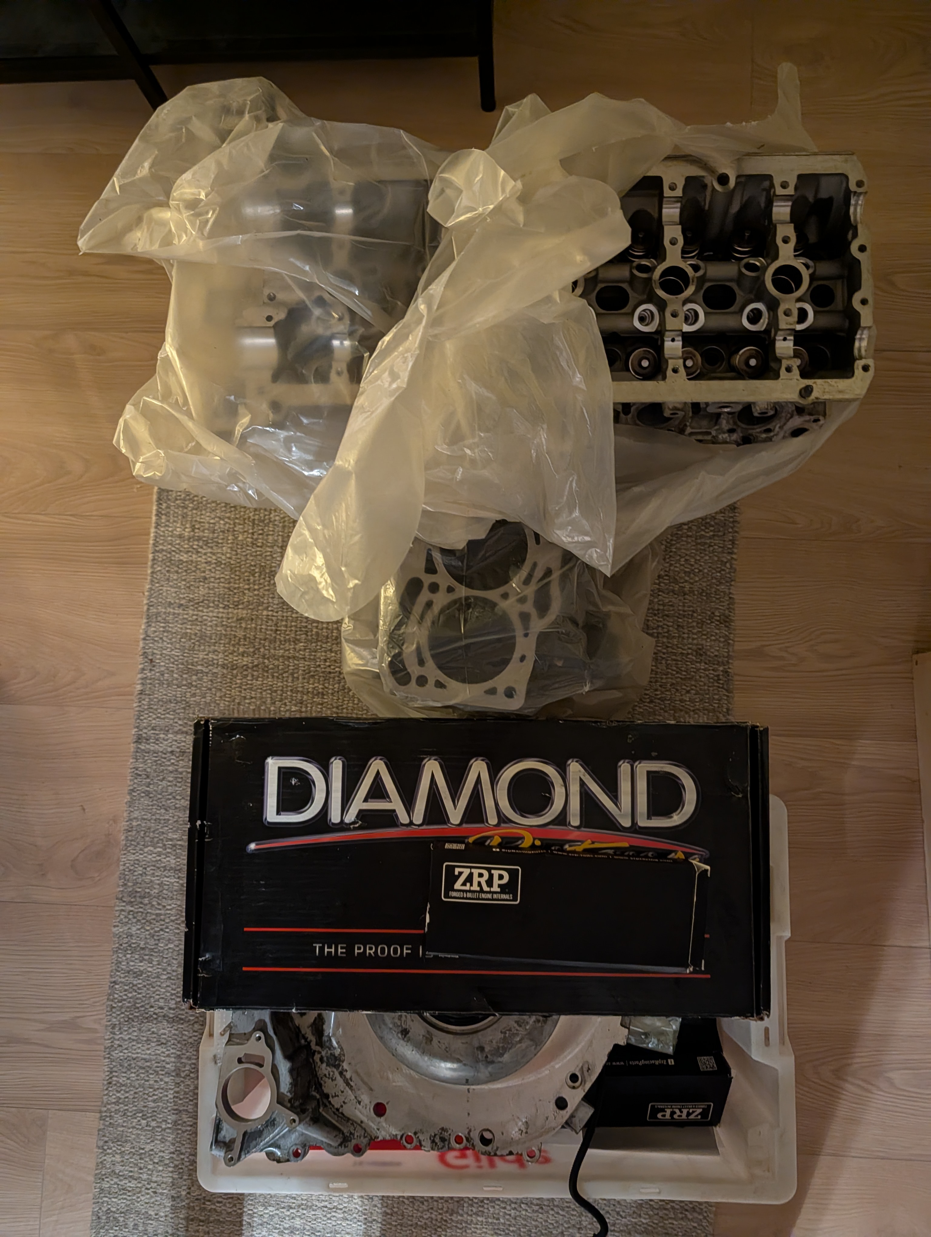

Engine parts has arrived from machining.
Assembly in 2026
