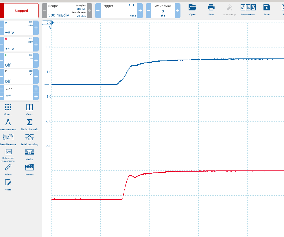

This is interesting. I've often wondered how these conversions handle acceleration enrichment. The stock system relies on the overshoot of the AFM, which is definitely different with a MAF. To some degree, the overshoot is caused by the extra air that has to fill the manifold (which should happen with both) but it seems that the mechanical vane of the AFM overshoots more than that:
This is a trace I captured when doing some testing with a MAF and the stock AFM, pulling air through both at the same time with a shop vac - blue is the MAF, red is the stock AFM:
In the stock chip there's some extra enrichment based on how quickly the output signal ramps up, but for US cars that it only during warm-up. On RoW cars, this extra enrichment remains at full temp. Also, from the trace above we can see that the MAF ramps up more slowly with sudden air increases, aside from the smaller overshoot. So even this extra software enrichment will probably be less than with the AFM.
My explanation of how this works is here[1] - the first half is pretty easy to read I think, before it gets into the technical details.
Anyway, this kind of thing is exactly what would push me towards a true MAF conversion (including new software) like Vitesse if I was looking for an upgrade. I don't think the transient behaviors of a MAF are ever going to match the AFM, and that is bound to affect driveability imo. The stock chip also does some transient fuel adjustments, for instance it slightly reduces fuel during tip in after a gear change, presumably because the AFM overshoot is too much.
One thing you might try if you're up for a little effort is switching over to the RoW maps. To do this you need to unplug the altitude switch and connect a 1.8k resistor across the plug in place of the switch. Then it would probably make sense to unplug the O2 sensor too. Then you should have more enrichment at tip in. If you still have the cat this might be risky though, I am not sure if it's good for the cat to run without the o2 sensor.
[1] https://jhnbyrn.github.io/951-KLR-PAGES ... rough.html

johnb wrote: Fri Sep 04, 2026 6:42 am This is interesting. I've often wondered how these conversions handle acceleration enrichment. The stock system relies on the overshoot of the AFM, which is definitely different with a MAF. To some degree, the overshoot is caused by the extra air that has to fill the manifold (which should happen with both) but it seems that the mechanical vane of the AFM overshoots more than that:
