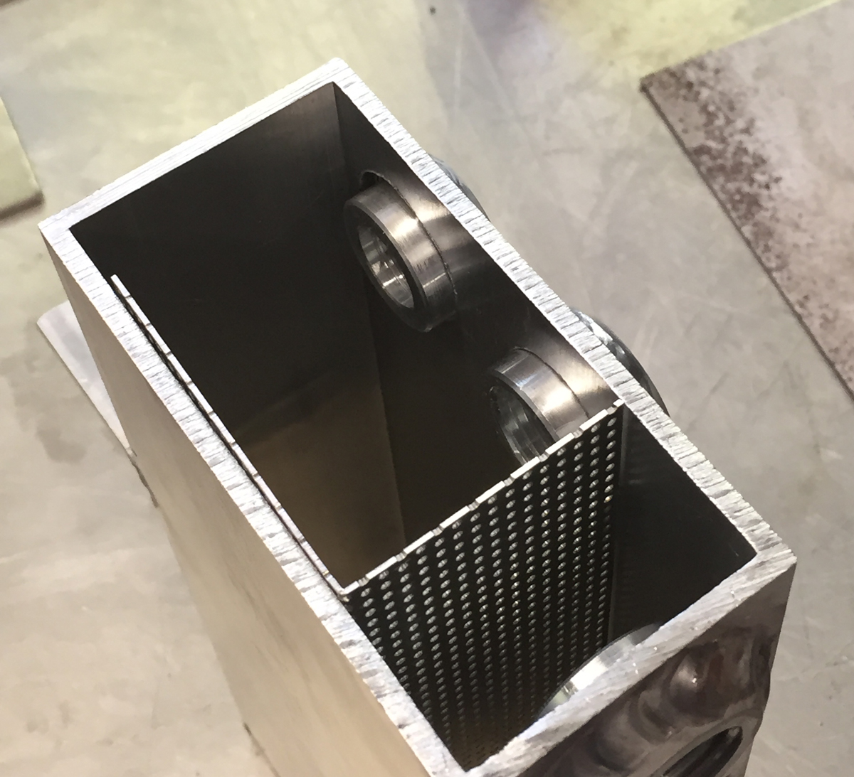

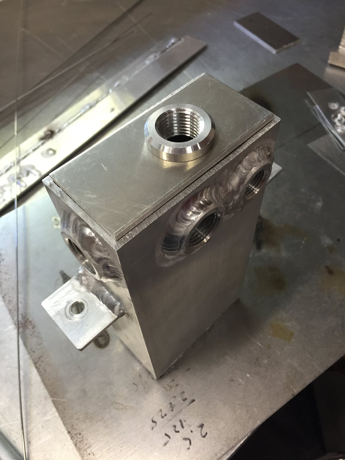

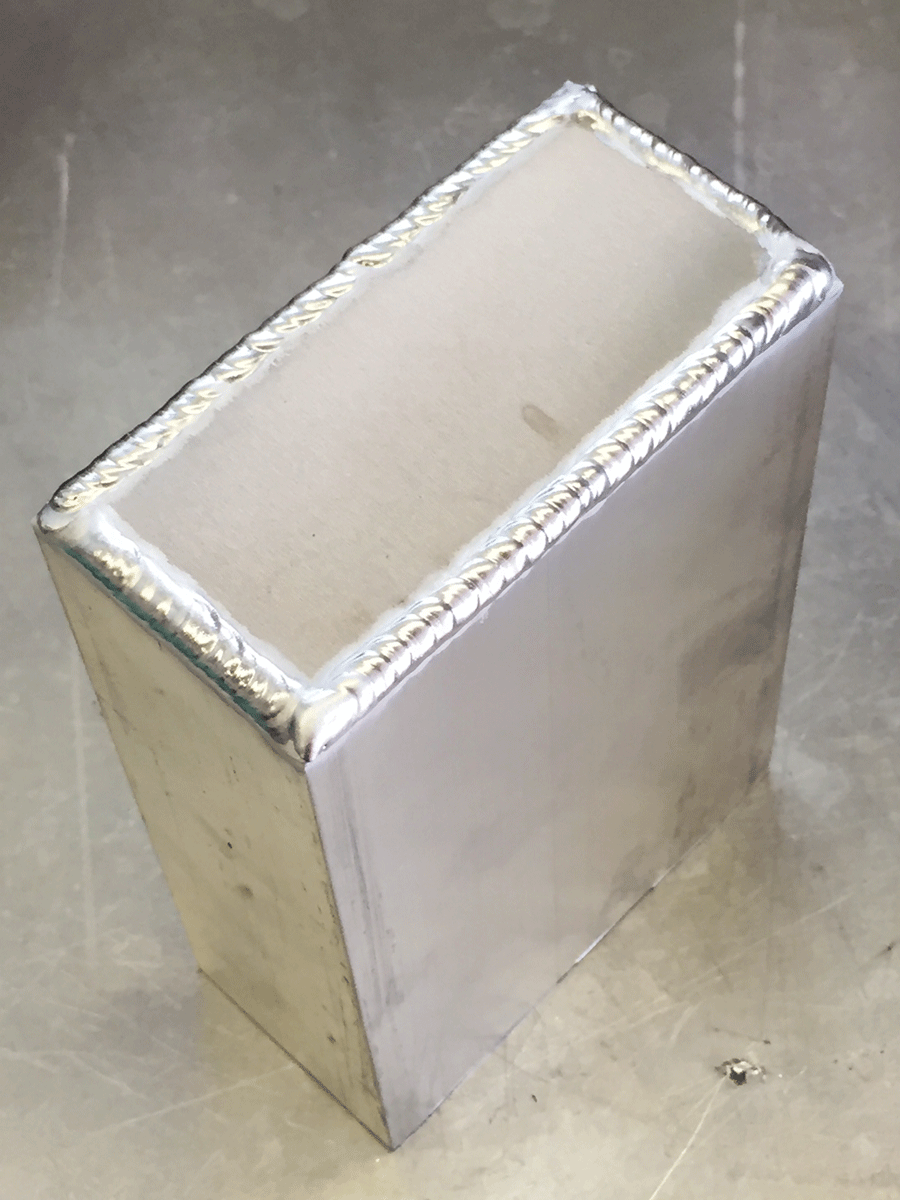

I left the car with at the shop so it could be thawed out and have all the ice build up removed at the ice. Once that was done, they built a catch can to hopefully prevent this from happening in the future. I asked for the can to be left with the raw uncoated finished.
I guess blown intercooler hoses and catch cans are a universal thing for hot rod turbo cars. :) I made my own catch can for all the same reasons... I powder coated mine black, however, so it would 'blend in' and stand out less.

Real nice job.....manufactured well...you got talent !!!!!

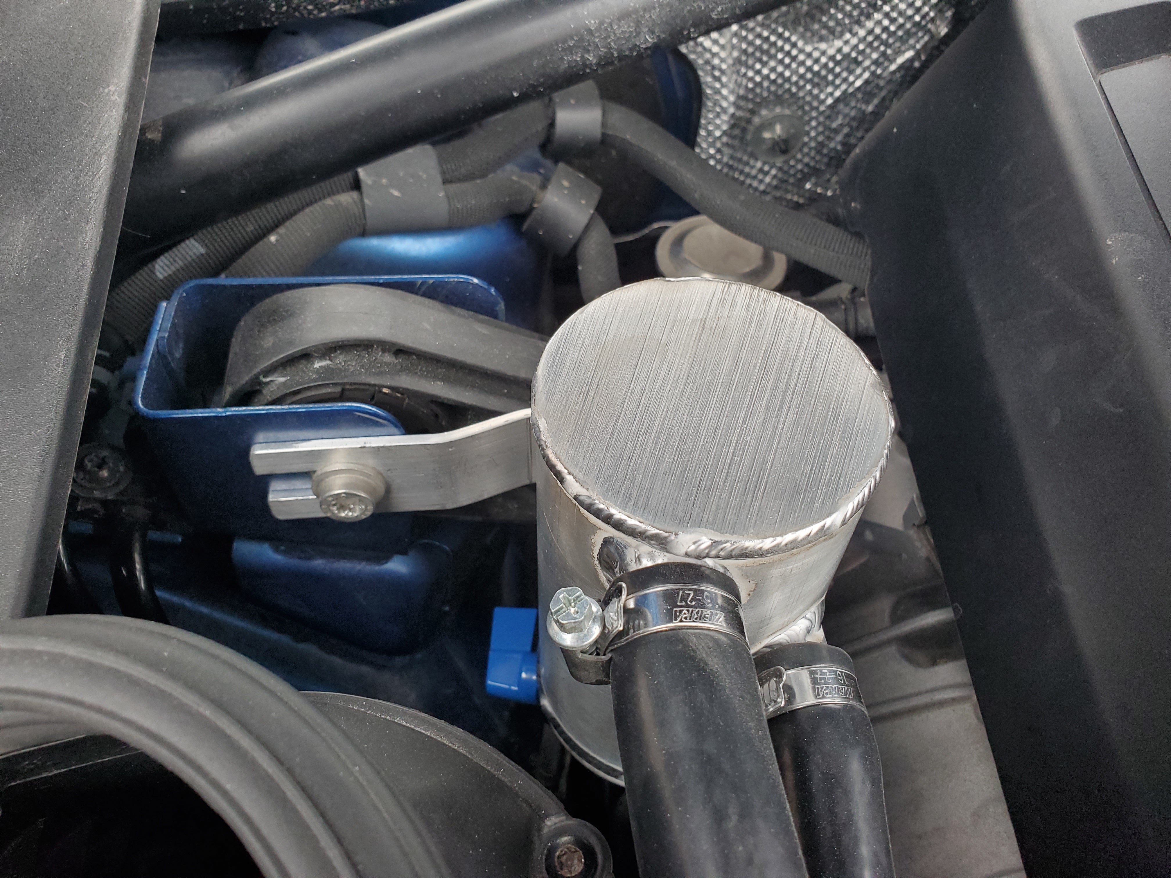

And the IC pipes always blow while merging onto the highway :roll:
Amazing work on the catch Tom. I wish I had the skills & knowledge to make something like that.
The raw uncoated look has grown old. I'll be sending the can in for black PC.
It will look like this to match the engine cover

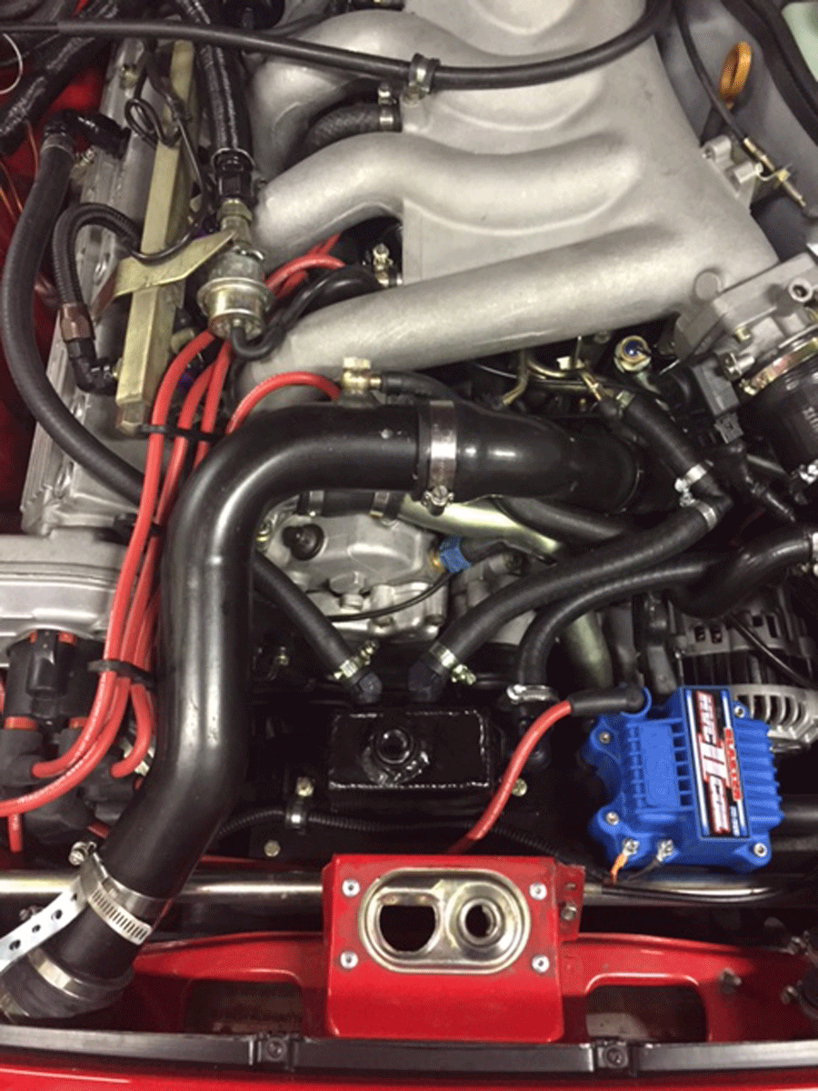

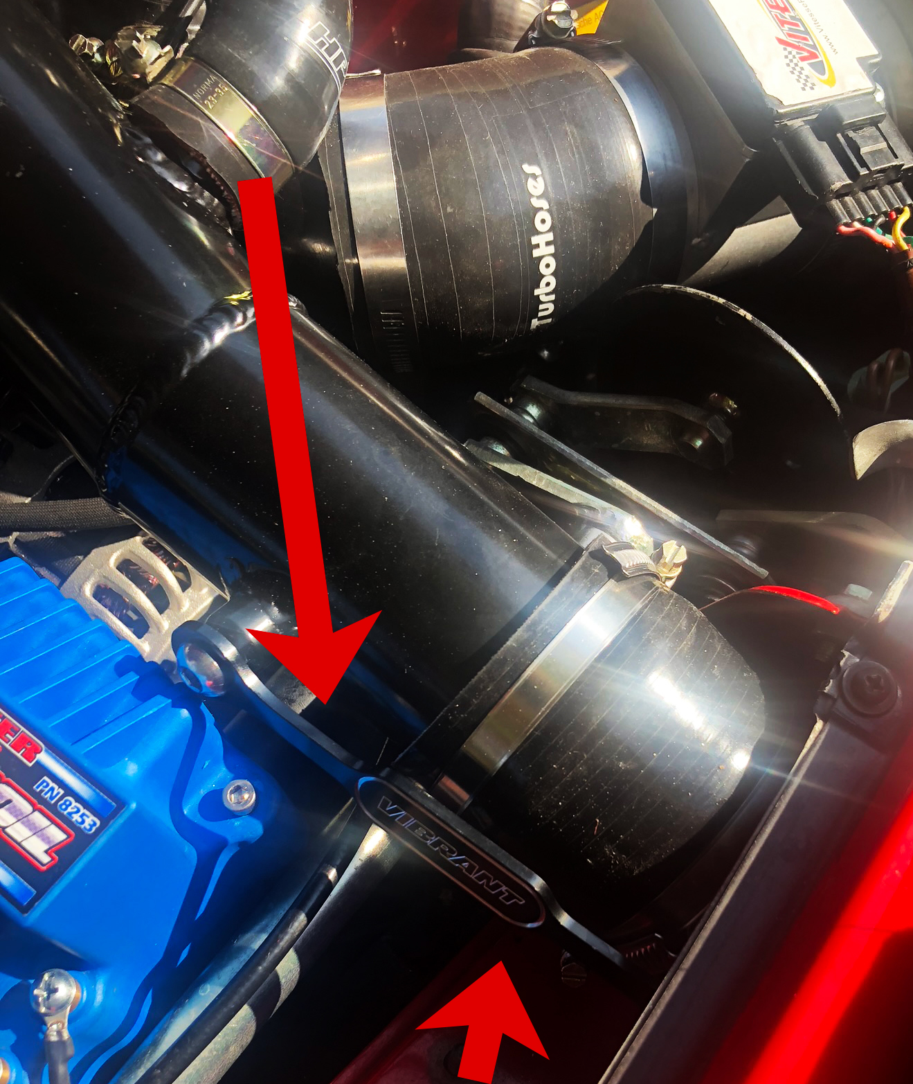

Thanks, I'm a hack compared to a lot of people out there, but have made an effort to learn how to do a lot of this stuff for myself. If you can find an old oven, Powder Coating is remarkably easy and cheap at home. Love the crinkle finish black (or red) and think it will look great under your hood. :)
As for intercooler pipes popping off, I finally had enough and welded 'boost braces' on to keep the pipes from pulling apart. All the fancy clamps in the world are no match for a metal bar holding everything together. Here's a bad picture of the ones I put on my custom pipes...

@Tom
Those boost braces are awesome. They definitely solve any issues with the pipes blowing off.

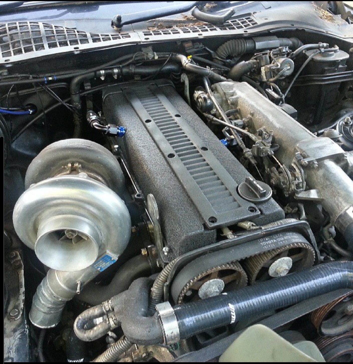

This is a valve cover I did for my Toyota soarer(1JZGTE)
#37
Posts: 8961
Has thanked: 936 times
Been thanked: 4025 times
Looks great! I've never tried VHT powder -- do they make that? I've powder coated lots of things under the hood and never had an issue. I use mostly Eastwood or Prismatic powder. A long time ago, I got a powder coating oven at Harbor Freight, like the one below, and it's been going strong for over a decade. For reasons unknown, it looks like HF no longer sells them. :(

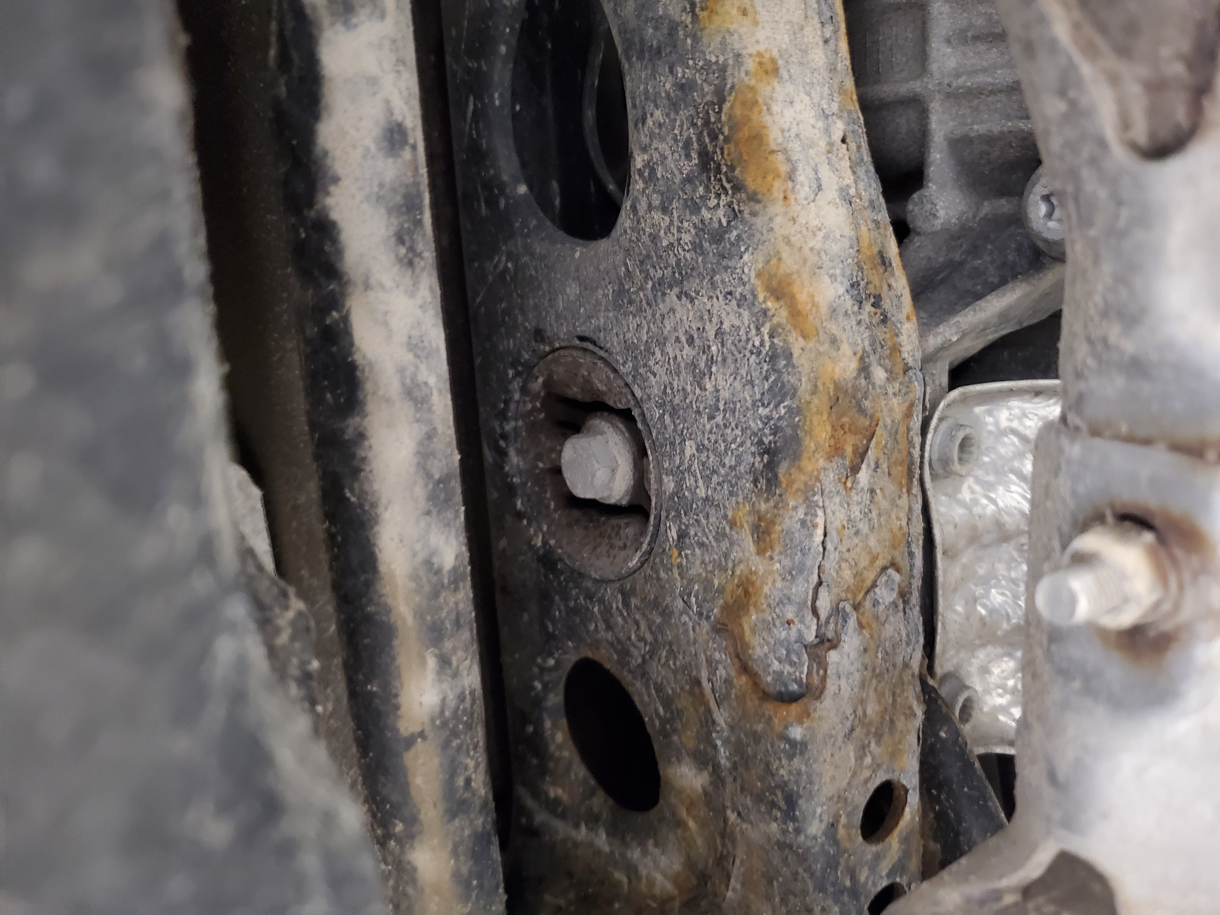

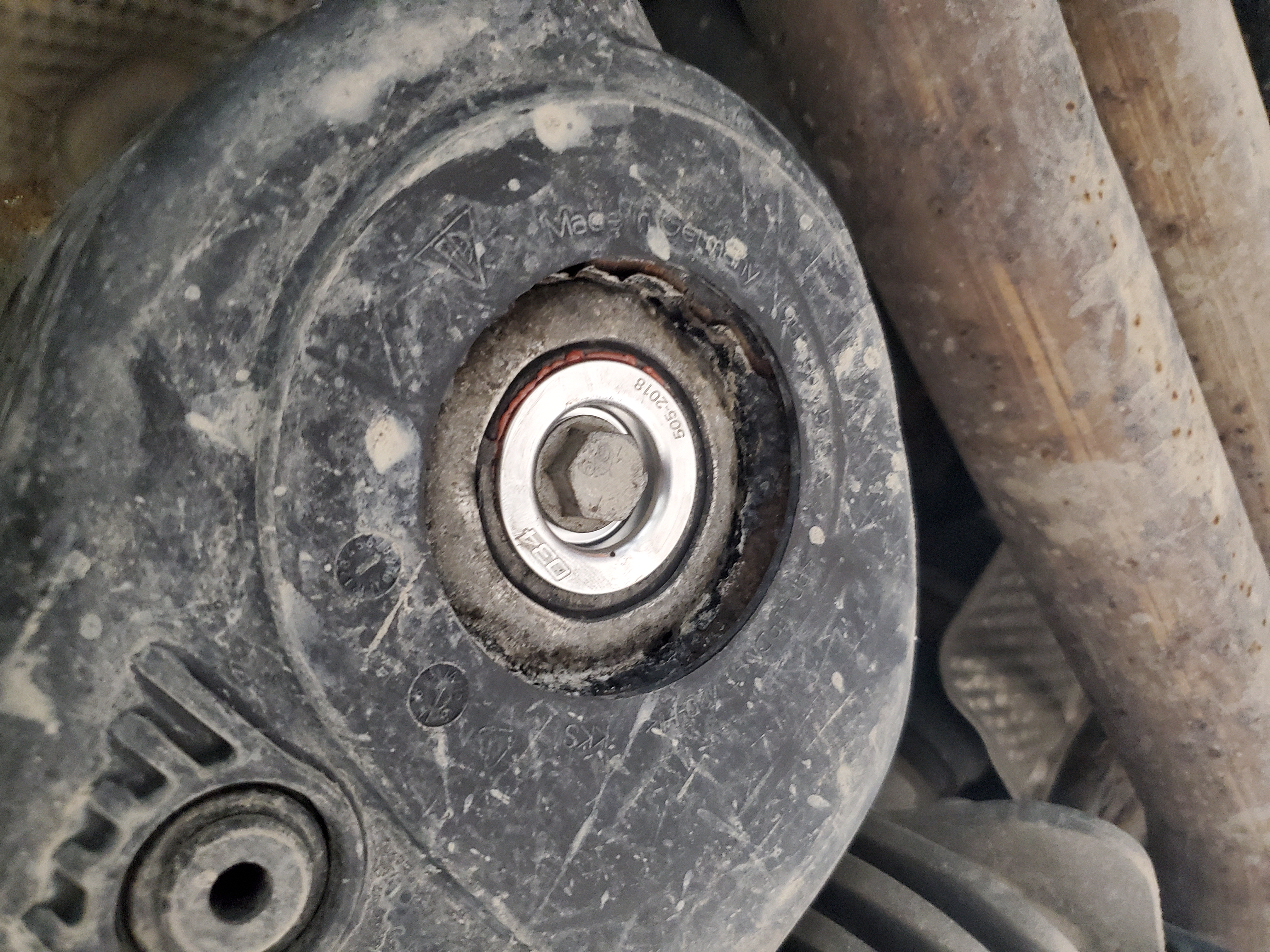

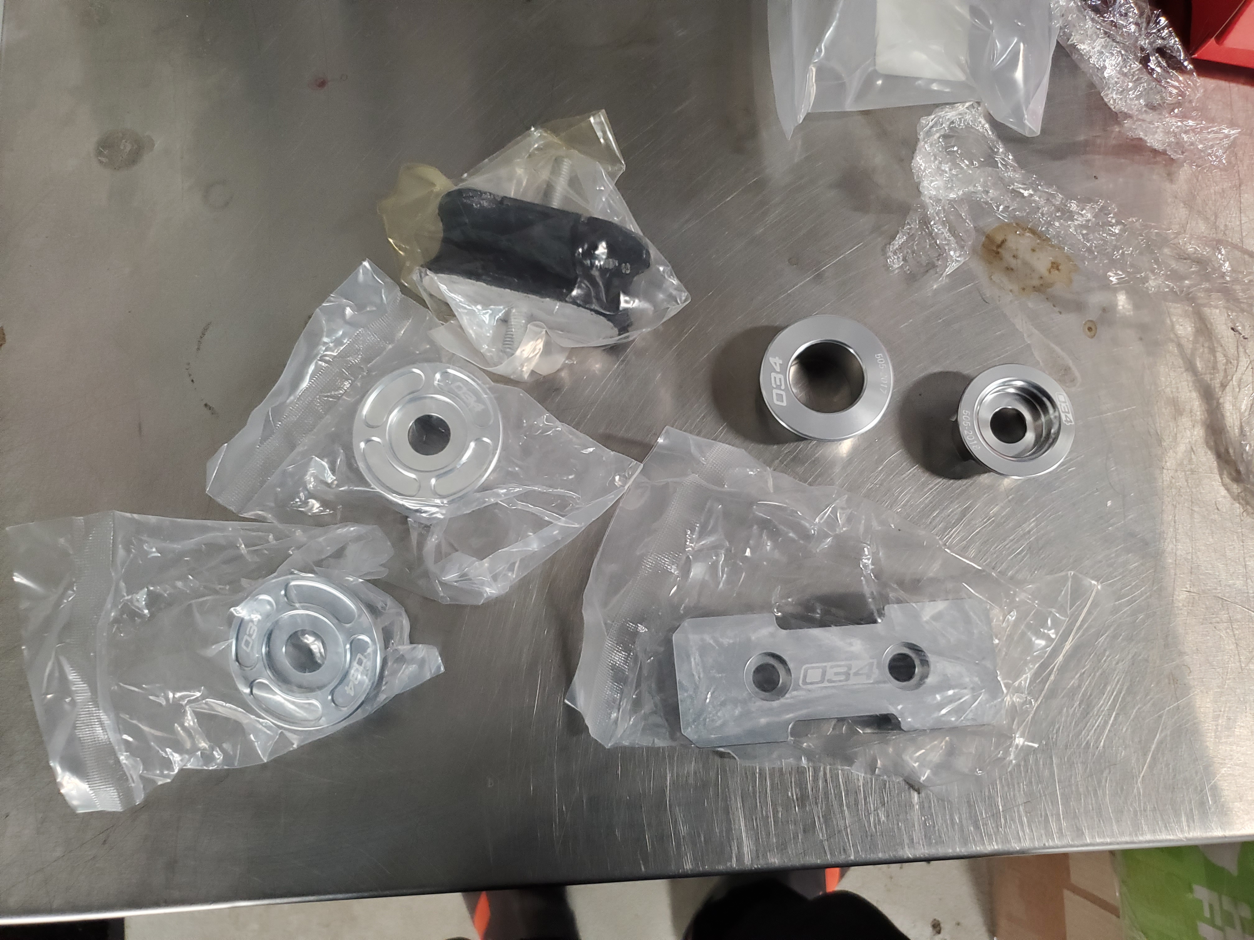

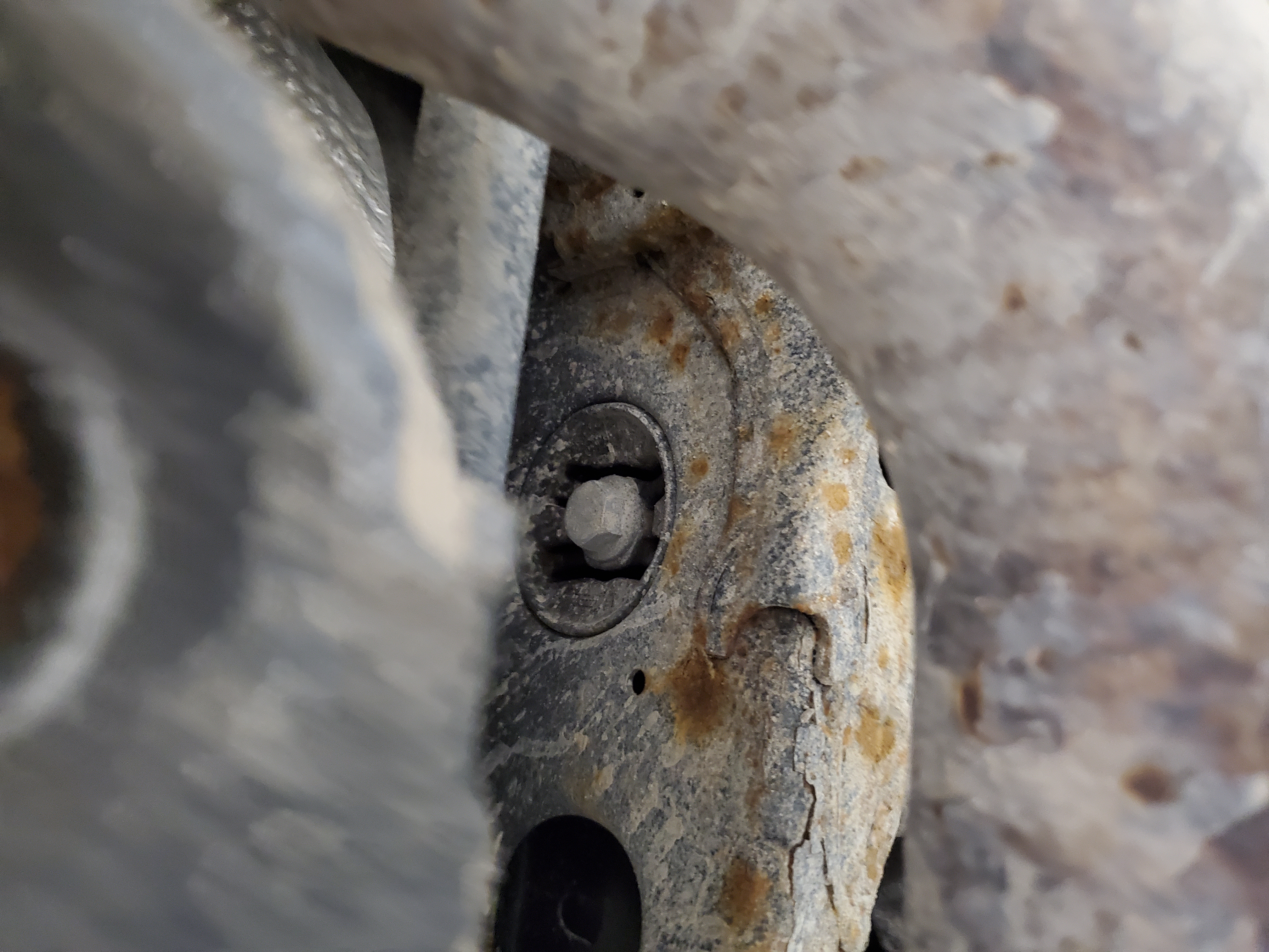

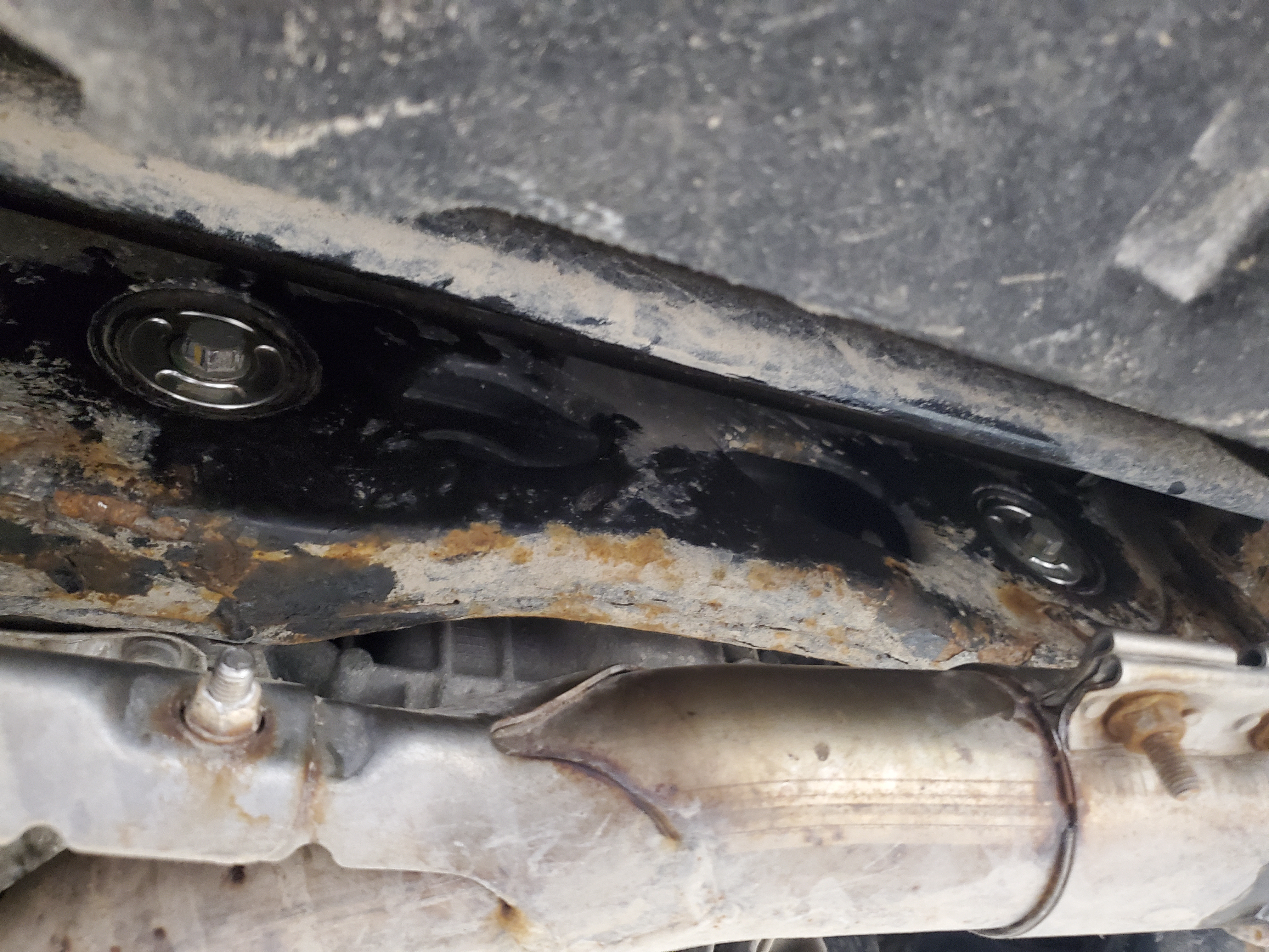

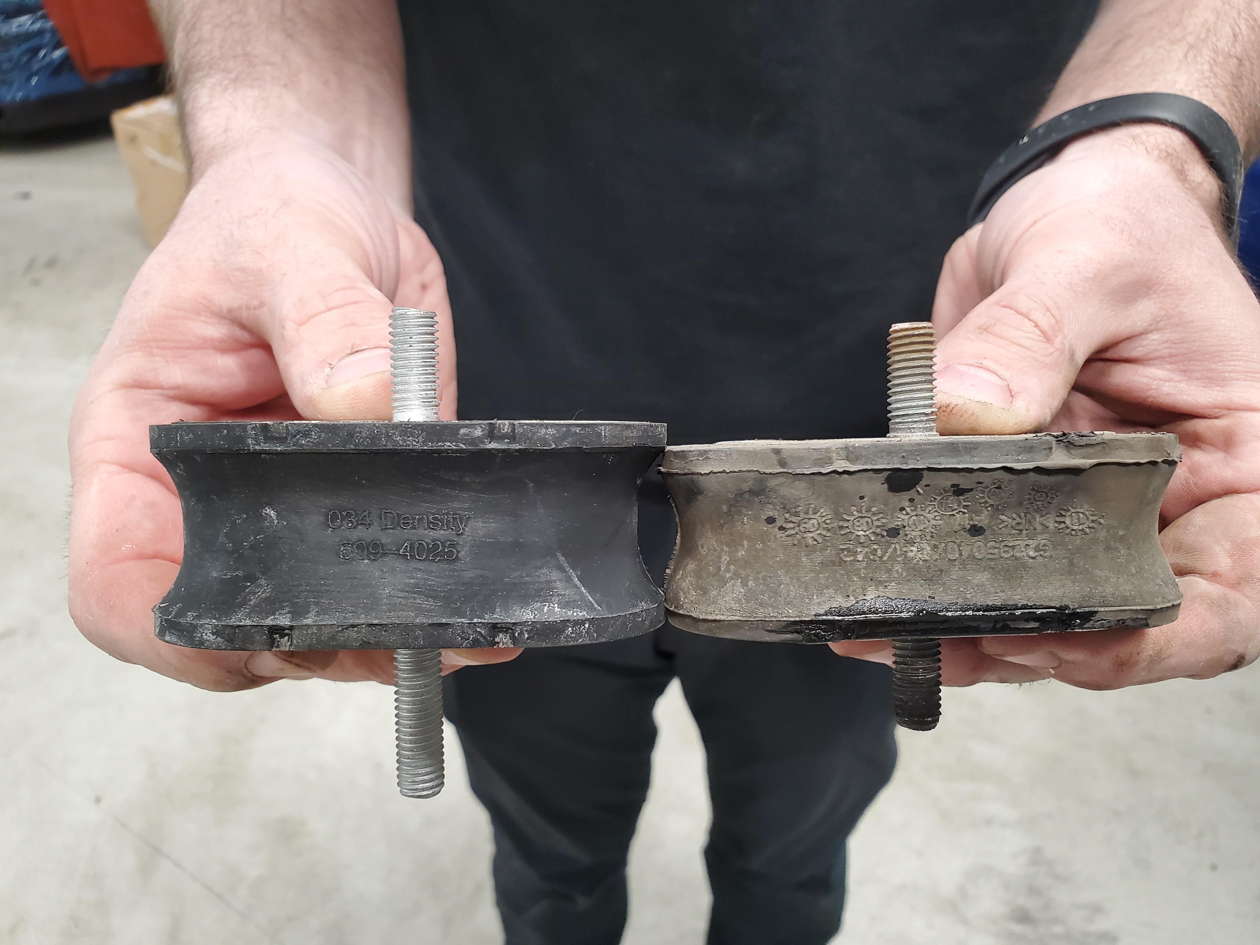

Drivetrain inserts are installed. Thanks to Bill and the guys at Garage Autosport for letting me use a hoist to install these. (Surface rust will be attacked with por 15)
These inserts feel fantastic. The car feels solid, and you can tell the power is all being transfered to the tires. I haven't noticed any difference in NVH but @Teddis will drive my car in the next week or 2.
Insert kit for rear diff, street density DSG/PDK mount and Insert.
Before pictures:
Stock PDK mount with 174xxxkms(right) vs new Street Density mount:
After:
