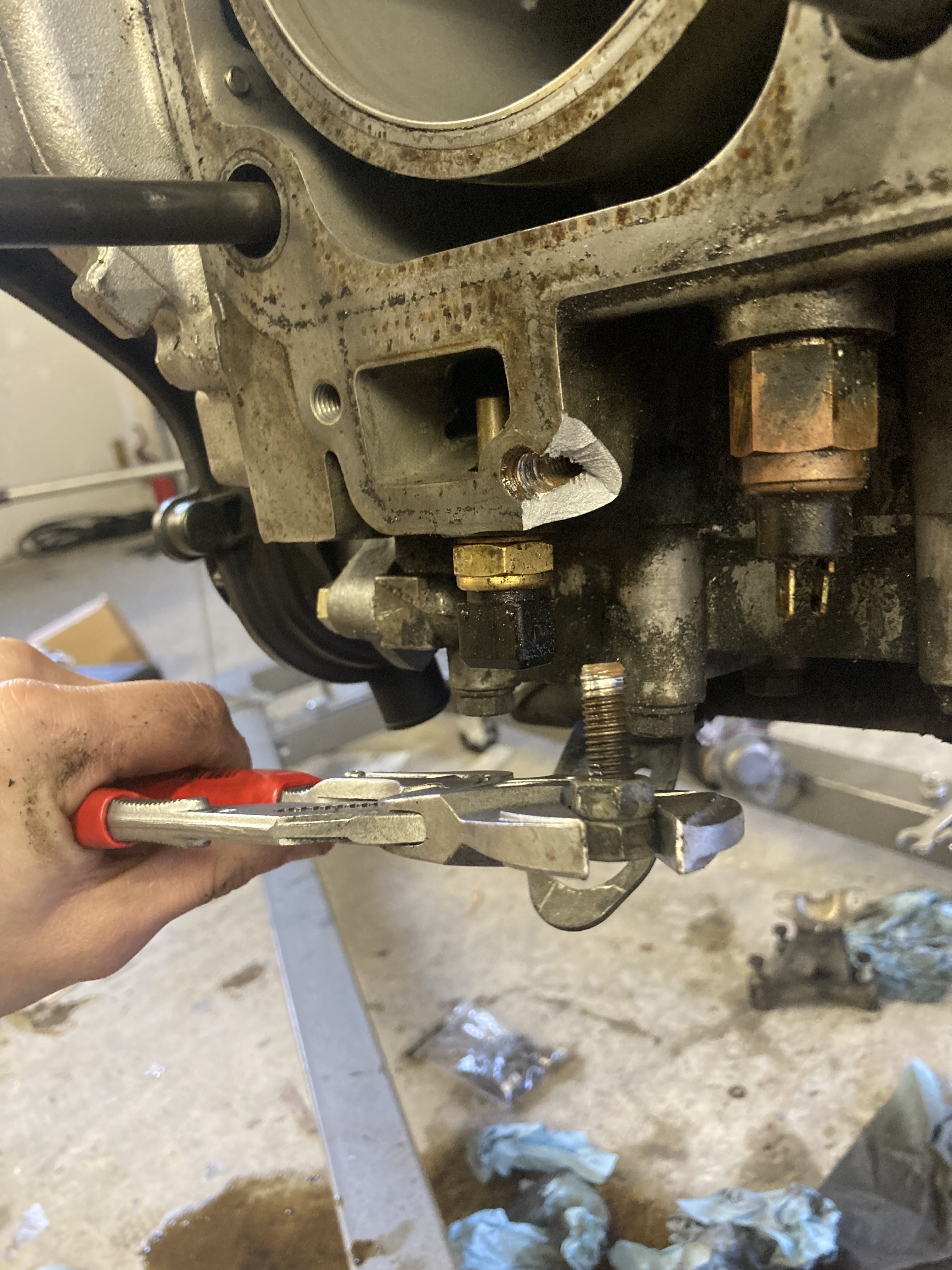

It wasn't all roses, however :( :
...Going to just find some decent epoxy (jb weld? eek.) re-drill and fit a thread insert, then convert those two bolts to studs.

Re the broken chunk, I'm not sure I'd bother with JB weld or the like -- just kind of doubt it would do much? If there is enough material below, maybe just tap it as is? That inner area 'should' seal the coolant.
A decent TIG machine would build that back up no problem. The new generation of welders are so small that someone 'could' bring one over to your garage. Decking the top might be a challenge, but for such a small and non-critical area, I'm guessing you could 'deck' it good enough with a dremel or the like.
If not TIG handy, that broken bit is a perfect candidate for HTS-2000 and/or similar brazing rods sold at HF and other places. I've used HTS-2000 and it's the real deal. If you create a little steal or copper fence for it, it would be stronger than new... Here is a cheesy video, but worth watching for your situation....

I would tap the hole to clean it up and install a long stud with loctite.
