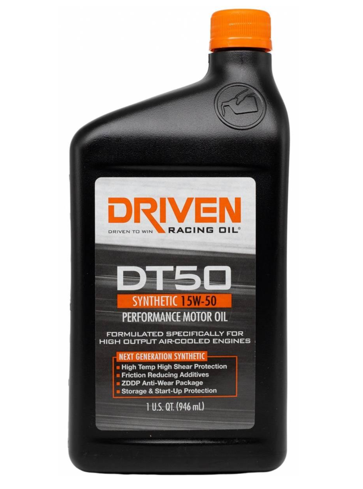

This stuff dropped my oil temp from from +/- 220° to +/- 195°.
Raised oil pressure a little bit, water temp dropped too.
ZDDP over 1500ppm.
Specifically for air cooled engines, Gibbs says can run it in watercooled too.
Never thought I'd buy in to beautique oil marketing, but this stuff works.
OEM filter only, I think they are Mann.
