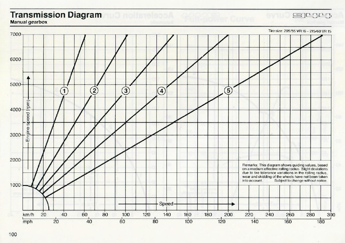

Back on the road, I see! Congratulations! 200kph at 4600rpm seems a little odd, though. Either your speedo is optimistic, your tach reading low, or you've got smaller diameter wheels...first gen speedos read off the front wheel spindle, and mine has always read quite fast compared to my gps, like 15kph too fast at 160kph running stock tires and wheels.
#37
944er
Posts: 155
Has thanked: 13 times
Been thanked: 54 times
Oringojin wrote: Mon May 11, 2026 12:00 am 200kph at 4600rpm seems a little odd, though.
Looks about 7-8 KPH fast to me, which could be from tire wear. Speedometers are required to read at or above actual speed, including with new tires.

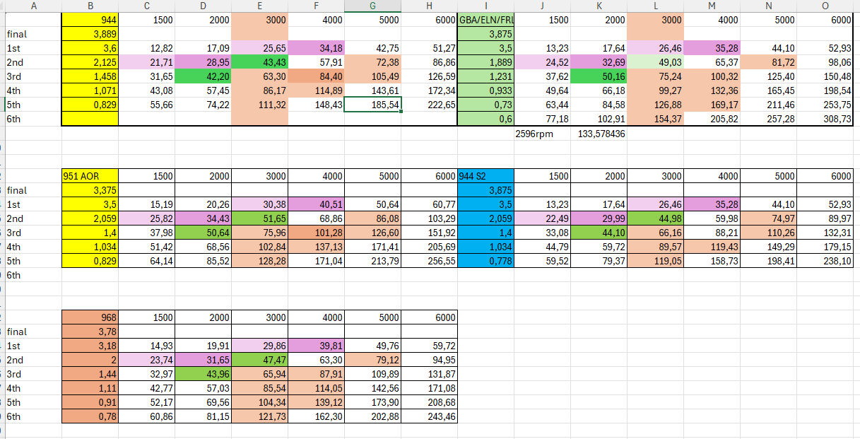

According to that chart the speed/rpm isn't too strange at all. Reading over by 7-8kph is perfectly normal.
I was going by a spreadsheet I made a little while ago just doin' the math to compare different ratios in preparation for a transaxle swap, as well as my own experience with my 924S. I've almost never cruised at 200kph, but my usual highway speed was in the 160-180 range, and my engine was turning in the 4500-4800rpm range at those speeds. That's why I've swapped in an 01E 6 speed.
The photo looks more in line with the ratios of a Turbo AOR box.
