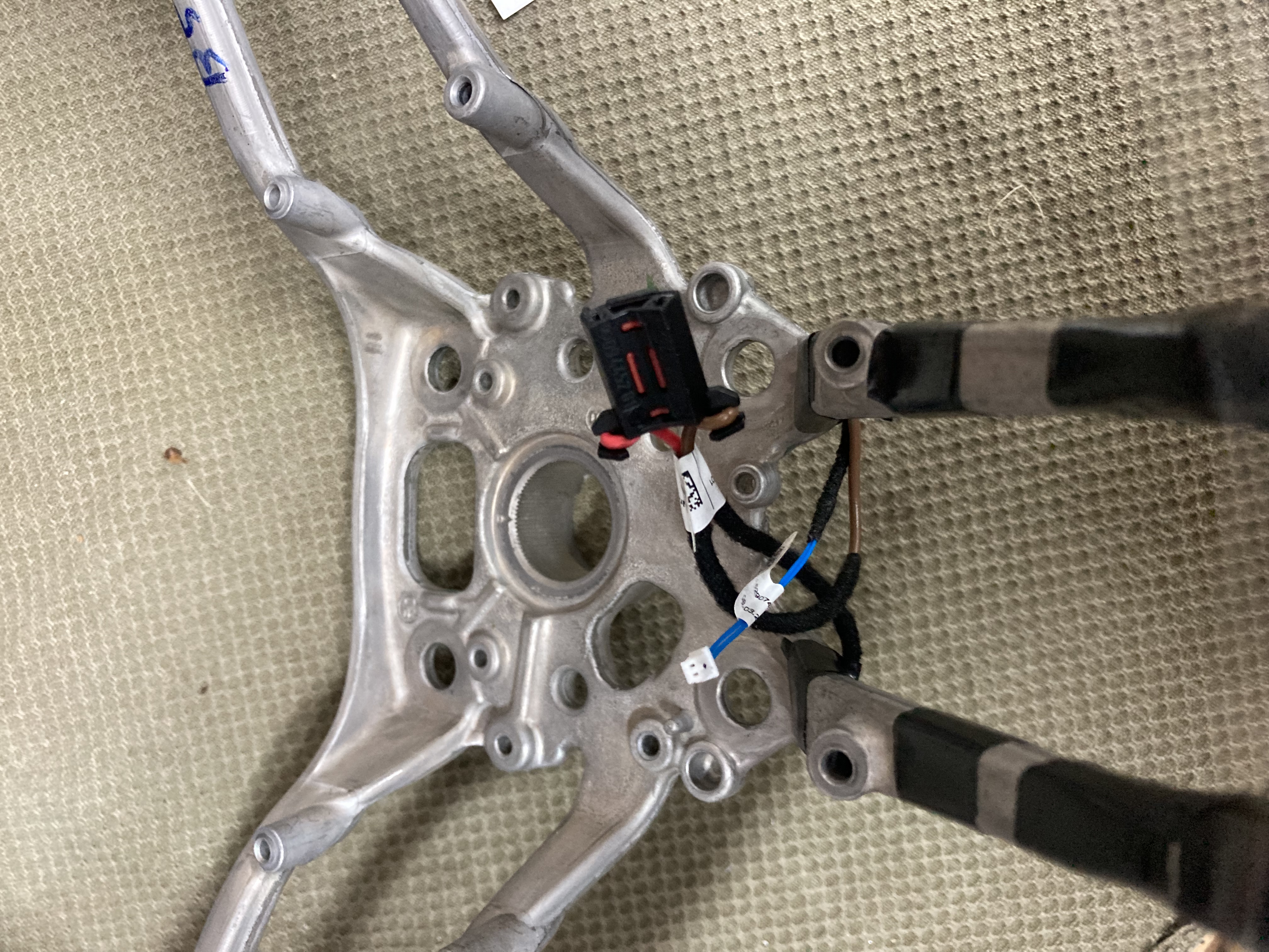

My journey continues to get exactly what I want. I got the wheel I ordered from eBay, and it looks good except for one slight problem. There is one less set of wires than my stock CF wheel for the heating feature. Pictures enclosed show both, and the new wheel (in black leather, BTW) only has two of the three wire sets with connectors instead of the three that the CF wheel that came on my car has. Will this make a difference? I don't know but suspect it will. I guess the only way to tell for sure is to install it and see what happens. Of course this will mean moving all the trim and MF stuff from the new all leather wheel I got from Dallas Custom to this newer one, lots of work just to find out, but I need to do that before sending it off to Dallas for the Espresso w/ Cognac stitching that I got on the first one. To be fair I got the exact wheel I ordered, and it only shows the two wire sets, I just didn't notice so that is on me. I assumed all heated GT Sport wheels would have the same wiring. I doubt anyone on Carpokes has done any of this and has any first hand info about it, but I'm posting my saga just in case. The place I ordered from has tons more Porsche wheels and I will look through them to see if any show the same wiring I have on my stock wheel for comparison. But I'm getting lots of experience in doing the wheel R&R and getting quite good at it.

i was going to change the wheels yesterday and put the eBay wheel on to see if the heating function worked with only two wire sets and I started changing the trim and wiring harnesses over to that wheel, when I suddenly realized they weren't the same wheel architecture. Examination of the pics in my previous post will show that they are not the same, but I failed to notice this when ordering the wheel or even when I received it. SO...I contacted the seller and am returning this wheel to exchange for another that both has the proper 3 wire sets for heating AND is the same design as my original. It is a CF wheel with black leather trim, and I will send it to Dallas Custom Wheel to have recovered in my Espresso w/ Cognac stitching per my original plan. This is getting expensive in a hurry, and the rabbit hole is getting deep. Oh well. The logical question is, why not just send my original CF wheel to Dallas for recovering, and I considered that. But I am leaning toward keeping this wheel so when I eventually sell my car I can offer the option of returning it to the factory spec. At that point I'll have an extra wheel I can sell. When I put the original wheel back on yesterday I must have not gotten the main plug seated in the clock spring well enough, for when I drove it last night the MF buttons on the wheel were dead. I had had trouble getting it to seat, and it never would click in with the locking tab as it should, so that is something I need to address. I have tried rather forcefully pushing the wire plug into the socket on the clock spring but fear being TOO forceful. I may need to trim a bit of plastic off the tab so it will more easily seat in the slot. Ah, the joys of modification!
