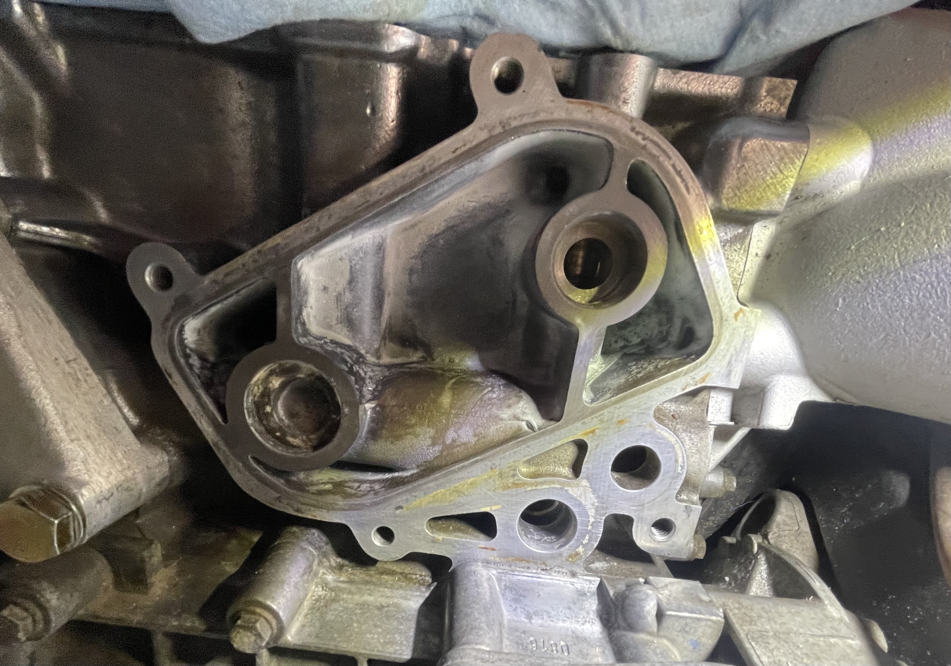

I'd want that surface to look cleaner personally, especially if not flat and smooth to the touch. Stains are one thing, but at least over the internet, that looks like more than just staining. MM's advice is intriguing -- always good to know what the pros use. :) I'll have to get one of those Super Scrapers, though it does look like you'd need to be careful not to scratch anything with it.
From the shade-tree hillbilly perspective, I bought a big box of these Dremel abrasive wheels and use them on stubborn surfaces like this. You just need to be careful not to go crazy with them, and make sure the debris/dust doesn't get into the motor.
Also, I just replaced that same gasket. I found some corrosion in the console groove, so abandoned my slightly judgmental aversion to sealant and used Curil T2 in on both sides of the gasket -- happy to report it's leak free. :angel:

I scraped the buildup very gently with a stubby flathead screwdriver and did a decent job. There’s still a few spots and staining that I can’t get with the screwdriver, I’ll give the super scraper a try. I don’t have a Dremel but been waiting for an excuse to get one. I think this calls for it.

The carbide scraper was too aggressive for my skill level, was scraping aluminum off with very little effort. I think it would be more suitable for a larger area like the cylinder head.
I developed a good flow using stubby flatheads in different widths. It’s tedious, but I have good control in tight areas, feel rough spots, and use a bit more force if needed with little to no scratching.
Then finished it off with popsicle sticks and 1000 grit wet sandpaper.
I think it turned out decent.
