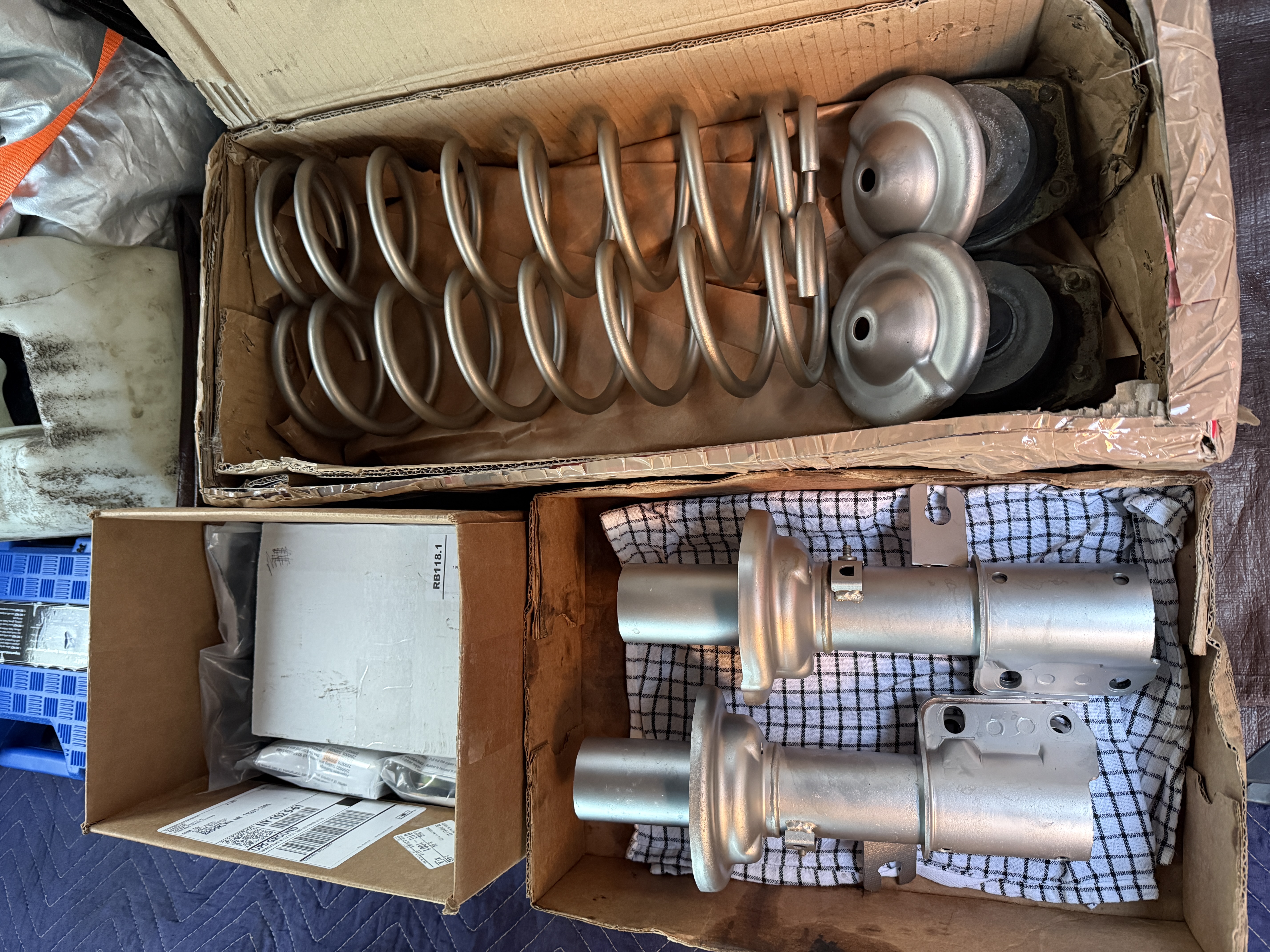

Vaporized.
The conversion kit comes this week. Had to pay a $100 tariff on it :lol:

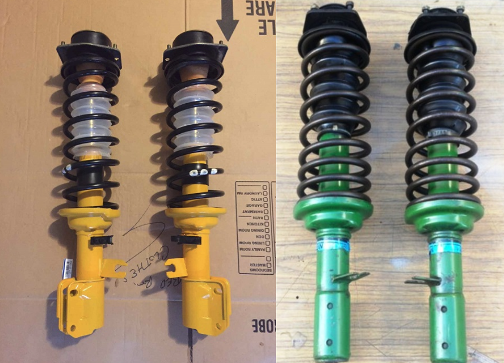

Yellow or green? Can the late car run the green Bilstein shocks in the rear?

Wow, vapor blasting looks awesome. Are you planning to paint or powder coat? My vote is Koni yellow. :)

spacecad3t wrote: Tue Jan 20, 2026 1:30 pm Can the late car run the green Bilstein shocks in the rear?
The green ones are for steel trailing arm cars, yellow are for aluminum trailing arms.

Bummer, sounds like yellow paint then.

Just paint them myself, I have a decent amount of experience. No heated spray booth tho, so I need to wait on the temps to rise later this year. I'll wrap up the fitting and welding once the shocks come in this week- but then go quiet until warmer weather.
