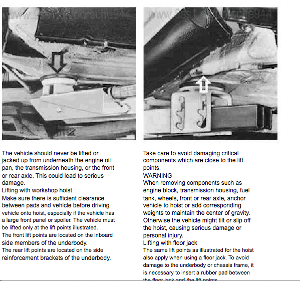

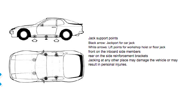

"The lift points are mentioned in the owner's manual : "diamonds" on the square frame rails."
Really? I have to look...
Screen Shot 2022-01-13 at 8.58.49 PM.png (83.27 KiB) Viewed 1754 times
Screen Shot 2022-01-13 at 8.59.05 PM.png (243.6 KiB) Viewed 1754 times
I didn't find reference to any diamonds, but yep, it's pretty clear to only raise in front on the inner rails... ...and never on the transmission in the back! That transmission lift is a suggestion at one of the popular tutorials for lifting found online!
Thank you.. glad I found this

I used the term diamond as this is the shape of the "things" in the square frame rails that show the center of the lift points for the front.

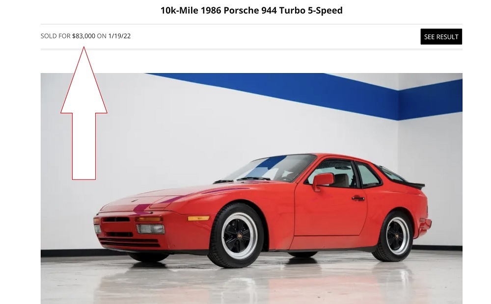

We're definitely not in Kansas anymore. I paid $12k for my '86 when it had 32k miles, and I'm pretty sure I overpaid at the time....

I like this one better than the last.. negligible mileage difference. It's a steal! Ha ha ha!
