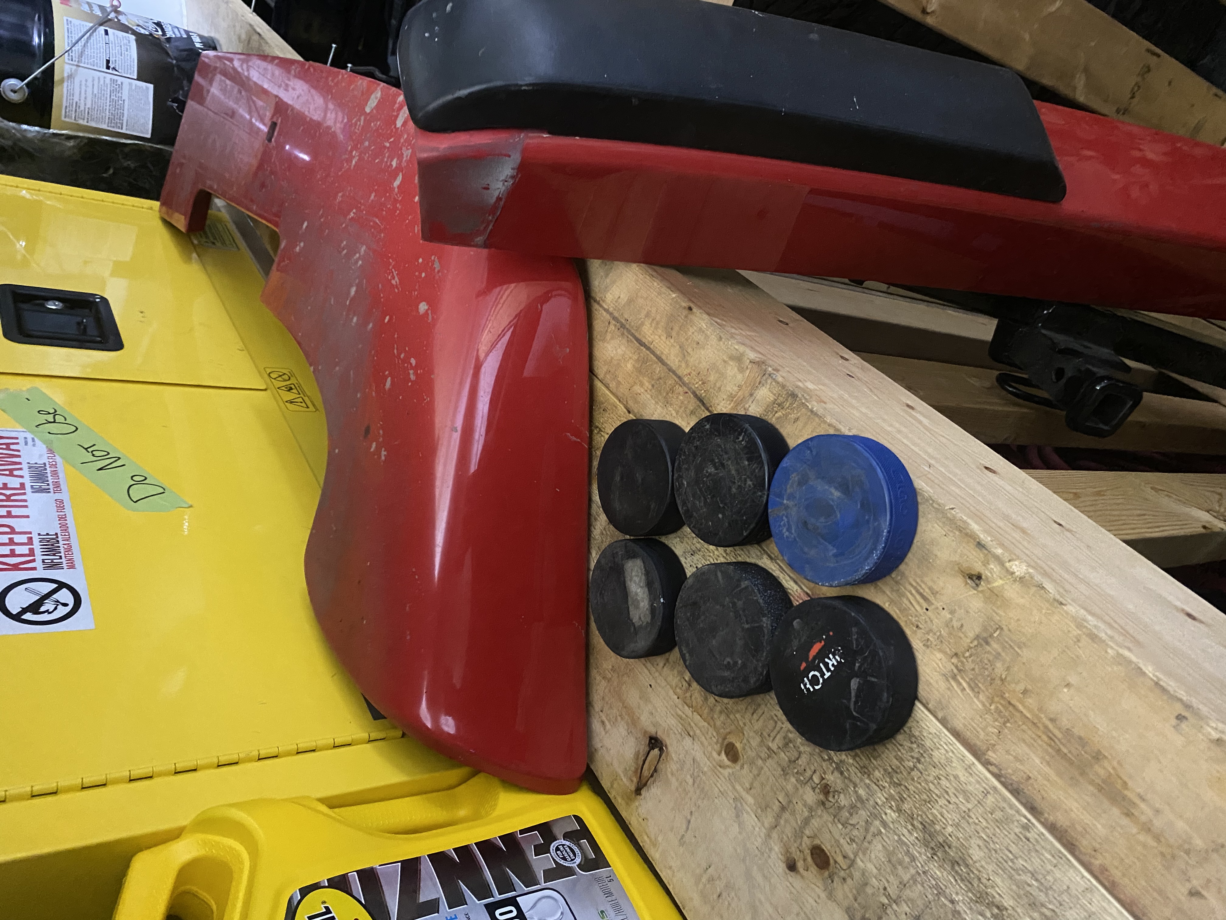

Use a hockey puck under any of the lifting points.
Hockey pucks are stupid cheap.
They also do not slip
You would have to ram into with a truck to knock it off

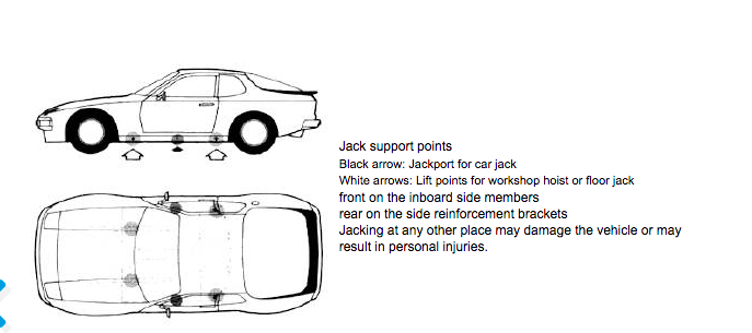

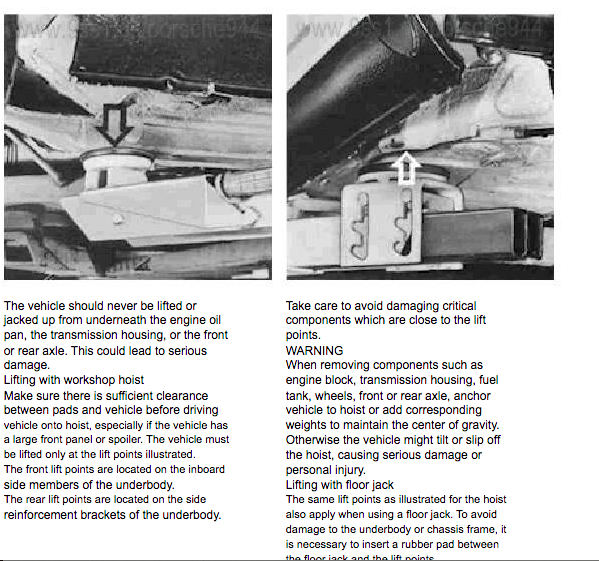

"The lift points are mentioned in the owner's manual : "diamonds" on the square frame rails."
Really? I have to look...
Screen Shot 2022-01-13 at 8.58.49 PM.png (83.27 KiB) Viewed 1753 times
Screen Shot 2022-01-13 at 8.59.05 PM.png (243.6 KiB) Viewed 1753 times
I didn't find reference to any diamonds, but yep, it's pretty clear to only raise in front on the inner rails... ...and never on the transmission in the back! That transmission lift is a suggestion at one of the popular tutorials for lifting found online!
Thank you.. glad I found this

gruhsy wrote: Thu Jan 13, 2022 2:57 pm Use a hockey puck under any of the lifting points.
Up here in Canada, we use hockey pucks for that and for just about anything else lol
How did you jack that thing up so high to get the wooden structures under??
PS: your front "rest point" appears not to be the inner rail... seems too close to the outer side?

The pucks are hidden in the photo and stacked with 2 or 3 high.
It’s an old photo from 2010
I’m in Calgary hence the pucks :)

I used the term diamond as this is the shape of the "things" in the square frame rails that show the center of the lift points for the front.
