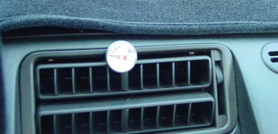

Under 20º F (with R-134a):
Vent Temp --
Vent Temp --
20 Degree AC Small!.jpg (87.18 KiB) Viewed 1024 times

I'm confused by your 20F vent temps, and suddenly feeling inadequate with my relatively balmy 38F temps. That's cold enough to cause actual frostbite. Shouldn't our previous a/c rabbit hole -- i.e., the freeze-over capillary tube switch -- prevent the temps from getting that low?

The freeze switch had failed (closed) at that point, and in the relatively dry L.A. basin there wasn't a lot of incentive to replace it. On longer trips, after maybe an hour or two, I'd have to remember to shut off the compressor for a bit to let it defrost. Ditto here in the high desert, but I don't need the AC almost all year as we did in SoCal. The cold vent temps are indeed enough to be uncomfortable after a while. But for a black car in sunny L.A., it did a pretty impressive job of chilling a heat-soaked cabin. Plus it silenced the naysayers who were sure that an R-134a 'converted' car just wasn't cold enough.
I have the new adjustable freeze switch installed in my car but not wired in; I don't think the contacts are rated for use directly in the clutch circuit. Original switch certainly wasn't. I think it needs a relay, similar to the way your 944 has the switch before the relay coil. I have penciled a solution but need an adjustable delay-on timer to make it work correctly. I could fit a normal relay and call it a day, but what's the fun in that?
Meanwhile, if your system is cycling off at 38 vent temp, it's working perfectly. It's quite likely that you are close to freezing at the evaporator coils, about as cold as you want to run it without risking ice-up. Read the low-side temp on the pressure gauge to see the internal evap temp, assuming there are no 'non-condensables' like air in the system. A small mass of air gets pretty 'large' between the evaporator and the compressor inlet, and steals an amazing amount of system capacity. Fools the expansion valve too.

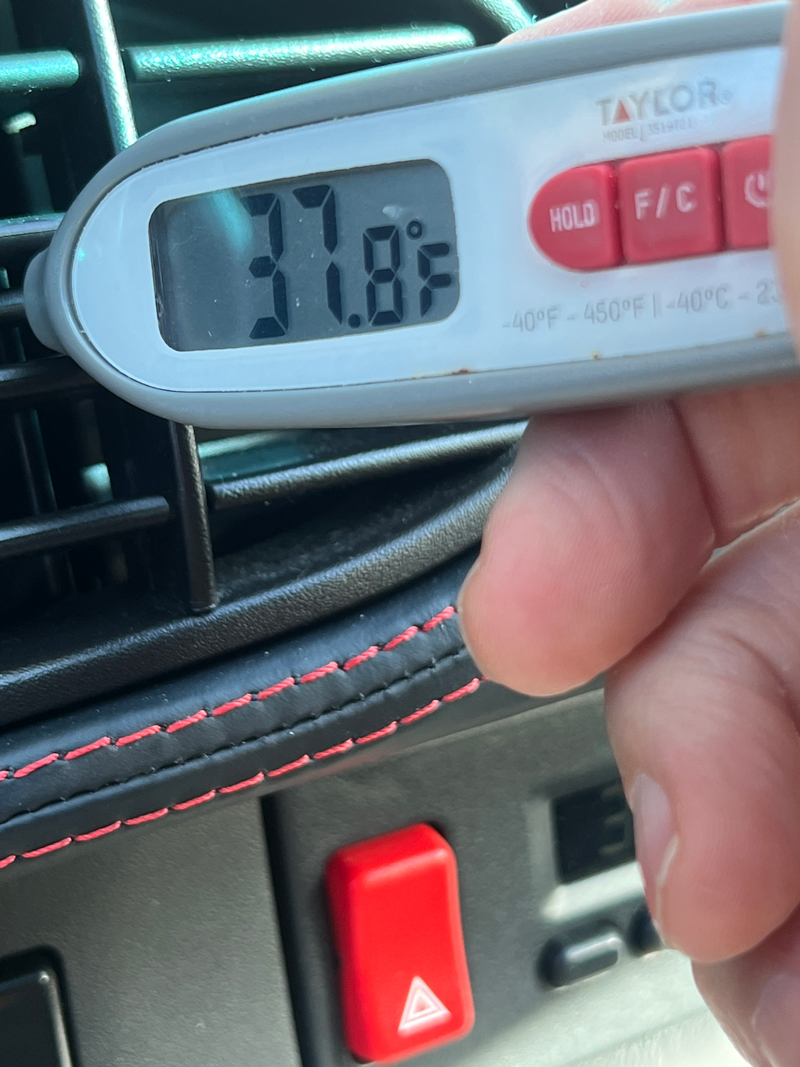

It cooled down to an even 100F today here at CP headquarters, after a high of 107F earlier in the week. Pretty crazy, but I took the opportunity to check the 944 a/c and was pleased to see it still brings the vent temps down to about 38F, then starts cycling the compressor to keep in that 38-40F range. Not sure if that's the high pressure switch or the freeze-over switch, but I figure if it gets the car uncomfortably cold on a 100 degree day, I'll call it a success and move on. The eBay condenser works!
Here's a shot from my truck on Tuesday or Wednesday this week. This was out driving around, not heat soaked in a parking lot. 107F in October. :shock:

If you are getting that 37º vent temp at your typical driving conditions and 100º ambient, you have done a very fine job.
For those playing along at home, California is subject to fall weather phenomena where a high-pressure zone parks over the southwest states east, and the winds blow hot and dry off the deserts. The 'dry' (low relative humidity) ambient condition seriously reduces the load on the AC system when the dew point is below the mid-30's evaporator surface temps. A pretty massive amount of heat is needed to transit water from liquid to vapor state (see: latent heat of evaporation in your high school science books), and a similar amount of heat needs to be transferred out to cause the change back to liquid on the evaporator. For folks in humid places with heat along for the ride, there's a comfort factor making the cabin air feel cooler when the water is condensed out, somewhat offsetting the loss of that capacity to the state conversion part. But with all that capacity spent on condensing the water vapor, there's less to actually reduce the sensible heat in the air flowing through.
Condensed if you will, don't expect to get the same vent temps as Tom is enjoying if you have humidity to contend with, even if your system is performing at design capacity.

According to the interweb, it was 102.2F ambient with humidity of 22.11% and a dew point of 53.6F yesterday afternoon around the time I checked the a/c. To your point, I think that qualifies as 'dry' weather. I do remember my days in South Florida where even a glass of tap water would sweat. No idea what the vent temps were, but turning on the a/c in a car was like turning on a faucet at the condensation drain. Even if the vent temps were 20 degrees higher, the dehumidifying effect of the a/c made all the difference in the world. Humid heat is tough on a California guy. ;)
