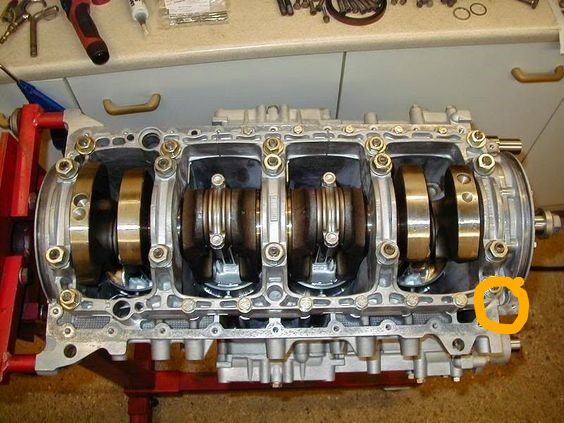

I think is partially why I am confused. My oil pump is sealed and leak free.
I think Michael is meaning to add a bead of 574 at one of the external seams between the pump and block...but I am just not sure exactly where.
Re: Oil pan gasket sealing
Posted: Tue Feb 13, 2024 6:46 am
by gruhsy
Here.
Finger painting was never my thing lol.
Just did this now on my iPhone picture editing.
This has been mentioned before that it is recommended to temporarily install oil pump then torque down crank girdle to help keep the three mating surfaces as flush as possible.
Not claiming credit for the idea😎
Girdle in your pic appears like it has a lip between girdle and block.

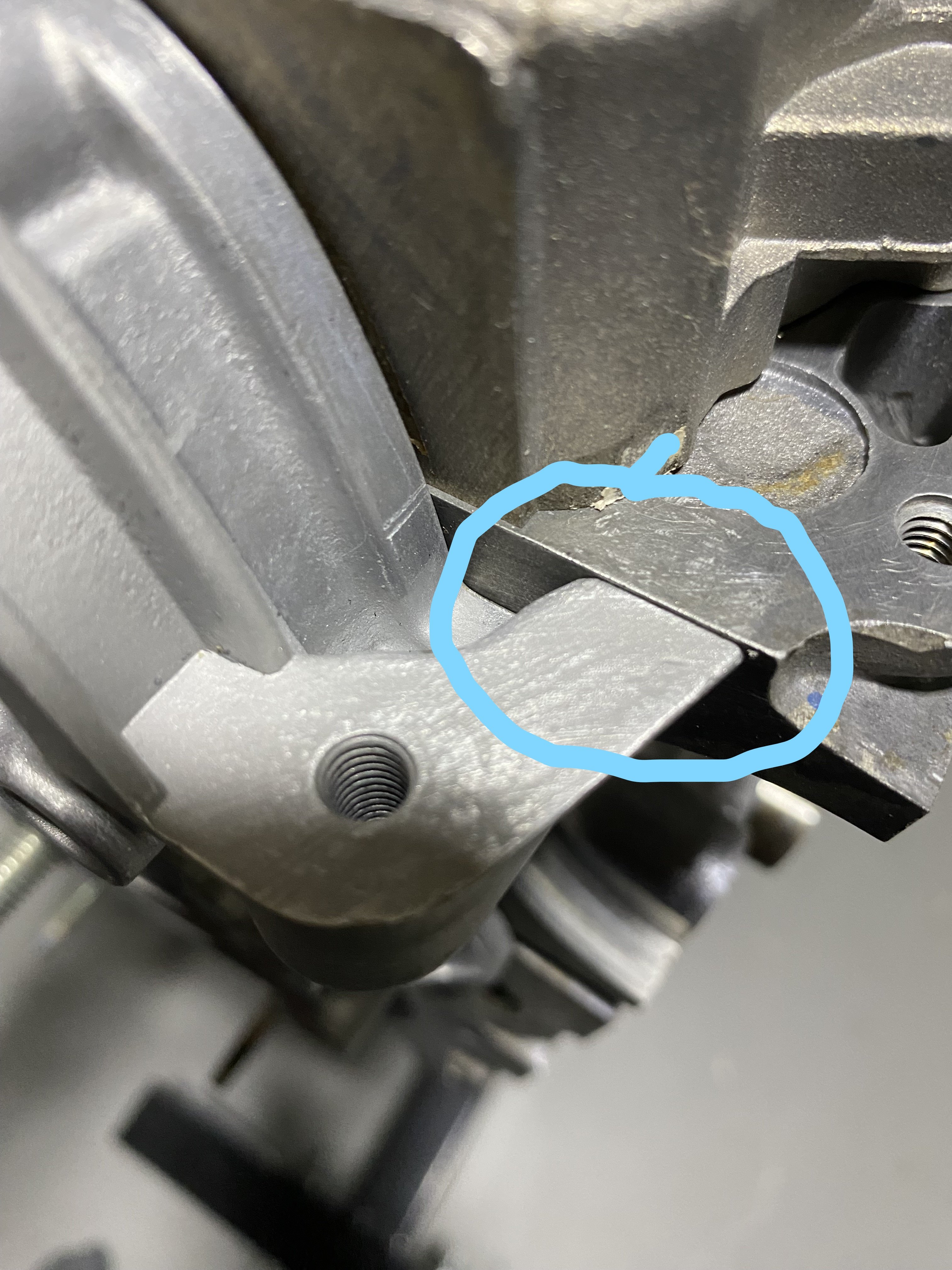

Apologies for all the confusion. I'll try again...
The oil pan gasket (seal) lays on what's typically called the pan rail. The pan rail on the block is not complete until the oil pump is mounted, since the pump adds the very front section of the pan rail including the 90 degree bends and the looped cross over to the opposite side pan rail. With the oil pump installed, there's a seam in the pan rail where the oil pump meets the block. This seam on the pan rail is where I put a small bead of 574. All this said, the sealant on this seam may not even be necessary, but it certainly doesn't hurt. Can someone post a photo of the seam for clarification?

Lovely photos. OK, here's the seam I've been trying to describe.
Posted: Tue Feb 13, 2024 6:09 pm
by Drscottsmith
Perfect! Thanks everyone. Will post some pics of the work when I get back under there this weekend!
