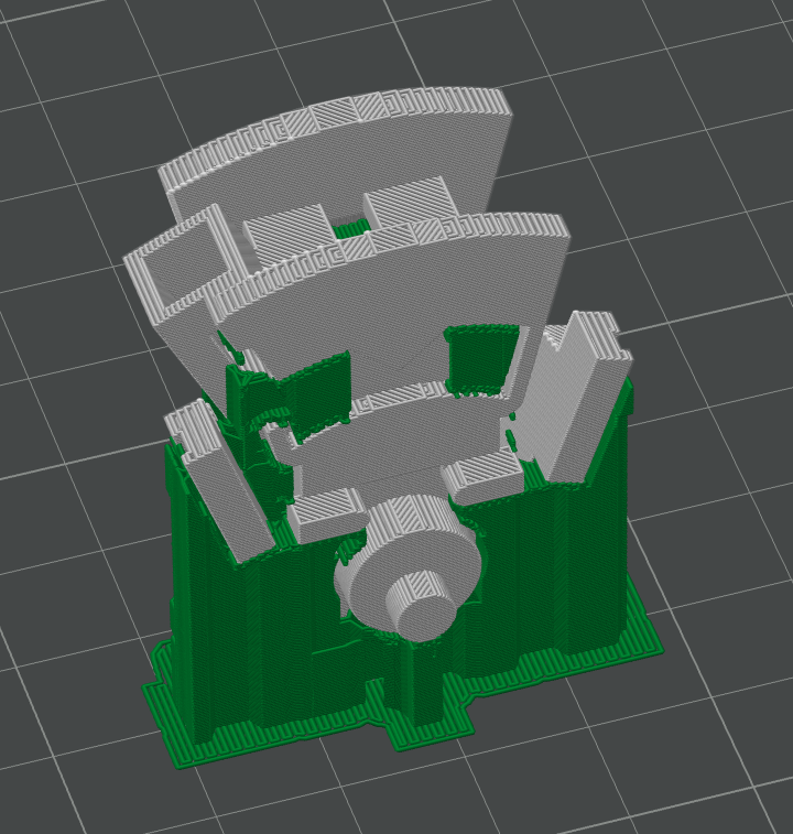

Heres my first attempt at this. Its not complete but I think itll definitely help someone out for now until I get everything dialed in. I included a Fusion360 file so that if anyone wants to mess around with my work then they can.

I will also be trying to make this with PLA as supports and PETG as the base material. Ill try out MJF and Resin prints after I get this one right on a FDM printer.
Slicer Screenshot
Slicer Screenshot
Screenshot 2025-10-23 154519.png (270.69 KiB) Viewed 854 times

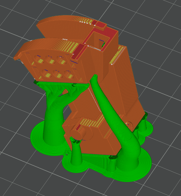

Final Version:
Turn Stalk Remade v9.step
(214.38 KiB) Downloaded 57 times
This took a while to perfect, but if there are any changes you need to make because of your 3D printer or whatnot then you can modify the step file for more or less tolerance.
You're Welcome :)
Heres a thingiverse link too: https://www.thingiverse.com/thing:7187324
I also recommend printing this at a 25 degree angle for the rectangle part to be printed upright and to have minimal supports as seen in the photo.
Screenshot 2025-10-31 142058.png (248.89 KiB) Viewed 790 times

This version 9 seems to have extra material like where the spring mounts. What am I missing?
#34
The_yuriy
Posts: 4
Joined: Fri Oct 03, 2025 5:12 pm
johnb823 wrote: Thu Dec 04, 2025 3:45 am This version 9 seems to have extra material like where the spring mounts. What am I missing?
I didnt think the big spring was necessary so thats why I got rid of it, but it seems like I need to add it back after some testing. The turn stalk doesnt return back to zero without it.
