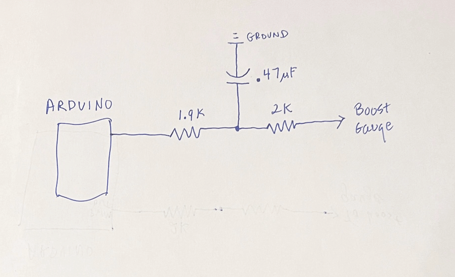

Here is a drawing showing how to drive the stock boost gauge with a 0 to 4.9v signal.
To drive the gauge in the software, this formula is a basic approximation (which can be fine-tuned with a better 'best fit' function to each individual gauge if desired).
Absolute pressure reading on gauge is approximately this: APSI = Vdc*5.42 + 2.575. For example, when you want the gauge to read exactly 1 (i.e., 14.5 psi absolute), set the arduino output to 2.2 volts, since 2.2*5.42 + 2.575 ~ 14.5. With this basic formula, you can also 'remap' the boost gauge however you want. For example, one setting in the SpeedoBooster remaps the gauge to read in boost pressure from 0 to 2 bar of actual boost (or 0 to 20 psi if preferred).

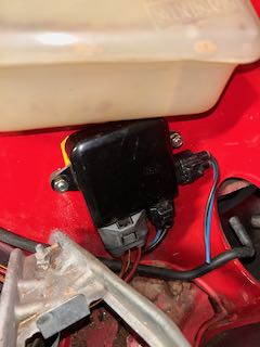

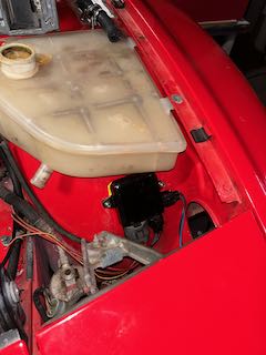

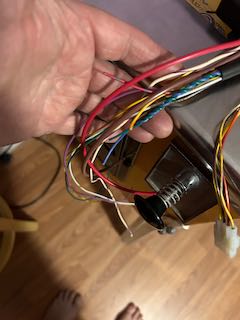

Nice work done today. Was able to get the wiring for the cooling fan controller finished up and the controller unit installed. See below. Knocksense box arrived today so I can assemble the secondary engine control unit now that will house the Arduino, knock sense, CANBUS interface, electronics components with circuits for ICV and Boost gauge control and a 12v-5v step down adaptor. Coming together slowly but surely.
Best location I can find. Not a lot of space in here to mount extra stuff!
Closer look at location. I did verify that the headlight bucket will clear

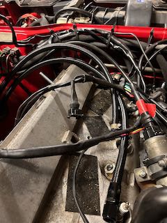

The new harness from the aux power box to the controller. +12v, PWM control wire, and ground

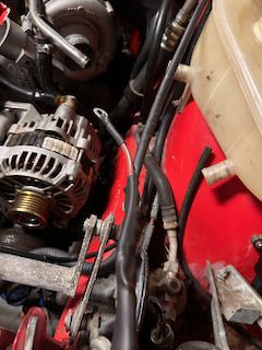

New harness runs along firewall bulkhead from aux power box in front of HVAC blower, then through the firewall near the 14-pin. Harness routes along AC refrigerant lines along fender

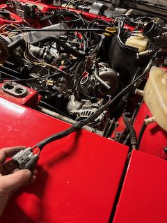

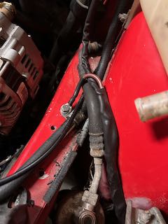

Completed tie in to Mazda plug

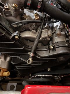

Ground wire attaches through harness to bracket attachment for coolant crossover pipe
Finished product. Have to run the individual fan motor wires through a new harness once I can set it in for measuring

I am just going to put the resistor~capacitor~resistor assembly for the boost gauge in line with the output from the Arduino in heat shrink (rather than add that to the circuit board as well).

Heat shrink should be fine for the resistors and capacitors, just remember the cap needs to be grounded on one end, so you'll have one wire going into the heat shrink and two coming out.

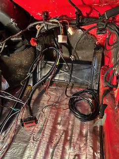

Incoming wiring harness from engine cleaned up and sorted. Plan is to mount the MS box and the secondary computer box to the back of the factory panel as original. I believe there is enough space back there for the plug. Have to put the multiline connector on the batch of wires that feed into the secondary box (that is most of the bundle headed back toward the pass seat area). In the pic left-to-right: gray wires going hard left are extra MS harness wires that are unused. Coming back towards seat by MS plug are connections either inside the cabin or to the secondary computer. Gray and Red wires next are 12V power to interior components and secondary computer (fused and relayed on ignition). Big black coil is from Wideband O2 sensor to gauge. There is also a 12V yellow wire for amp power and a speaker wire that will go back to spare tire well in there somewhere.

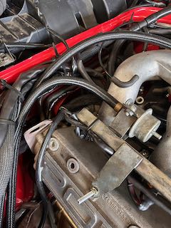

New AN6 fuel lines built and installed. Extended them so they will route by firewall and not crossover header heat area. Need a firesleeve for these.

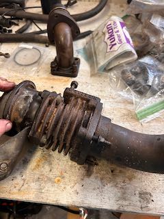

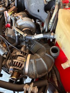

Vacuum lines run for Wastegate and got that reinstalled. What a pain and I took the exhaust lines off. Hopefully new hardware will make reassembly a bit easier. Clarks mentions studs on one side of the WG for the connecting pipe and bolts on the other. PET shows bolts all around. Mine had a combination of studs and bolts. Need to figure out what is correct. If anyone knows for sure...

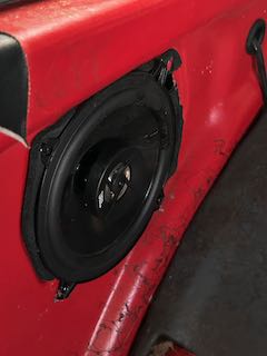

Rear speakers mounted. Not doing anything extravagant with the audio in the car other than a spare tire subwoofer. Had these JBLs leftover from another project so made a little trim and they fit just fine. Ready for panel reinstallation.

Wastegate before reinstall - note bolts/studs here. Have to figure out what is actually correct and/or most useable. Open to suggestions!

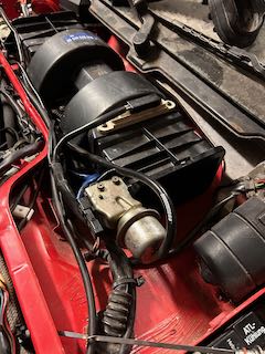

Blower motor fully reinstalled. As soon as my new ignition switch comes in I will be able to start electrical testing of all of the car's systems. I have no idea what does or does not work at this point, and want to test all of the factory systems as well as the new harness electronics before the dash goes in.

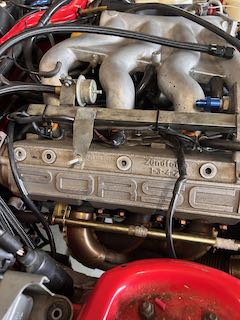

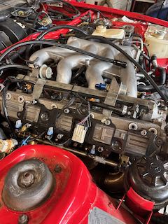

Fuel rail attached and new fuel line routing above. Made some new braided lines with -6AN connectors. Routed away from header path.

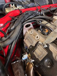

Injection harness connected and in place
Full shot of fuel rail in place ready to go. Long attachment studs will verify...

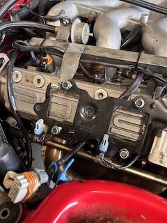

...and here's why! The bracket for the new ignition coil packs piggybacks over the fuel rail.
All vacuum lines are now in place. Coolant, PS and AC lines left to connect.

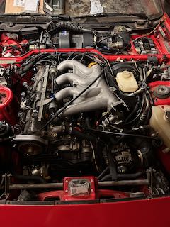

Full shot of engine bay at this time.
