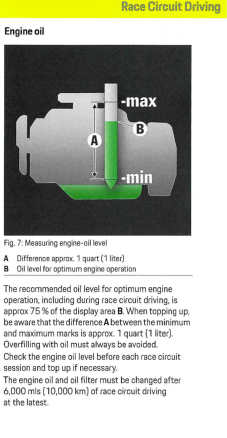

Hi all, here's my feedback on this topic based on the one oil change I've done so far on my '22 CGTS:
Fill with 8 quarts to start; I think I added another 0.25 quart to get to middle level. With DFI engines, I try to keep the oil at the middle of the measured range.
To get a reading after the oil change, this worked for me: 1. Drive the car until everything is up to temperature. 2. Turn off car but do not open front or rear trunk. 3. Wait 5-10 minutes. 4. Turn on engine and let it idle for 5 minutes. 5. Get oil reading!
Another option (this worked for me as well): just start car up in garage, and let idle for 10-15 minutes.

slilley wrote: Fri Feb 17, 2023 5:48 am Hi all, here's my feedback on this topic based on the one oil change I've done so far on my '22 CGTS:
This dance makes me appreciate the oil dipstick in my 2018 GTI!
@slilley
To your point regarding where you like to keep the oil level, there's this in my 2021 718 GT4 'Driving on the race circuit' supplemental owner's manual (p5) which supports what you shared.
I'm splitting small hairs with Porsche, but I find it interesting that they don't make that distinction in the full owner's manual. It seems to reinforce the idea that the correct filling is with the green bar at the top, albeit with the explicit warning to never overfill.
On a different note, this is also the same manual which, along with the regular 718 owner's manual, that has the illustrations for the water fill and oil fill ports reversed. After two years, Porsche is finally releasing digital updates correcting the mistake in the two manuals. (I received an emailed notice from Porsche regarding the update a couple of days ago.)

Interesting. It seems to me that Porsche should have that information in ALL manuals, not just the GT4 ( and I presume the GT4 RS), since many folks with "lesser" models track their cars too. I would like to inspect one of those race supplements to see what else is included in it.
