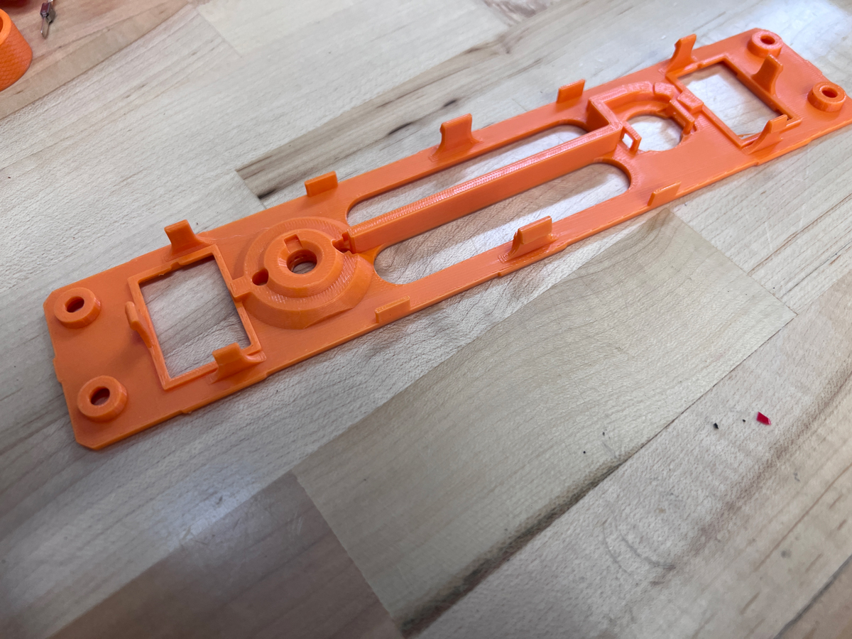

Someone sent me a 3D print file for the faceplate, so I printed it (quick and dirty) just to see. Looks remarkably true to the original. I used whatever plastic I had in the machine just to see it, but if printed in a high-temp clear plastic, it looks like this would work. I'm still waiting on Rennbay's version, however, since -- if I understood Travis correctly -- it is set up to install without de-soldering anything. :)

Tom I’m not sure what all is involved in replacing the faceplate. To use the one you just printed the control unit needs to be taken apart so would that mean pulling switches of the circuit board ??
Re: Need Help With Climate Control
Posted: Mon Feb 27, 2023 8:07 pm
Don_Cote wrote: Mon Feb 27, 2023 7:31 pm Tom I’m not sure what all is involved in replacing the faceplate. To use the one you just printed the control unit needs to be taken apart so would that mean pulling switches of the circuit board ??
Right, to get the clear plate out in one piece, you need to de-solder both the snowflake and defrost button. Weirdly, the clear plate has its own part number (NLA) which I always thought was interesting for a part you can't replace without removing components from a circuit board. If I understand correctly, the Rennbay one is designed so you can put it on without de-soldering anything. Hats off to Rennbay for investing the time, effort, and money into making a part the 944 world has needed for a long time. :)
