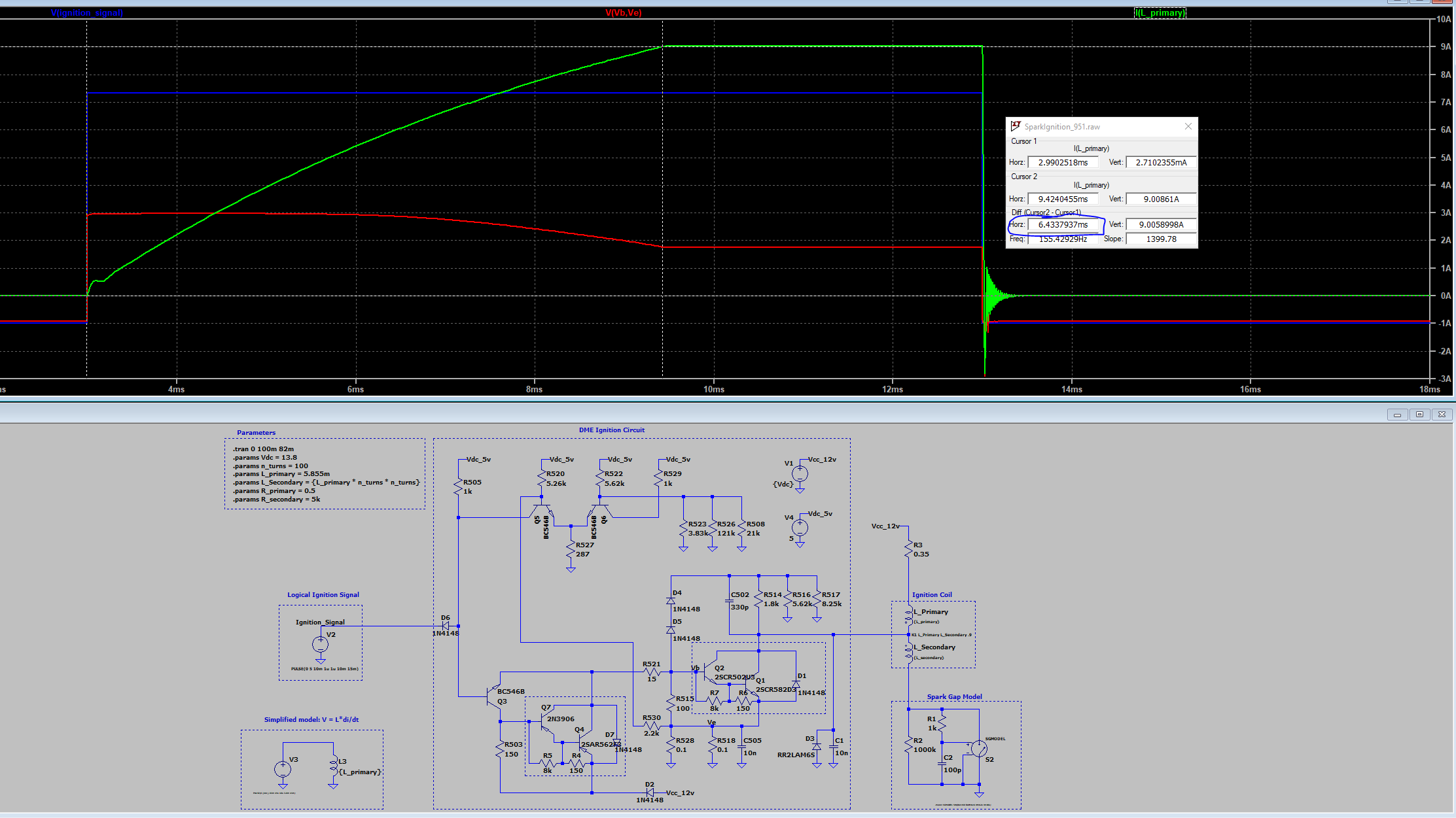

I took a look at your comments on my old ignition / coil tech thread. Your conclusion is wrong.
Using just V = L di/dt ignores resistances and other voltage drops, which in a 12v system is going to significantly change the result.
In particular, there is a significant voltage drop across the Darlington transistor driving the coil. There are connector and line resistances. There is also discrete resistors in the low-side path in the DME.
When I tested the coils, I tested them at the various voltages in the table's columns, 6.0 8.0 10.0 12.0 14.0 16.0 16.4 volts.
I even built an replica circuit in LTspice:
This very closely matches with what I measured. I tried reducing the resistances, but it still won't charge as fast as your measurement.
My conclusion is that your coil has less inductance compared to what I measured for the stock coils.
Additionally, the time to charge is not 1/(2*rpm/60). This affords no time for the coil to actually discharge and the circuit to stop ringing. Typically, a 1mS 'blanking window' should be applied to account for this time.

Rogue_Ant wrote: Mon Sep 29, 2025 8:26 pm @johnb
Thanks for the reply! It's odd that my measurements don't match then - my coil (and entire car) are stock. I don't have the ability to measure the inductance, so maybe it is off.
But another thing that made me think something had to be wrong was the dwell times. If it takes 6.5ms to fully charge the coil, why doesn't the dwell map use that time when it's available? If I read the dwell map correctly, the time drops below that 6.5ms once you get above 500rpm or so, even though there's plenty of available time up to 4000rpm and beyond (for typical running voltages).
