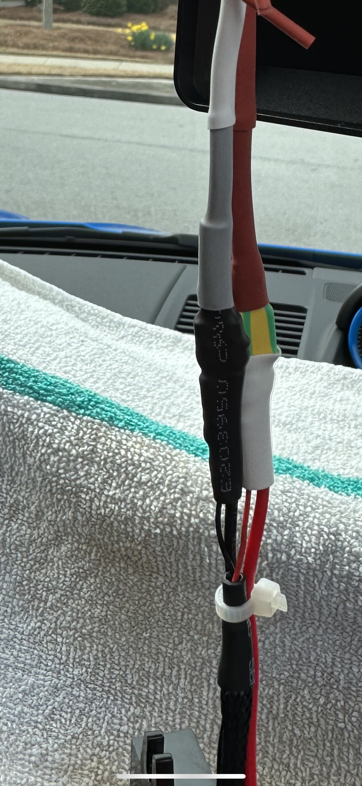

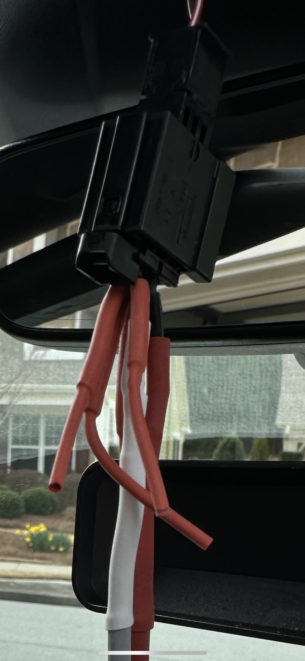

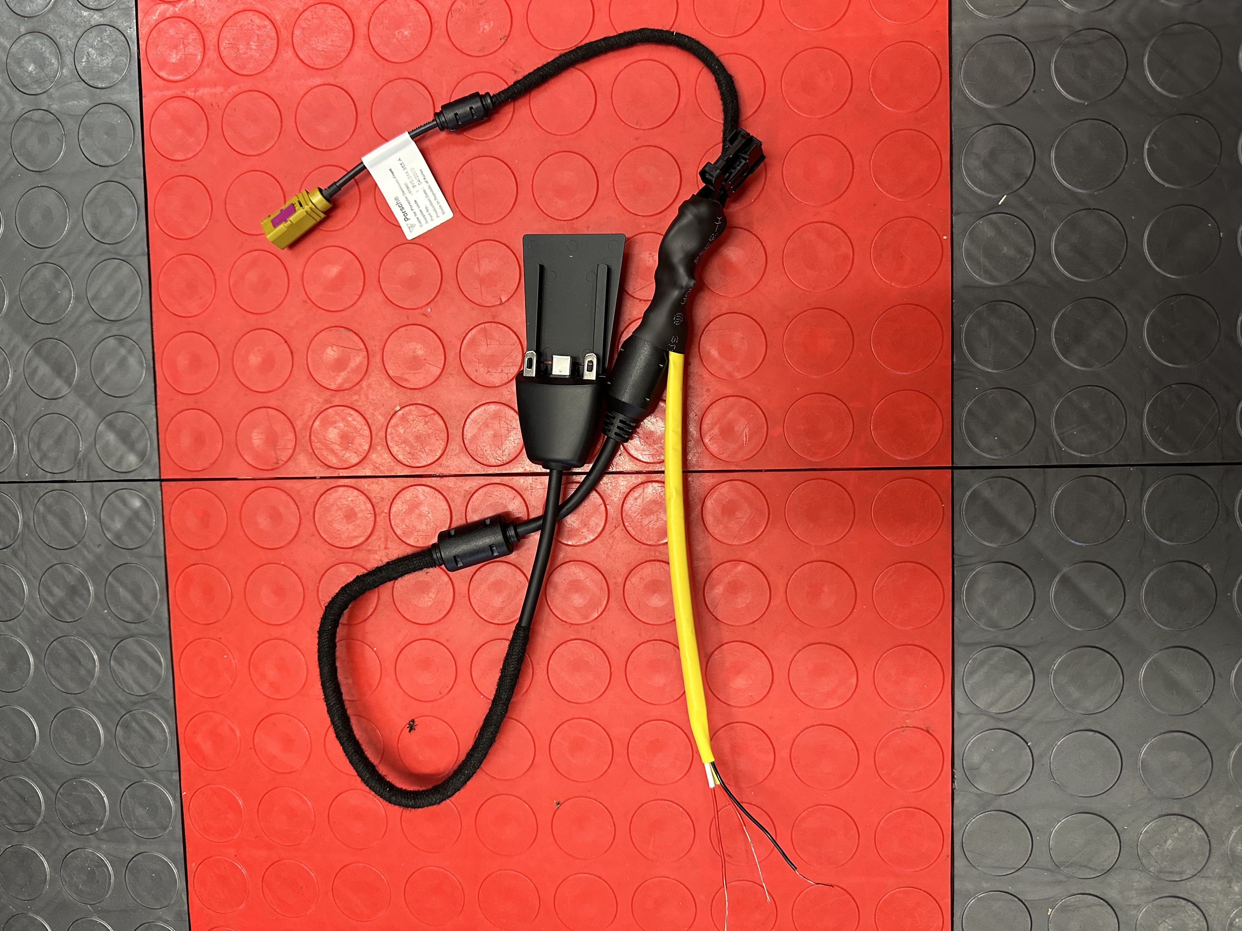

so here is my modified wiring harness which plugs into the Porsche Dashcam prewiring.
It will supply switched and constant 12v and ground. These are the 3 wires appearing out of the yellow sleeve. I will use the switched 12v for my radar detector. I need to test the usb C connector on the Porsche camera dock to determine what is the output voltage - if it is switched 5v I will be able to connect an aftermarket dash cam to dock connector with a usb C to micro usb cable.
For some reason there’s a video output as part of the harness - I don’t know where this connects in the car - if at all ???

Thanks for sharing more details on this as your venture continues.audi4t wrote: Sat Feb 25, 2023 7:32 am so here is my modified wiring harness which plugs into the Porsche Dashcam prewiring.
For some reason there’s a video output as part of the harness - I don’t know where this connects in the car - if at all ???BDFC58F1-30C1-4F79-B734-B724BE1EEDEB.jpeg

I specified my cabriolet with the dash cam prewiring which provides a connector behind the overhead courtesy light panel. The connector has a ground, switched 12v and permanent 12v source.
My original plan was to install the Porsche OEM camera harness, which I purchased. A couple of issues caused my plans to change.
The cabriolet has very limited space behind the courtesy light compared with the coupe since the cabriolet latching mechanism takes up a chunk of space in this area.
I could have packed the harness in the space under the plastic cover, below the courtesy light, but I chose not to since I don't plan on using the Porsche OEM camera.
I also determined that the camera dock for the Porsche camera, in typical Porsche fashion, uses a proprietary connector not a USB C connector, so I couldn't use the dock to supply an aftermarket dash cam.
So I hacked off the male connector from the Porsche wiring harness I purchased and used this to connect the female connector behind the courtesy light panel. I used this to provide switched 12v to my radar detector and to a 12v to 5v converter which will power my aftermarket 70Mai dash cam.

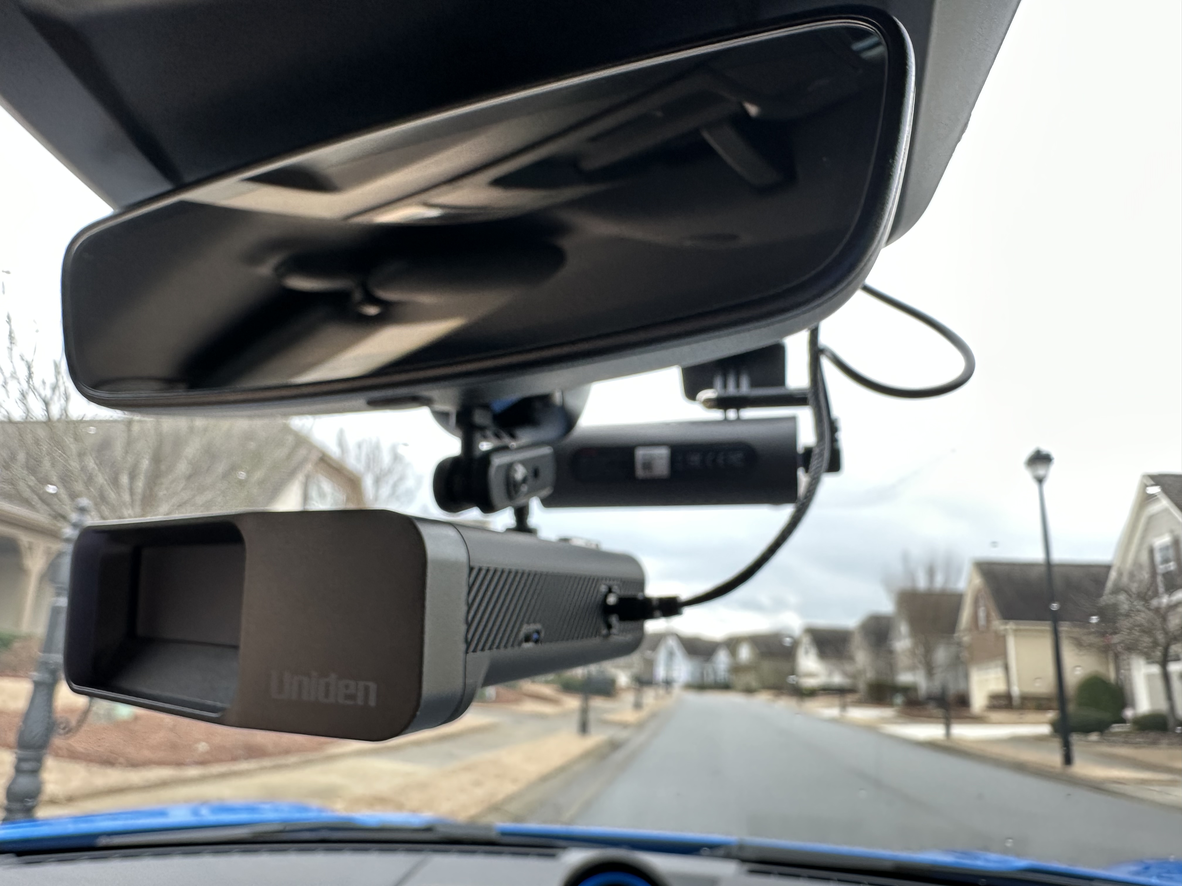

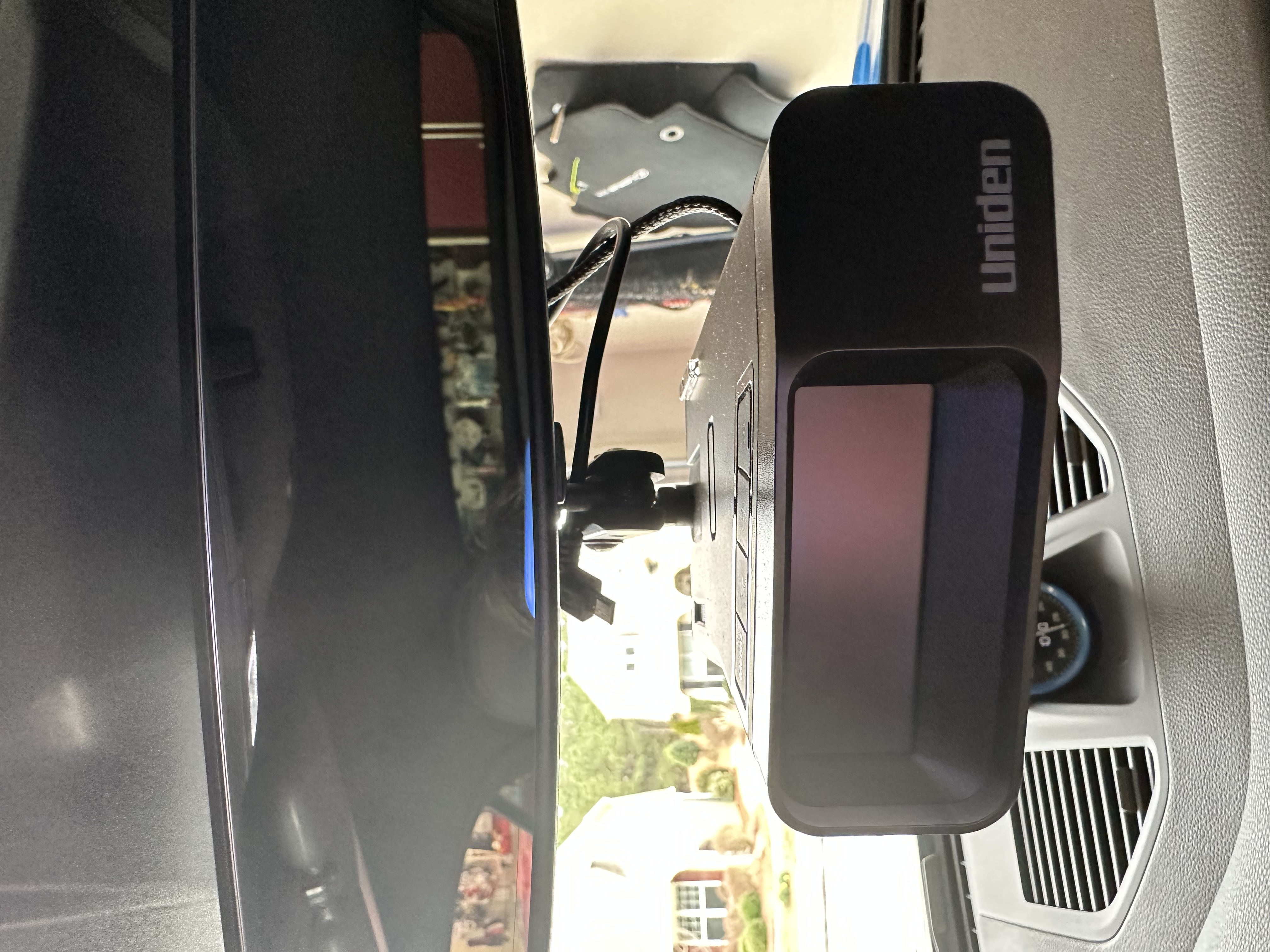

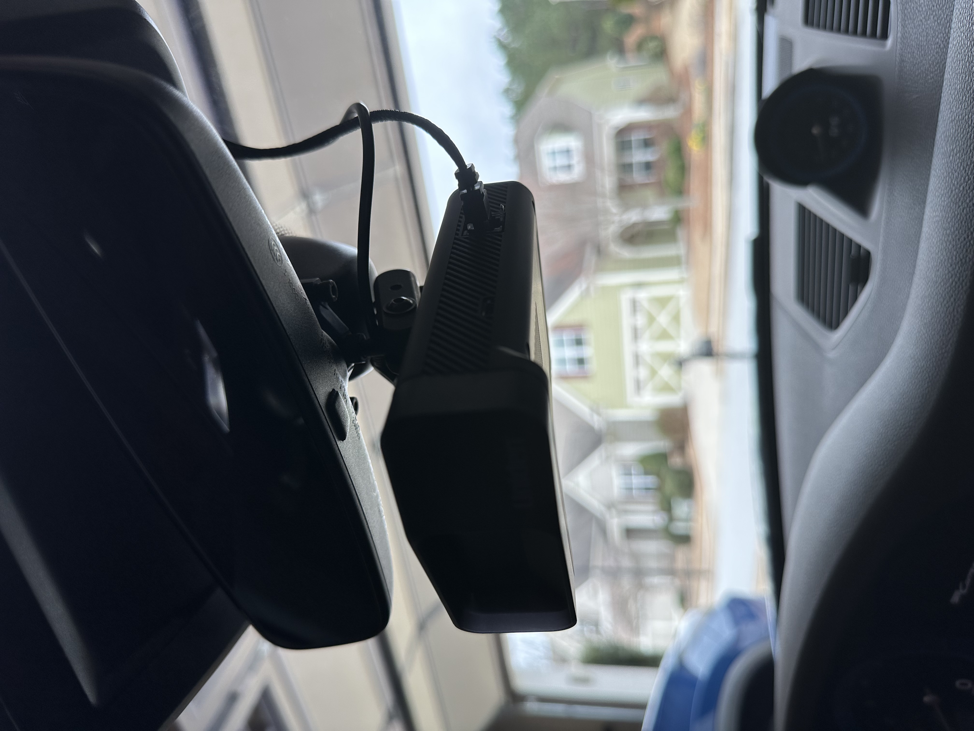

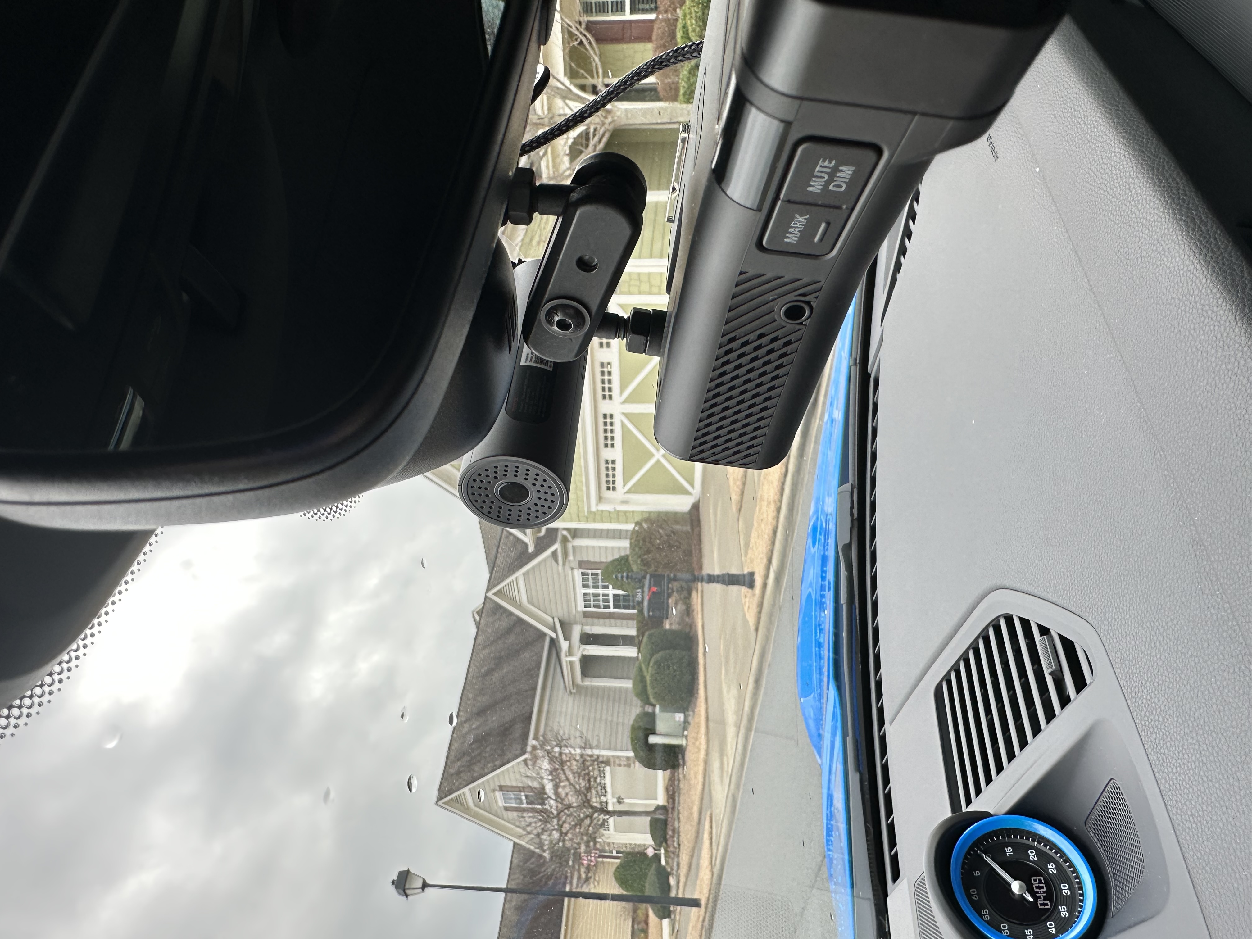

Here’s my 70mai dash cam mounted on the windshield in front of the radar detector.
- Posts: 6179
- Has thanked: 4522 times
- Been thanked: 2452 times
I see a blue bezel that's lookin' good!audi4t wrote: Wed Mar 01, 2023 9:39 am Here’s my 70mai dash cam mounted on the windshield in front of the radar detector.
