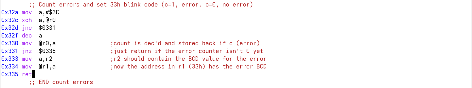

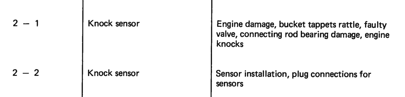

Slight correction, you would be getting the knock sensor installation blink code, not the noisy engine one. Here's what I've come up with after a quick look. The register r2 holds the blink code value which you can just read off as 2 hex digits - in other words when r2=22, that corresponds to the blink code 2 - 2 as seen in the documentation.
So it looks like 119 is the minimum threshold for the knock sensor signal - any higher than that (i.e. weaker signal) and the KLR assumes the sensor is not connected.
Then 5 is the max - any lower than that (i.e a stronger signal) and the engine is too noisy
Here's the code that effectively decides whether to trigger a blink code - if carry is not set then it doesn't do anything:
Relevant blink codes:

Thanks for that. I guess getting the blink codes to do the right thing in simulation is a good way to test my simulator.johnb wrote: Sat Feb 07, 2026 3:17 pm Slight correction, you would be getting the knock sensor installation blink code, not the noisy engine one. Here's what I've come up with after a quick look. The register r2 holds the blink code value which you can just read off as 2 hex digits - in other words when r2=22, that corresponds to the blink code 2 - 2 as seen in the documentation.
The blink code output was entirely wrong. There were random timings between the on and off edges.
Whilst stepping through the 8048 code you mentioned, I saw that the timer interrupts were failing sometimes. It turns out the 8048 core simulation I got off the internet wasn't entirely correct. I fixed two bugs but was still concerned about the quality of that code. So, after some work, I'm now using the latest 8048 simulation code from MAME, but cut-down to make it do only what is needed for this project. The MAME code looks a lot more likely to be correct (enough).
Now I get more sensible blink code output. Still not convinced its right.

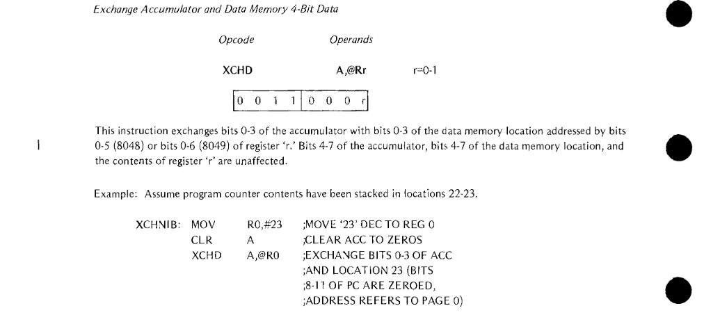

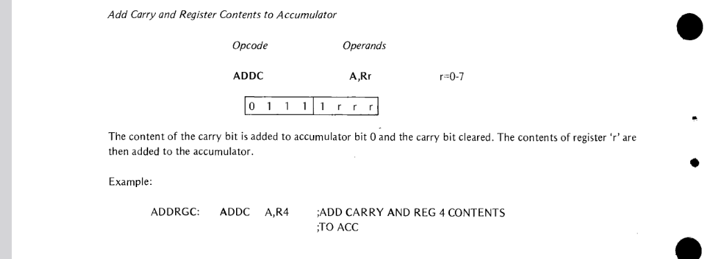

EDIT, nevermind, I checked the KLR code and it has 31 at 9B so I checked it in the instruction reference[1]:
and
So 31 is xchd a, @r1
[1] https://jhnbyrn.github.io/951-KLR-PAGES ... _Dec78.pdf
