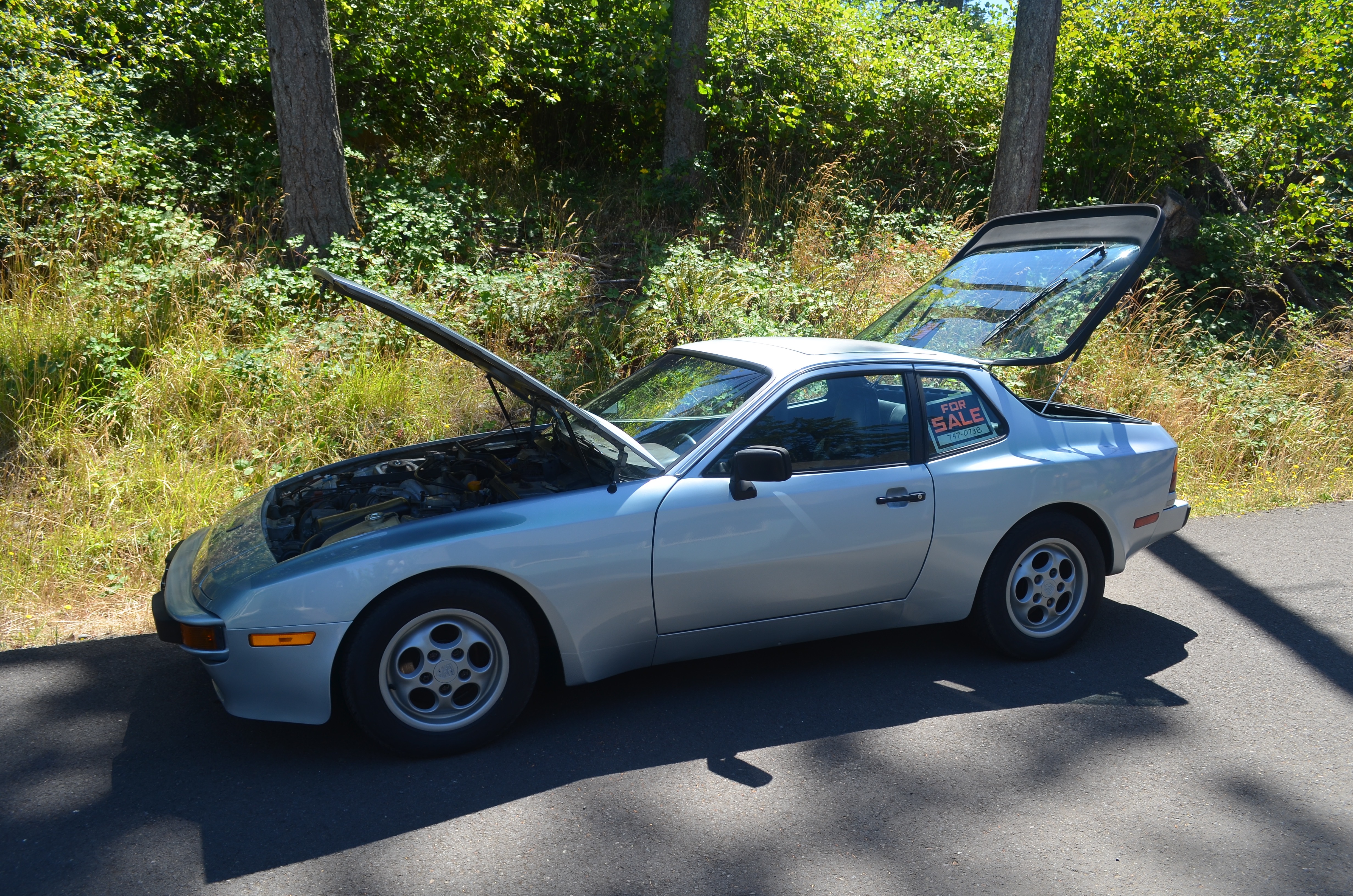

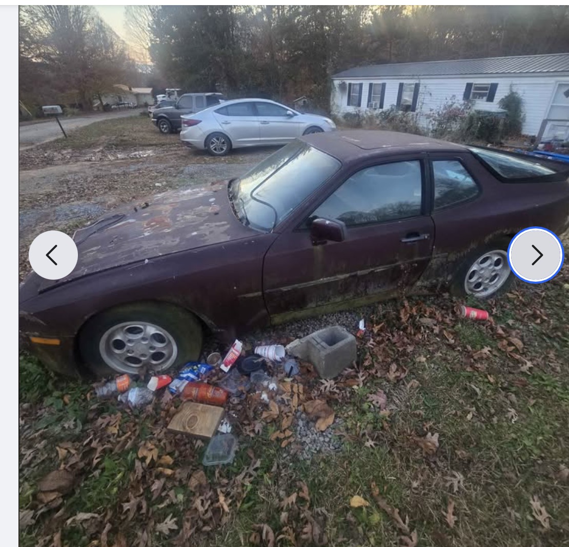

I compared the pictures in the ad to the pictures I took of my former 944, and I'm pretty sure those are early offset phone dials. Definitely looks to have deeper lips than the later offset that I swapped onto my '84 using some big spacers. Note the different contours around the holes as well.dlarsen944 wrote: Sat Jan 03, 2026 10:13 am From the pictures of the rims/wheels, the 1987 model year of a different wheel offset then the 85.5/86 model year. I believe its a 1987. The Porsche sticker on the drivers side door jam would specific the month/year of manufacture.

I thought the same based on how my 86 rear wheels are set in a bit on the rear. Same as that pic. Why didn't Porsche make them more flush? Trust the engineers I guessArne2 wrote: Sat Jan 03, 2026 5:04 pmI compared the pictures in the ad to the pictures I took of my former 944, and I'm pretty sure those are early offset phone dials. Definitely looks to have deeper lips than the later offset that I swapped onto my '84 using some big spacers. Note the different contours around the holes as well.dlarsen944 wrote: Sat Jan 03, 2026 10:13 am From the pictures of the rims/wheels, the 1987 model year of a different wheel offset then the 85.5/86 model year. I believe its a 1987. The Porsche sticker on the drivers side door jam would specific the month/year of manufacture.

Rear fenders were sized to cover 8" wide Fuchs. The 7" phone dials sit a full inch (25mm) deeper in the fender. Adding 25mm spacers on the rear only makes a big difference in appearance.PSU_Crash wrote: Sat Jan 03, 2026 9:50 pmI thought the same based on how my 86 rear wheels are set in a bit on the rear. Same as that pic. Why didn't Porsche make them more flush? Trust the engineers I guessArne2 wrote: Sat Jan 03, 2026 5:04 pmI compared the pictures in the ad to the pictures I took of my former 944, and I'm pretty sure those are early offset phone dials. Definitely looks to have deeper lips than the later offset that I swapped onto my '84 using some big spacers. Note the different contours around the holes as well.dlarsen944 wrote: Sat Jan 03, 2026 10:13 am From the pictures of the rims/wheels, the 1987 model year of a different wheel offset then the 85.5/86 model year. I believe its a 1987. The Porsche sticker on the drivers side door jam would specific the month/year of manufacture.

When I went from Fuchs to the late offset dials I had to put on 25mm spacers in front and 50mm in back to fill the fenders.

That makes sense. A crude measurement shows i'm about an inch shy of being flush in the rear. Although, I don't know that my Fuchs are the early offset either.Arne2 wrote: Sat Jan 03, 2026 9:56 pm
I was able contact the seller last night, or at least the guy who made the listing, and told him his brother ghosted me. I got some BS story about his phone being dead and he would "probably" be in touch this morning. Nothing. So that's that. I guess I won't be picking this up after all. Why list a car if you aren't interested in answering calls and texts from a guy who tells you the trailer is hooked up has cash in hand? Frustrating. At this point the only thing left to do is leave seller feedback.

No such thing as late offset Fuchs. If your rears are inside the fender that far, they are probably 7", same as the fronts.PSU_Crash wrote: Sun Jan 04, 2026 4:14 pm Although, I don't know that my Fuchs are the early offset either.

They are indeed 7s. Well now I have another item to add to the list. 8" early offset fuchs in gold
