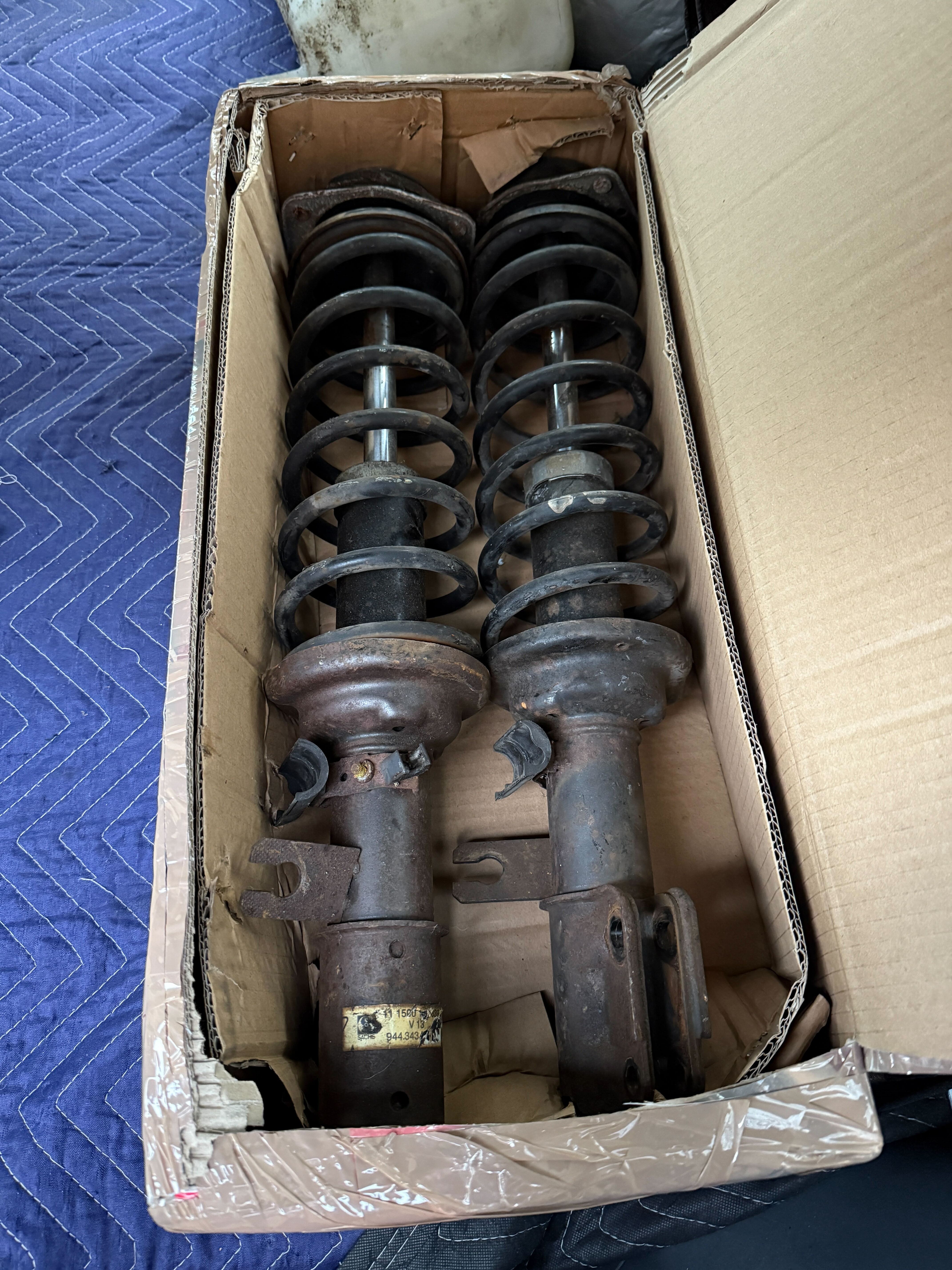

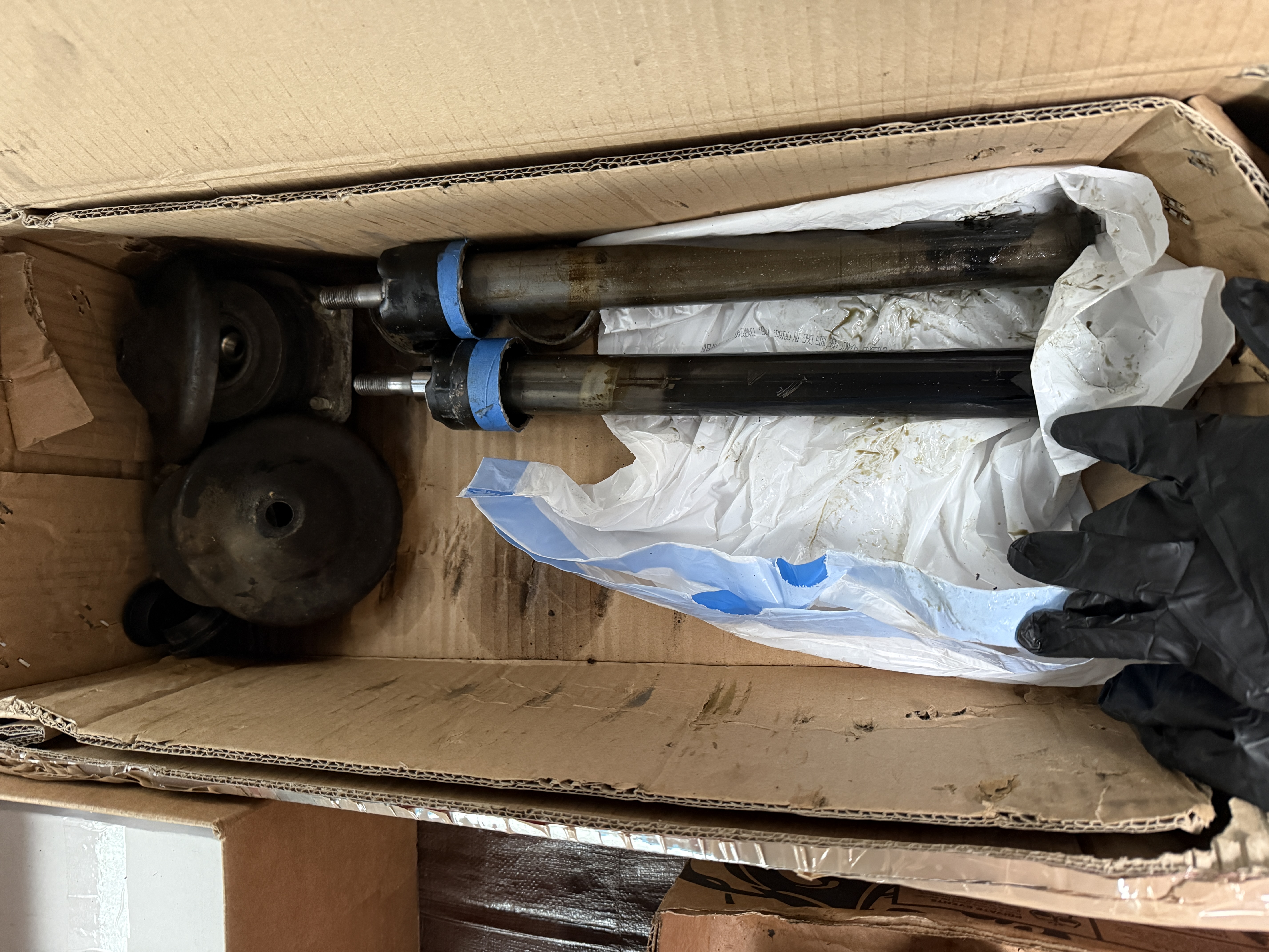

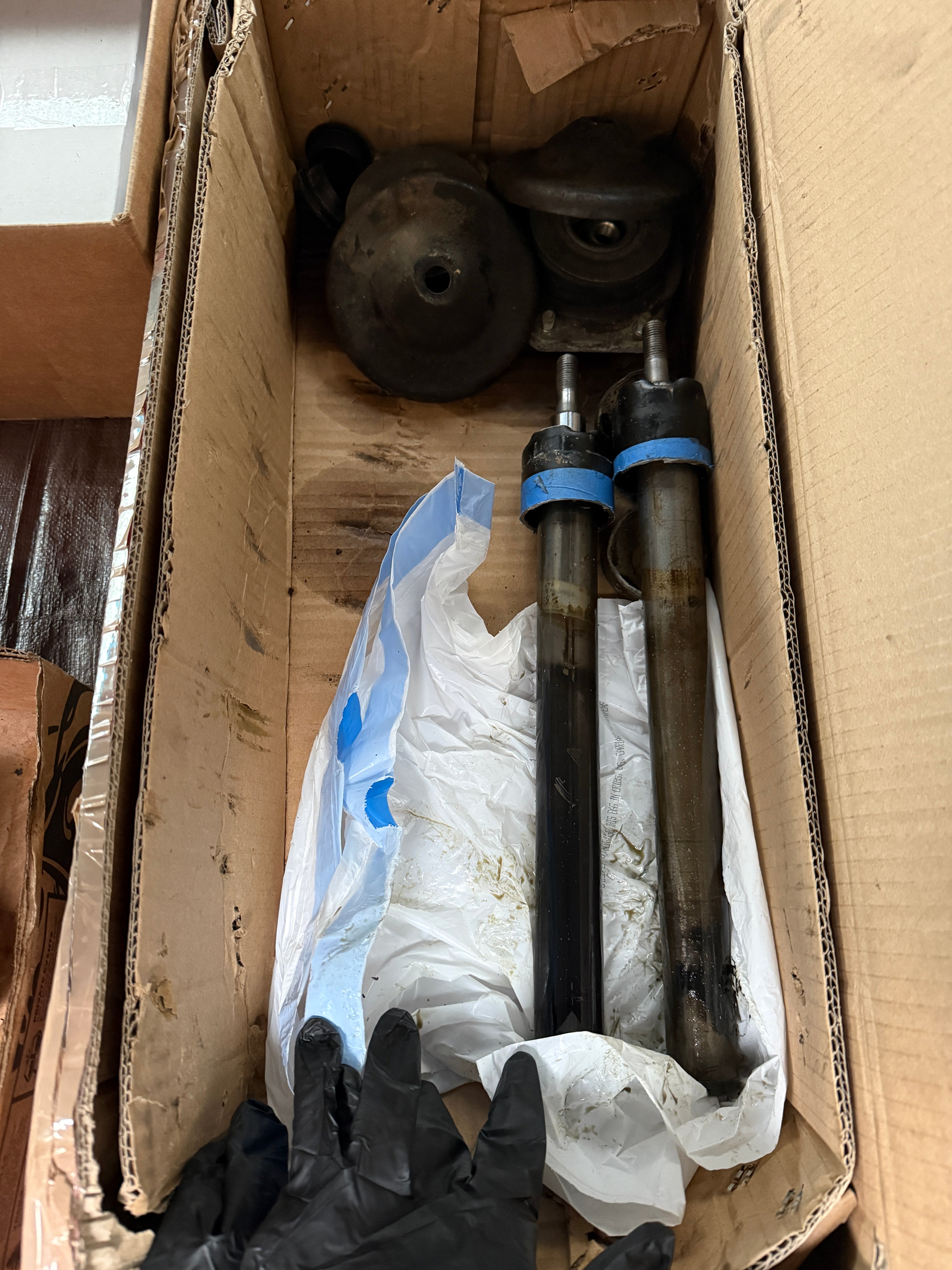

Small update, after much thought, I'm going to rebuild a set of struts with koni inserts. Mainly because I saw this decent donor set that is a match to whats in my car. I'll post some updates as I go.

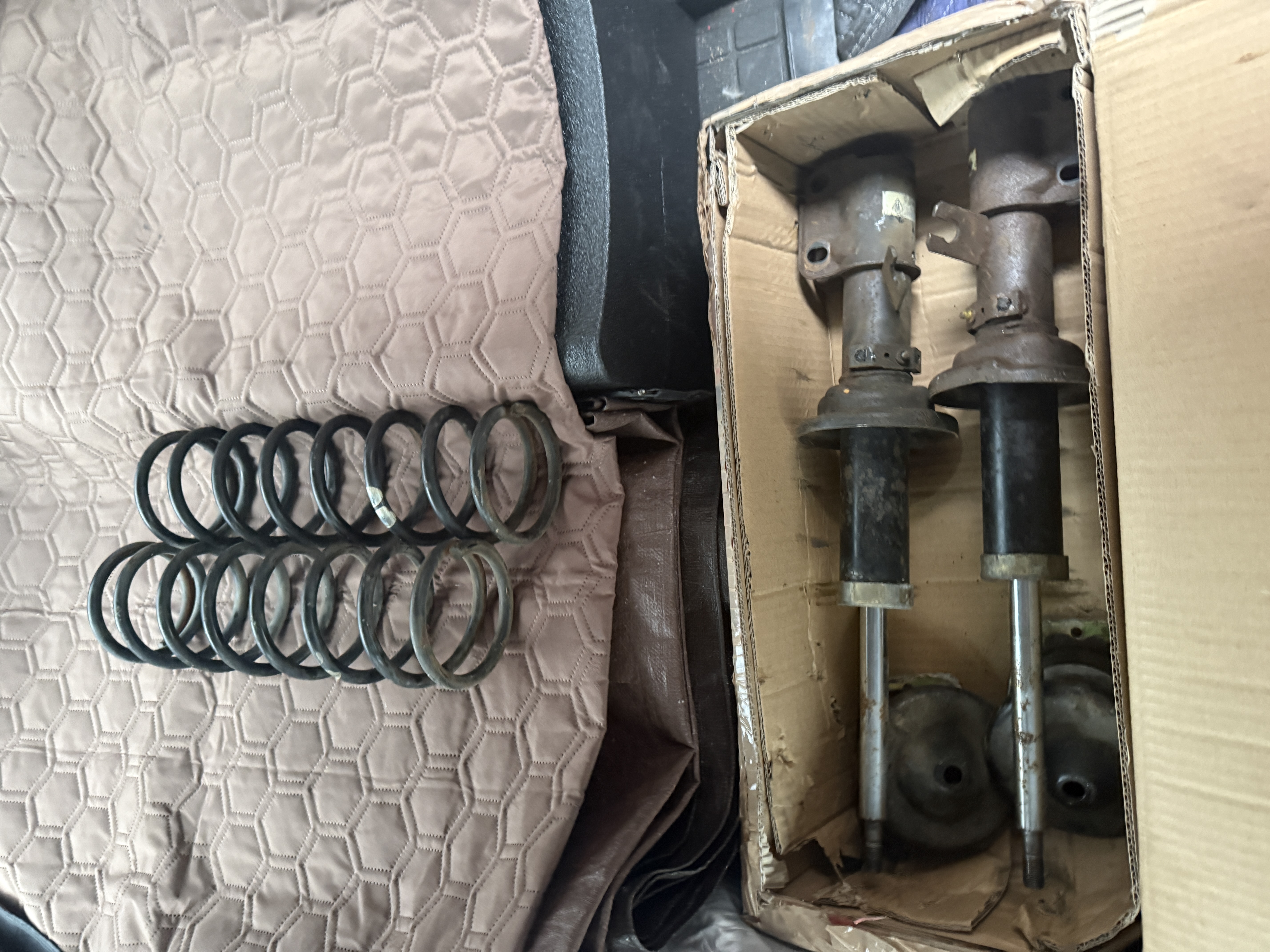

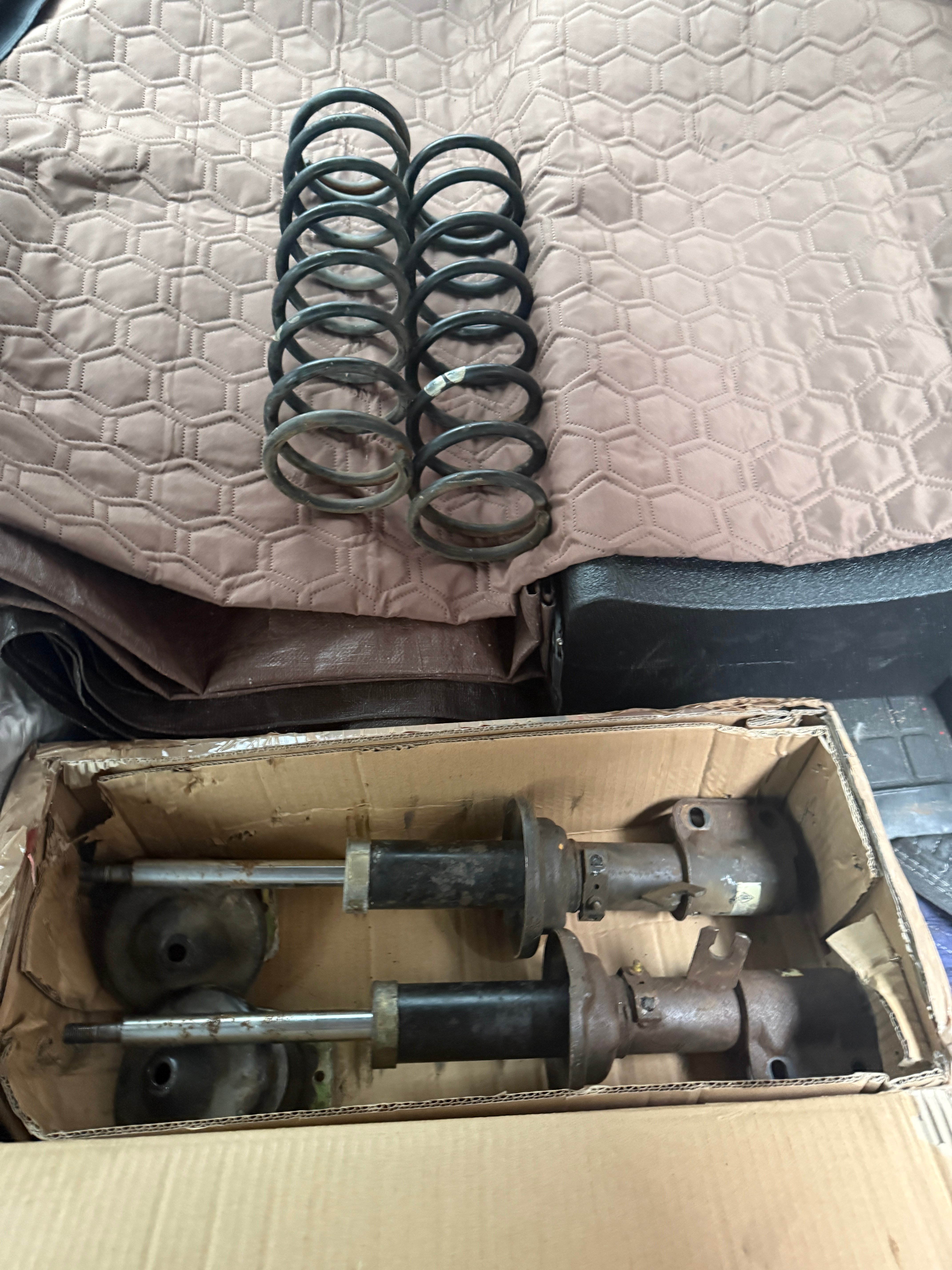

Small update, but a big victory for my garage-less butt. Struts ready to be cut.
Im planning on keeping the springs and painting them. Anyone done this? Hows the paint hold up?
How are stock springs? They hold up well? Are these likely tired? They seem fine to me.

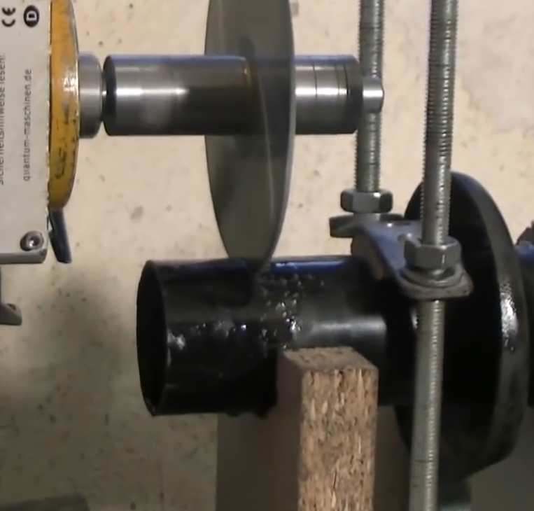

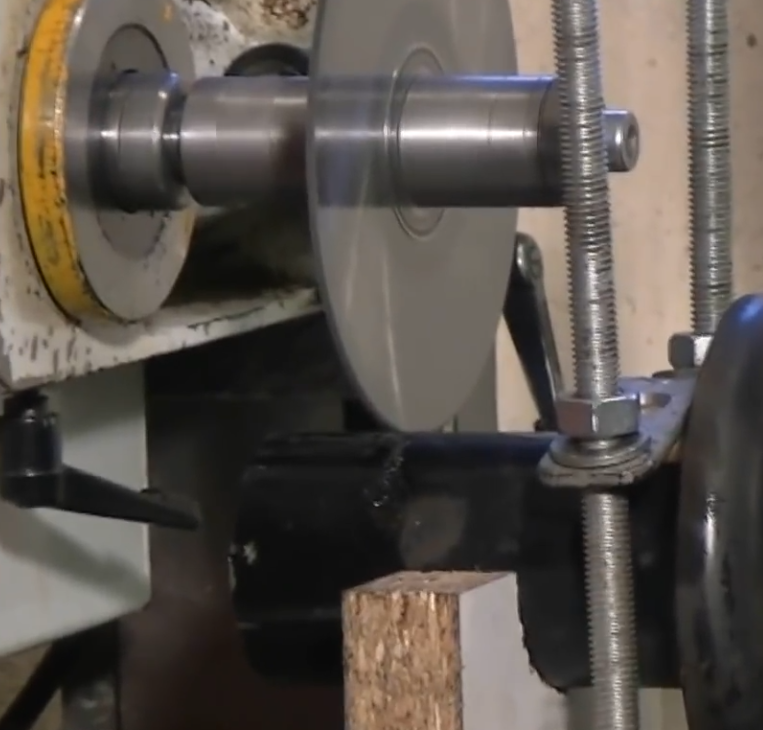

I'm at the point where I need to decide and I think I'm sold on the Bilstein conversion. I watched the video and have a question if you or anyone has an answer.

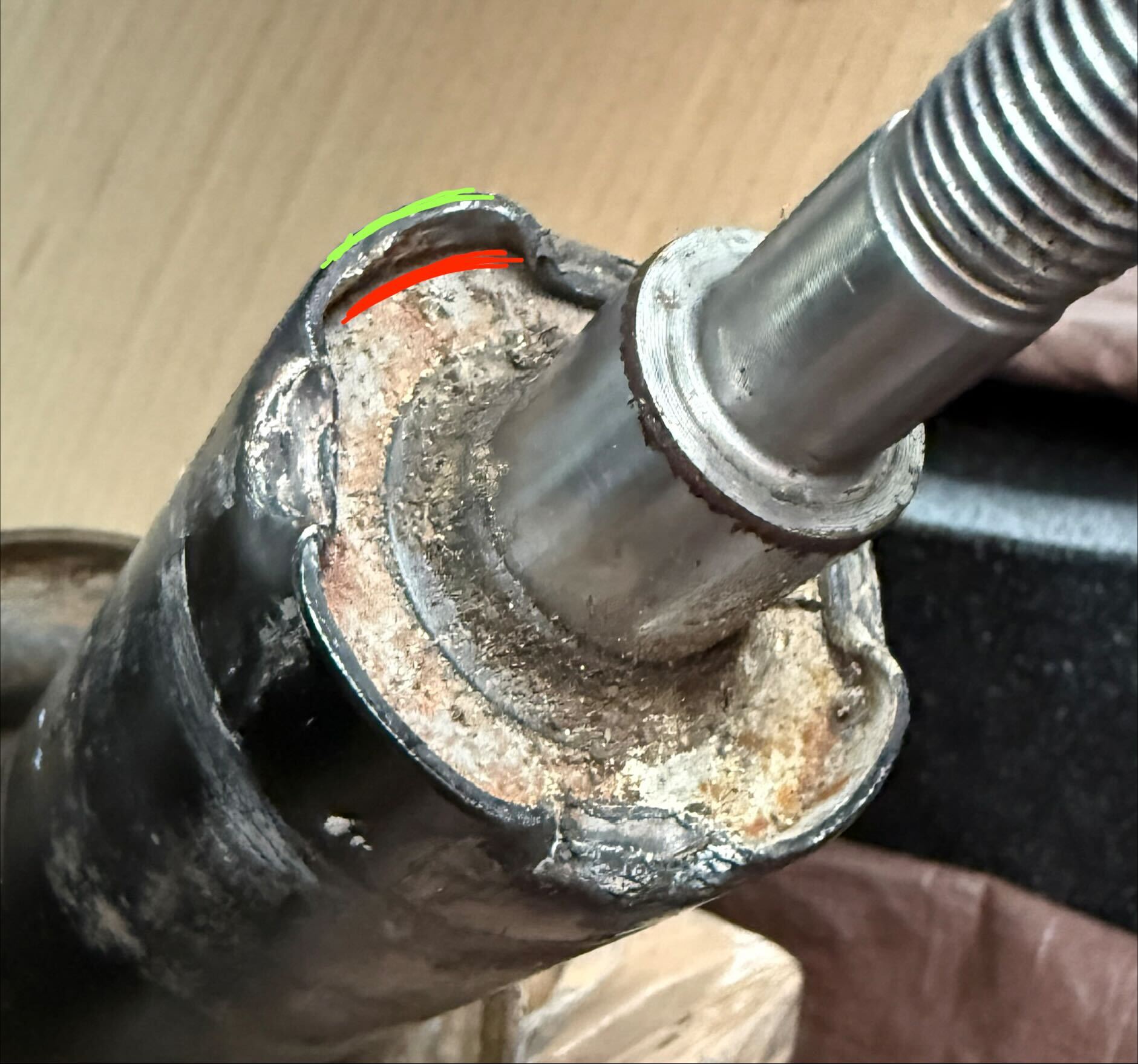

It is hard to tell from the video where he is measuring 44.5mm from. It looks like he has maybe even removed a little bit of the top where the crimped metal is?

I would like to spare myself the fight with the crimps and just remove the top 1-2mm, then reduce down another 44.5mm form there.
Question really is, should I measure from the green line or the red?

Found this for the record :)
https://forums.tipec.net/viewtopic.php?f=25&t=23096
Seems like from the "red" line.

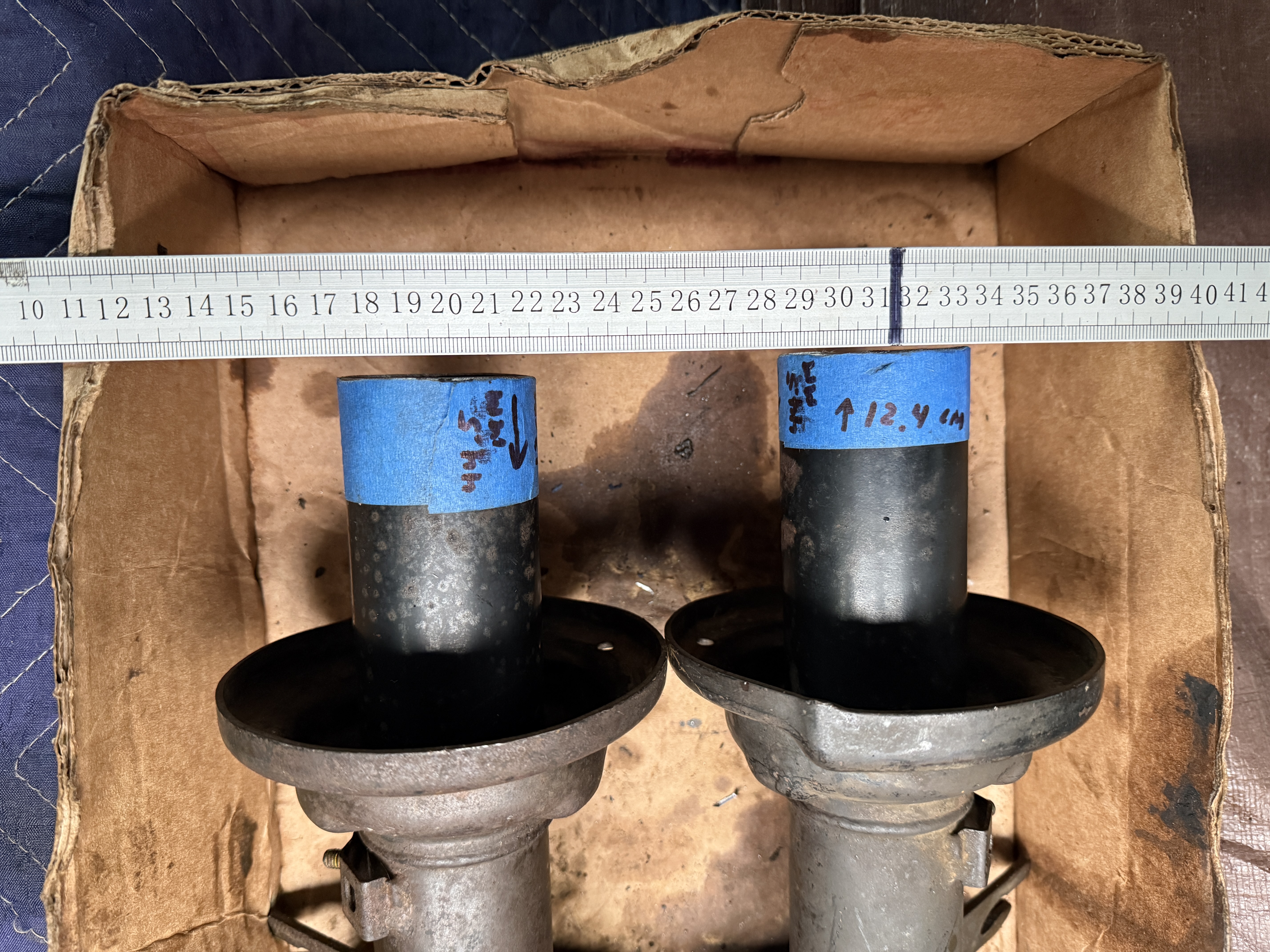

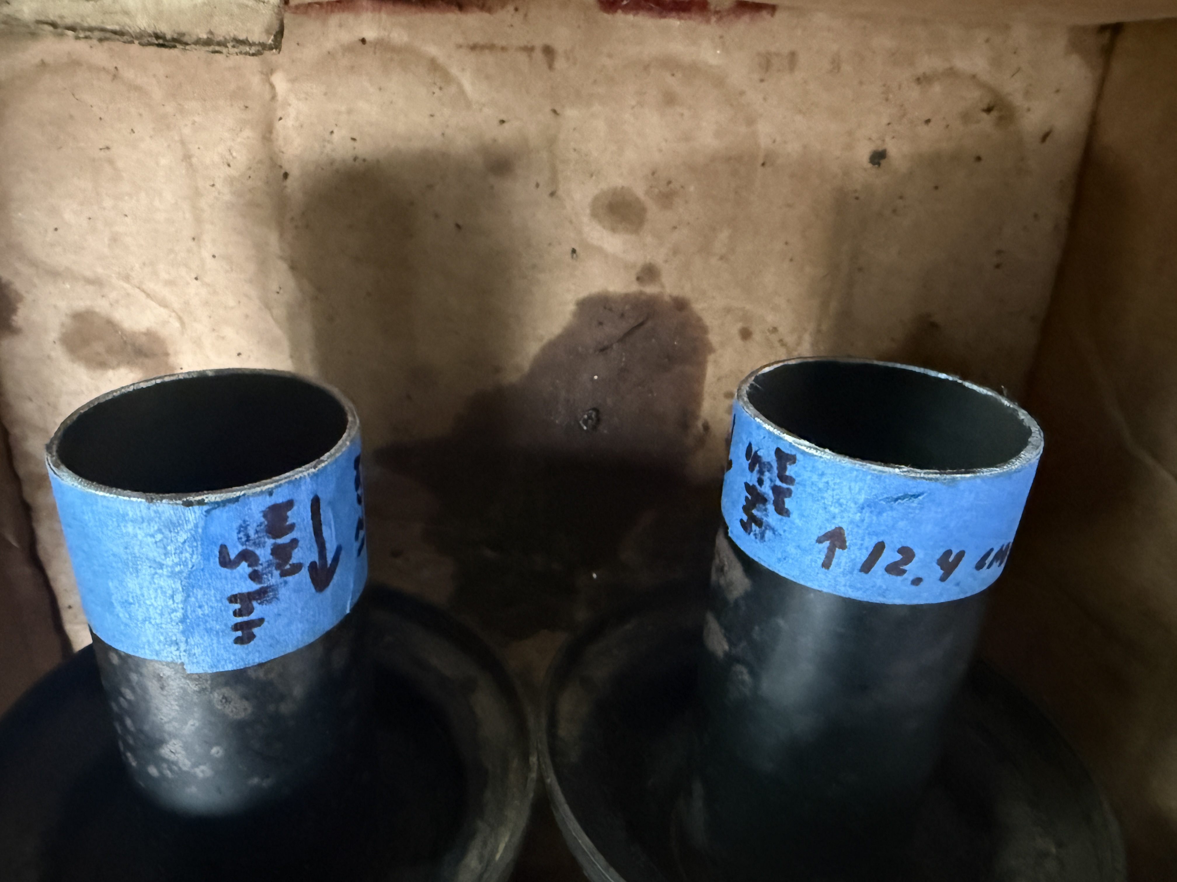

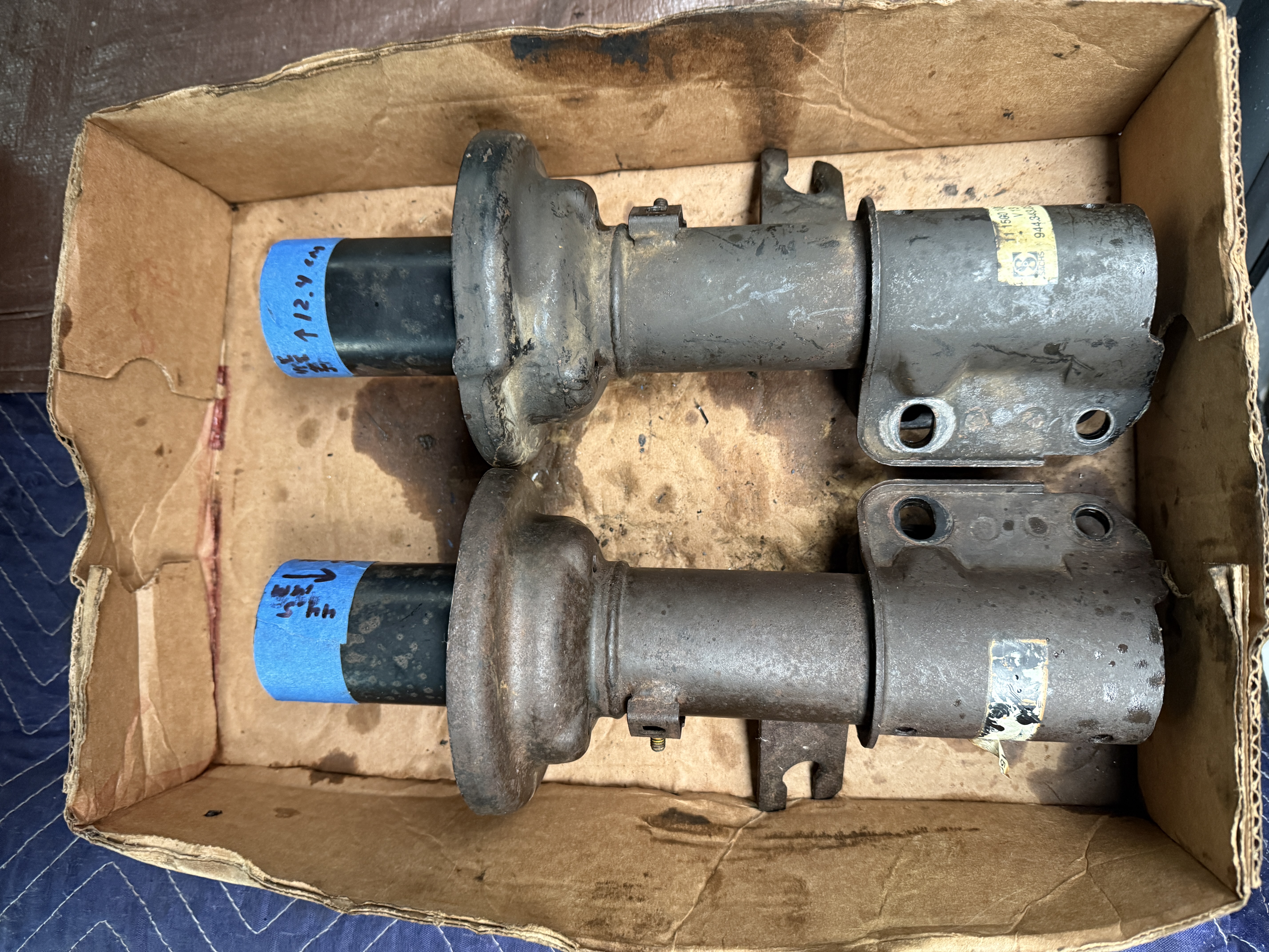

The struts are cut.
The cuts are pretty straight and I triple checked the measurements. Still ended up not the same height.
Rechecking the tops, both within 1-1.5mm from 44.5mm.
Update: Spoke to my friend and he recommended measuring spindle mount center to cut, where I get 27 and 27.1cm -- Once I get the Bilsteins in, I'll test fit everything and post another update.
