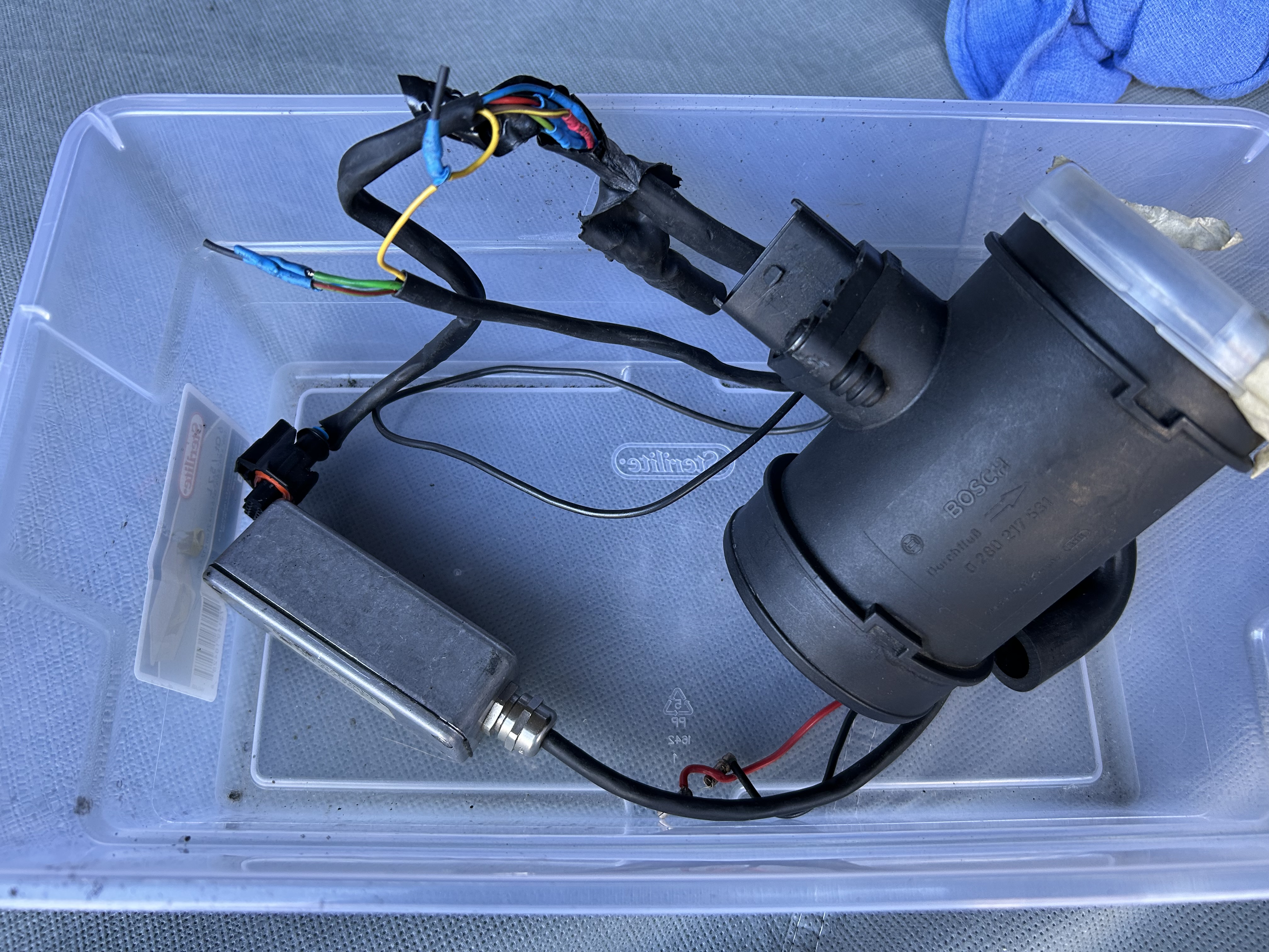

I stumbled on this little plastic box as I was taking my spare parts out. My old MAF. The harness got tangled up several years ago but I kept it. I put it on and BAM. Started like a champ.
Do t want to get too excited just yet since I do have to put everything back together.

Awesome. What's the box do??

I’ve never opened it. This was the first run of the Scivision MAF from the UK. The newer ones was a cleaner cable instead of the box.
