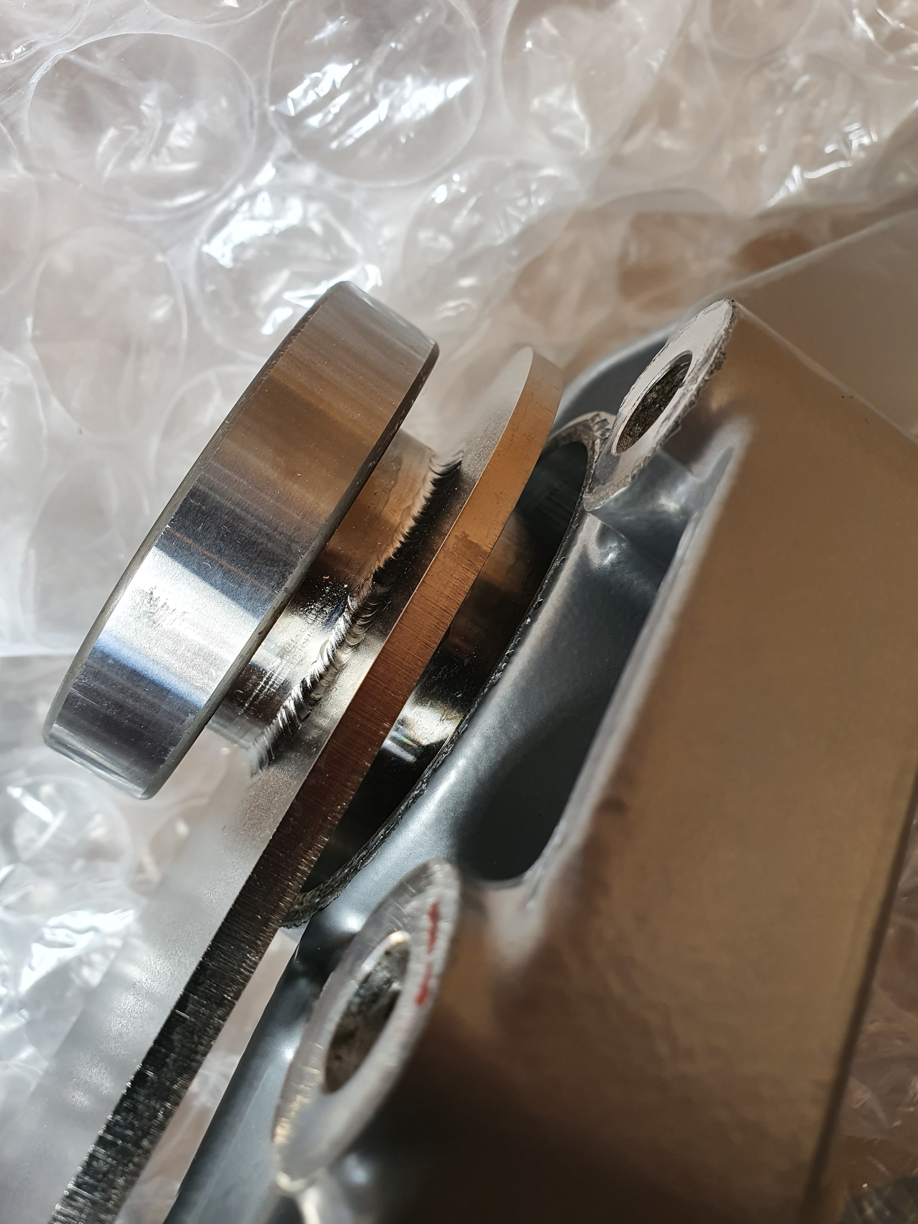

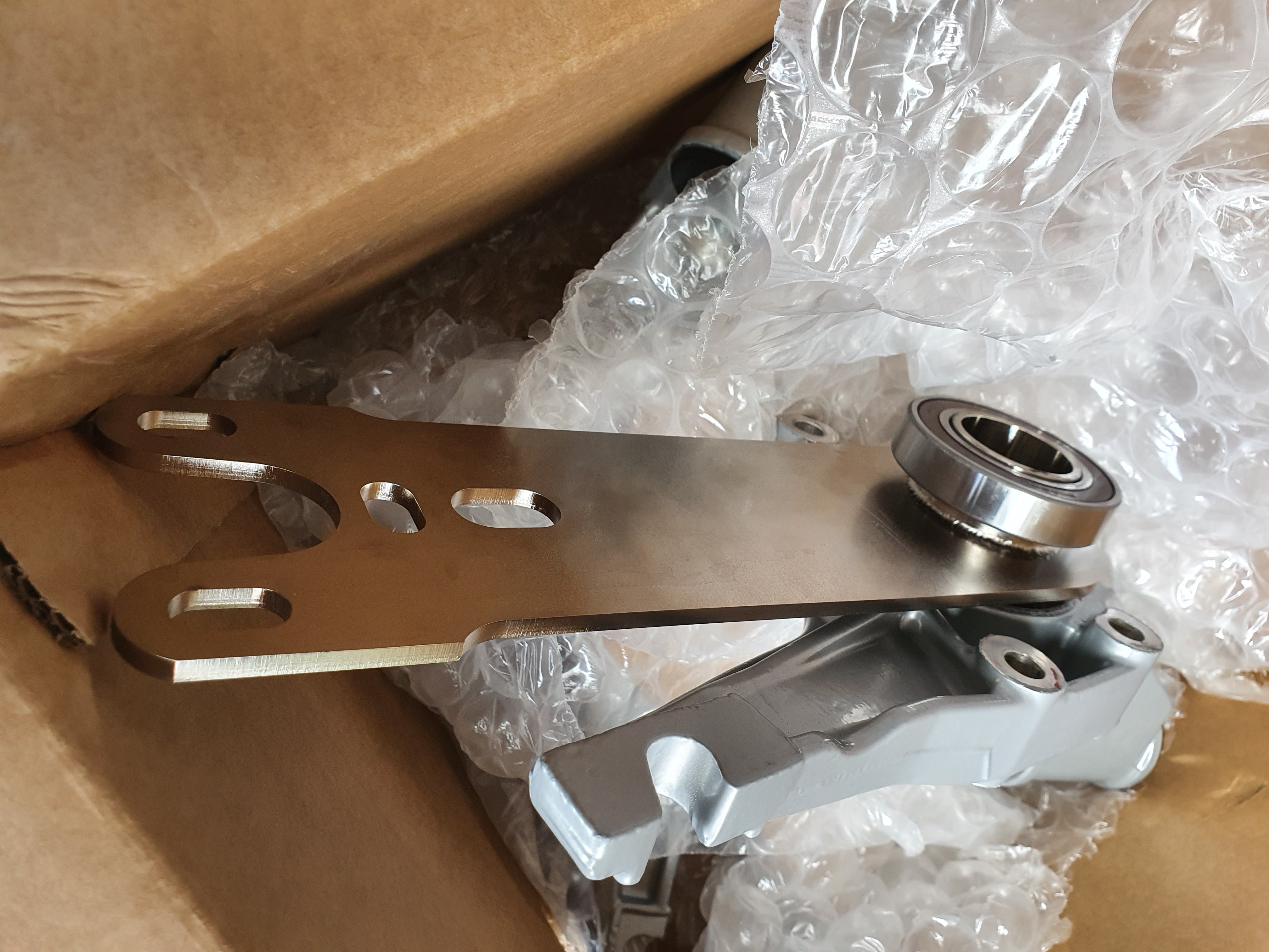

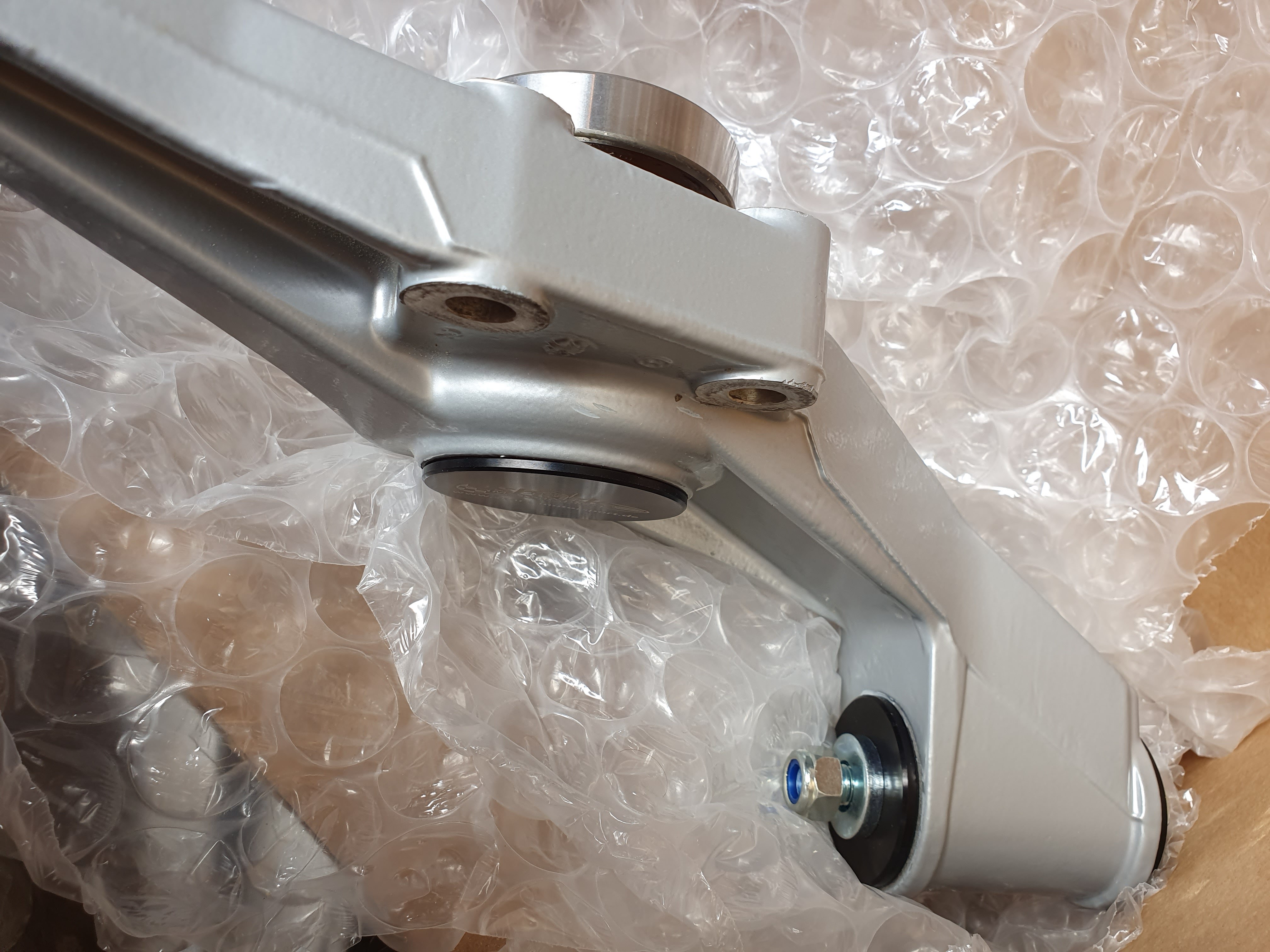

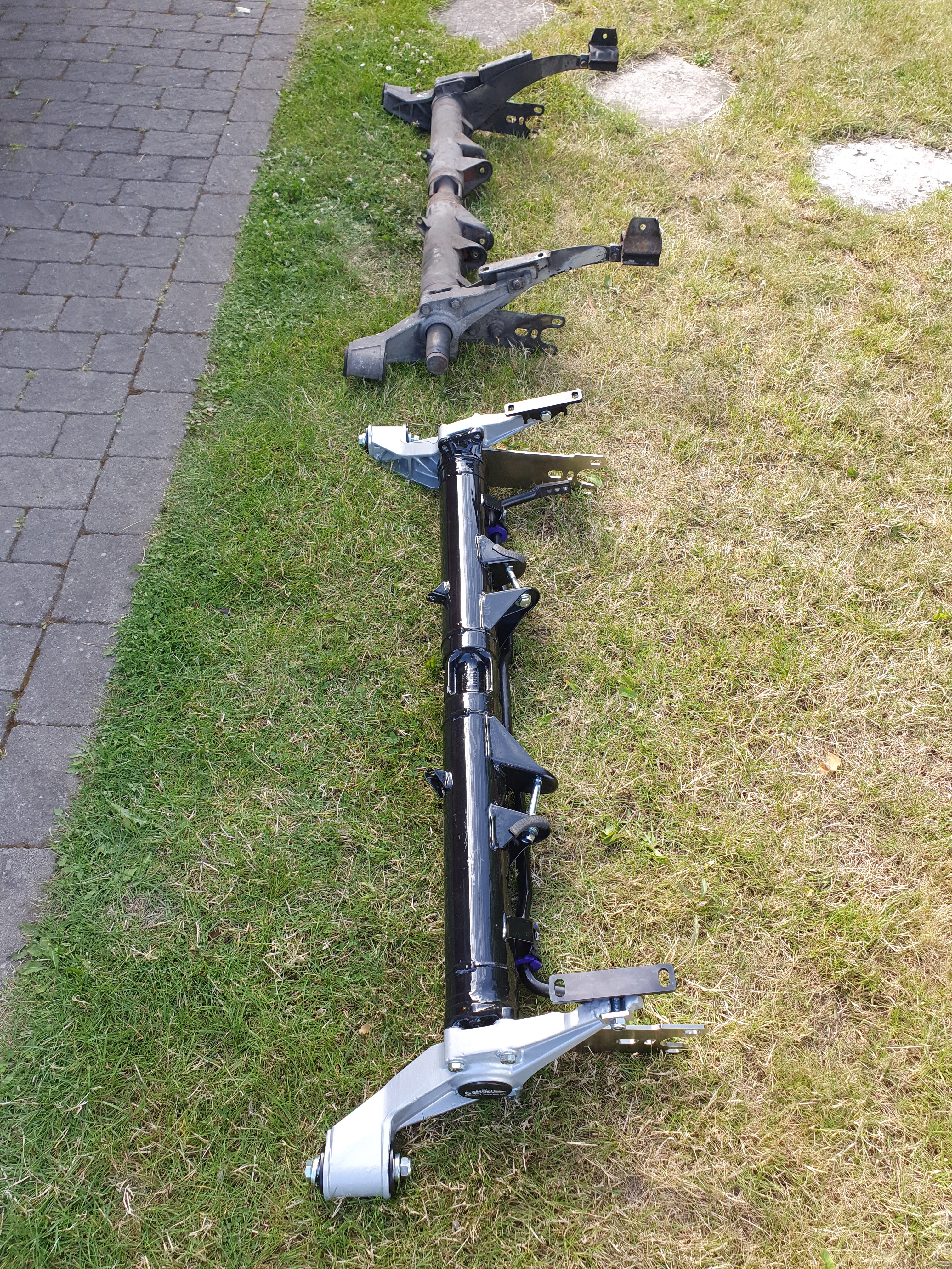

A couple more pics of my rear suspension beam.
Also "all" original rubber bushings are now uniballs.
