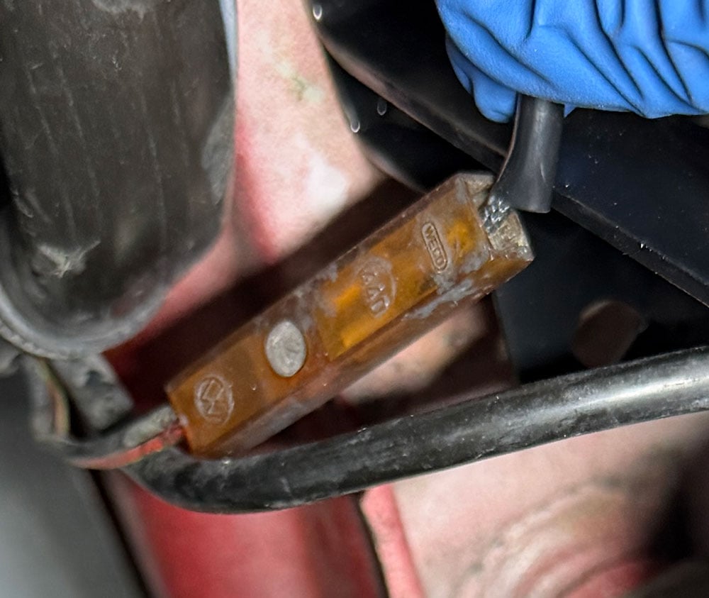

That connector Tom pictures is the same one that's used in the V8 car, and is subject to all kinds of interesting stress and flex in service. On the glove side of the connector in Tom's picture, for instance, you can see where the insulation has been pulled back, and some now-brown copper wire is exposed. This is really common stuff in our well-used cars. I'm all for redoing connections like that, getting back to not-so-oxidized copper and using a crimp-and-shrink terminal with an added layer of adhesive-lined shrink sleeve going back just far enough to be able to grab and pull on it without yanking on the wire insulation. On my car I went through the trouble of rotating the connector sleeve so the wires pass back around it, then a simple zip tie holds the wires and the connector to the harness. Full support, no strain, no flex at the connectors.
The point though is that you are looking for poor connections, a corroded wire, etc., adding resistance in the circuit. So more Ohms when you read the coil, and less current flowing (amps) so less ability to get the clutch engaged. Every element (pressure switch, temperature anti-freeze switch, power supply, control head, relay contacts) and every wire and connector is a possible cause of low current flow available. You get to bypass all those things when you connect a battery-plus wire to the clutch coil side of that connector.
Most electrical troubleshooting is an exercise in dividing the possible causes. For this exercise, the test at the coil terminal immediately determines if it's a supply problem or a coil problem. If it's a coil problem, it gets replaced. If it's a supply problem, we reconnect the coil, and start measuring voltage at each component on the way back towards the battery. At some point the low voltage you'd read at the clutch connection increases to battery voltage. And you've identified the resistance or interruption in current flow. I jump first to the middle of that string of circuit elements to cut the possibilities in half, and than go towards the battery or the clutch depending on what I find. Preference is given to measuring at easy places in the process. But you get the idea. Divide-divide-divide until you find the flow blockage.

Interesting to hear the 928 uses that same spade-connector anti-disassembly device. Any tips for separating the spade without yanking on the wire? If I ever really need to separate it, I'll probably ditch that plastic cover altogether (and just take my lumps with the Pebble Beach judges) in favor of a more serviceable weatherproof connector like a Weather Pack or even Deutsch connector.
In the meantime, horrified by your comment, I went and looked at the connector wiring (which is relatively new from when I changed the compressor this decade) and am happy to report that picture was misleading. It actually has multiple lawyers of protection -- an outer sleeve the fits loosely over wires, and inner nylon braided sheath (which looks like an exposed copper wire but isn't) and a traditional wire with white insulation under the nylon braiding.

Glad to hear you are are a step ahead on the wire protection. To disassemble, I usually reach in with a small hemostat and pull on the exposed copper spade connector where it wraps around the wiring. The only time it comes apart on the 928 is for a timing belt change, so not that often.
The troubleshooting methods are still the same. I can poke a meter probe into that plastic connector to test for voltage there, to see if full battery voltage is making it all the way to the clutch coil when it's supposed to. If it is, and the coil still isn't closing the clutch. I'm looking at the ground side of the coil, and testing resistance through the coil from there to ground. If voltage isn't there, I start with easy stuff like a fuse, then go back through the circuit to find what's blocking current flow.
The clutch coil is an "inductive"" load, so stores some electricity in the generated magnetic field. Sort of like how an ignition coil works. When the supply circuit opens for any reason, the stored field collapses and sends a pulse of current back up the wire towards whatever interrupted the flow. It can arc at that opening contact. For a switch or relay coil, the contact arcing risks building a tiny blob of weld metal, and eventually it's enough to resist the flow of current to the coil. Hence the voltage testing at each element in the circuit, looking perhaps for the one that's suffering from the contact blobs.

As for poking into the connected spade, I did confirm on my car the clutch coil still shows at 2.7 ohms even when everything is connected. My guess is that is all the coil and that the upstream signal is disconnected or high impedance, but I'd need to pull apart the un-pull-apartable spade to really confirm that.
