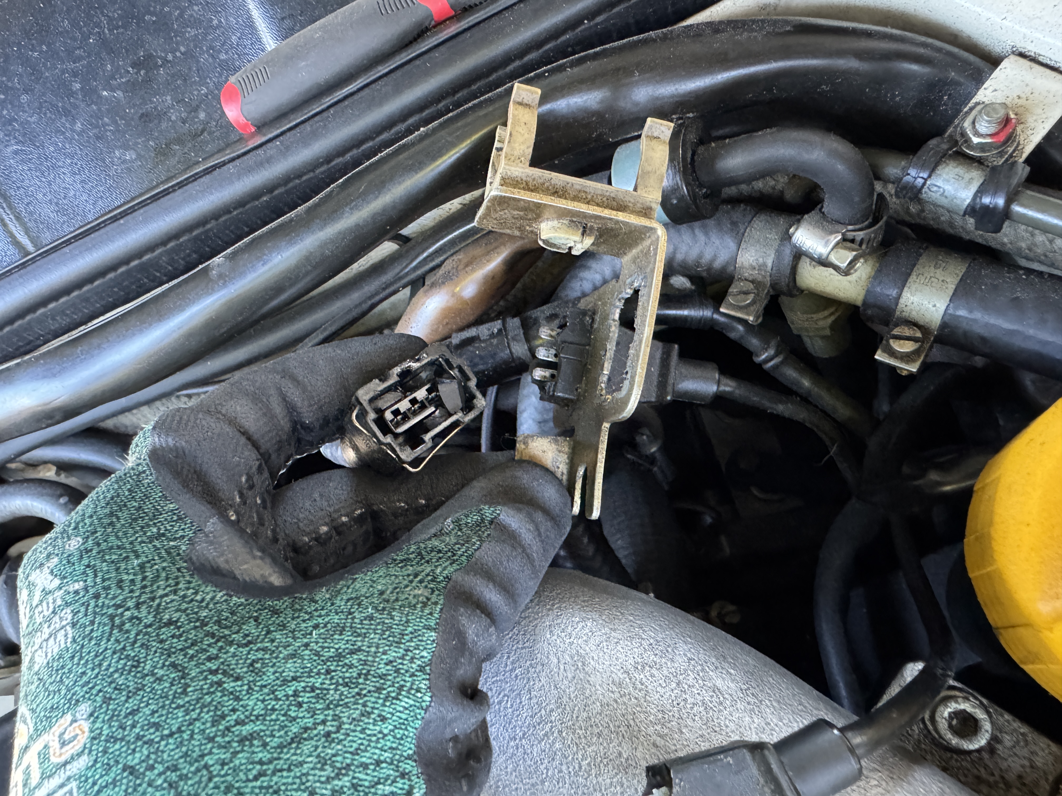

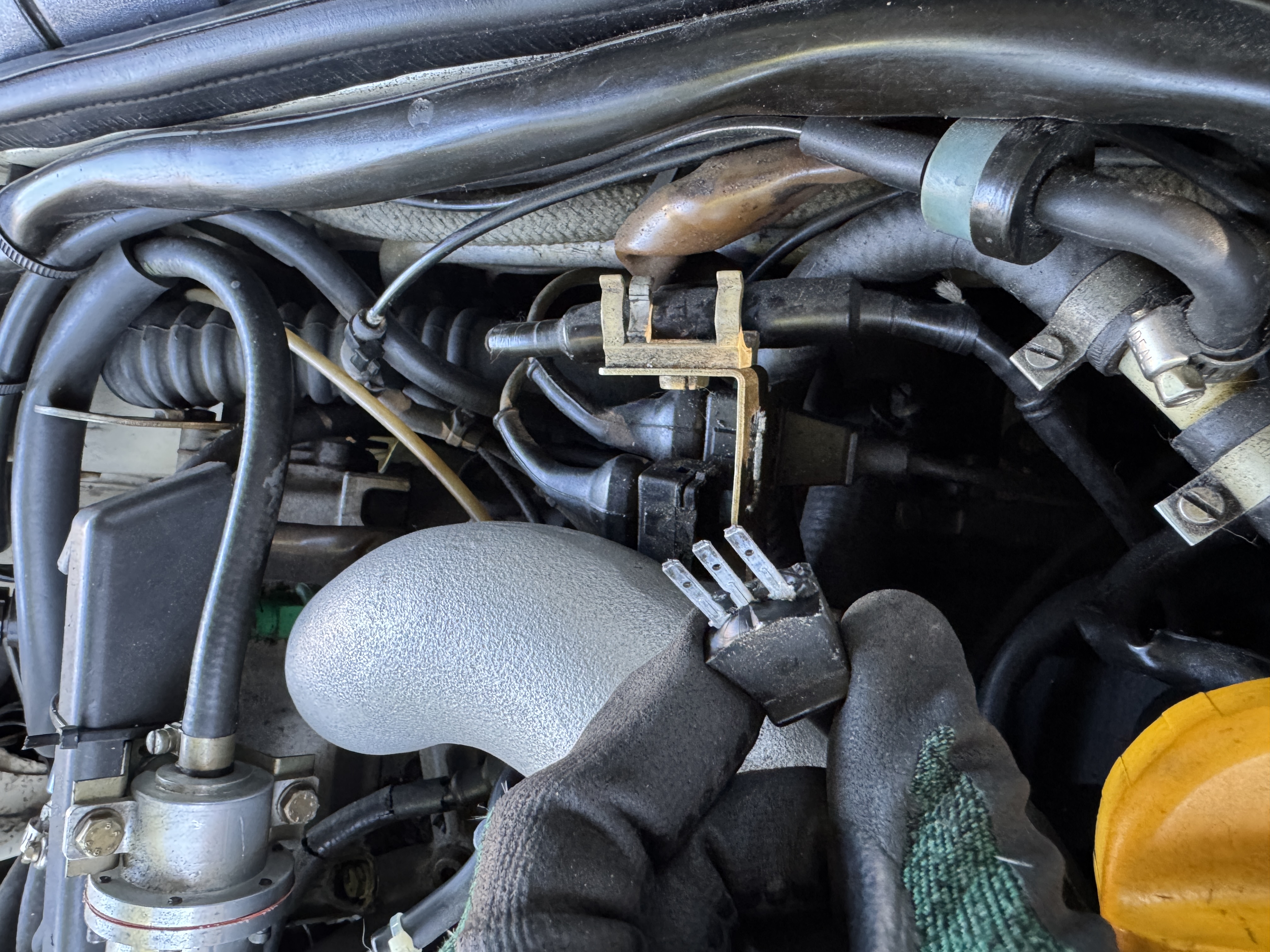

Alright I have an update but this time I believe I found the issue.
I went to check the speed and reference sensors that I assumed were okay because I was getting tach bounce. Upon inspection, the housings were cracked and very frail. I’ll attach images but they crumbled when I disconnected them whoops.
Tested resistances on the reference sensor for pins 25 and 26 which didn’t provide a reading with “overload” condition. Spec is 600-1600 ohms. This was the same for pins 8 and 27 for the speed sensor.
Tested 8 and 23, 25 and 78 which spec is over 1 M ohm. 8-23 read 34 k ohm and 25-78 read 0.16 M ohm.

The normal failure mode is frayed wires under the rubber boosts. Never actually say a JPT connector break like that. Tach bounce is typically a good indicator that the sensors are working, but either way it looks like you'll need to fix those connectors....
