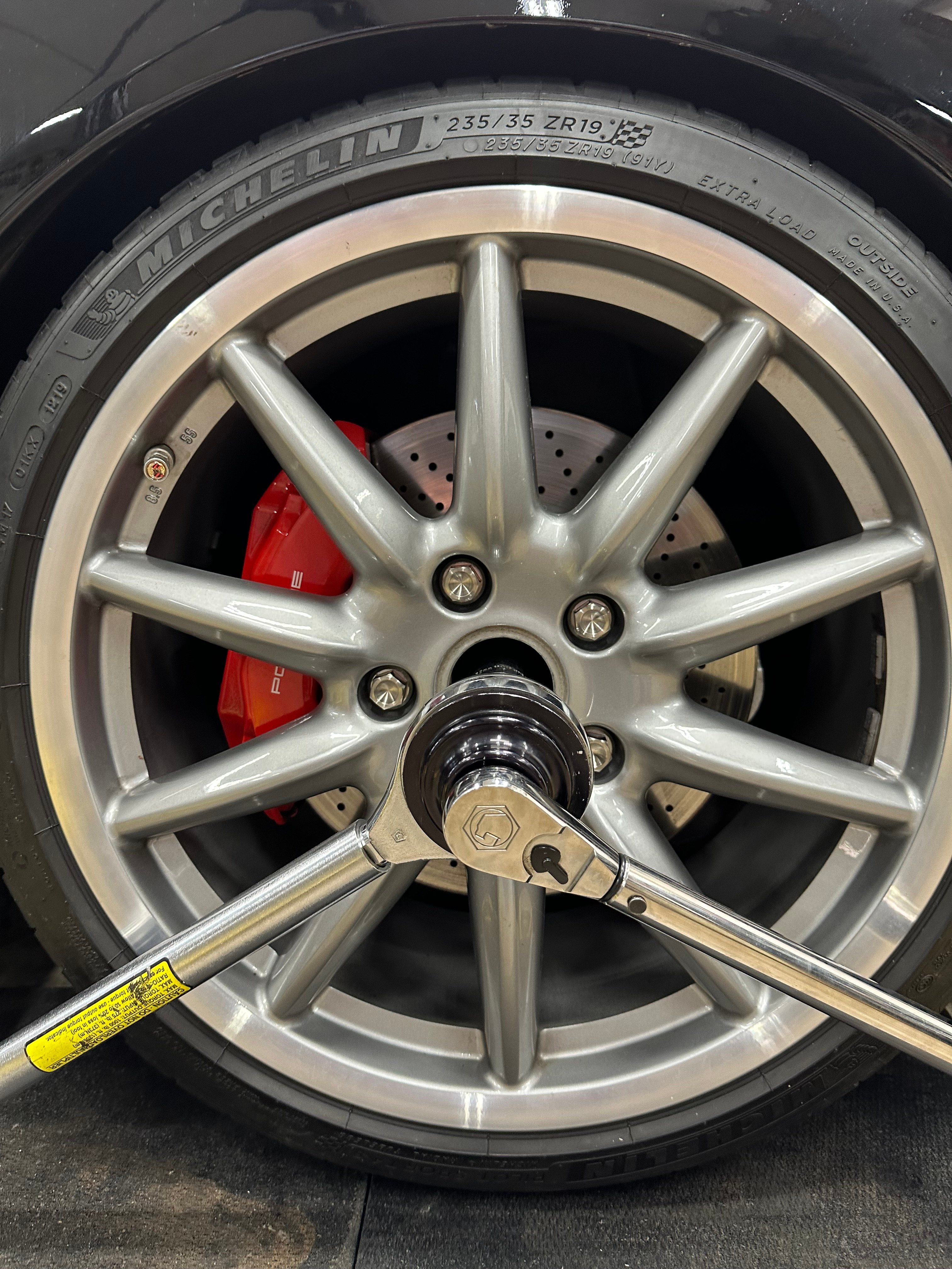

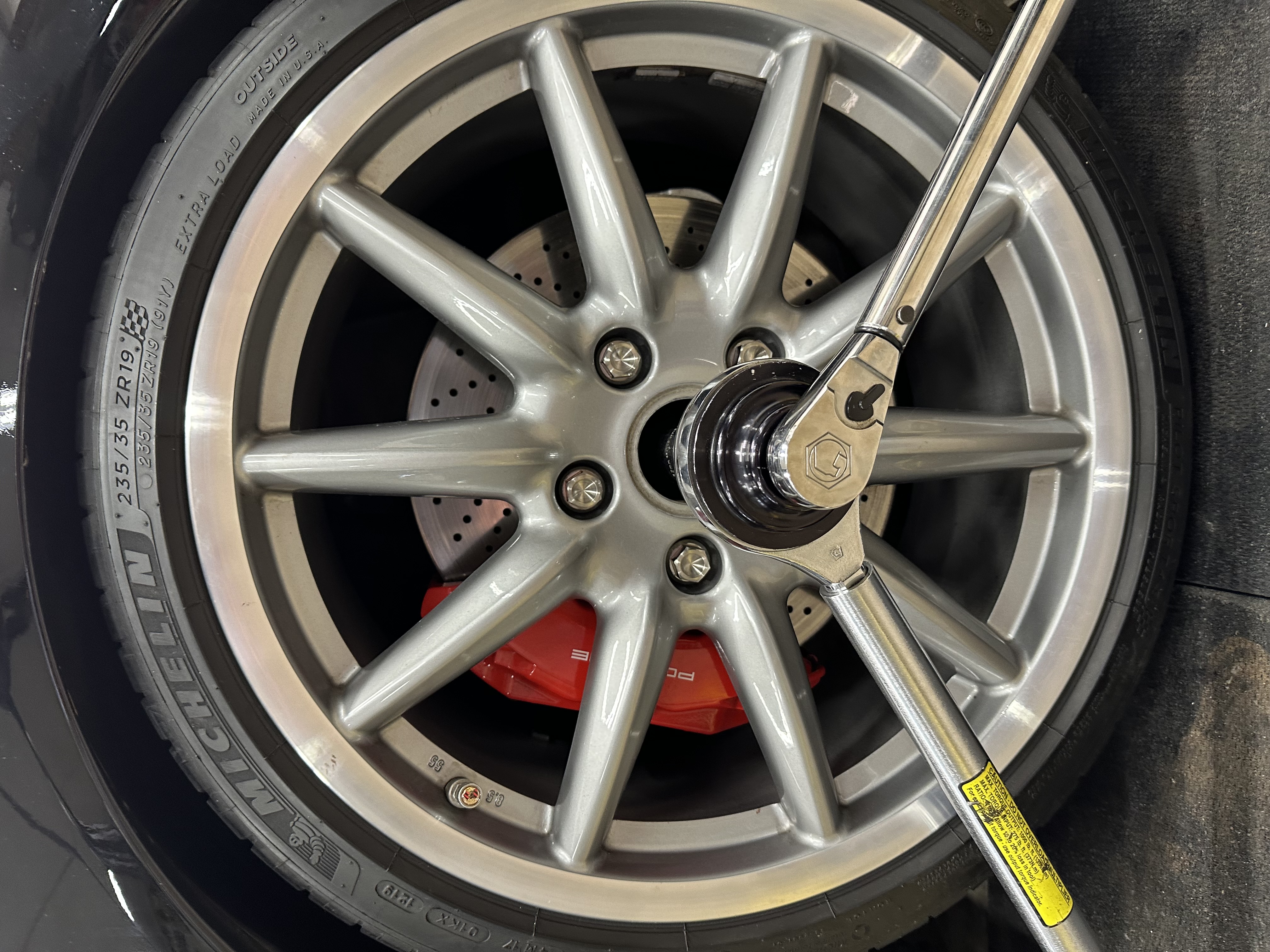

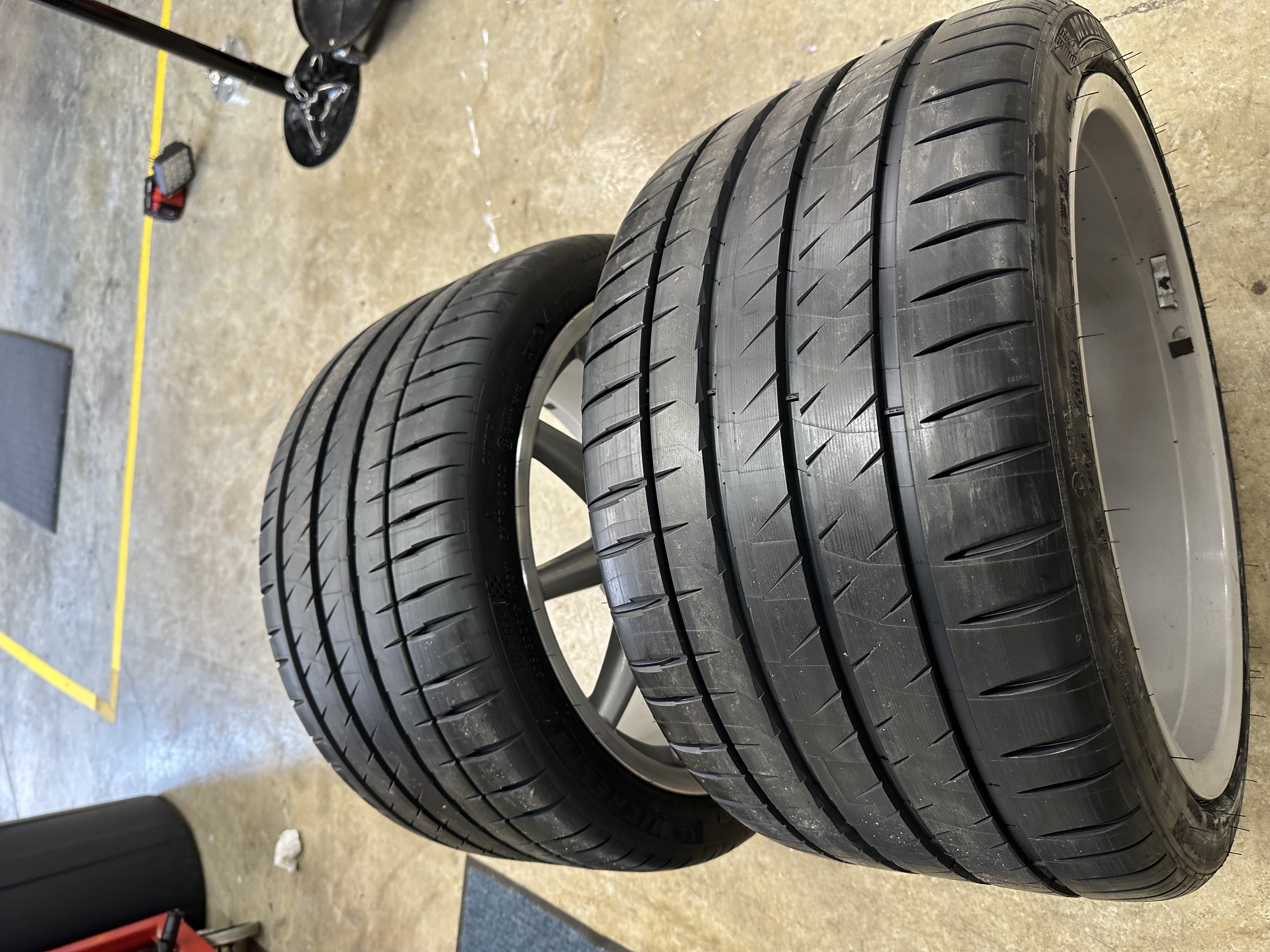

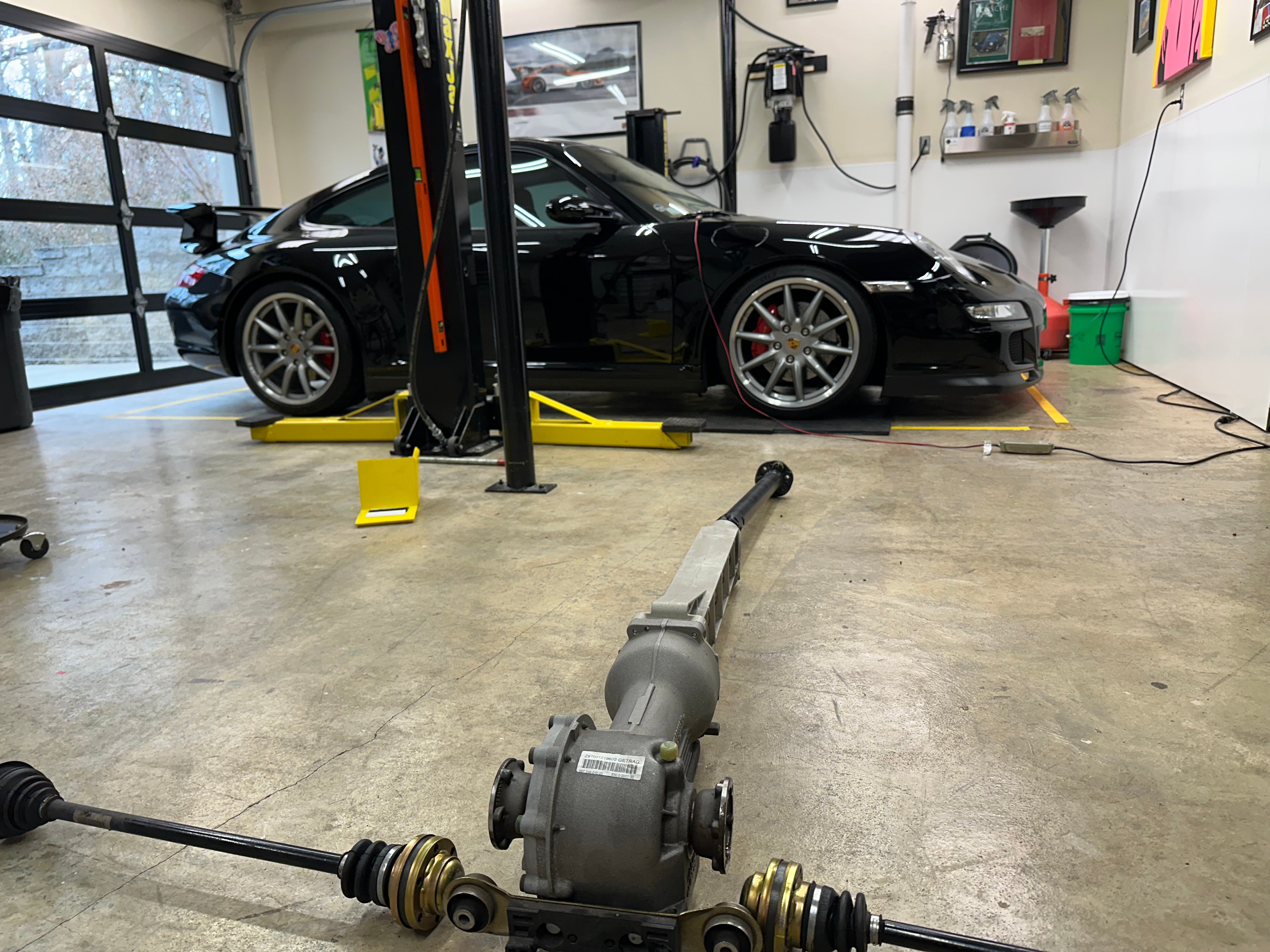

Was able to get the new rear tires mounted and everything back together. Used a torque multiplier I borrowed from my friend who owns a tuning shop. Got the axel nuts torqued to 340 ft/lbs. Took it on a very short drive and the steering is definitely lighter for a lack of better terms. It is especially noticeable on slow (driveway) turns. Im really really liking it.
Im hoping this helps the next person who tackles this very simple job. Next up is the CV boots...
