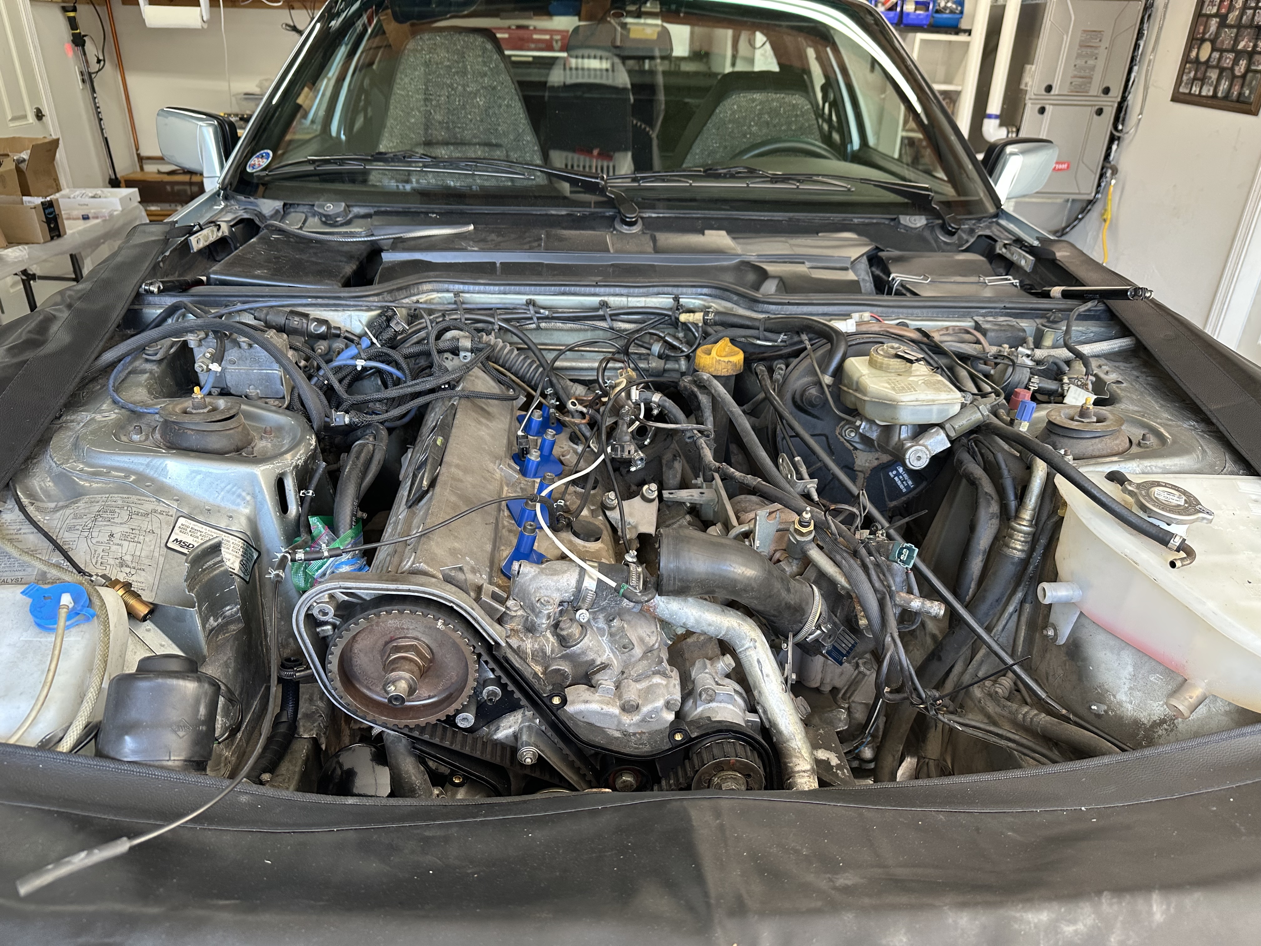

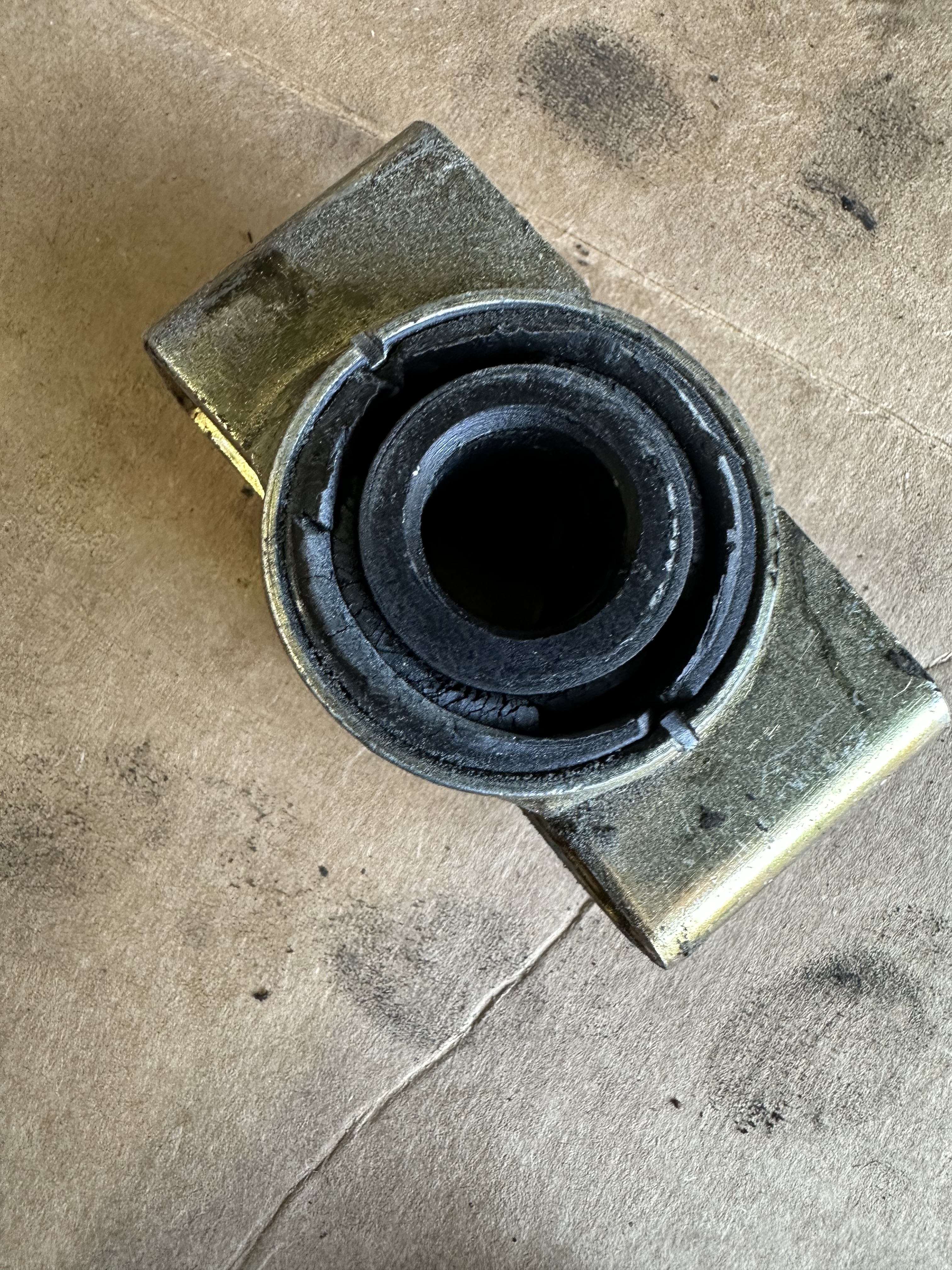

Most of the pics are reminders about how things looked before removing. But here are a couple - one is before engine removal. 2nd is my 4 year old/4k mile caster block. I was a little surprised to see the wear on this one. Maybe the 17" wheels?
One of my local 911 friends offered to come by to check on the work this morning and offer moral support. He ended up under the car helping take out the mid section of the exhaust. Quite helpful!
1986 951 - Silicon Valley

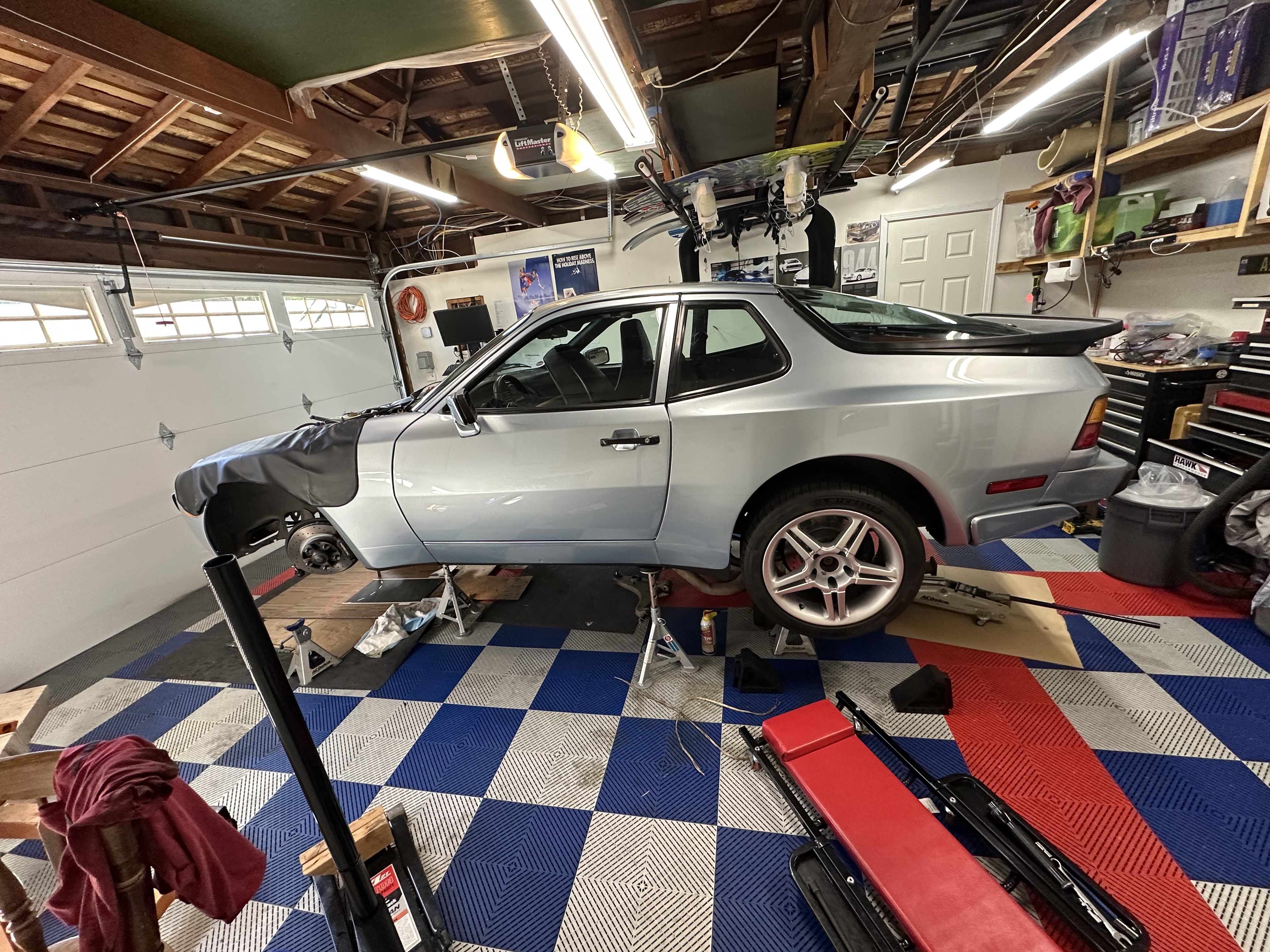

Everything is pretty much prepped to drop the engine. Just need another inch or two clearance.

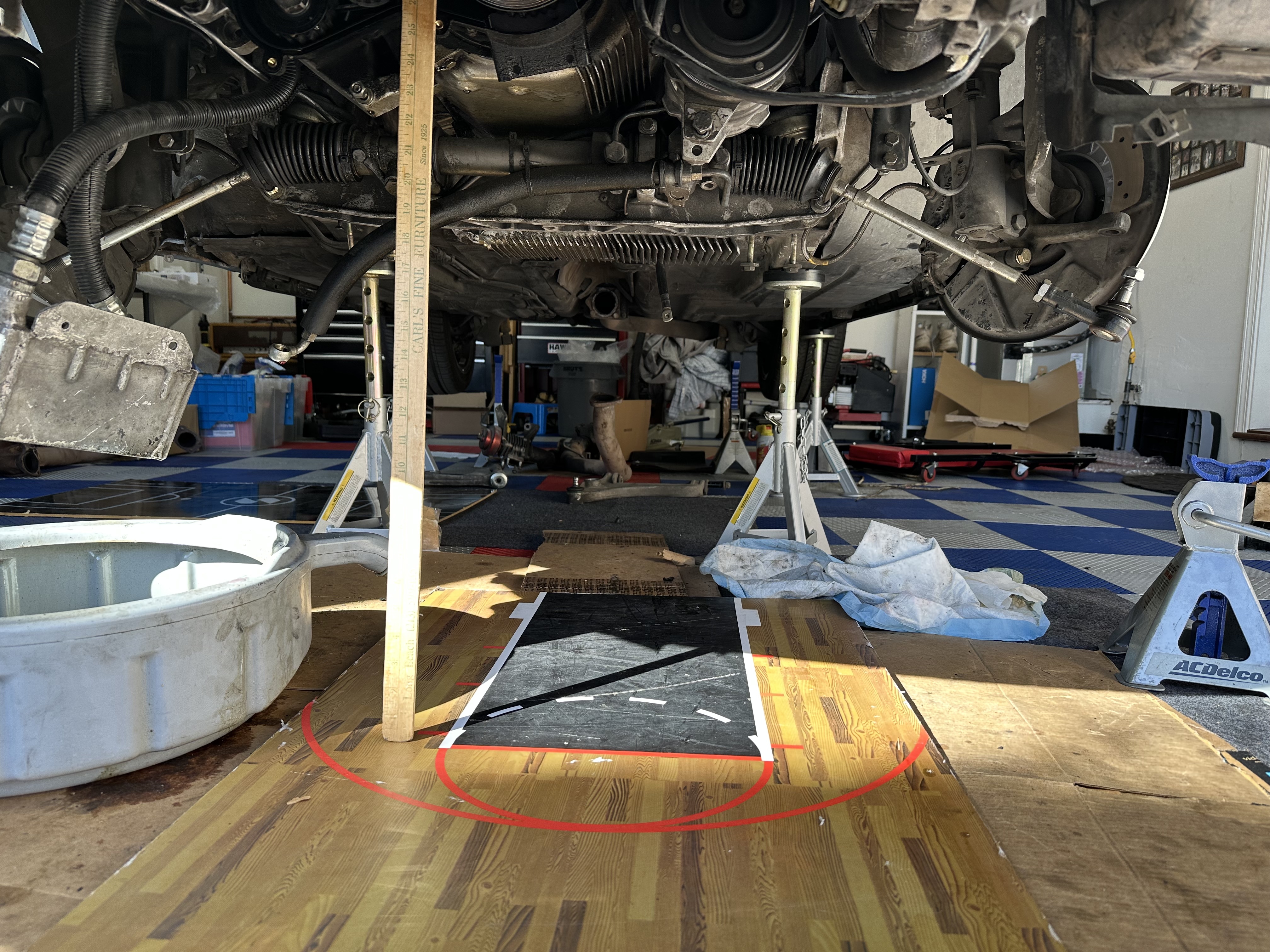

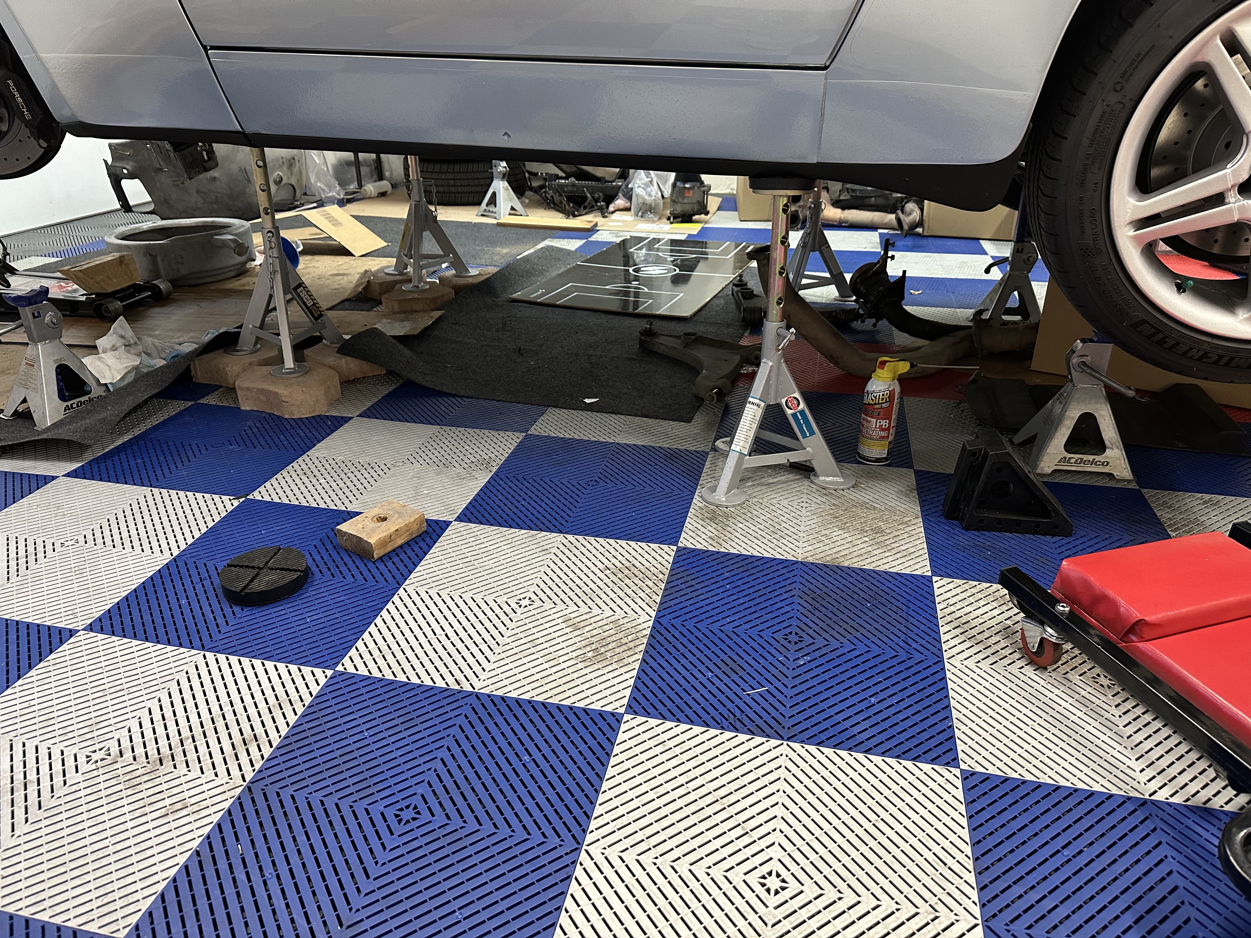

If you lower the back of the car, you can point the car upward a bit, adding a few more inches at the front. You can also put the jack stands on top of a wood platform.

Ok - now we have the magical 25" in the front (raised back 1.5" and front the height of the pavers).
