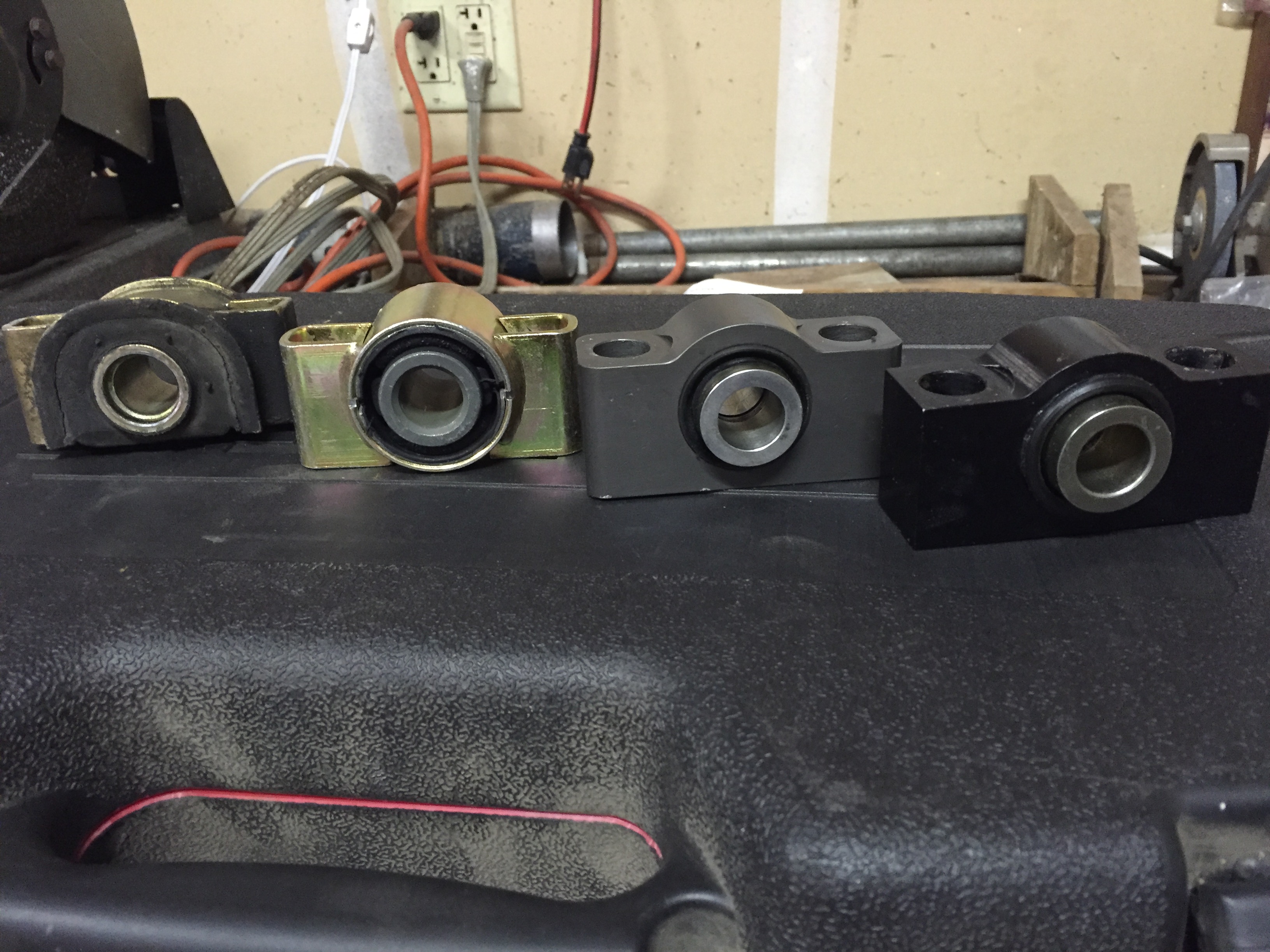

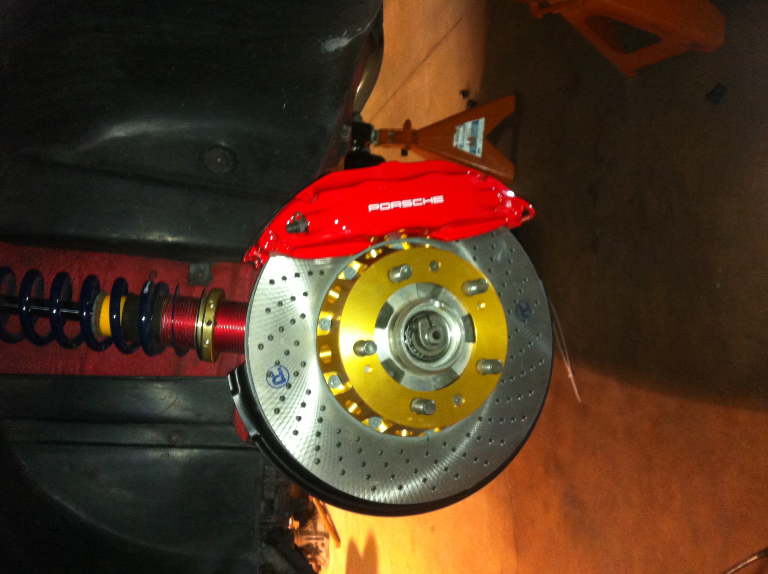

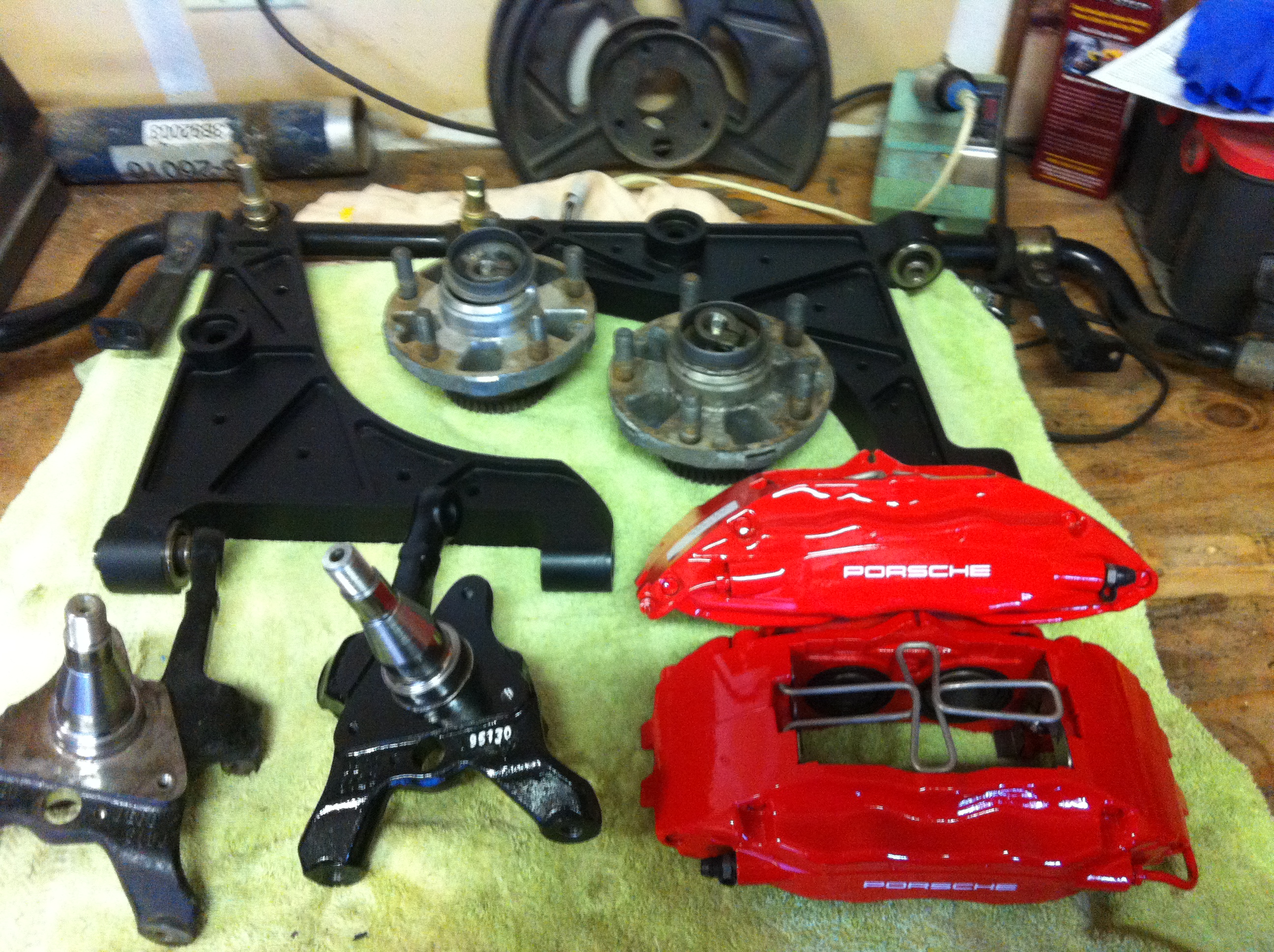

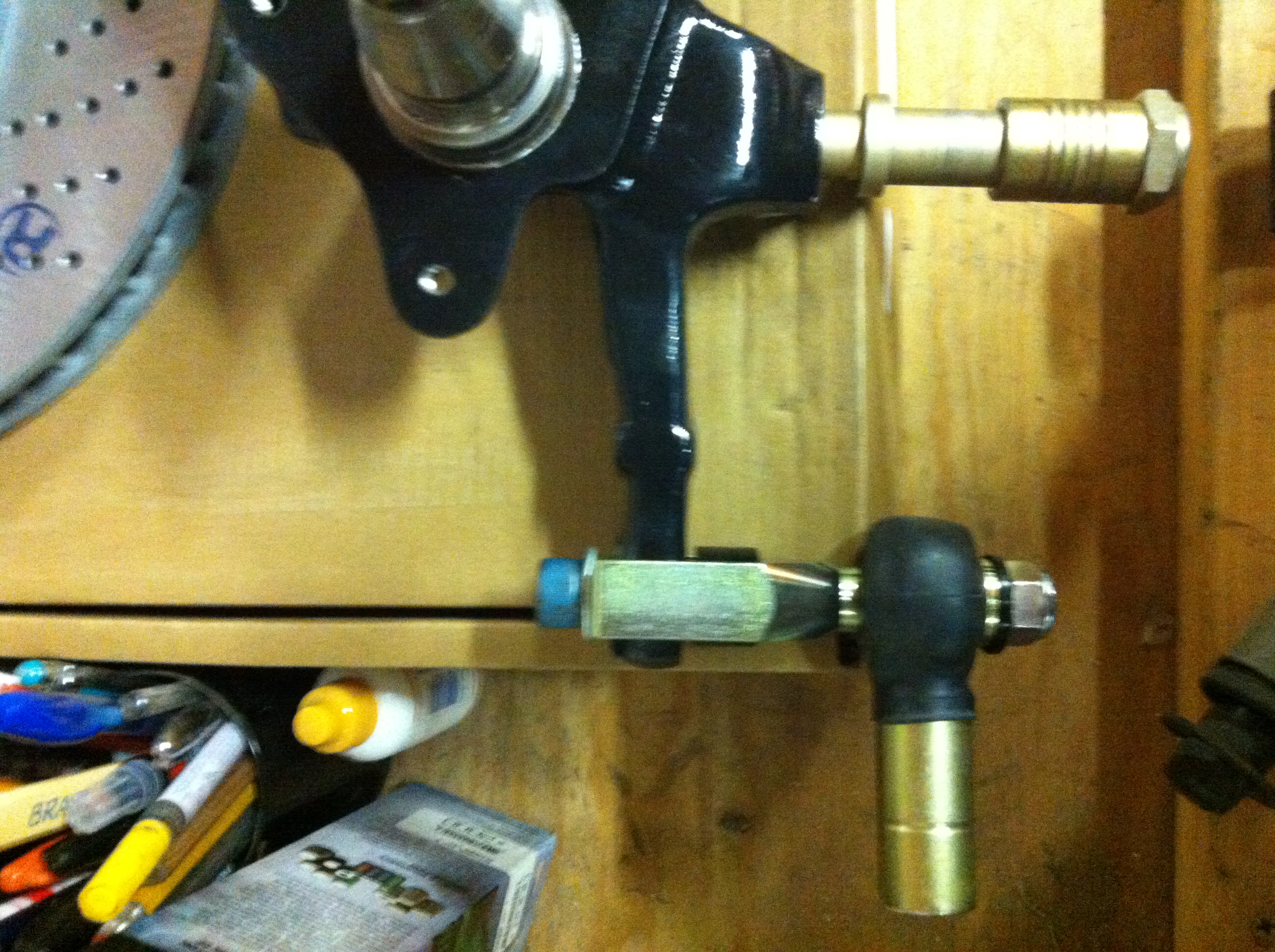

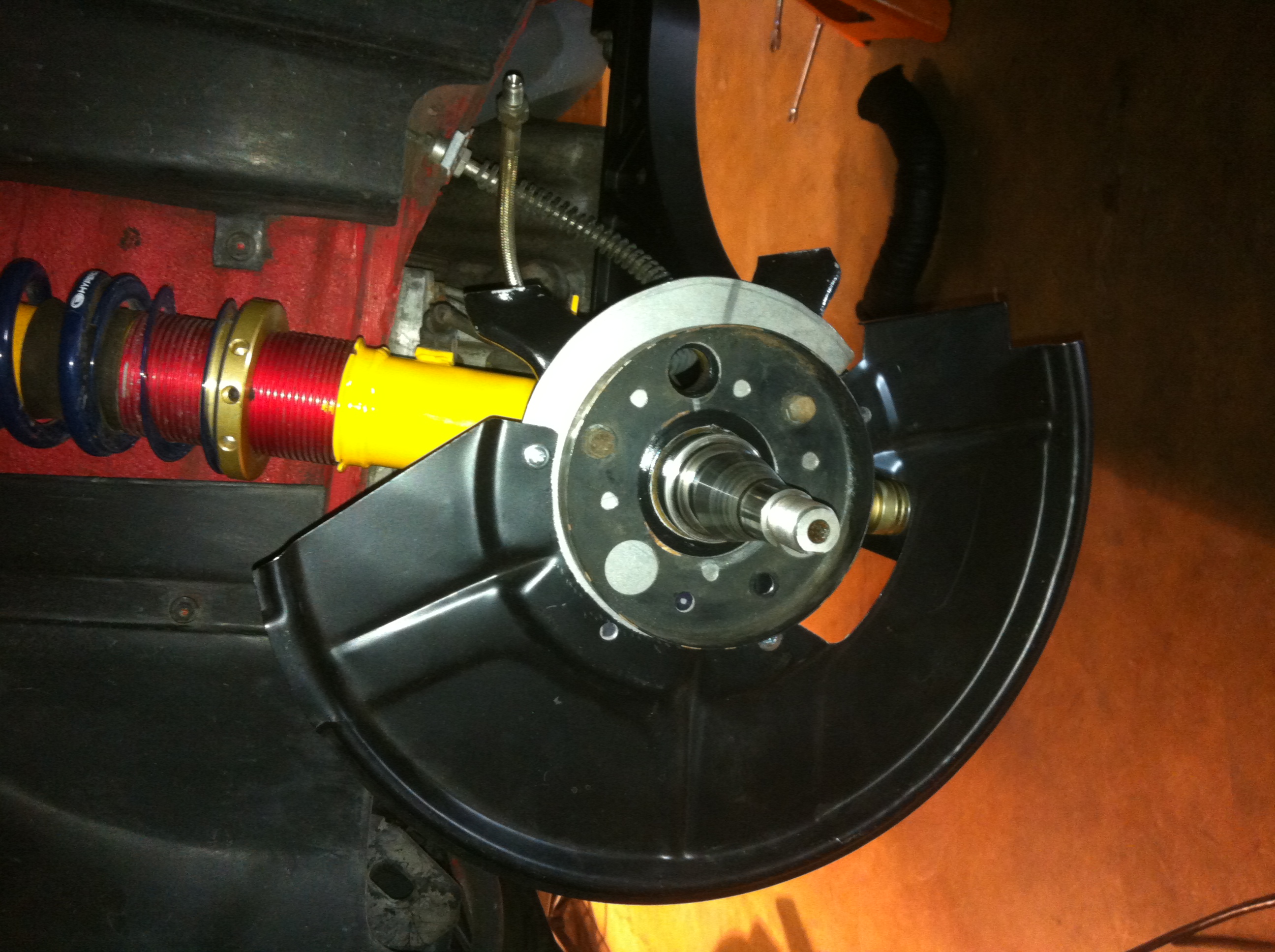

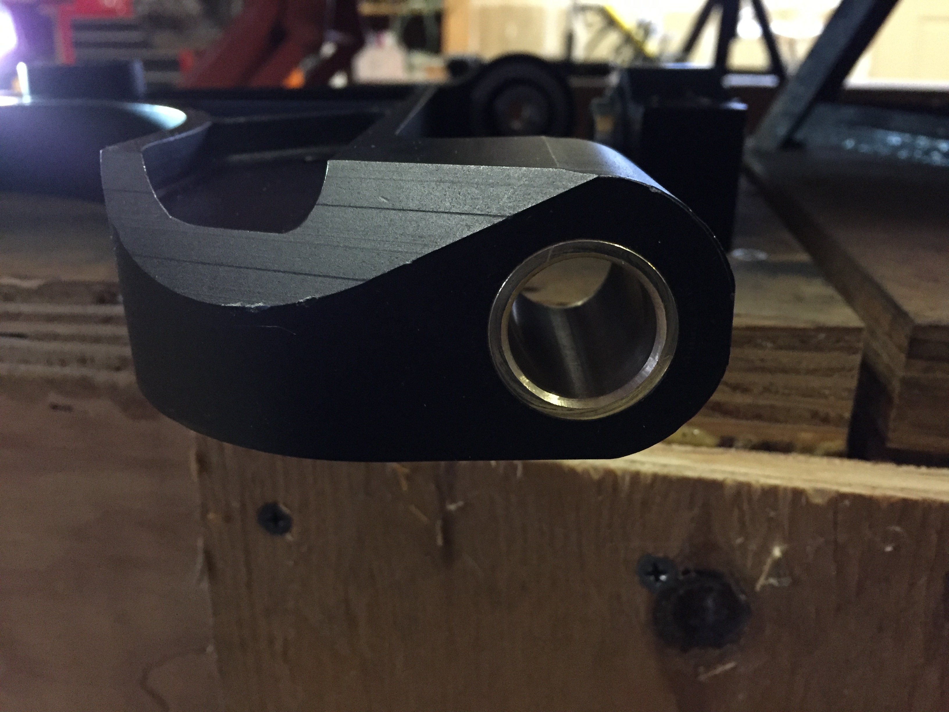

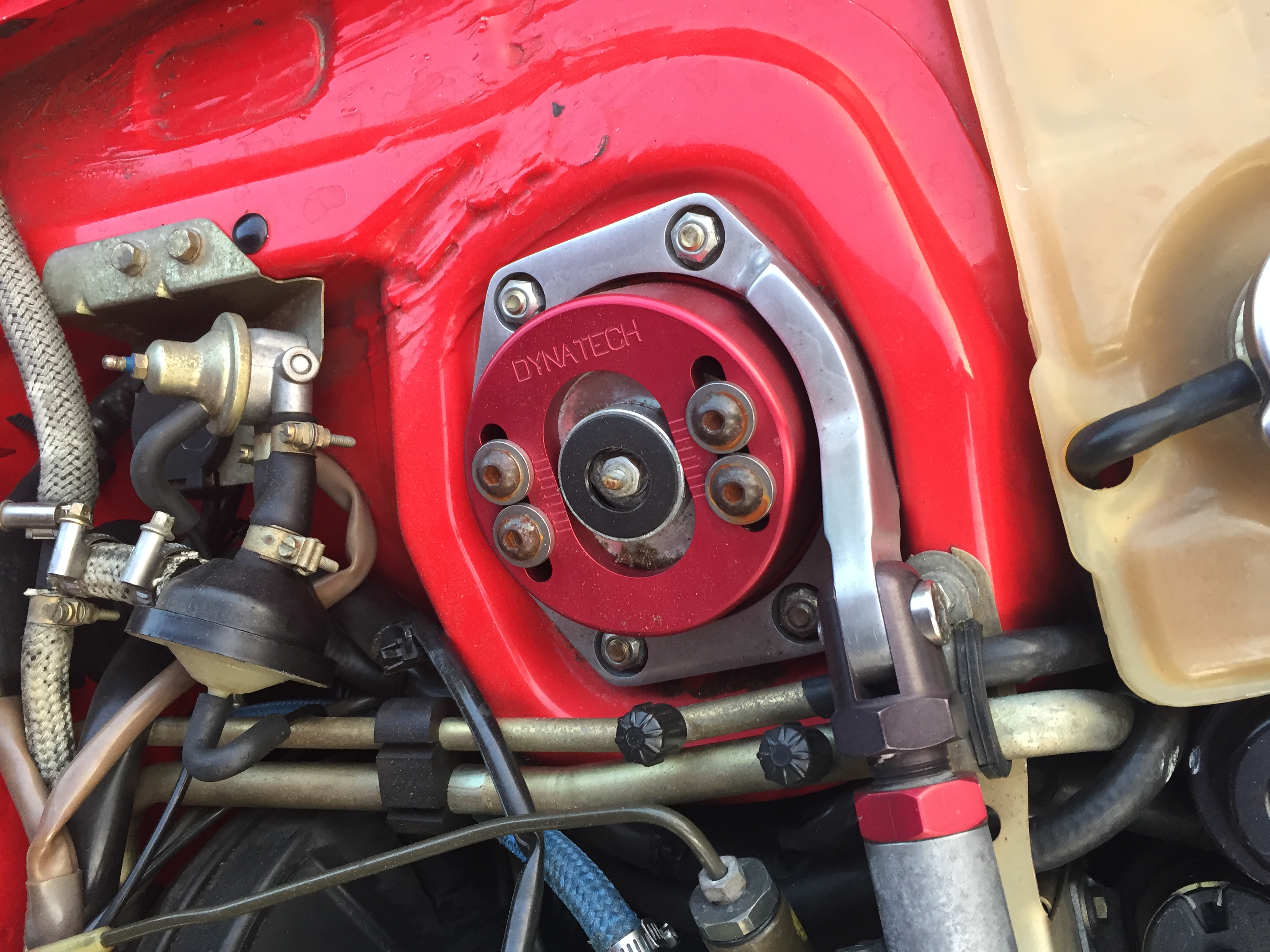

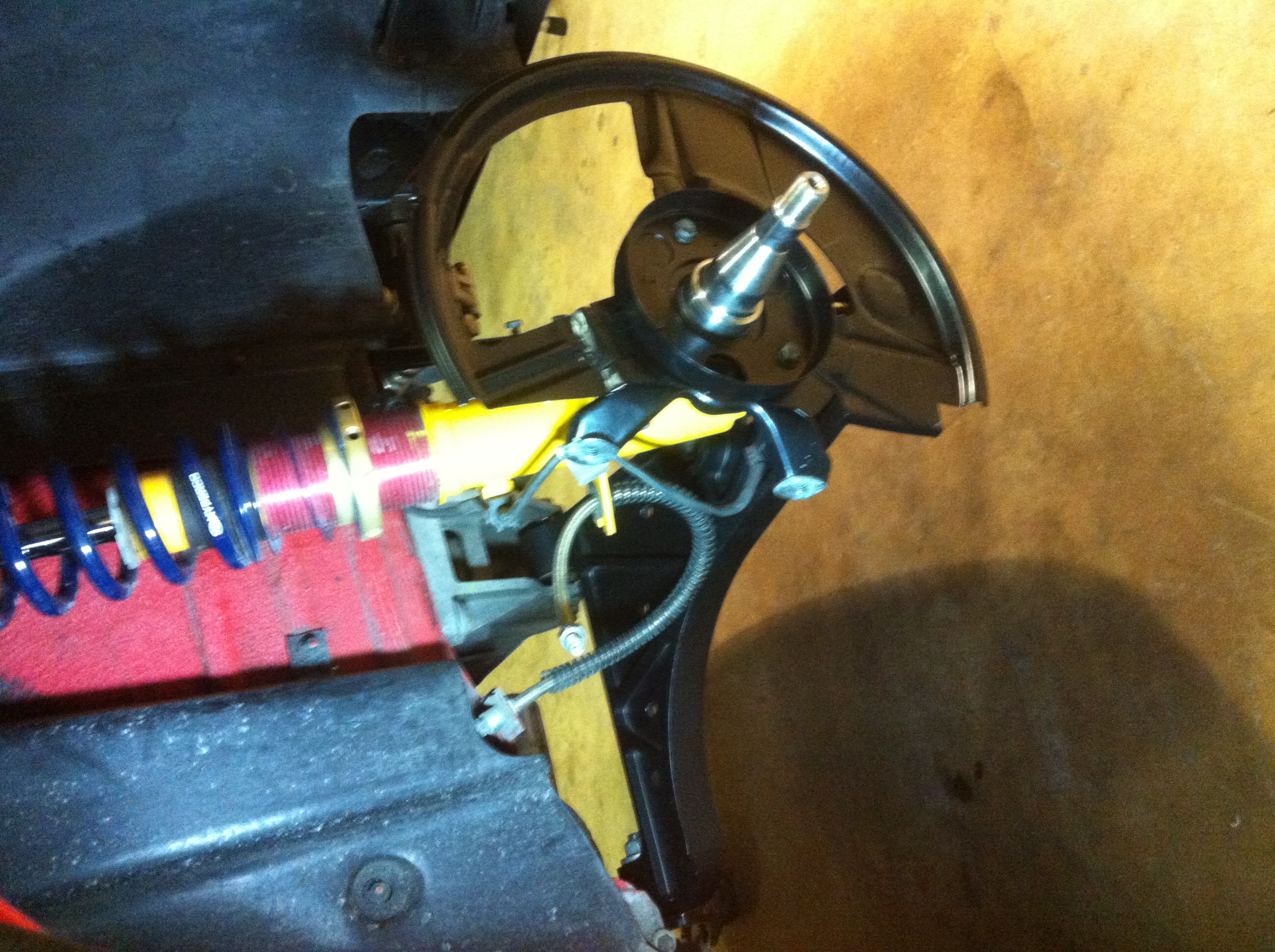

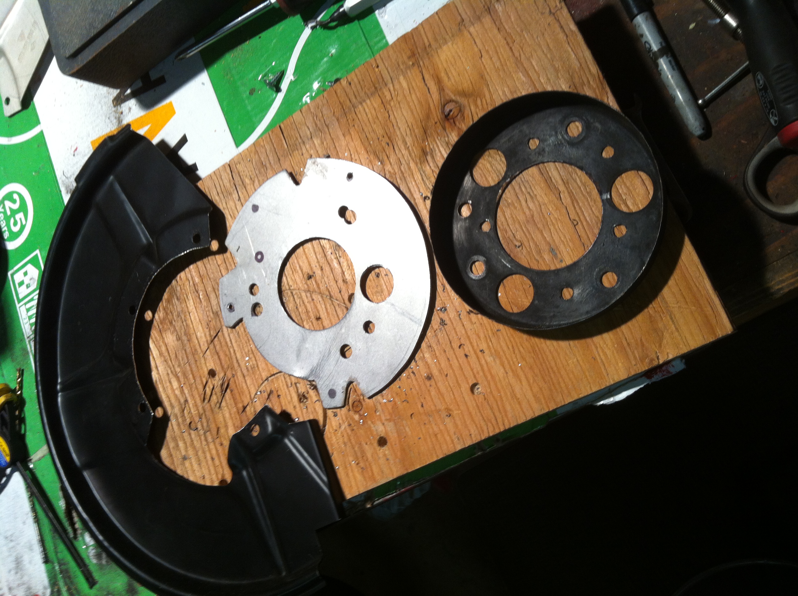

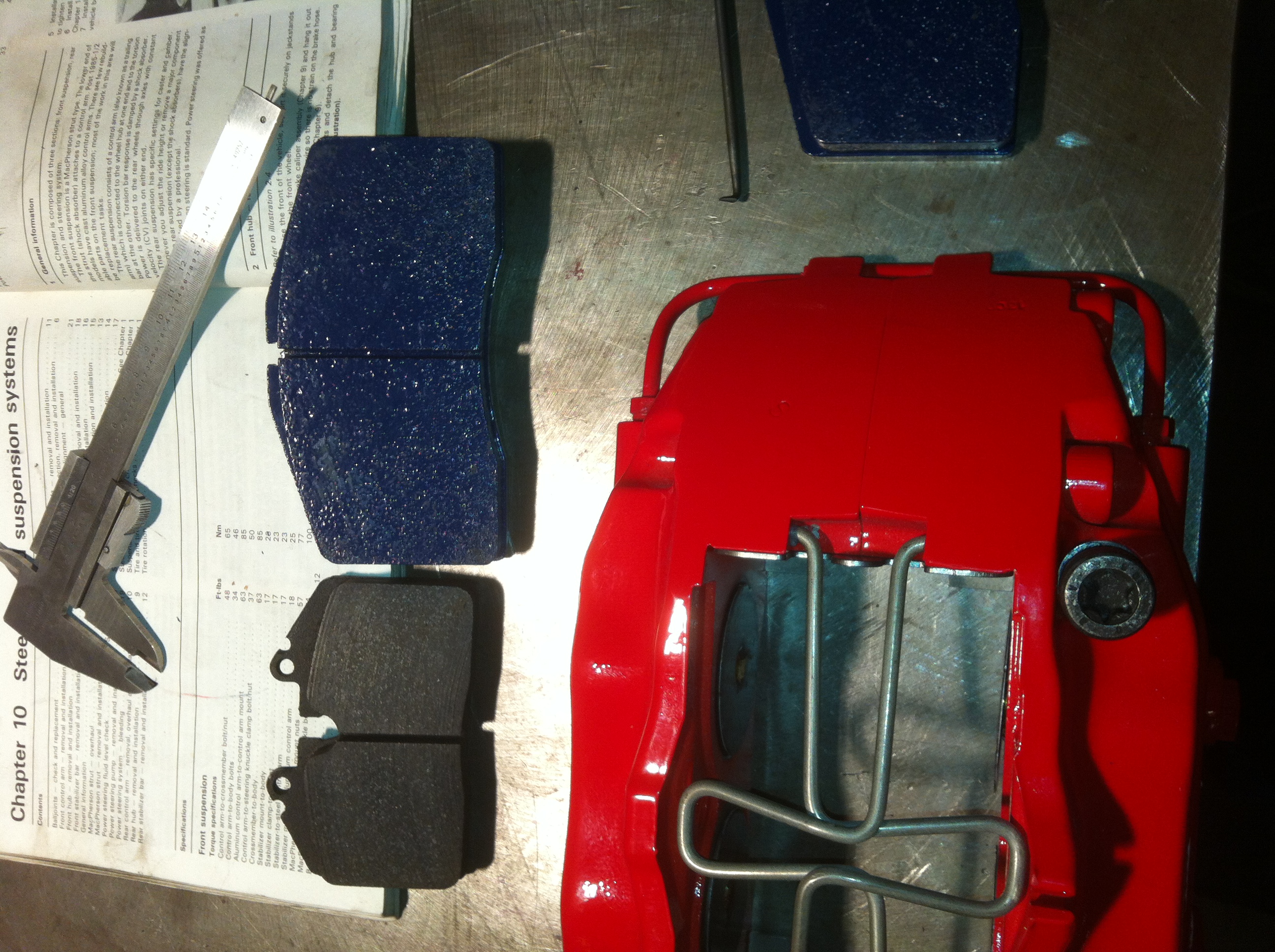

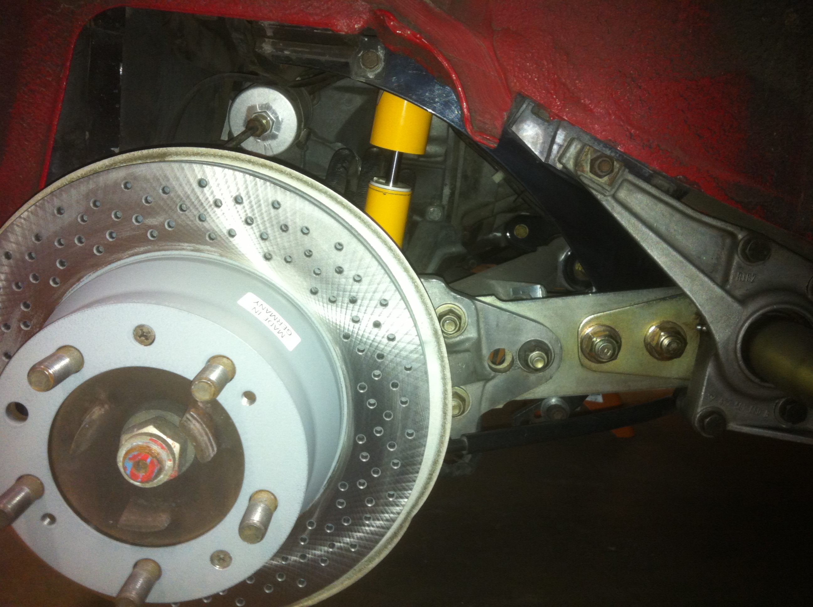

As promised, pictures of my 86 Big Red brake upgrade. For those with a keen eye, the rotor in picture #3 is not installed on the wrong side, this is just one of my mock ups.
1. Brakes - Big Red Upgrade DEC 2013.JPG (2.2 MiB) Viewed 431 times
2. Brakes - Backing Plate DEC 2013.JPG (1.18 MiB) Viewed 431 times
3. Brakes - Big Red Mock Up DEC 2013.JPG (1.16 MiB) Viewed 431 times
4. Brakes - Castor Block Comparison DEC 2013.JPG (1.39 MiB) Viewed 431 times
5. Brakes - Rear, DEC 2013.JPG (1.3 MiB) Viewed 431 times

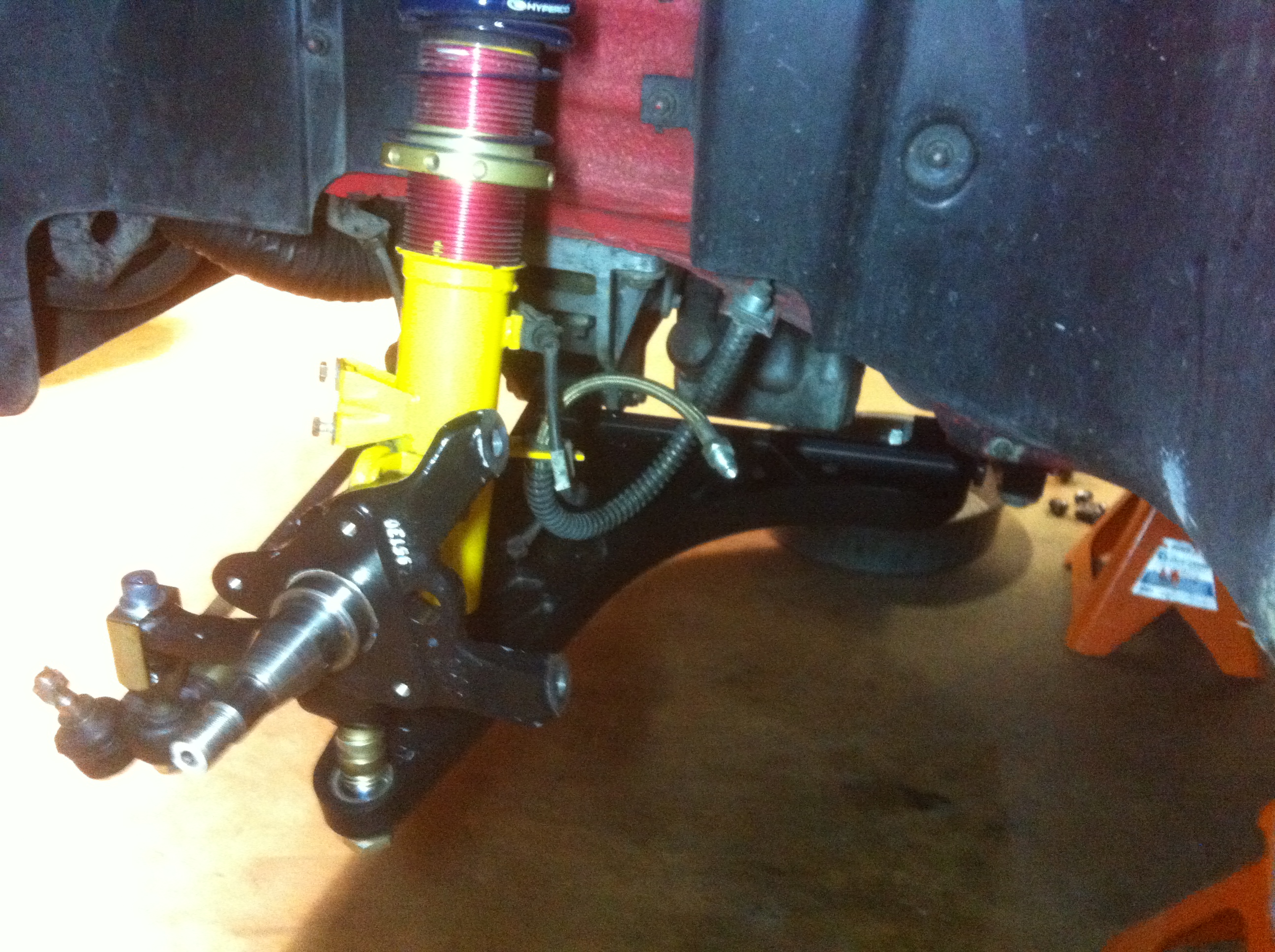

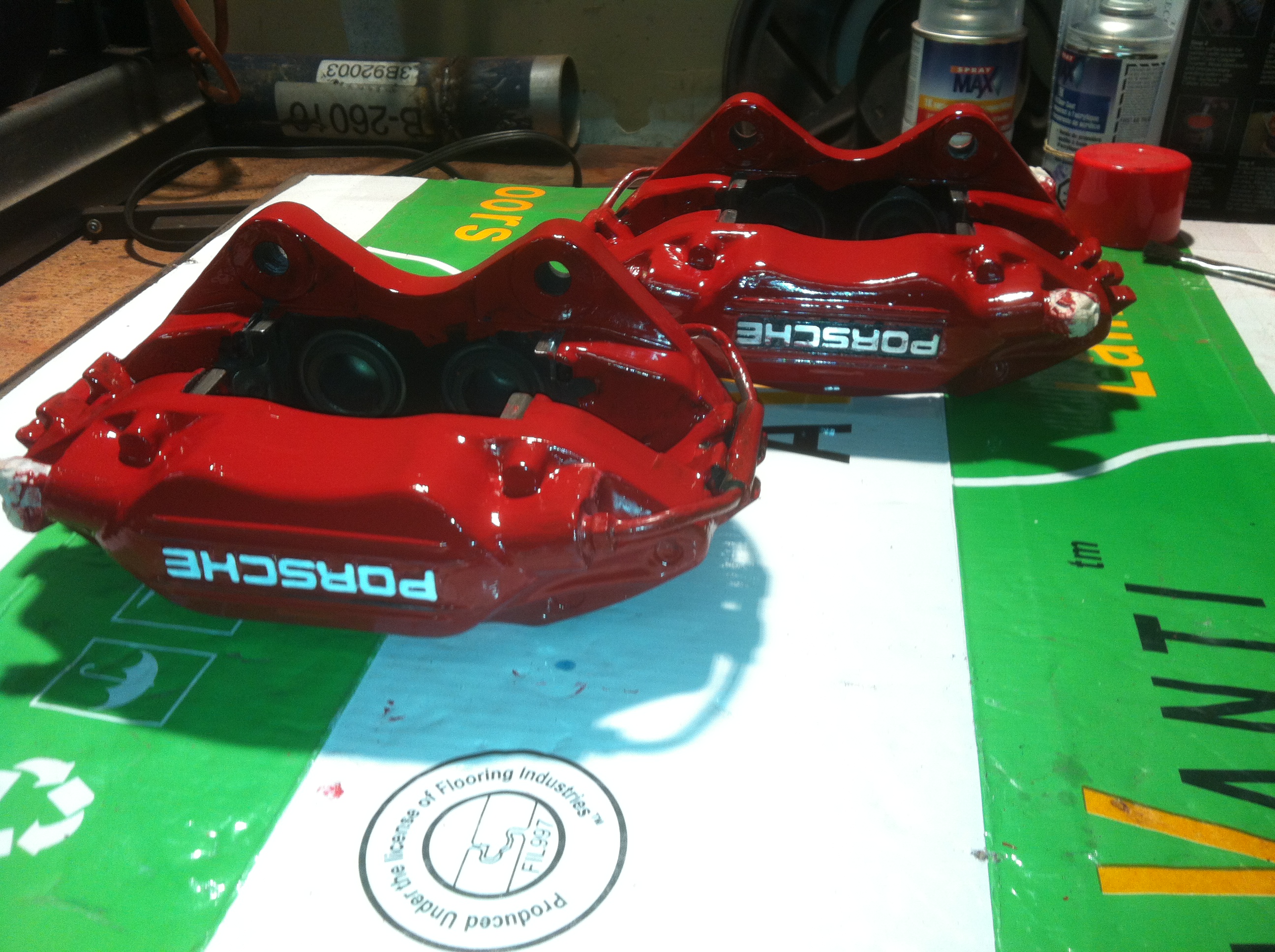

Also I only mentioned the big items for this update, but there are smaller items that I added like painted stock rear calipers, Porsche brake proportioning valve to add more brake pressure at the rear, SS brake lines, Pagid blue brake pads machined to accept wear sensors, camber plates, strut brace, Elephant Racing tie rod drop adapters for bump steer, etc.
A few more pictures:
