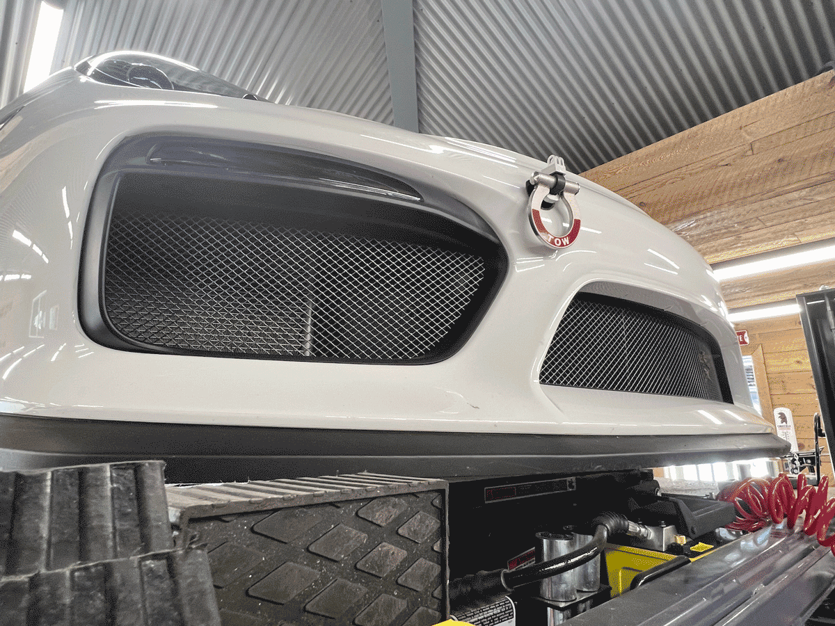

Crazy Eddie came over today to change his oil on the lift, and I couldn't help but notice the tidy factory screens they put over the front radiators (981 GT4). So it's not like Porsche never thought about it....

@Tom Yes, Porsche provides screens for the GT4 but not for the other Caymans (well…probably the GT4 RS). I bought a full set from Zunsport for my GTS 4.0. They don’t fit perfect but look great if you don’t get up too close.😐

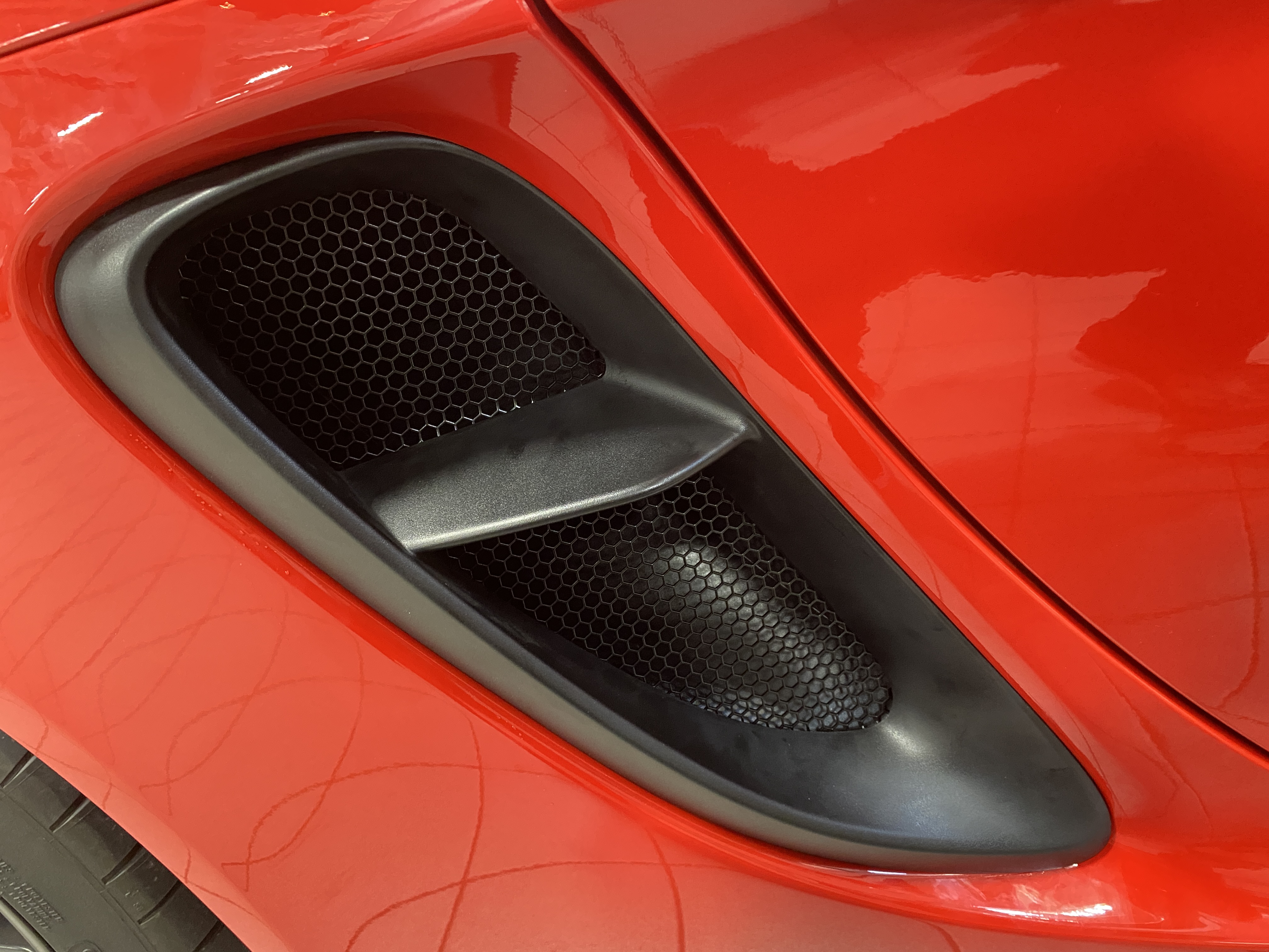

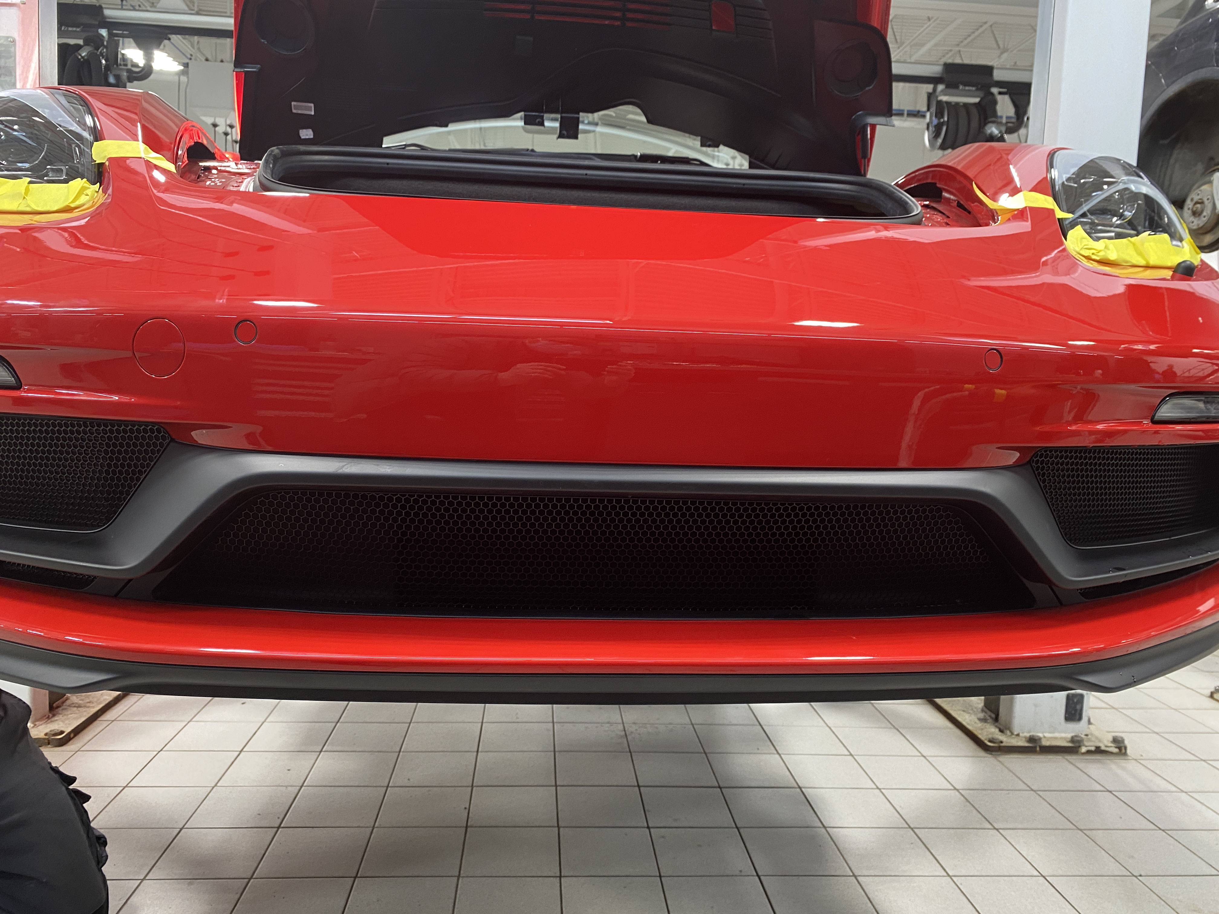

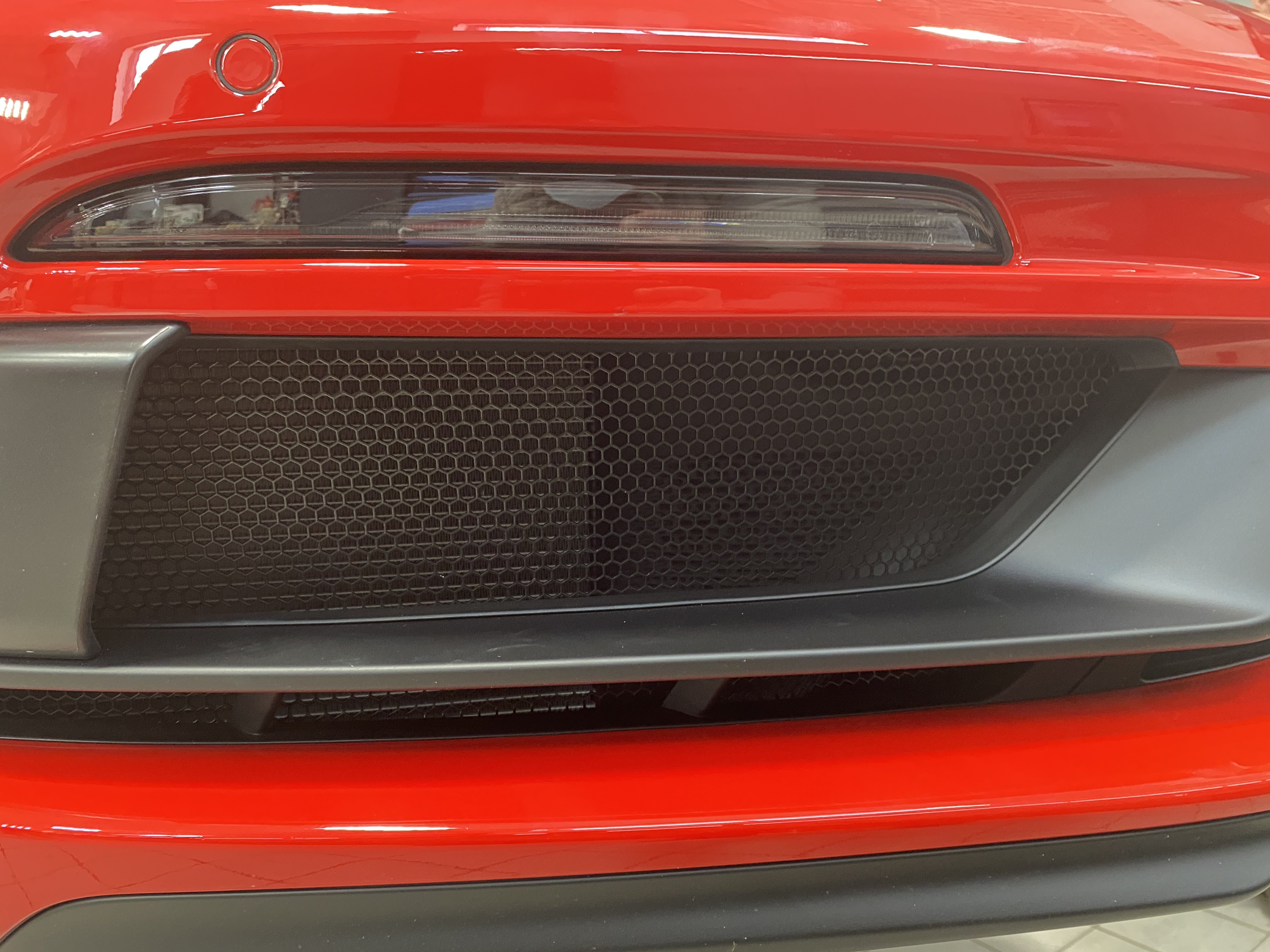

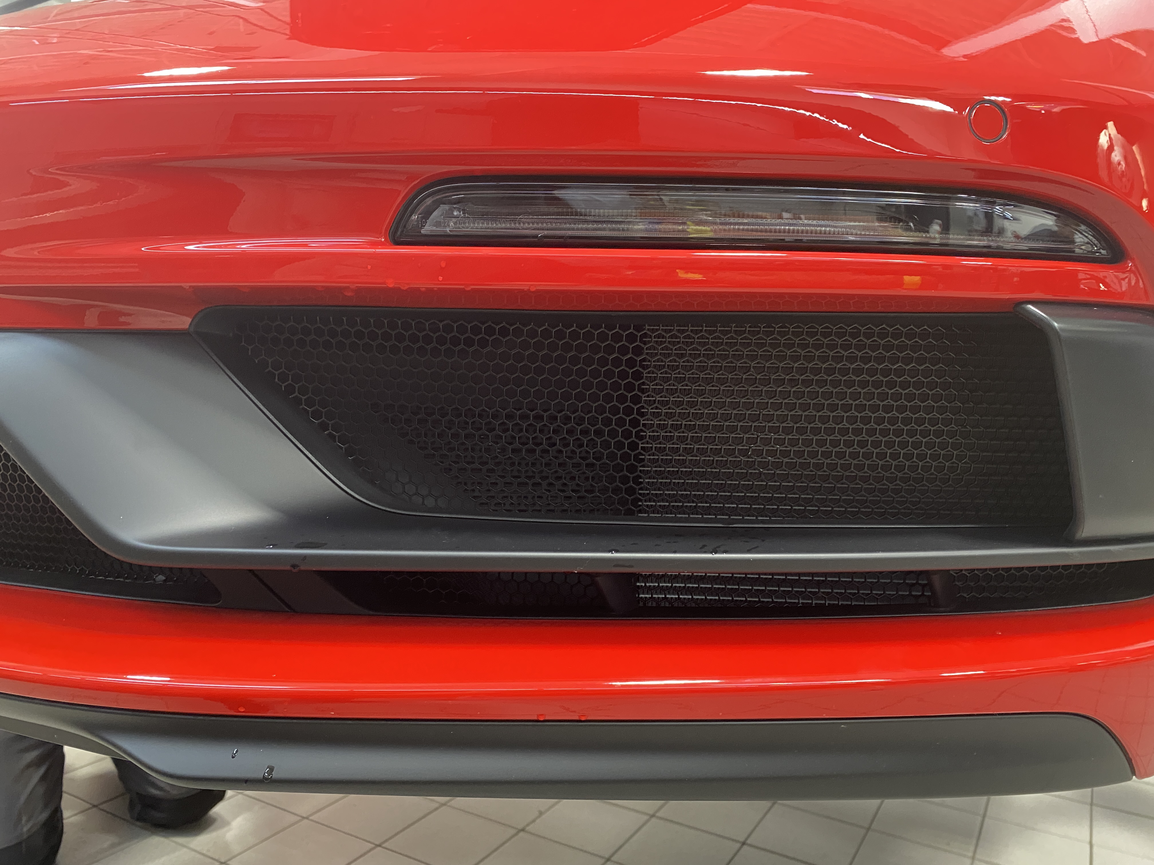

It’s finally done! RGS front grills and side engine intake grills are installed on my Boxster GTS 4.0. I am super happy with the look (Porsche should have delivered the car like this in the first place).
I decided to have a Porsche technician install it for me. Pulling the bumper out was key in order to preserve an OEM look. Also, if something broke during the process or an unexplained issue occured after, it would be covered by them. And boy, was I happy with my decision. The side intake trims are so hard to snap off I wouldn’t have gone so far in force myself. The Porsche technician broke two plastic pins on the trim during the removal. They will obviously replace the trim free of charge. Anyways, a bit more pricey than if it was done by myself but overall, it would have cost me an intake trim (maybe two-who knows?), many swear words trying to fit the grills from the front per RGS’s procedure and I would have never had that OEM look.
