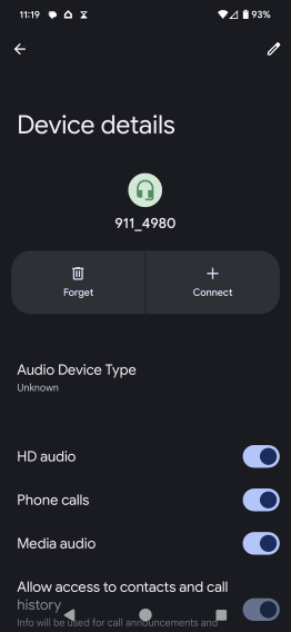

Bluetooth > Connected Devices > "See all" > gear icon > your particular device that you want to turn off > "Forget"
Screenshot_20240711-111945 (Phone).png (28.32 KiB) Viewed 1024 times
PS - as you can see, depending on the connected device's hardware (ie: your car) and available types of Bluetooth features, one can select specific connections to turn off rather than forgetting the device entirely.

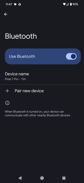

PPS - alternately, you could also simply temporarily turn off Bluetooth completely if you don't need it while in your car.

I don't have those screens. Even when I unpair the car and turn off bluetooth on the phone, they still pair when I get in the car. I can find the phone connection on the PCM, but I don't see the option to stop pairing. I even broke out the owner's manual.... :o :o
