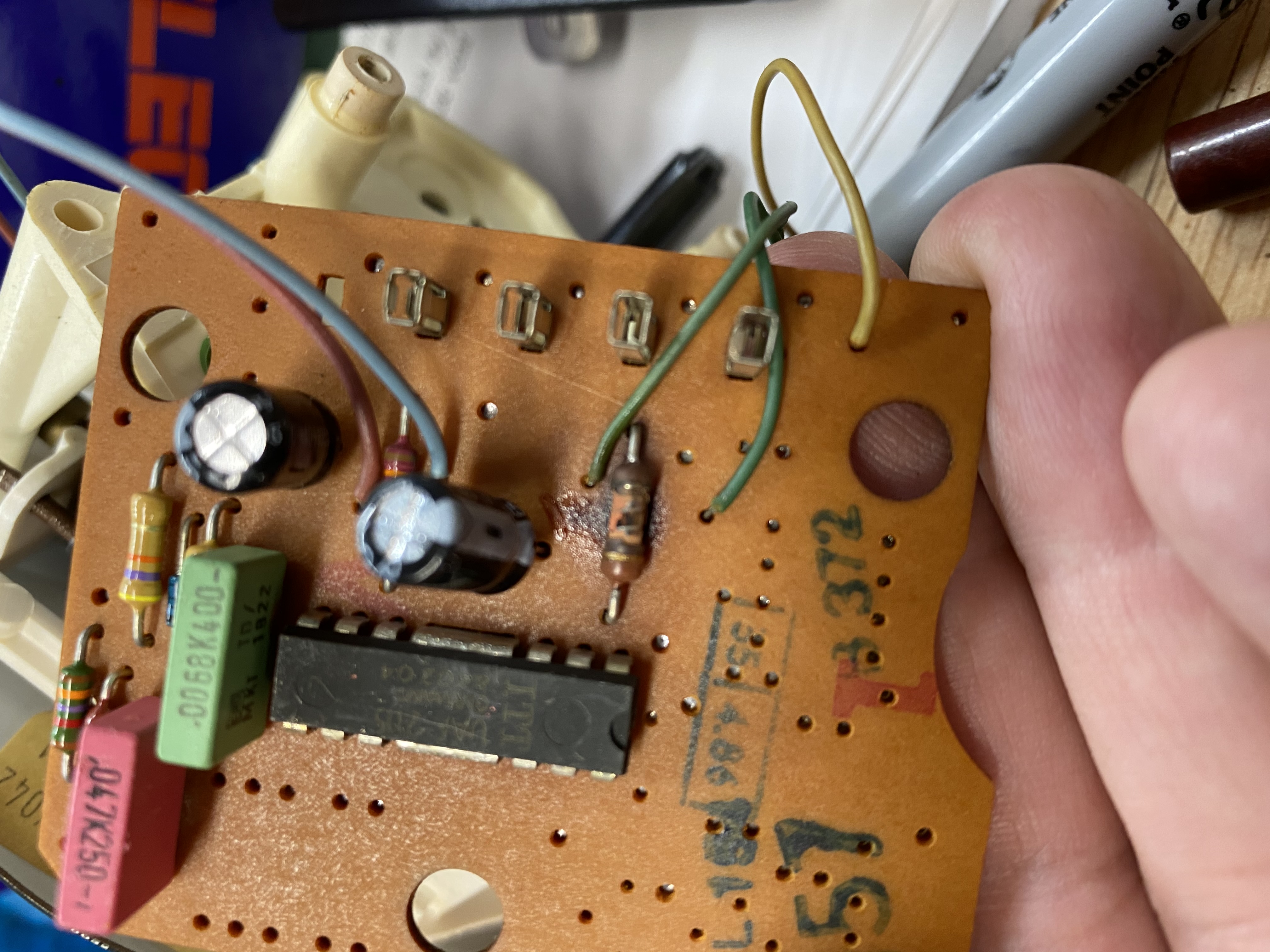

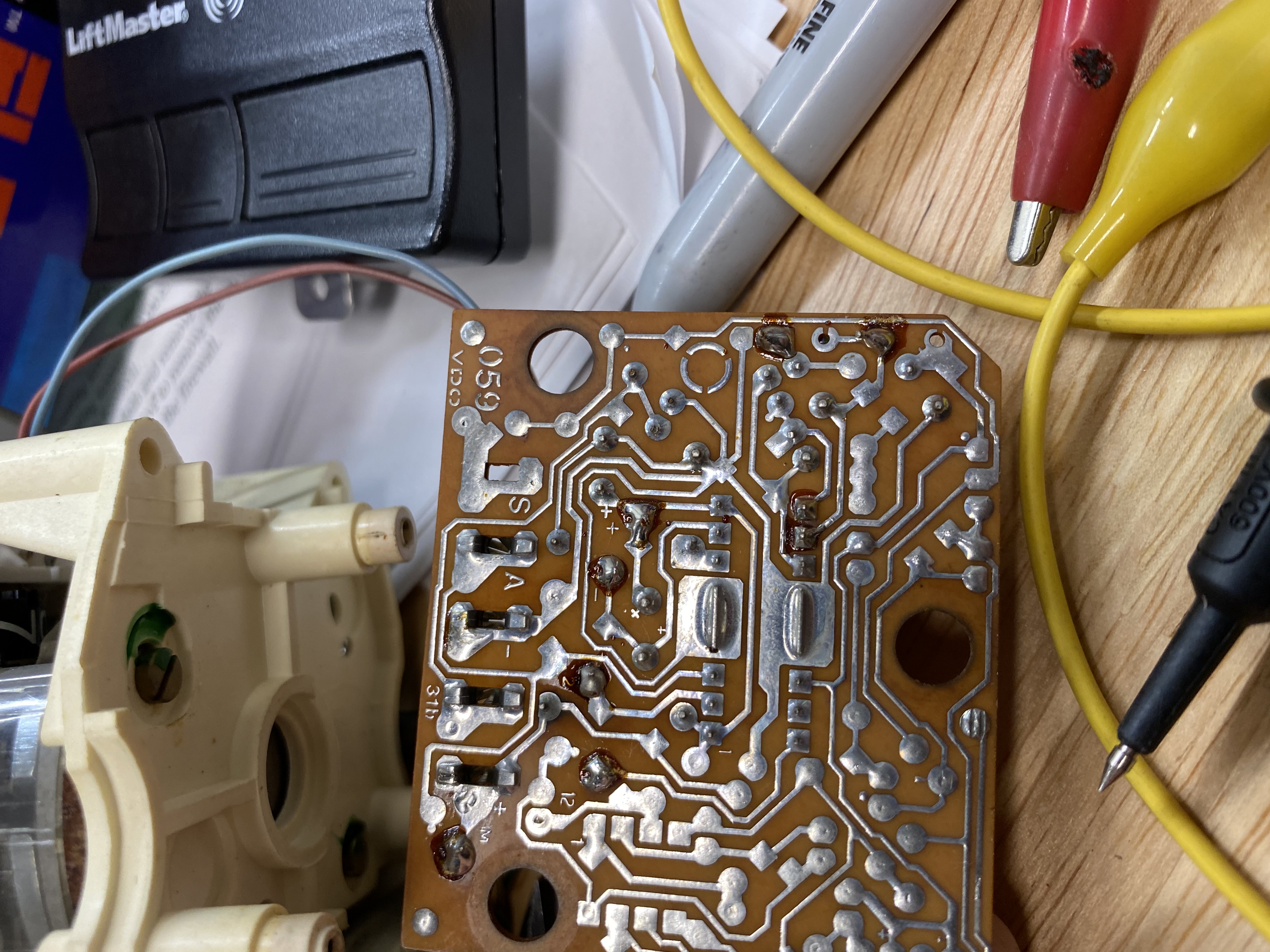

My speedo was also non functional when got my 951. When I pulled the gauge out , it was obvious that a capacitor had shorted out and burned up a couple of resistors as well. Replaced them and everything worked.

Pic of burned resistor attached. I replaced all of the caps as I recall.

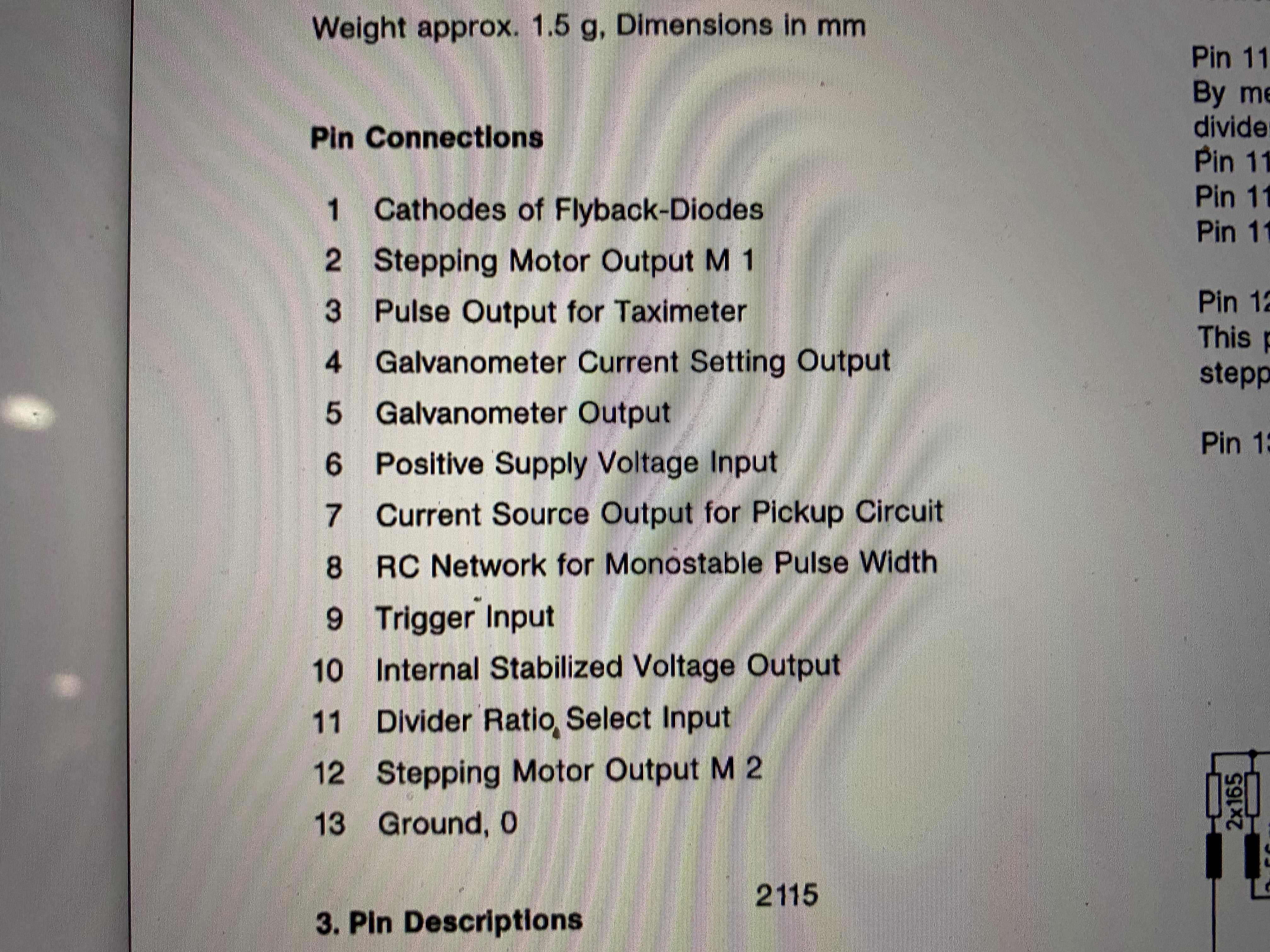

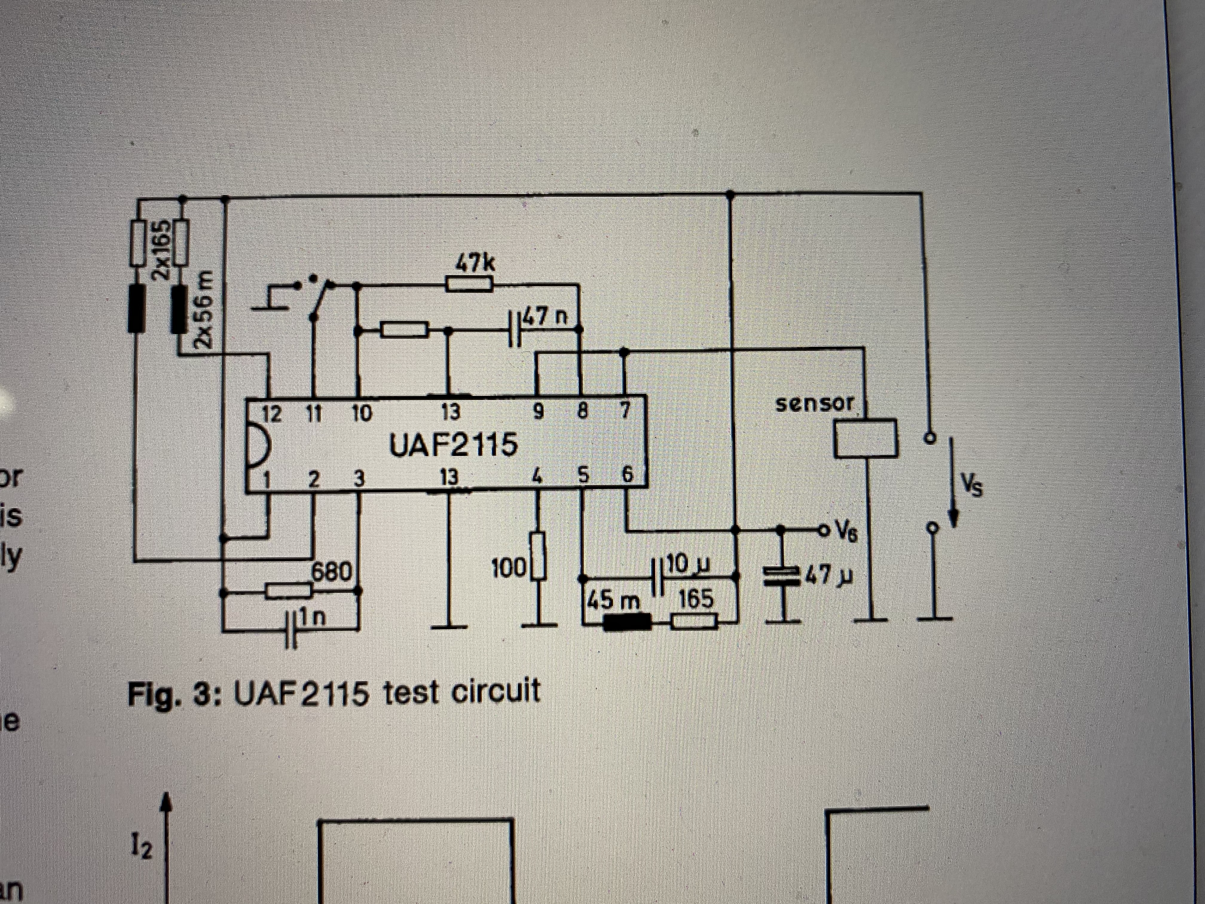

Schematic and other info attached for future reference as it’s not in any Porsche electrical diagrams.
