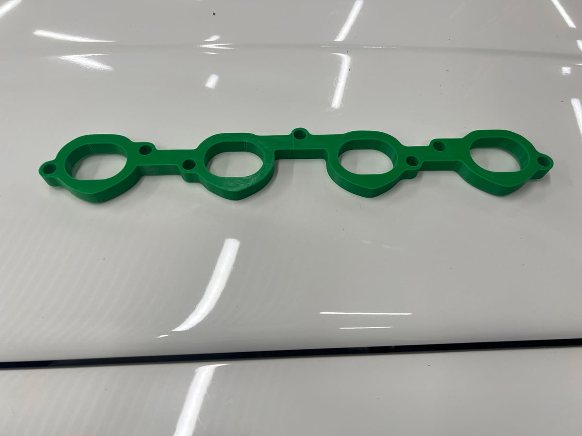

I had some freetime last night and took a swing at doing a dxf for the mounting face based on the PDF provided.
I essentially outlined the pencil drawing as best I could using splines, there are a couple tiny oddities I may be able to work out later, but all in all it appears to be fairly good.
Hole position was within .03mm based on me eyeballing it so I feel that the outline geometry should be reasonably accurate. I made the mounting holes to print.
I then extruded a solid from it 15mm thick and used direct modeling to increase the diameter of the holes to 11.8 (from 8.15) to allow for compression limiters to be inserted later (mcmaster part number 91868A436).
I'm going to do a test print of just 1/4 of the overall part later today if time allows.
If my intake gaskets ever show I I'll be pulling the intake soon and I can do a test fit at that time.
I'll make a post in the 3d print area to attach some of the technical files as the main forum doesn't like those.

I put your STL on my Bambu X1C just to see. I had to split it in two, but Bambu adds automatic connectors that hold it together surprisingly well. I could see it being designed in 3 pieces, with the two outer ports/pieces each having two bolt holes, and the two inner ports being one piece with 3 bolt holes. I assume this is for a 16 valve head, as the ports are slightly different than either of the 8 valve ports. Printed in green ABS, since I had it spooled up and ready to go.
