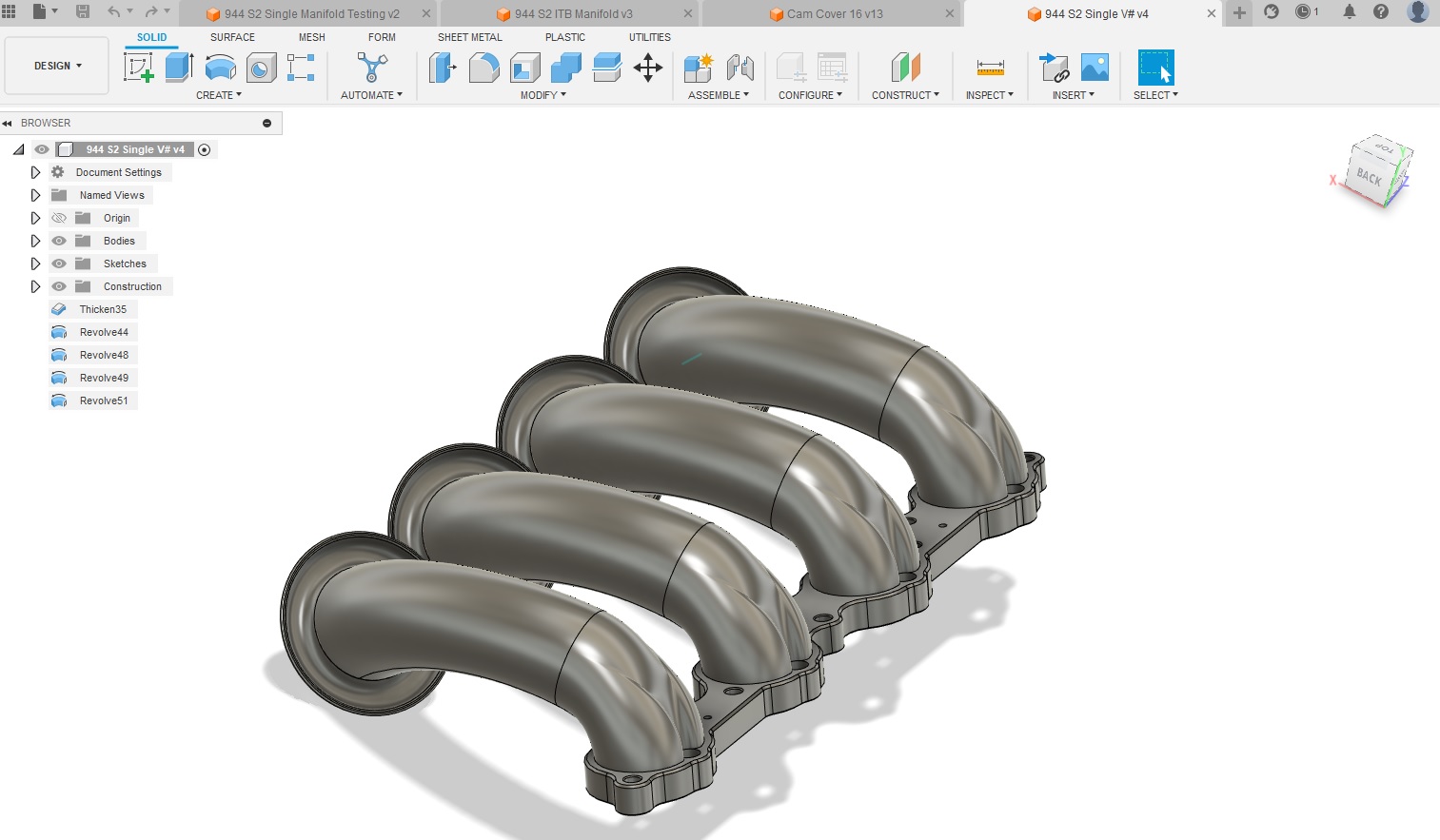

I've printed lots of underhood parts in PC, including a MAP sensor bracket under a 951 intake manifold that is still in service 6 years later. I made a new cam gear housing for my 3L 16V(front and rear) in Nylon 6 with CF, including the cam sensor mount. I do the CAD, and a friend does the actual print. We're making a test piece to pressurize to nail down settings for something airtight under pressure/ vacuum.
My next project is an intake manifold for a 16V NA, and possibly the same for my turbo if it works well. It's important to melt in metal inserts for threads, and metal standoffs for through bolts. Even with 100% infill, printed parts are not that strong in compression.
Someone posted a model of a 968 manifold from grabcad - I've used that as the base for what I'm working on, but removed the plenum and extended the runners. Need to verify the length I can fit in the engine bay, and then sort out plenum design, throttle placement and diptick tube support. It's also designed to use M97 intake gaskets, the port shape and size is close enough.
One of the biggest issues is build volume, and supporting the shapes when you have critical, flat faces at odd angles. This will need to be 3 or 4 pieces, either bonded or bolted and sealed. Adding these features and breaking it into multiple parts later on is pretty easy.
- manifold cad.jpg (166.1 KiB) Viewed 1967 times

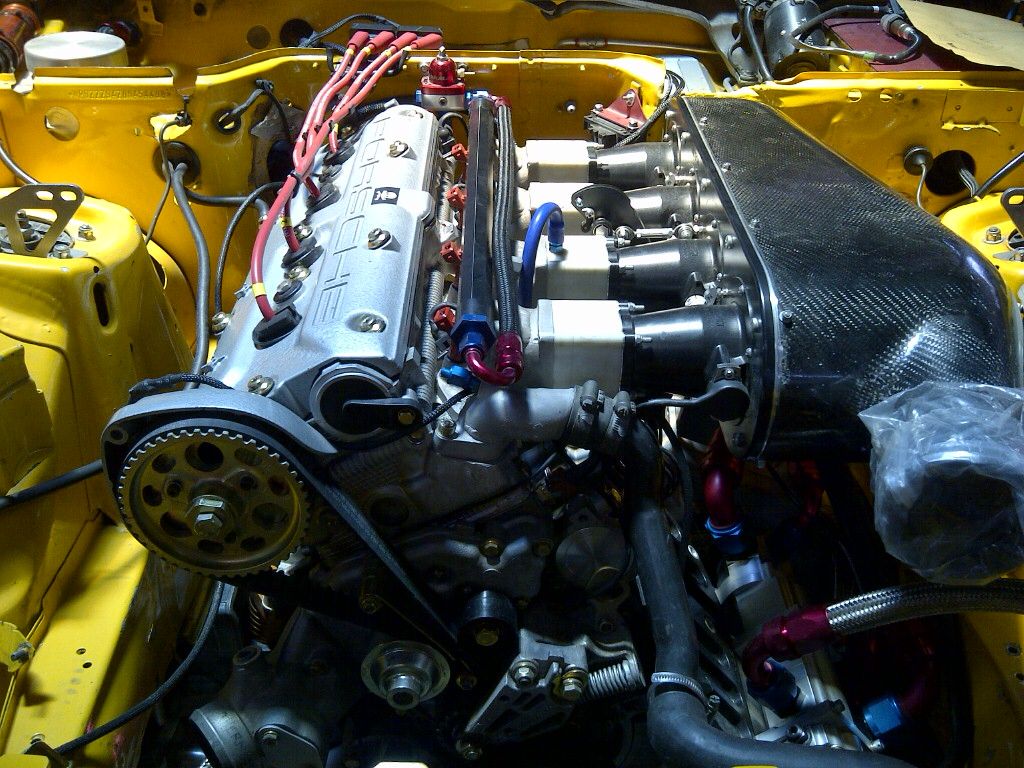

@michaelmount123
Is this the intake kit you’re referring to that uses the AT throttles? Found this on the other website / google.
- IMG_5764.jpeg (200.27 KiB) Viewed 1954 times

No. That system came from Dave Finch at Raetech in MI. The cost was astronomical.cp99 wrote: Fri Jun 07, 2024 3:03 pm @michaelmount123

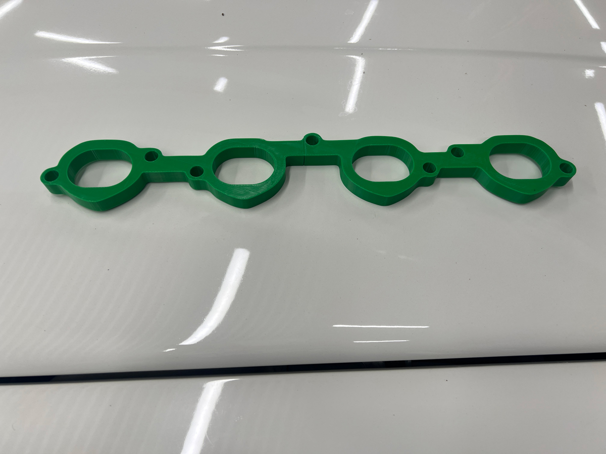

I had some freetime last night and took a swing at doing a dxf for the mounting face based on the PDF provided.
I essentially outlined the pencil drawing as best I could using splines, there are a couple tiny oddities I may be able to work out later, but all in all it appears to be fairly good.
Hole position was within .03mm based on me eyeballing it so I feel that the outline geometry should be reasonably accurate. I made the mounting holes to print.
I then extruded a solid from it 15mm thick and used direct modeling to increase the diameter of the holes to 11.8 (from 8.15) to allow for compression limiters to be inserted later (mcmaster part number 91868A436).
I'm going to do a test print of just 1/4 of the overall part later today if time allows.
If my intake gaskets ever show I I'll be pulling the intake soon and I can do a test fit at that time.
I'll make a post in the 3d print area to attach some of the technical files as the main forum doesn't like those.

Part of the reason I've personally been focused on PC and PC blends. Viable solvent welding vs PA. Though if we're not adverse to a 2 part gun style adhesive Infinity Bond makes a couple interesting products that might work well on pa-cfTC72 wrote: Fri Jun 07, 2024 1:16 pm One of the biggest issues is build volume, and supporting the shapes when you have critical, flat faces at odd angles. This will need to be 3 or 4 pieces, either bonded or bolted and sealed. Adding these features and breaking it into multiple parts later on is pretty easy.
- Posts: 9207
- Has thanked: 961 times
- Been thanked: 4160 times
I put your STL on my Bambu X1C just to see. I had to split it in two, but Bambu adds automatic connectors that hold it together surprisingly well. I could see it being designed in 3 pieces, with the two outer ports/pieces each having two bolt holes, and the two inner ports being one piece with 3 bolt holes. I assume this is for a 16 valve head, as the ports are slightly different than either of the 8 valve ports. Printed in green ABS, since I had it spooled up and ready to go.
