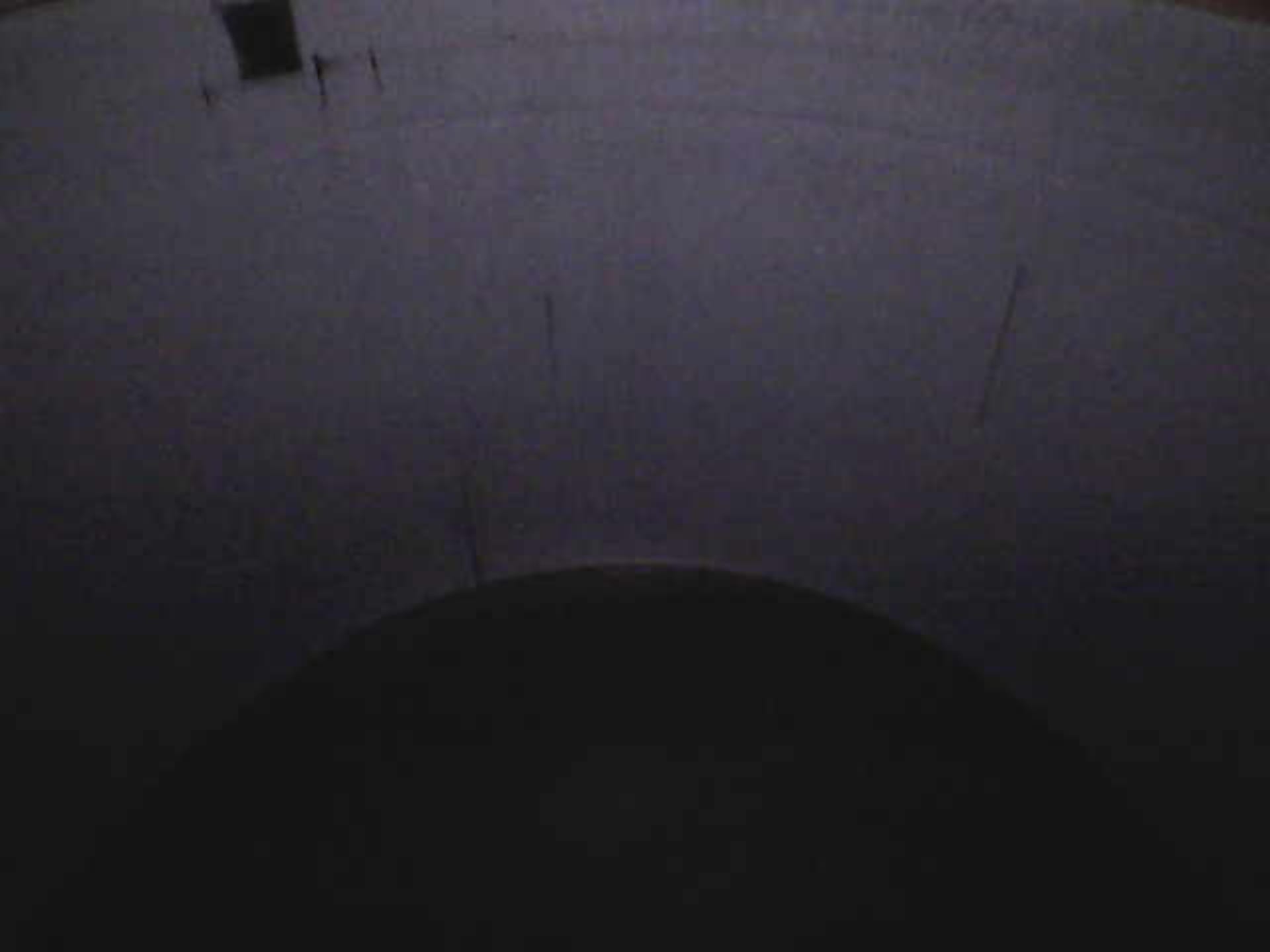

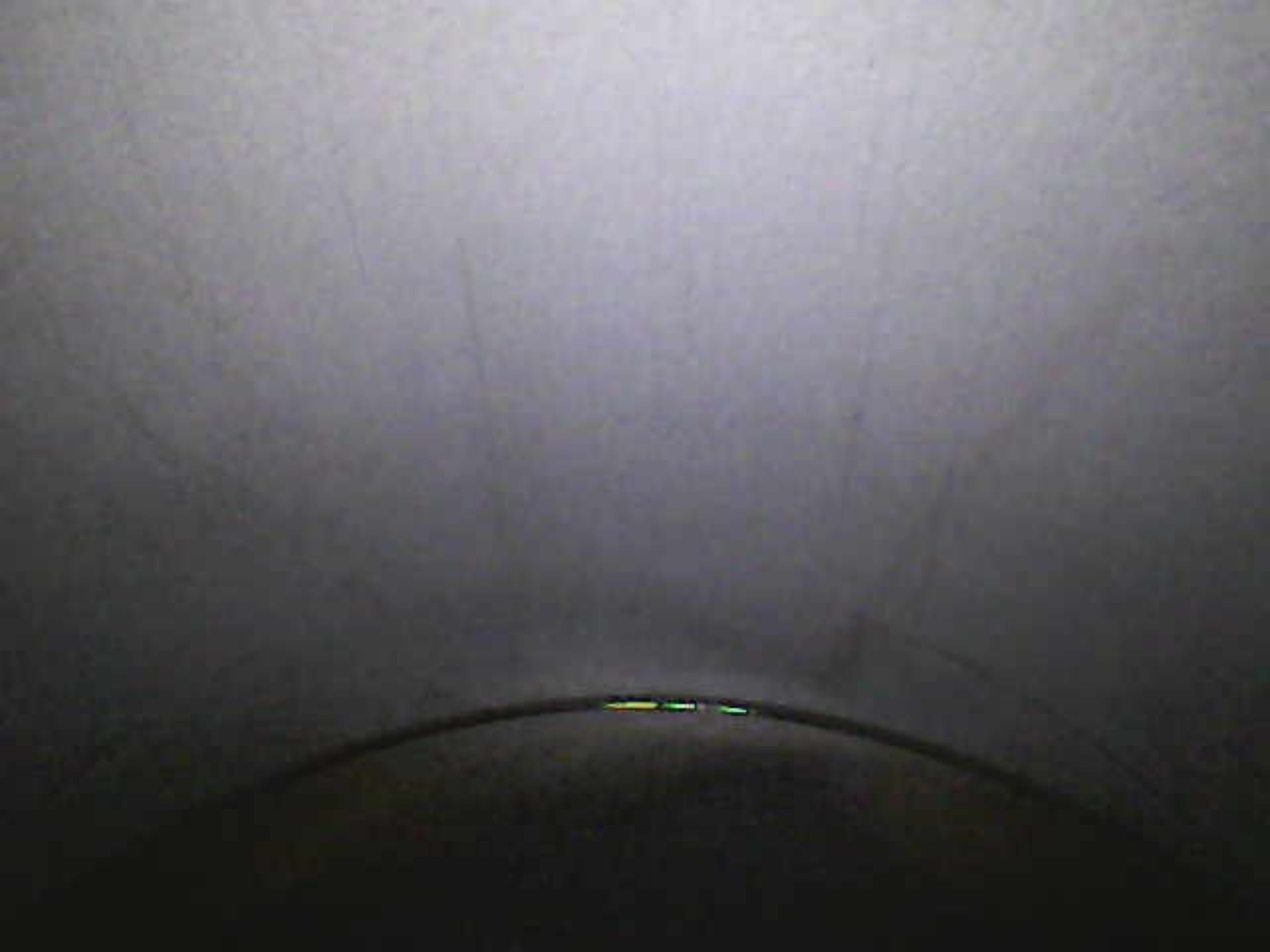

After this rather horrible experience, I reinstalled the starter motor and the various skid plates. I then proceeded to check the cylinders with my new, and indeed improved, boroscope. The results are.. well :think:
Cylinder 1: was on top, couldn't boroscope. but the piston was very blackened and oily.
Cylinder3: piston again very black, oily looking. Has what seem several scratches including a strange dark patch on the cylinder wall. See pics here:

Cylinder 4: less blackened piston, less scratches it seems. See pics here:

The cylinders look pretty typical to me. These motor can run very well with worse cylinders -- ask me how I know. :) Not sure that caused that black area at the top of that cylinder, but maybe some kind of ring issue that had to work itself out...
