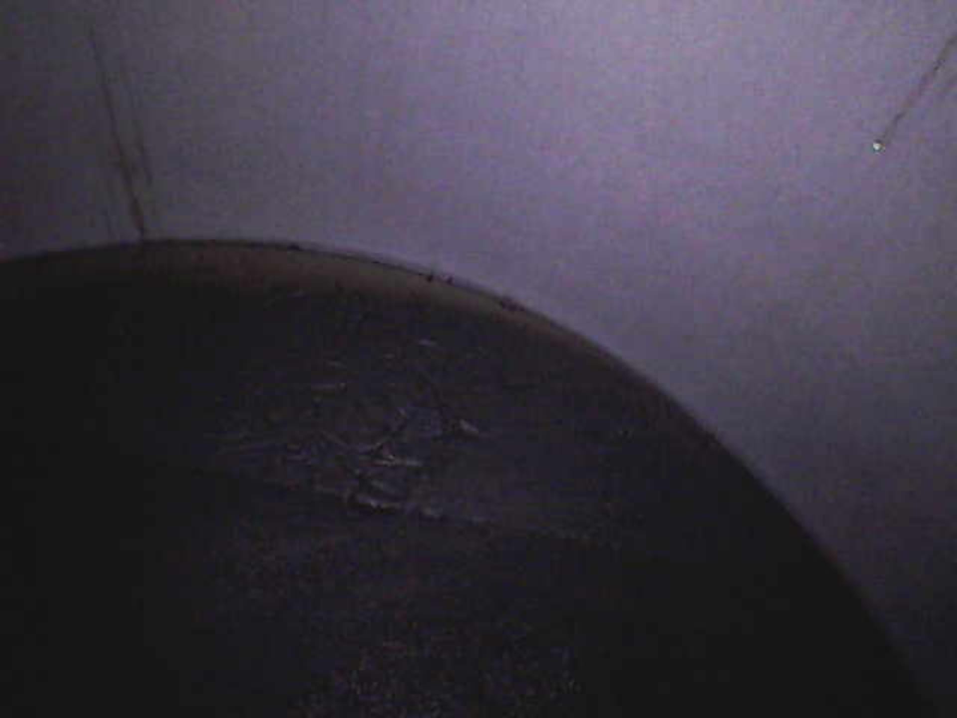

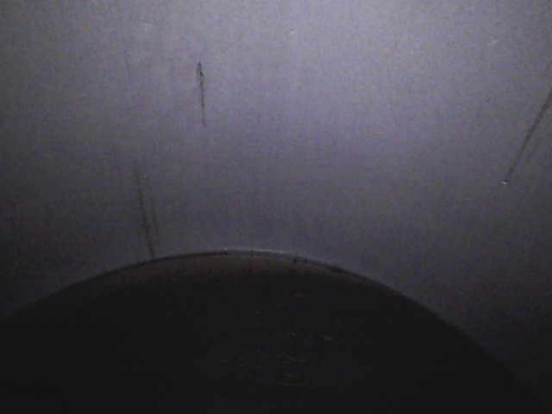

After this rather horrible experience, I reinstalled the starter motor and the various skid plates. I then proceeded to check the cylinders with my new, and indeed improved, boroscope. The results are.. well
Cylinder 1: was on top, couldn't boroscope. but the piston was very blackened and oily.

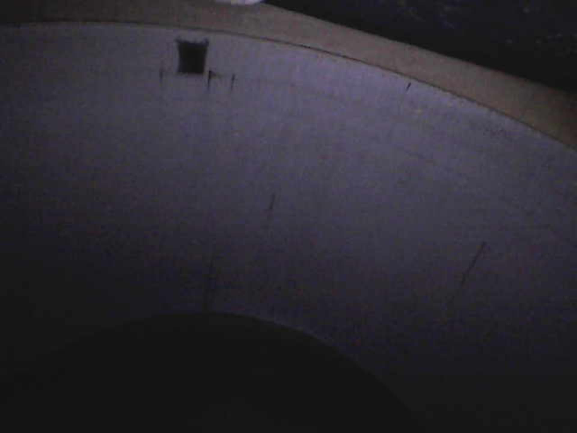

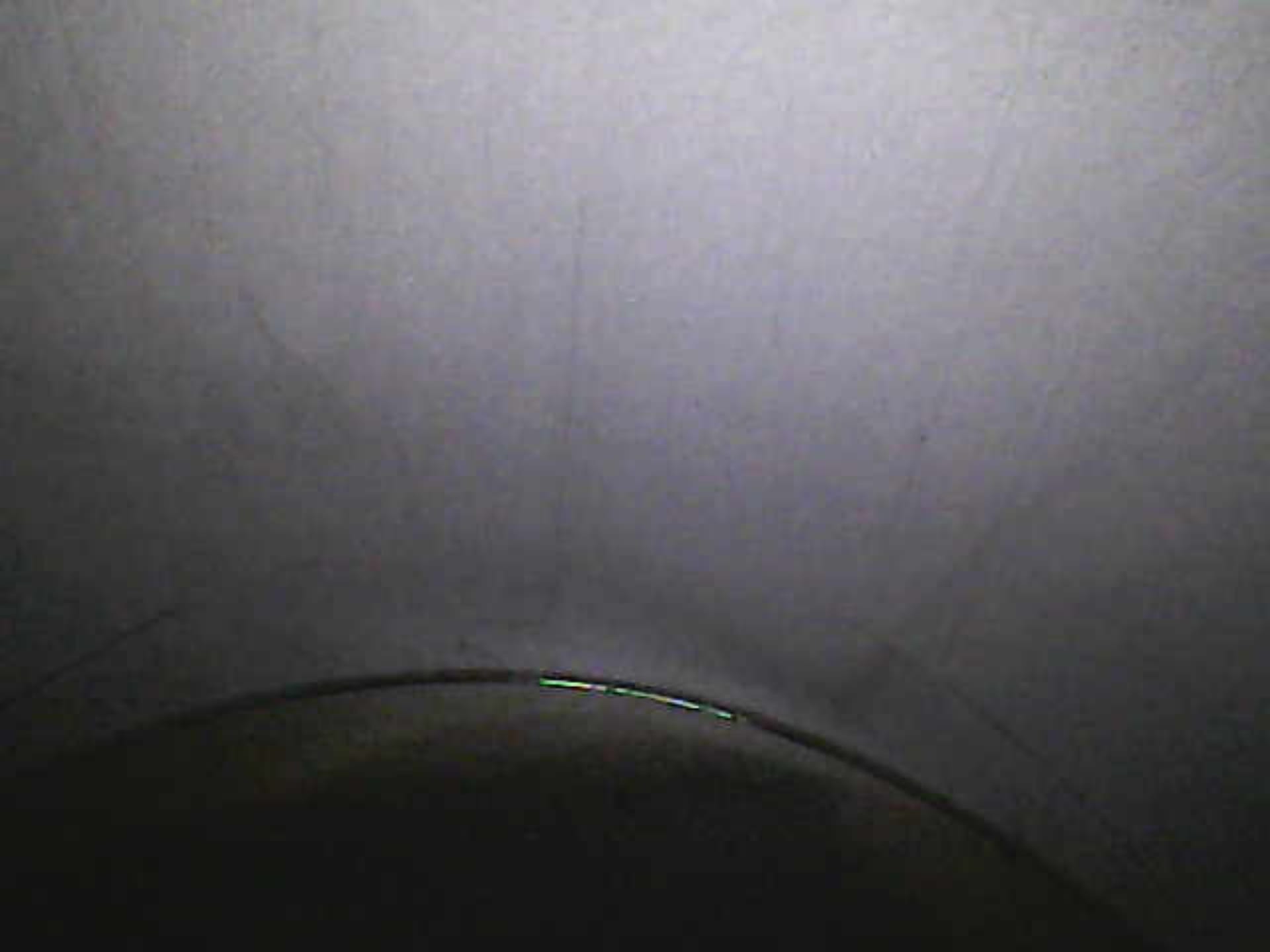

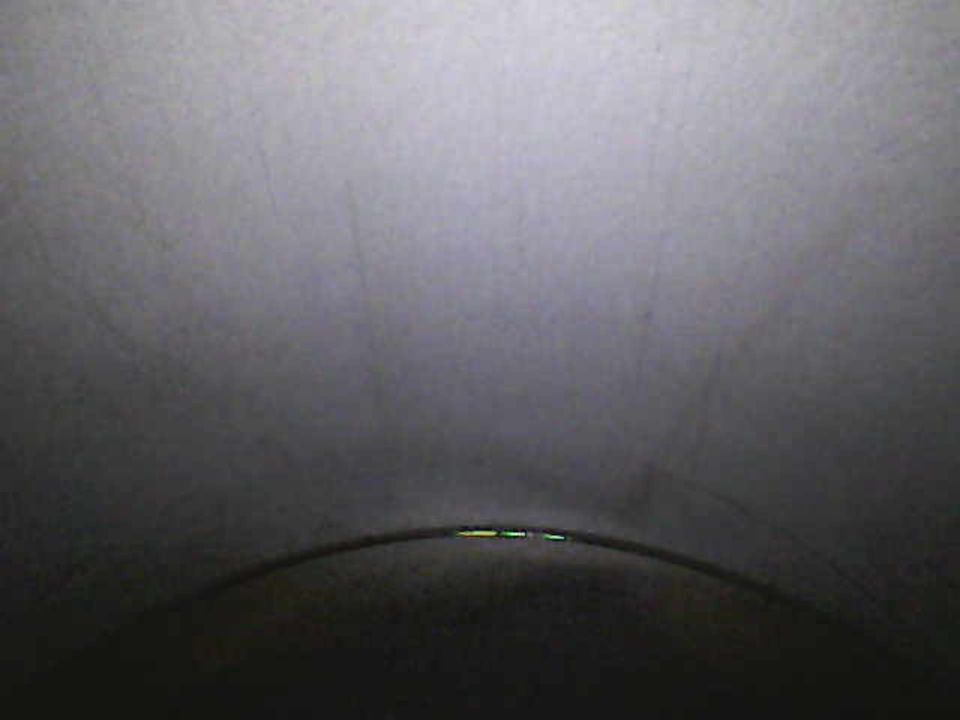

Cylinder3: piston again very black, oily looking. Has what seem several scratches including a strange dark patch on the cylinder wall. See pics here:

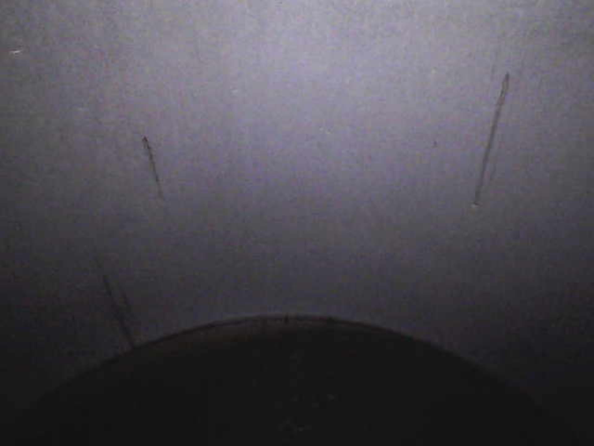

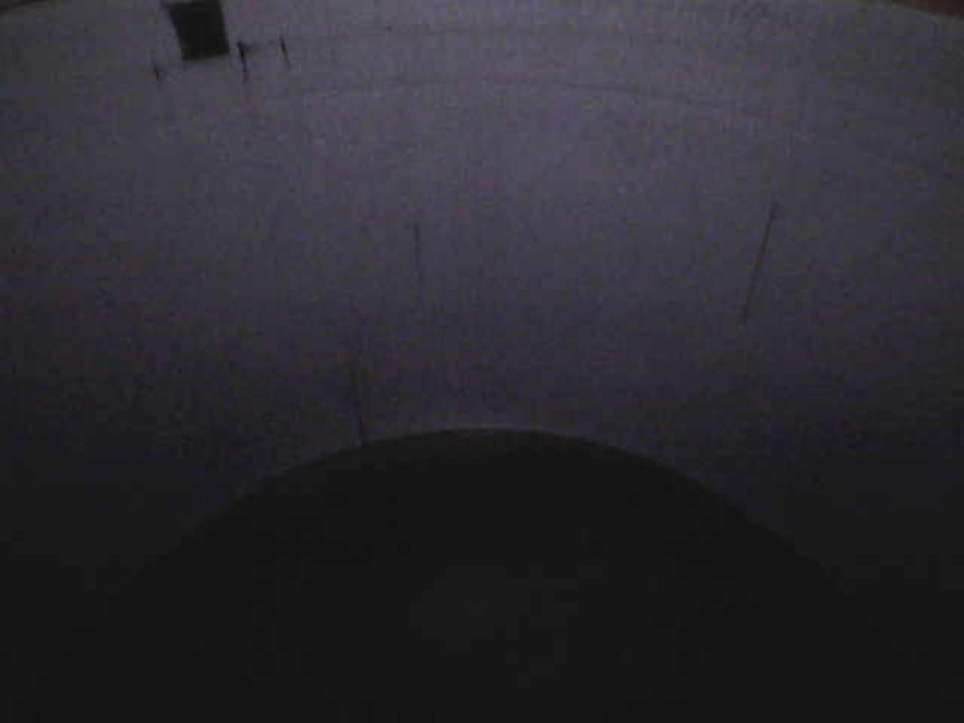

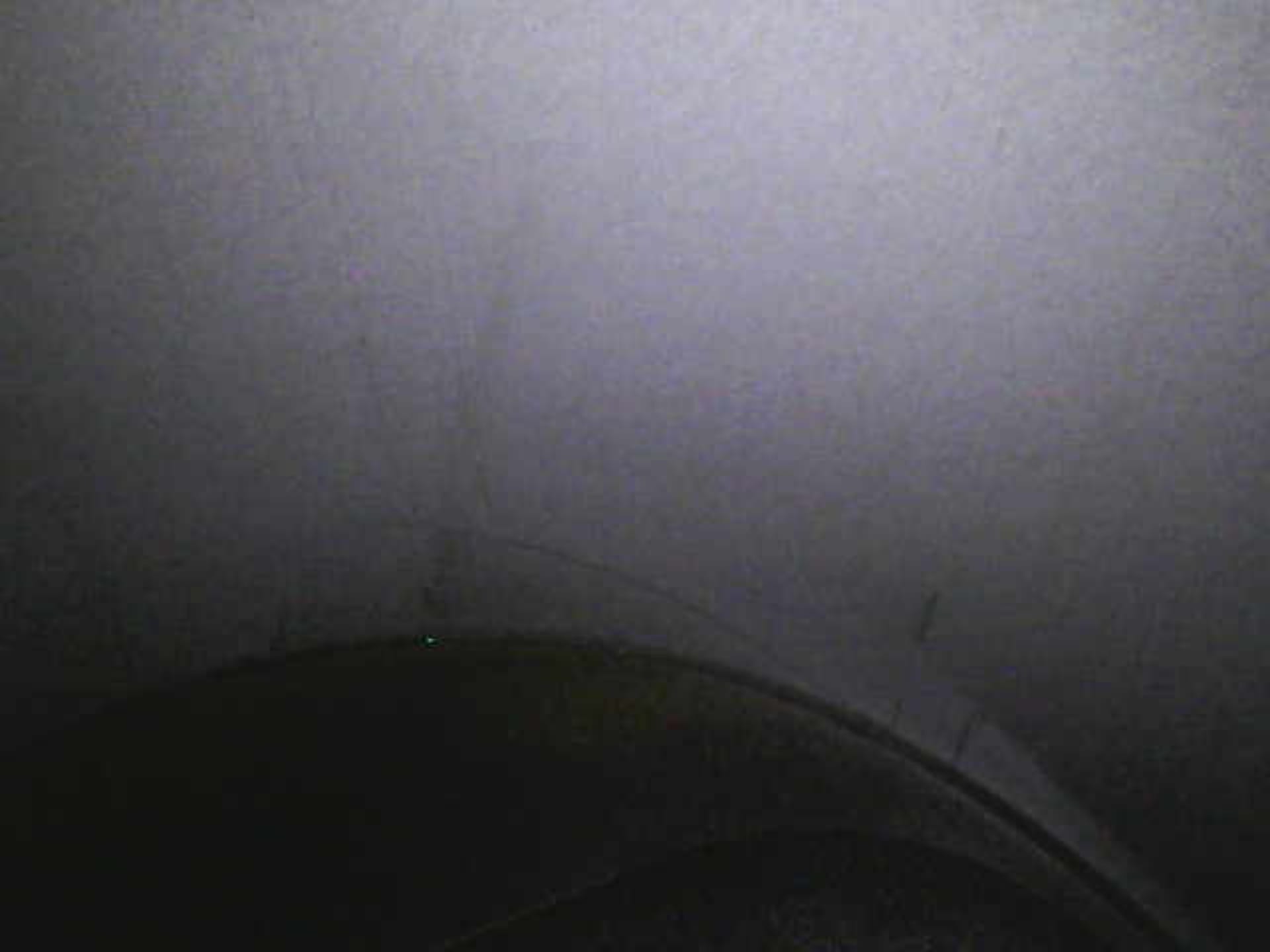

Cylinder 4: less blackened piston, less scratches it seems. See pics here: cylinder 2: was on top, couldn't boroscope.

big update here.
So yesterday and today I had some time to work on the car. I was hoping I could finish it on Saturday, but that blasted bolt the PO put in the downpipe instead of a stud really took me for a spin. Today, I ended up just putting it back in without the tiny washer that was also on there. I tried getting a new bolt, grinding down that bolt, getting another one, grinding that one, ... I just gave up for now.
So the good news is that after too many hours of struggling with this bolt, I go the complete exhaust back in. I think I'll have to remove the back section again later because the four bolts that hold it to the cat section seem unable to completely close the sections together. It's like that big sealing ring isn't seated 100% correctly in the exhaust. But for now, it should do.

Others might disagree, but if it were me, I would change the oil and the filter before doing anything else. It's no longer really oil with a ton of solvent in it, and you could be doing a lot of cranking over the next little while. Your pics of the cylinders look good to me and I don't think they show anything out of the ordinary, maybe just a few small minor scratches from years of use.

The cylinders look pretty typical to me. These motor can run very well with worse cylinders -- ask me how I know.

I'm relieved to read that my cylinders seem fine! I'll do the oil change first thing. Would adding 'Slick 50' help? My mechanic teacher said it would help protect the cylinders. It makes sense to also do the fuel loss test ICB described earlier... don't want to change oil every 500 km lol!
