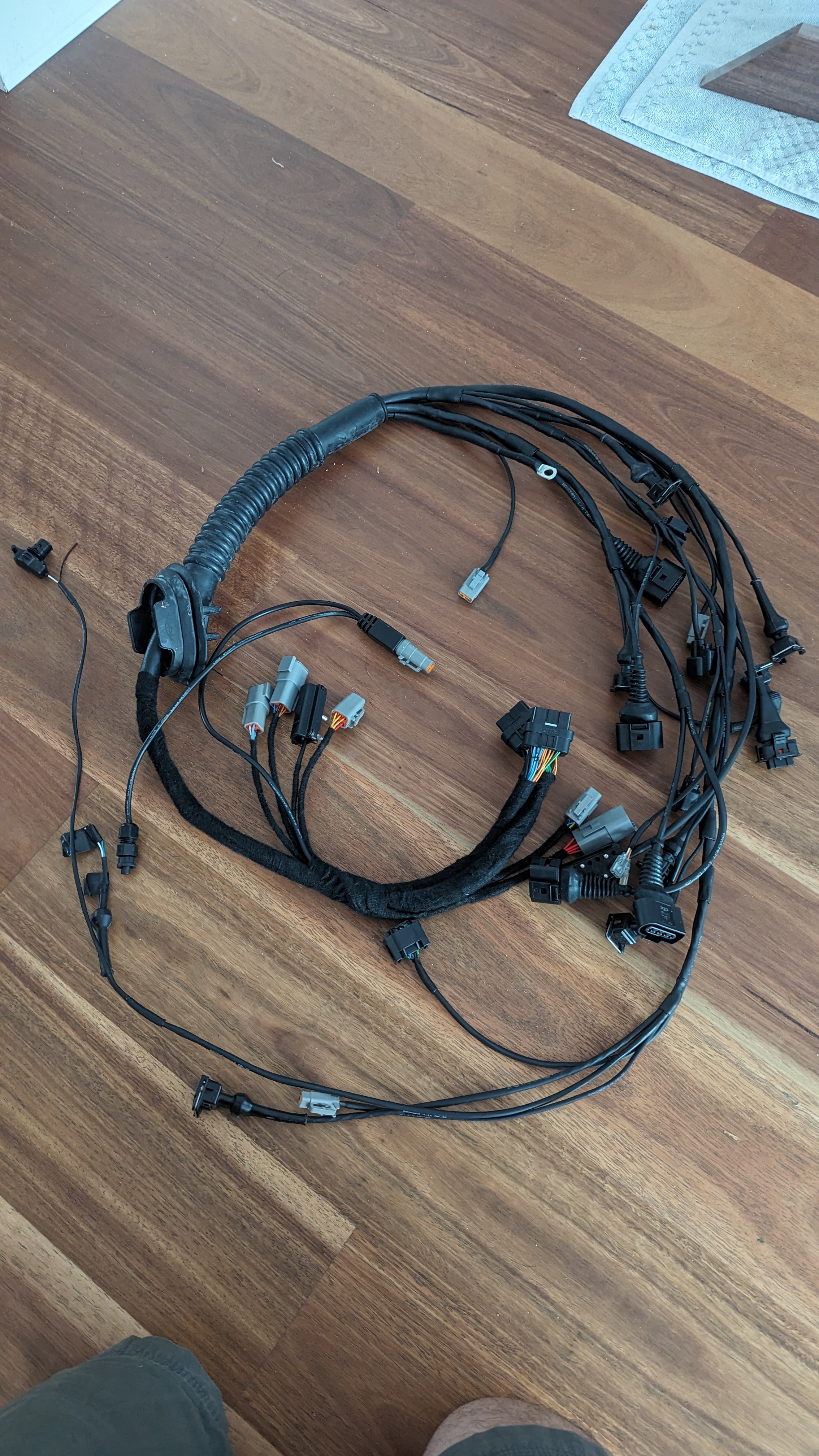

Harness is finished apart from a wayward DTM plug for the oil pressure sensor. Just a few tweaks to the PDM and interior harnesses and it's time to setup the Link.

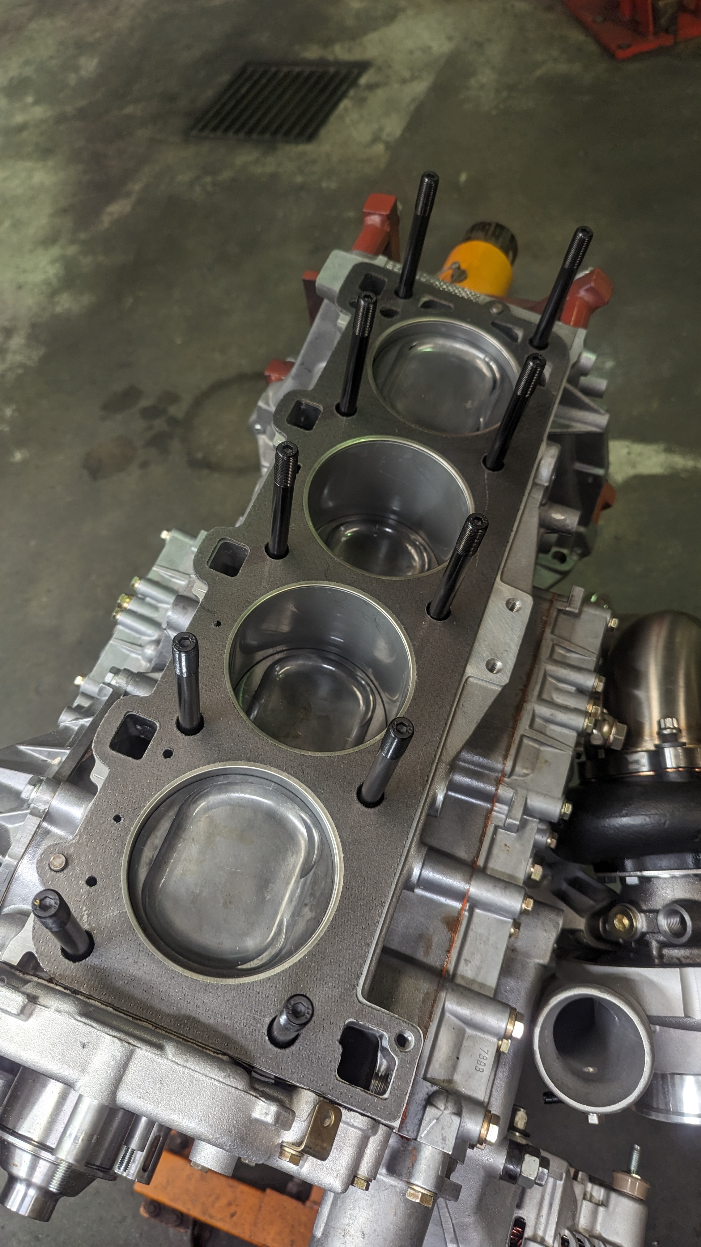

by Bergerac

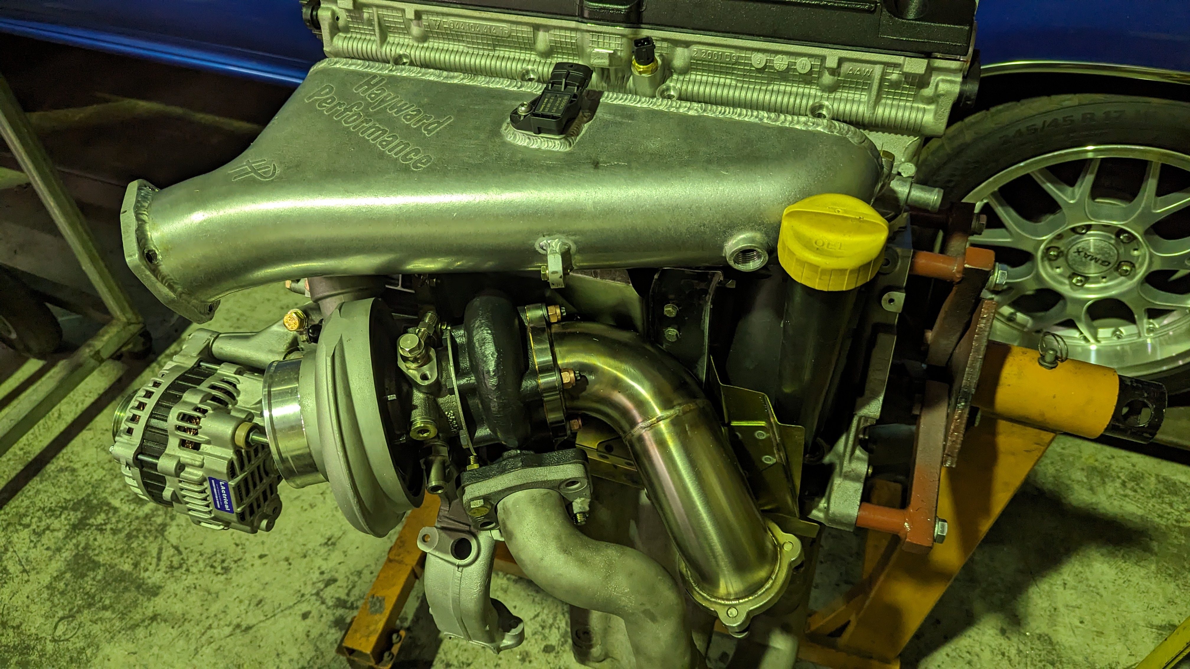

Finally got some time to work on the motor, the head is now on and torqued down. We're just waiting on the last of the turbo heat shields and the rear support bracket to arrive from the US. Once that's here we can finally bolt up the turbo correctly and mod the crossover flanges and weld in the EGT and EMAP ports. Then a big pile of parts go off for zinc and ceramic coating.

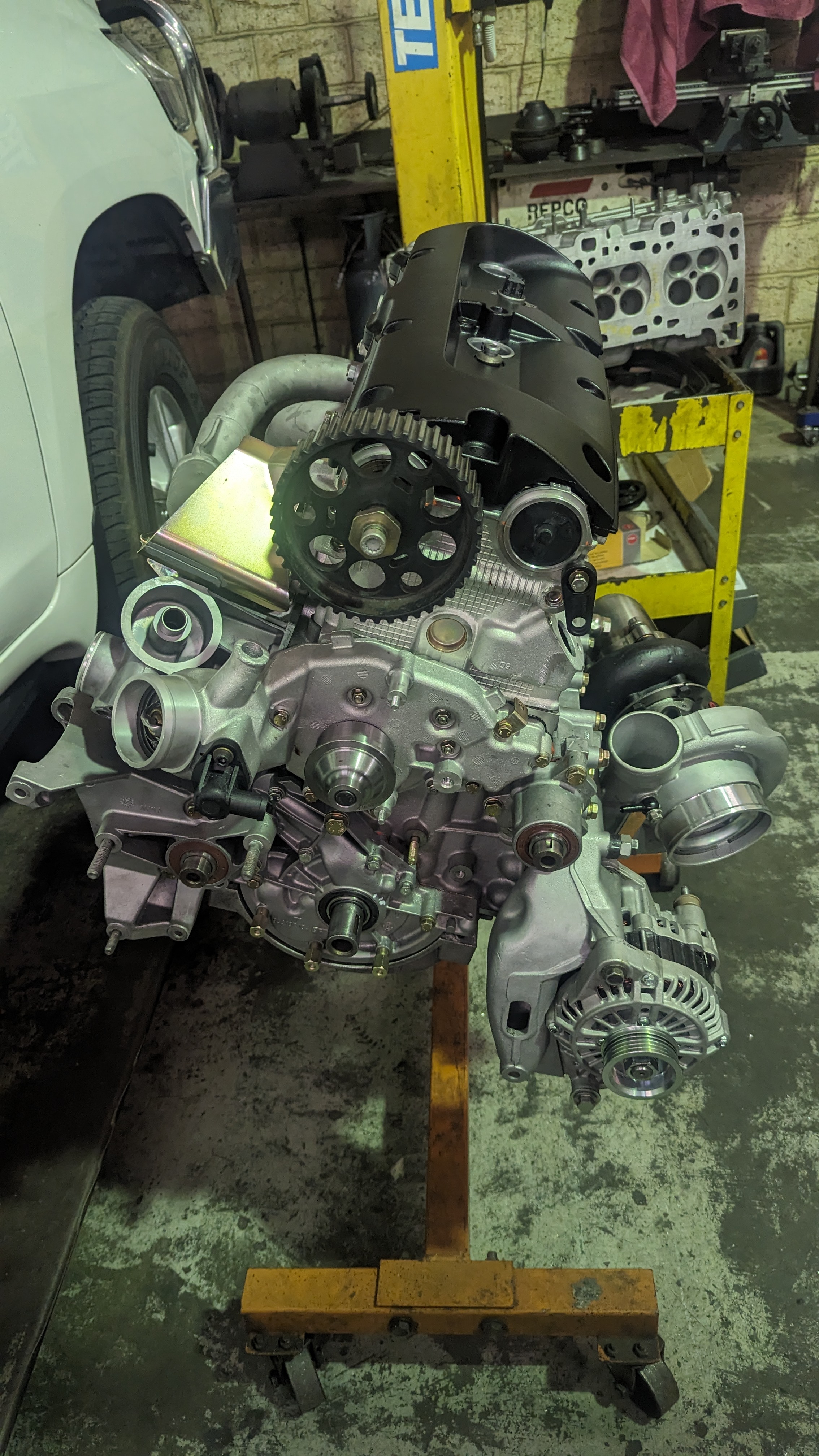

by BasHenneman
Nice work Luke! Are you keeping the camgear open like this or reinstalling the cover?

BasHenneman wrote: Tue Apr 02, 2024 11:24 pm Nice work Luke! Are you keeping the camgear open like this or reinstalling the cover?
No covers will go on later, I have to swap the oil pump, I got a sent a turbo one and it doesn't have clearance for the 16V tensioner

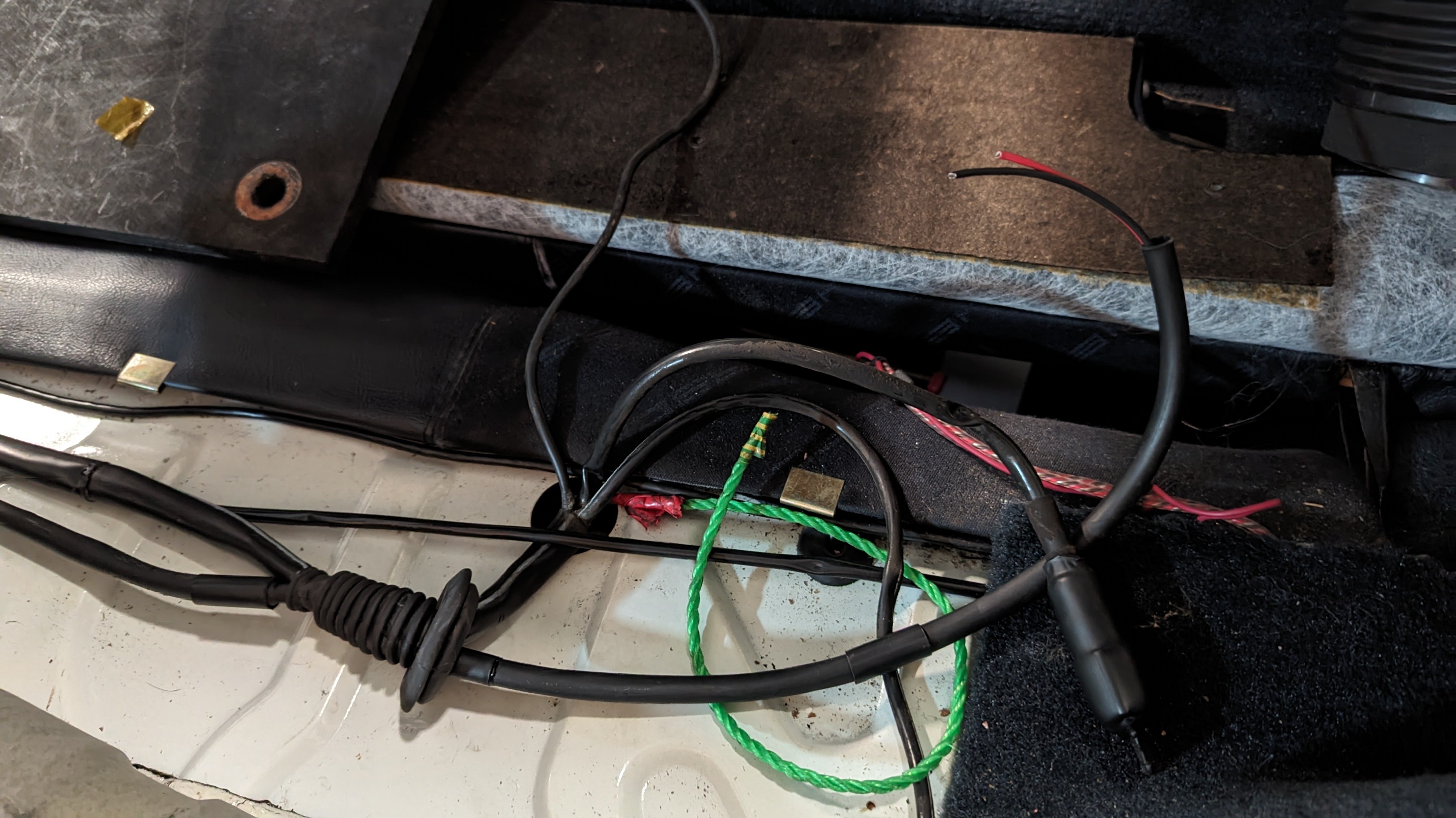

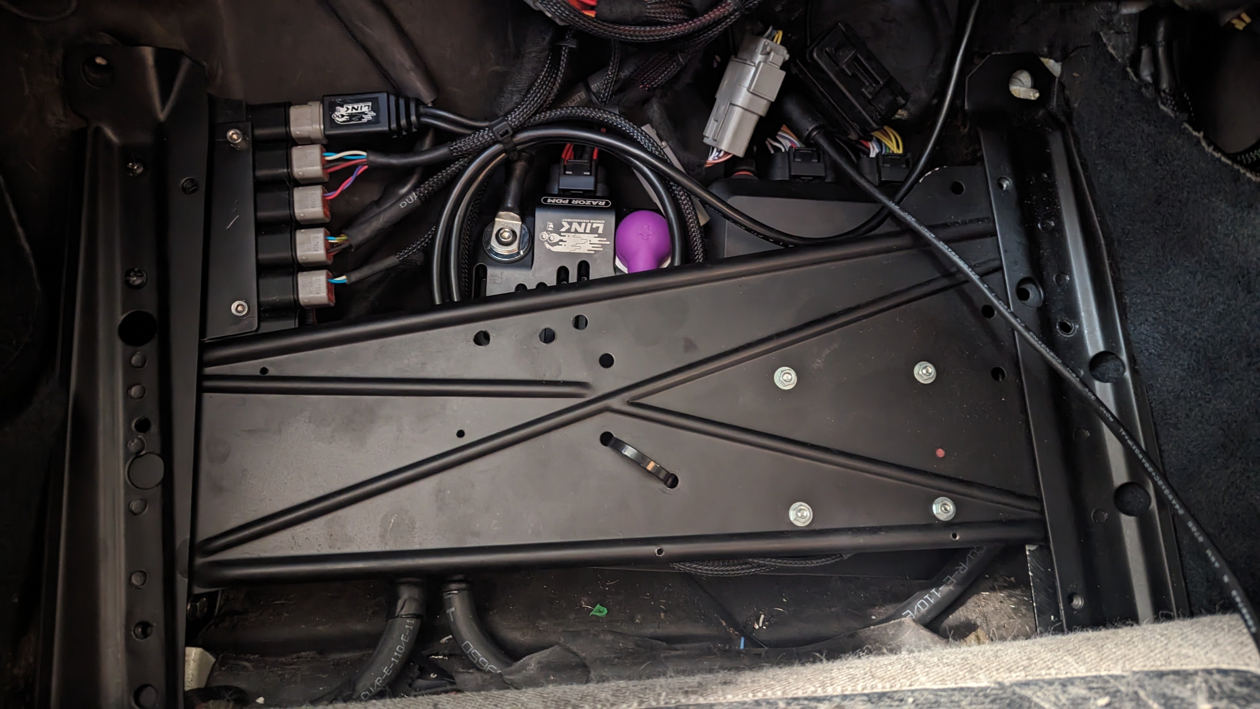

Interior wiring is finally complete and all bolted in, its packed in tight so Im a bit worried about heat but Ill have to see how that goes when its running.

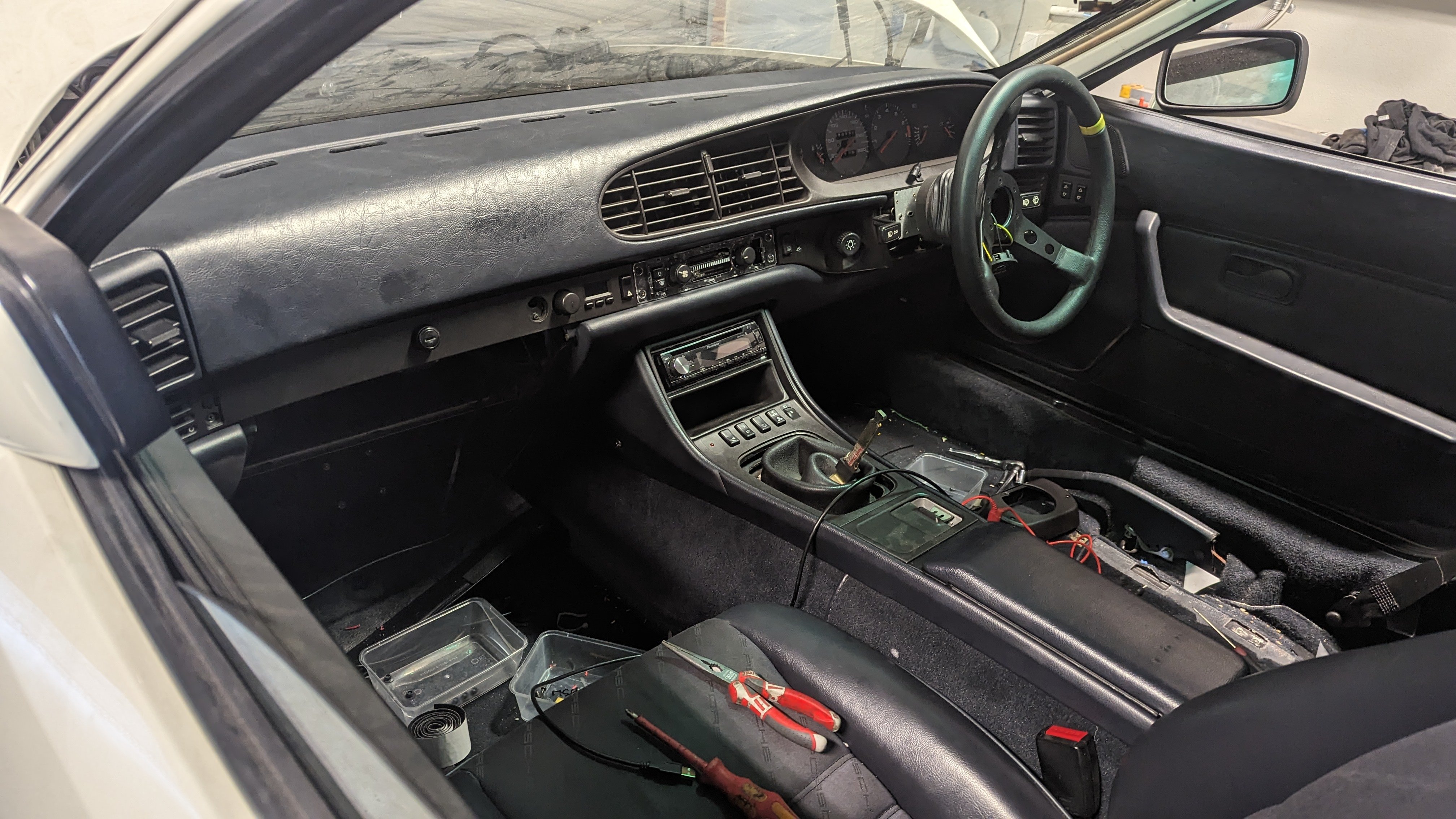

Dash is almost back in after the A/C repairs, replacement Carpokes HVAC control cover is installed but I dropped my A/C switch which exploded into 1000 pieces, so Ill have to source one of those.

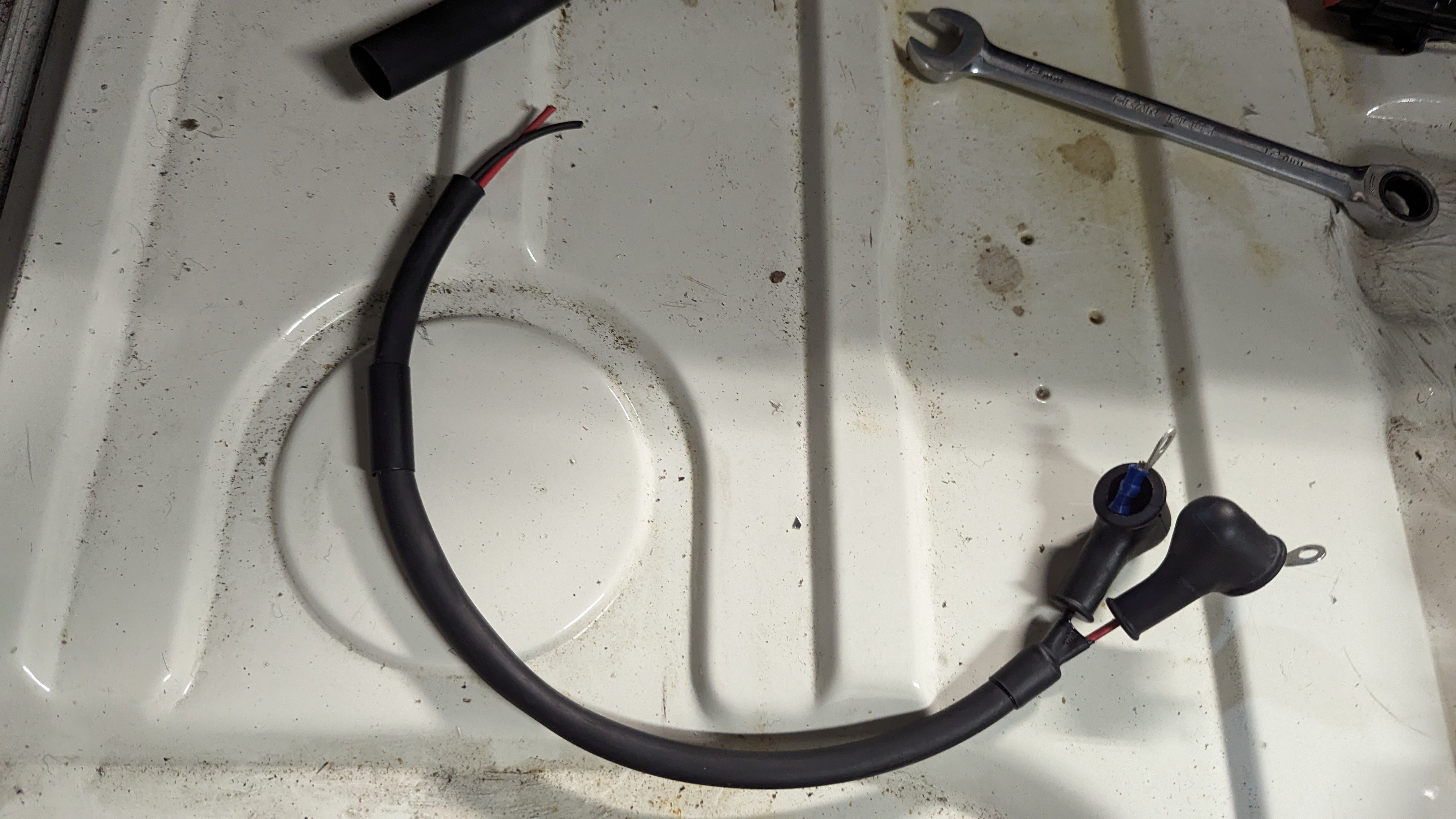

Upgraded fuel pump wiring was finished today after my DTP connector and crimpers arrived, I thought I was going to get away with DT but the Bosch '200' fuel pump should draw around 15A. The original wiring is left in place and sealed up if I ever need to go back to stock.

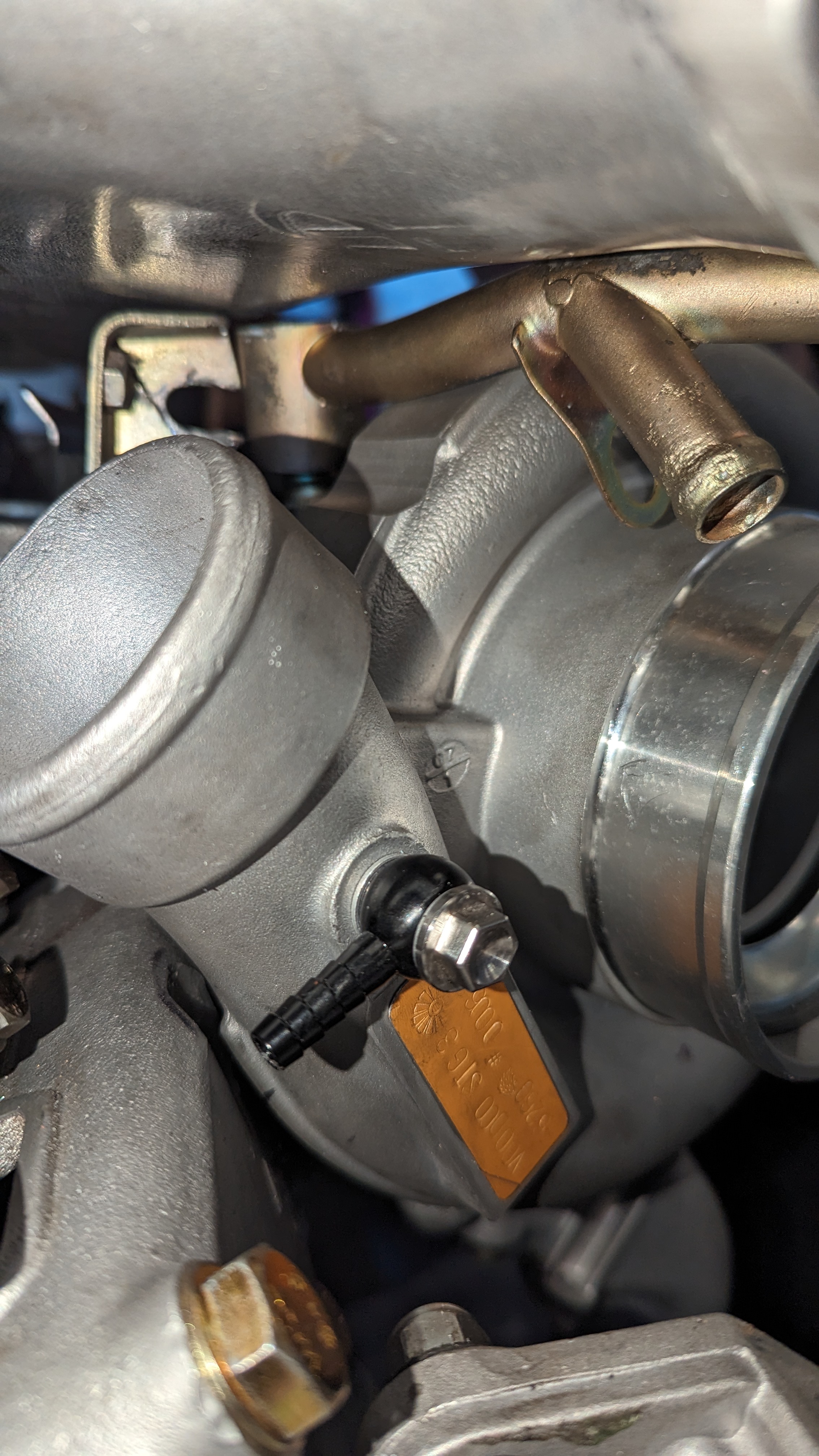

In the process of modifying the intake manifold braces and turbo coolant pipe to solve some clearance issues with the Hayward manifold. I will most likely be deleting the switch and setting up some logic in the ECU to run the pump based engine temp and runtime.

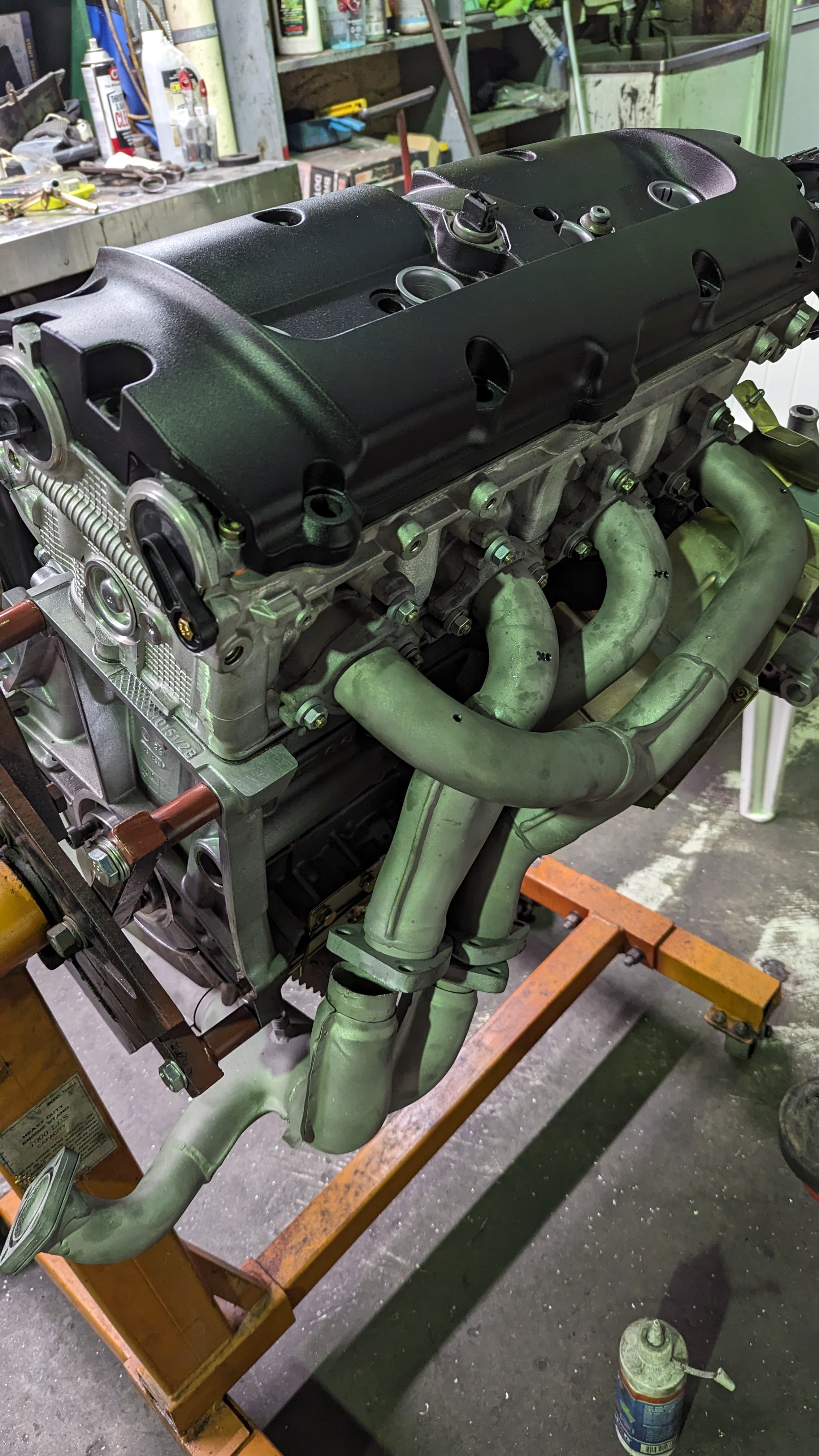

Crossover mods to mate up to the S2 headers are underway.
