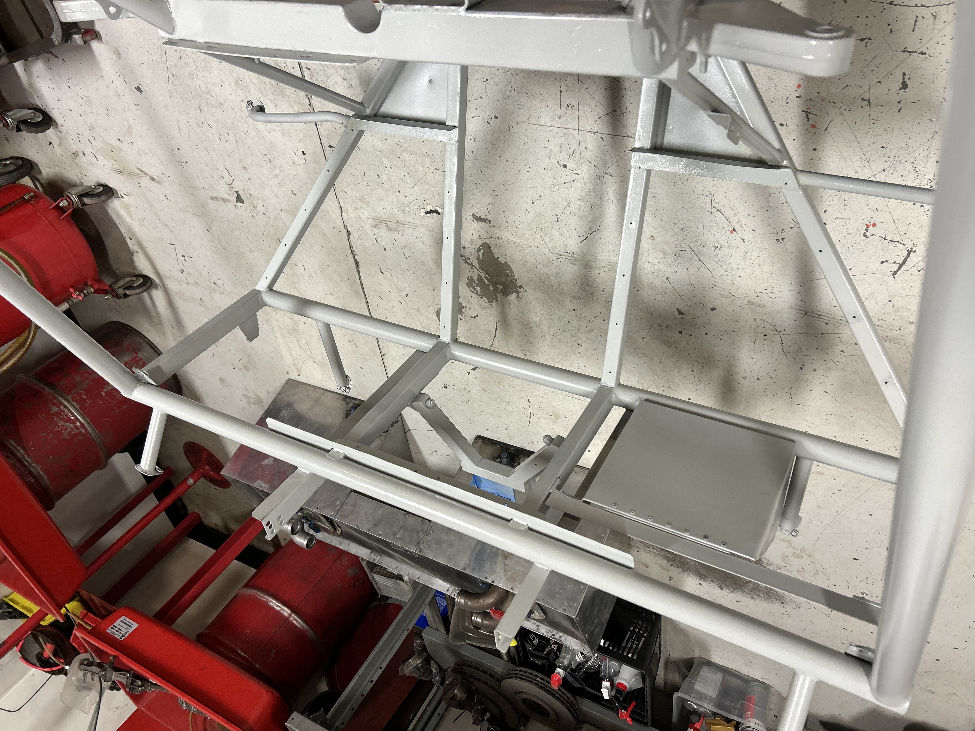

A little cleanup prior to and during reassembly.

That last picture piques my interest Michael. Do you know what the gearbox is? When viewing the incar video it really sounds like they have straight cut dog engagement gearing as he is able to shift very quickly. Maybe flat shift? I'm trying to source something for my car that will offer equally quick shifts while minimising boost loss. The video:
I was advised that the driver is a Colin D. Apparently they were having some issues and he wasn't driving super quickly.
