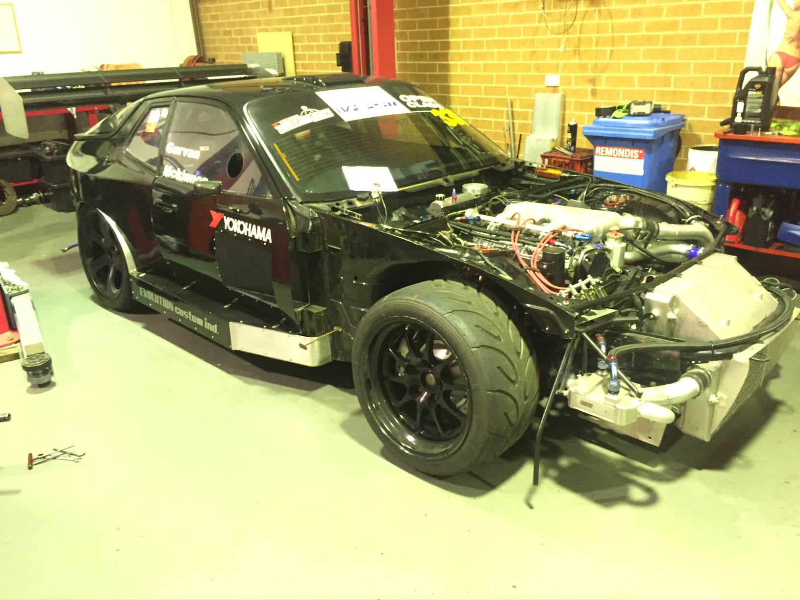

That's what I thought. We ran my car on the front with max -neg as we could get and this is on a road legal R spec tyre. I think you'd quite like the tyre we use which is the Yokohama AO50 but I don't think they're available in the US? My guess is that they'd sit somewhere between the Radial and Bias ply offerings. You can get them in a few different compounds.

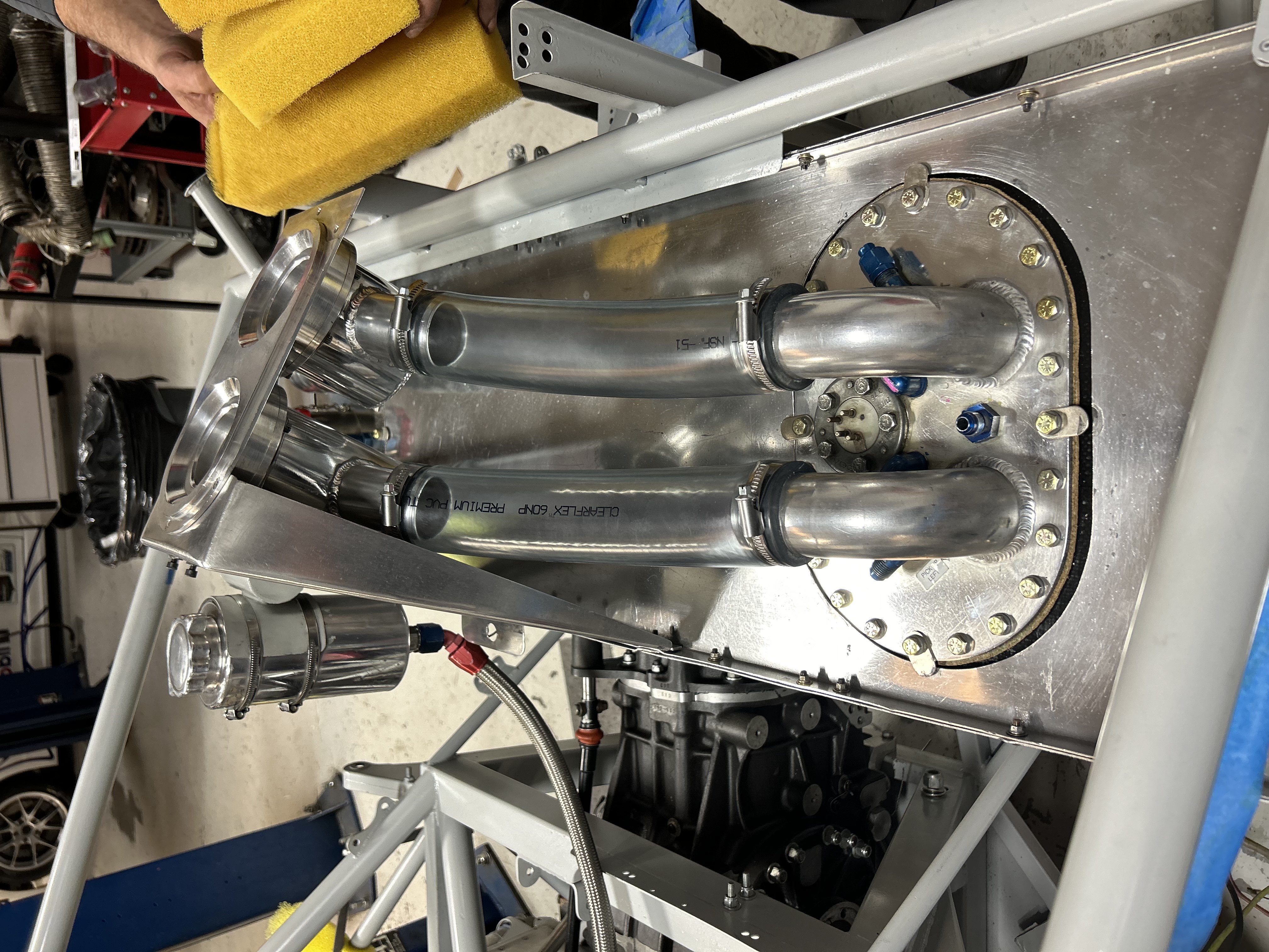

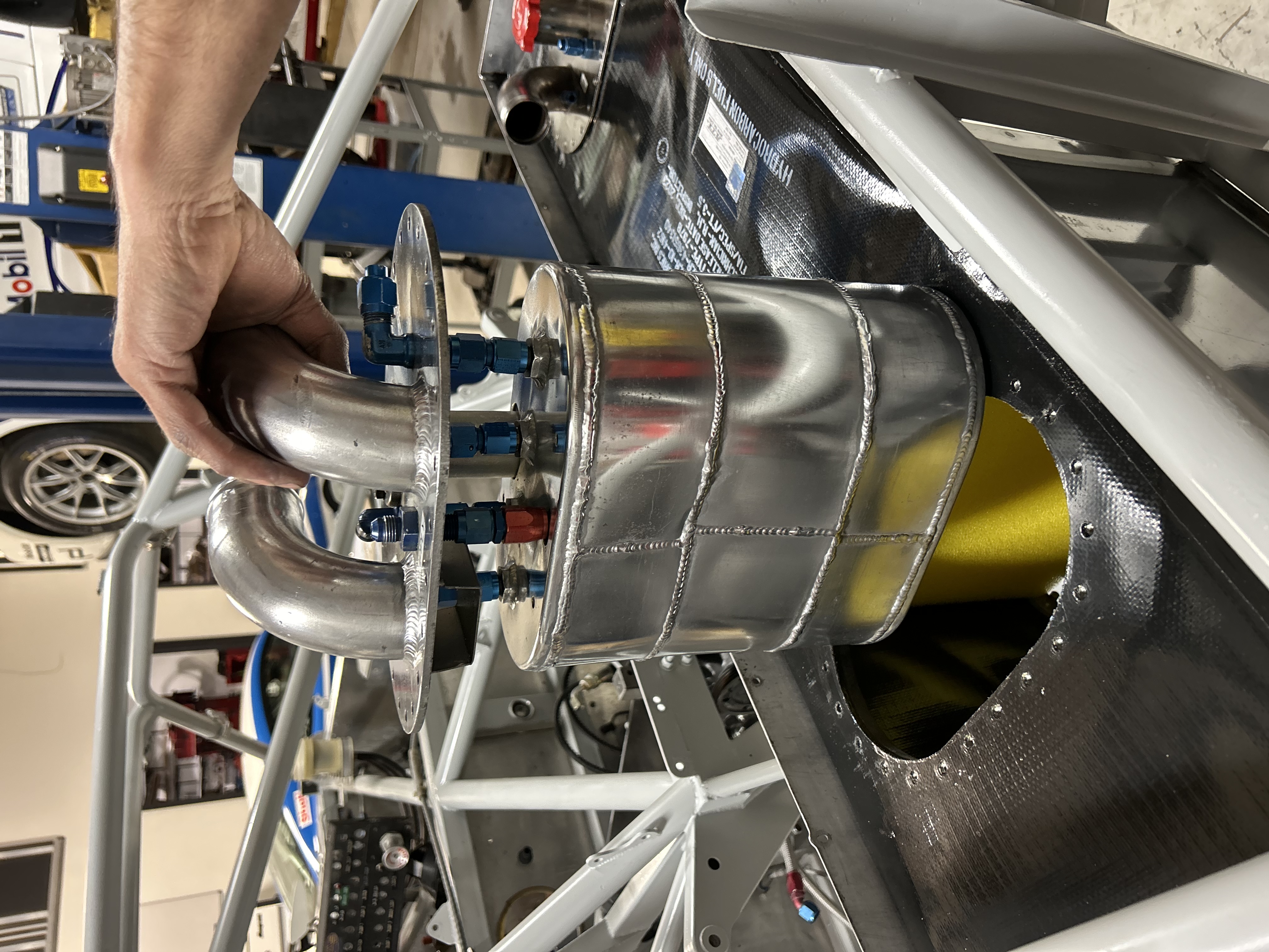

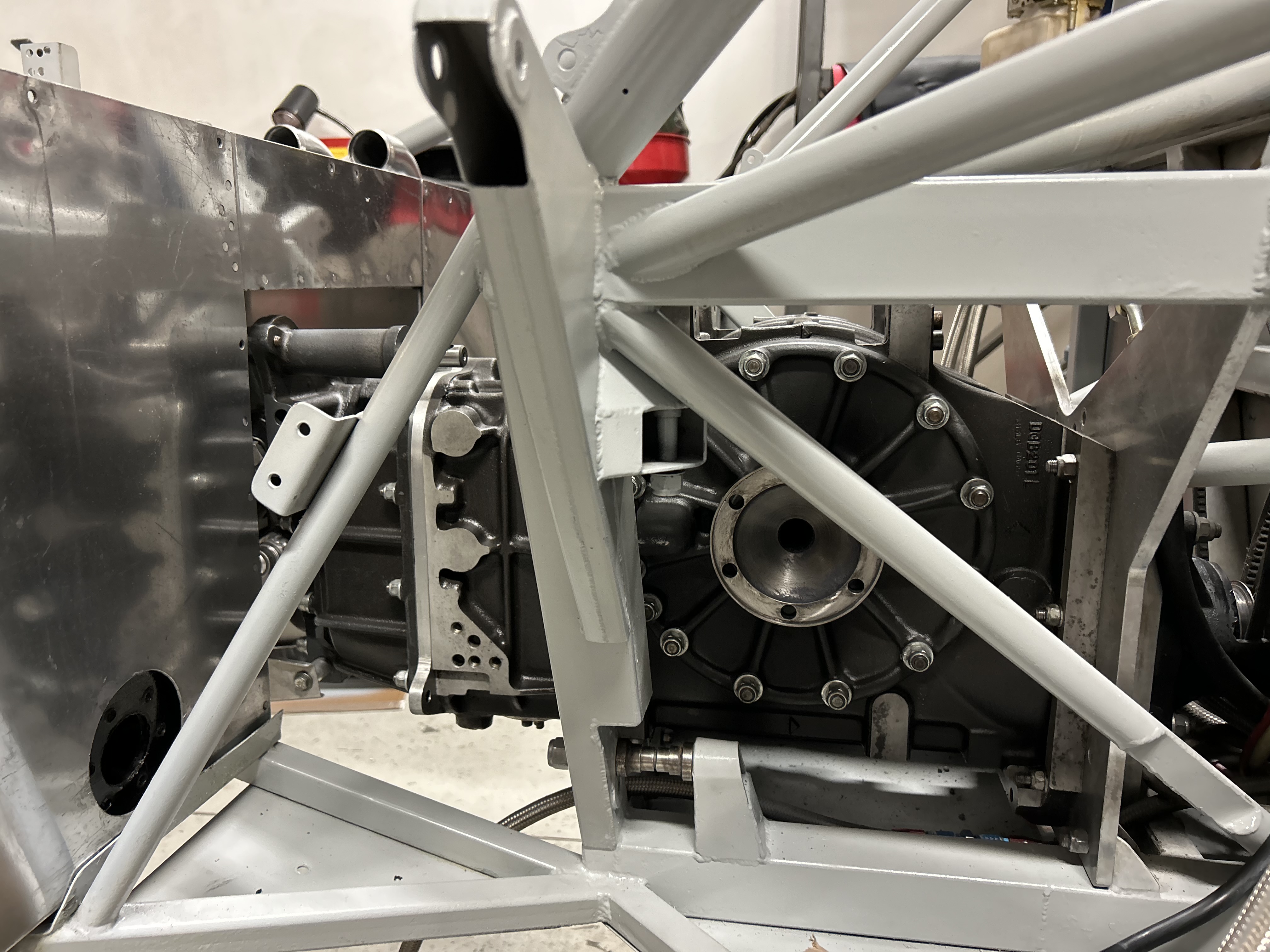

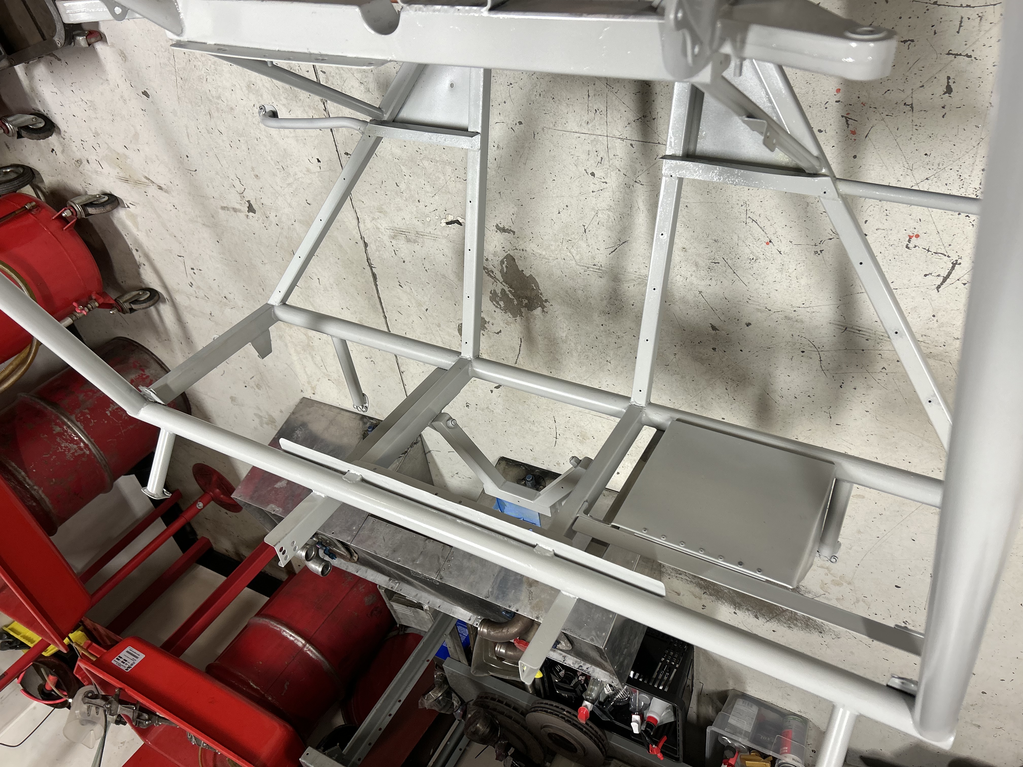

A little cleanup prior to and during reassembly.
- 72842379192__472444BF-2DAF-440B-A655-3467C1D8F228.jpeg (3.95 MiB) Viewed 836 times
- 72774192337__34A92146-EE74-4C70-9536-2CC186404BDC.jpeg (3.18 MiB) Viewed 836 times
- 72774197232__52787973-E74E-49A4-886E-FCDBEAFFA8F0.jpeg (2.61 MiB) Viewed 836 times
That last picture piques my interest Michael. Do you know what the gearbox is? When viewing the incar video it really sounds like they have straight cut dog engagement gearing as he is able to shift very quickly. Maybe flat shift? I'm trying to source something for my car that will offer equally quick shifts while minimising boost loss. The video:
