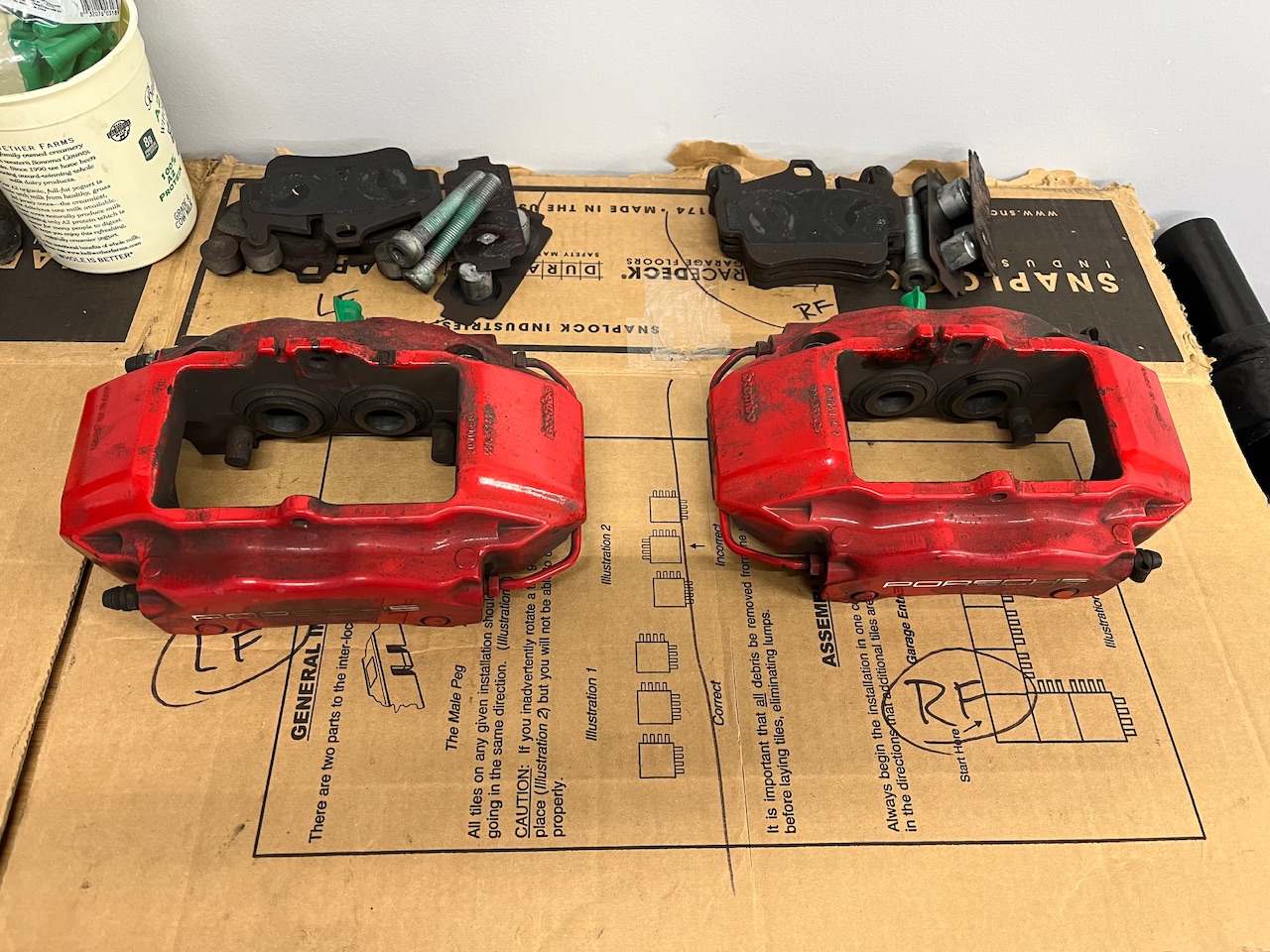

Also spending some time cleaning up the calipers so I can repaint them. So much caked on grime!

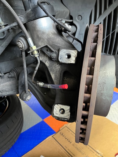

On the brakes, did you just crimp off the lines or will you do a full R&R of the brake fluid? A fluid flush is on my short list of projects for this spring, but I've tested the water content in the fluid and it is still showing "good" with minimal H2O content. Not sure I really want to change the fluid if it is testing good.

I did stop the brake lines, but they will still need a full flush. It’s due anyway since it’s been a couple of years.aboyandhisdog wrote: Sat Jan 20, 2024 6:02 pm On the brakes, did you just crimp off the lines or will you do a full R&R of the brake fluid? A fluid flush is on my short list of projects for this spring, but I've tested the water content in the fluid and it is still showing "good" with minimal H2O content. Not sure I really want to change the fluid if it is testing good.

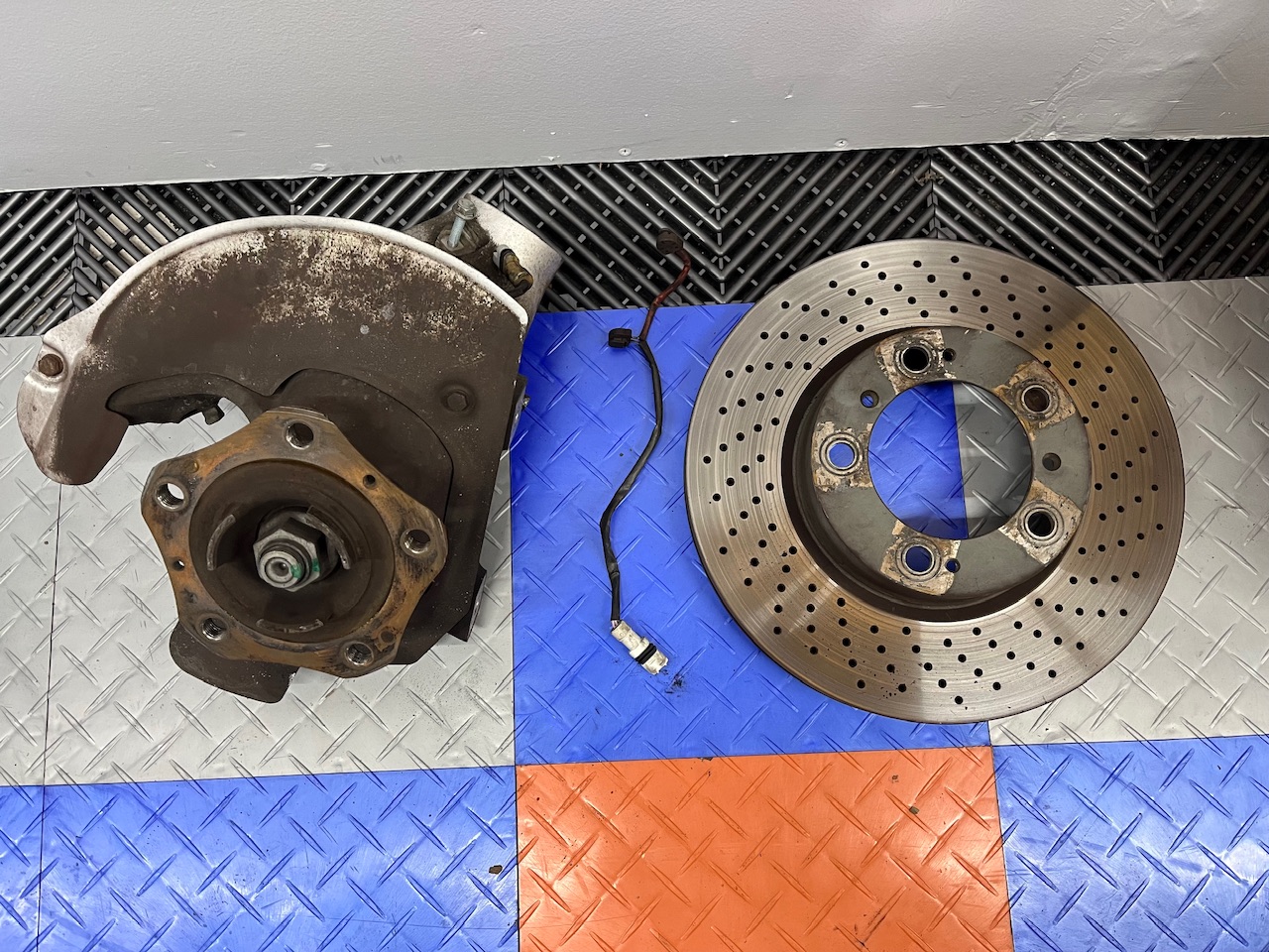

Imagine my surprise when the rotor fell off the driver side wheel carrier as I was removing the damper! Fortunately it didn’t land on my foot. Nice that someone left those screws off. It seems one rear rotor only has a single screw instead of two. Nice work previous mechanic!

Woah! Glad you found it when you did. Someone somewhere was disinterested, distracted, untrained - or something! Sloppy and dangerous for sure.vitaminc wrote: Sat Jan 27, 2024 9:25 am Imagine my surprise when the rotor fell off the driver side wheel carrier as I was removing the damper! Fortunately it didn’t land on my foot. Nice that someone left those screws off. It seems one rear rotor only has a single screw instead of two. Nice work previous mechanic!![]()

A big reason I do all of my own work. Nobody to blame but myself. I can't remember when I have taken my vehicles to a shop that something didn't come back broken or with a fastener or two missing. People make mistakes, I get it, but for some $200/hour and triple the retail on parts, I set the bar a bit higher for the shop to give exemplary service. Usually disappointed.

PS- those caliper screws are only $1 each! I can't believe someone would leave them off. The PO's mechanic was not good. I've found so many missing fasteners and other issue related to their work.
