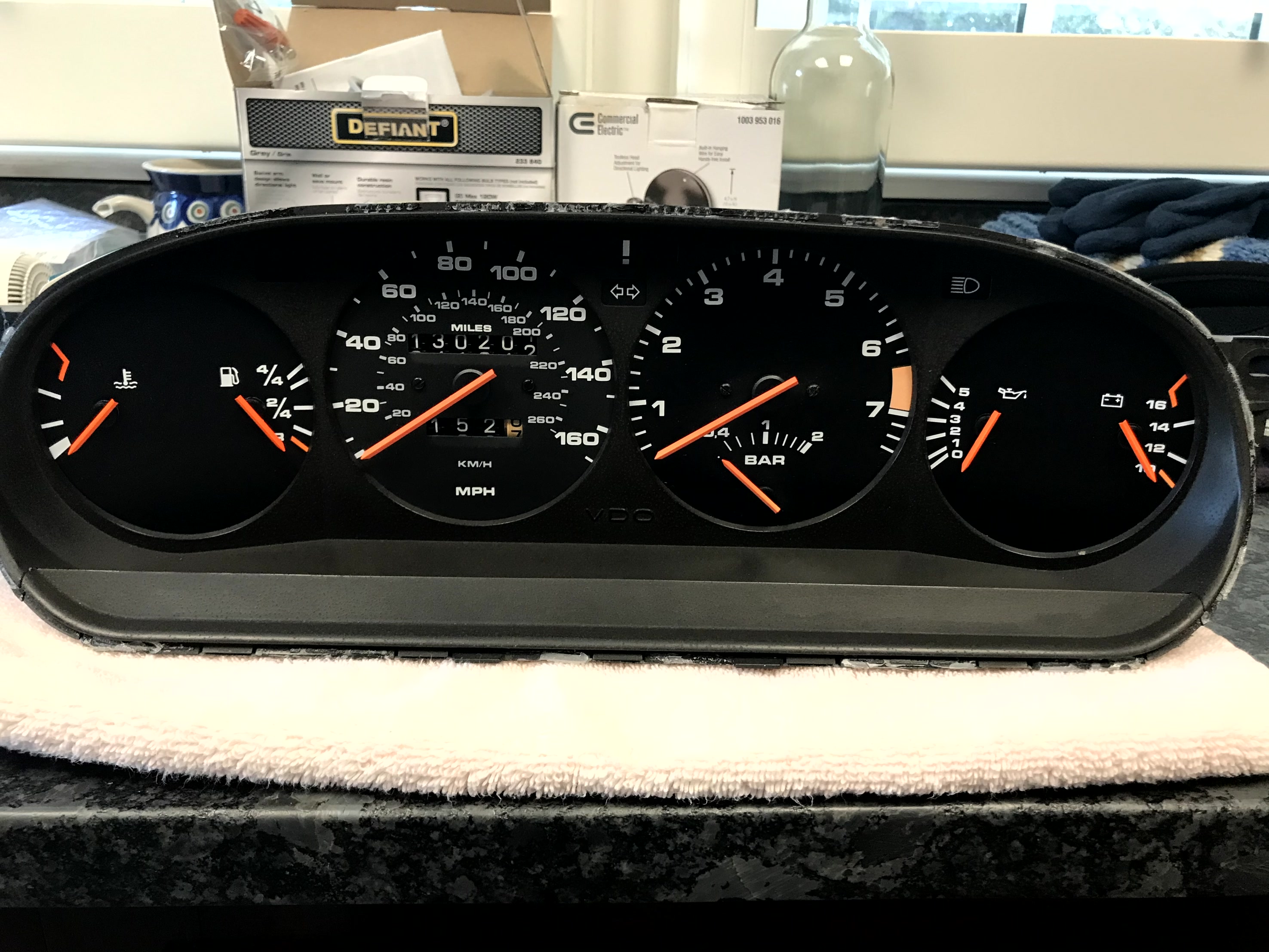

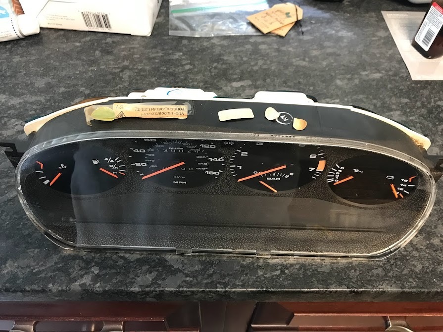

Hi all, I thought I would share the procedure and results for removing the lens and eliminating the white spots on my 951 binnacle. In hopes of my eventual number coming up for one of Toms' 911 style bezel & LED kit, I thought I would do some preliminary prep work for the install.

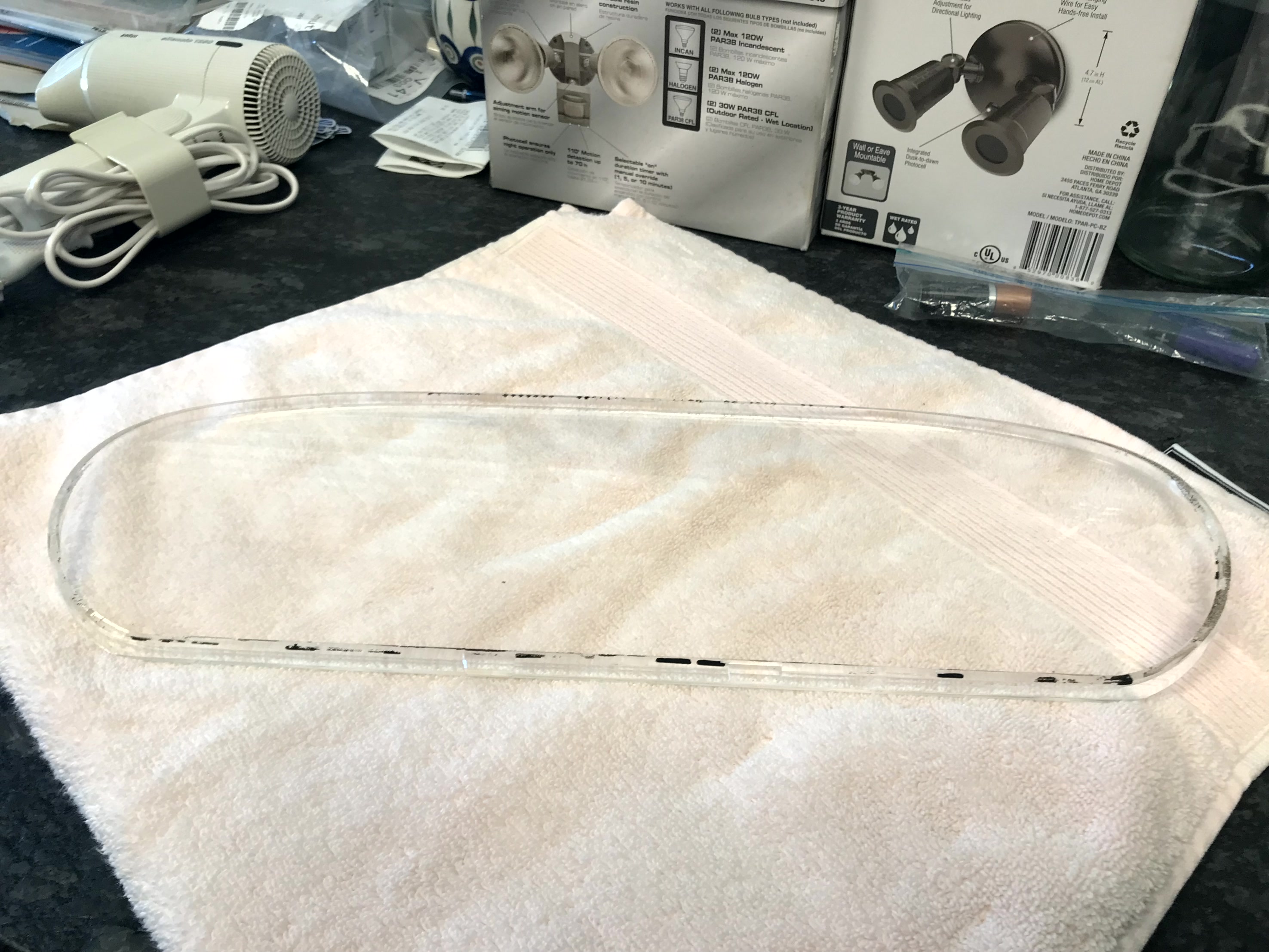

Removing the clear lens was not too hard and I was able to get it off without cracking it. I heated the edges up a little using heat gun on low and then used a very thin flat head to "gently" pry up on the lens and slowly going around the entire perimeter of the binnacle. I did this several times and it eventually pulled free. For me, not rushing the process was key.
My binnacle also had the usual white spots so I used Toms' heat gun method to remove them and it worked great. I removed the instruments from the binnacle and then used low heat and kept the gun moving over the entire area for a few minutes seemed to do the trick. The texture remains and the spots are gone. I also plan on using Griot's trim restoration before I put it back in the car.
Here are a couple of photos to show before and after results. I believe patience is the key to success for these two tasks.

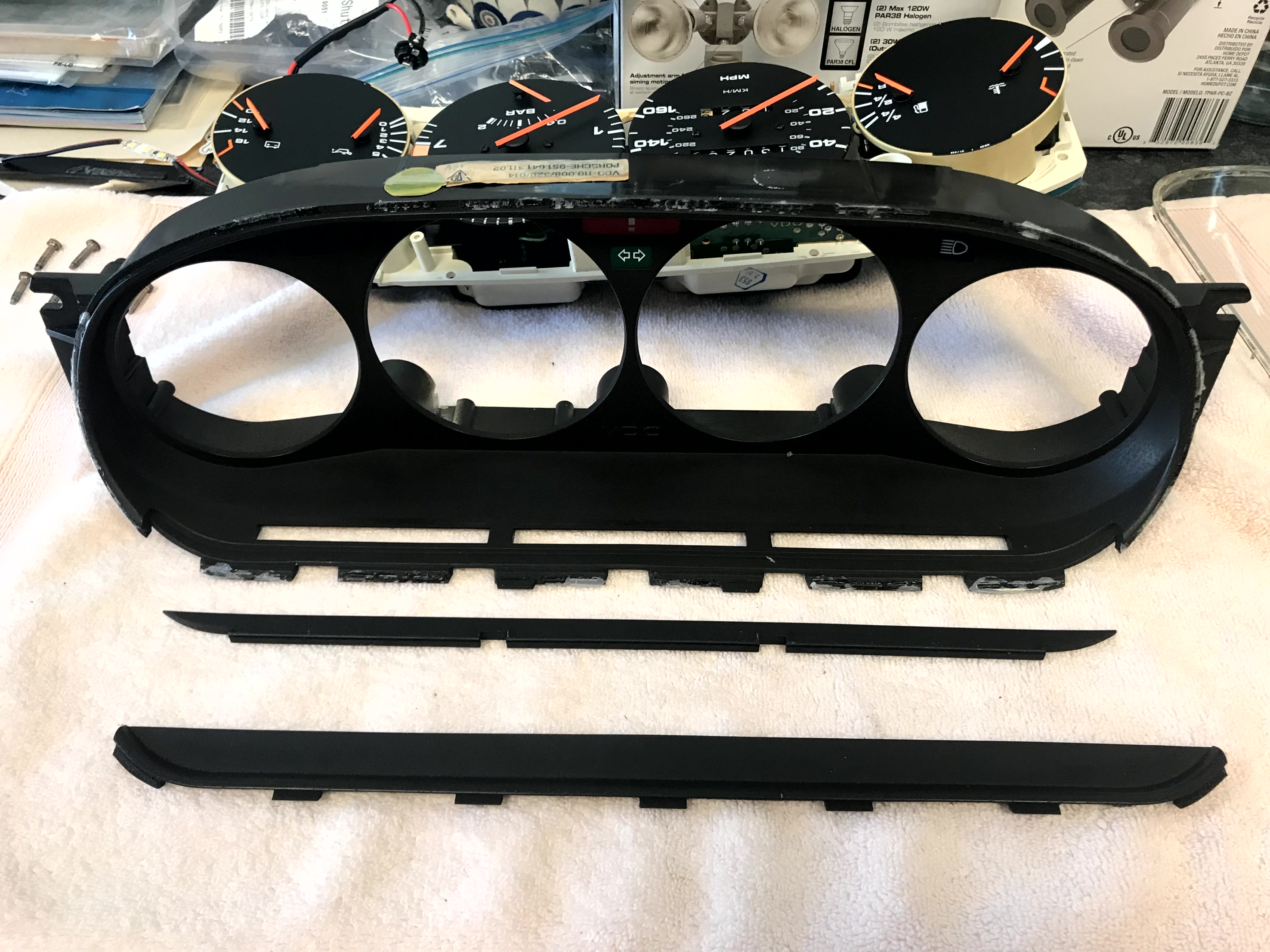

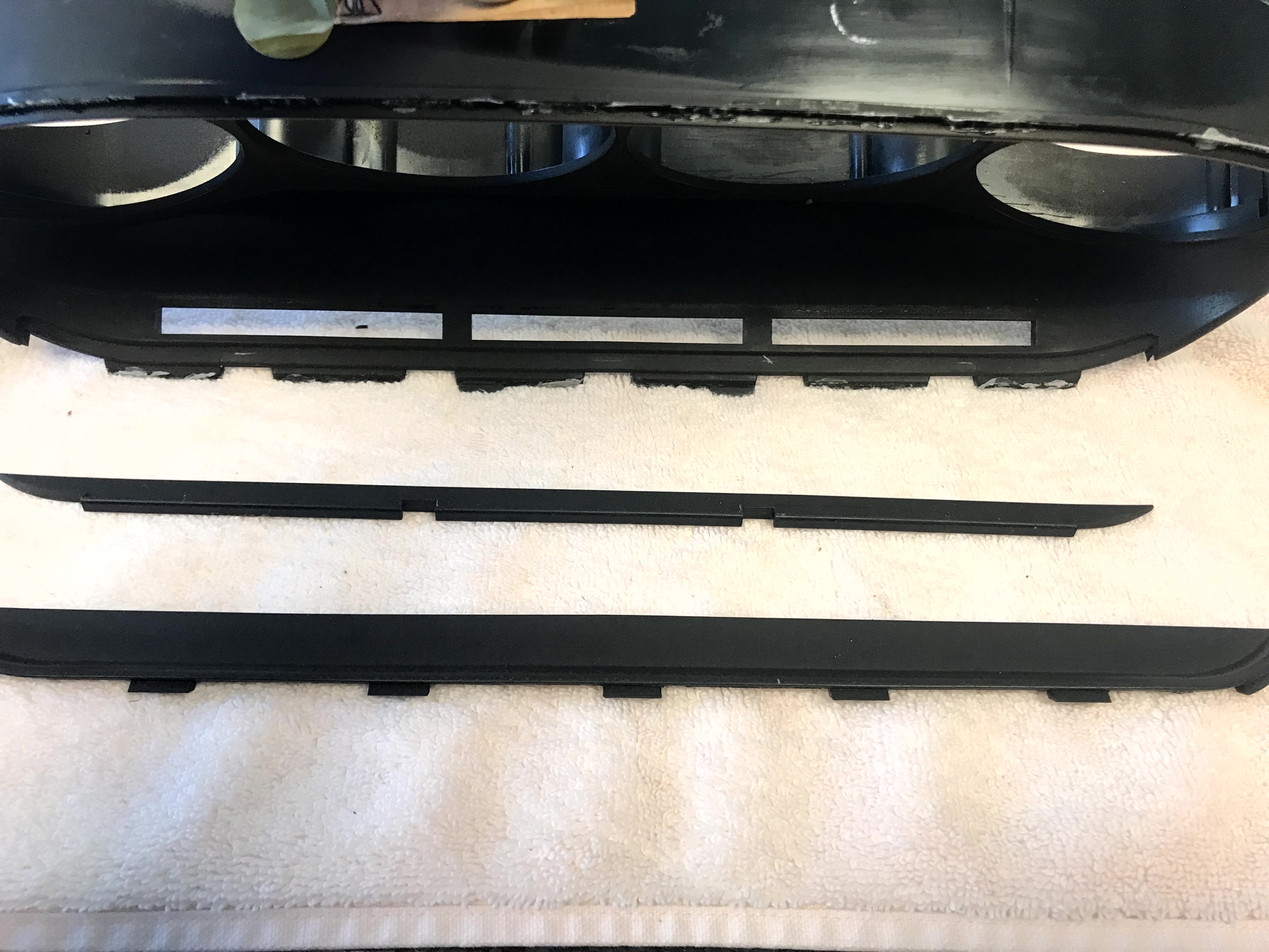

Very glad to hear you got the clear lens off without too much fuss. The black binnacle stuff looks fantastic with just heat, but try the Griot's Trim Restorer stuff too, in the green bottle. Between the heat and the Griot's stuff, it makes the binnacle look better than the day it left the factory. Did you remove the light guard trim at the bottom -- where the arrows are pointing in the picture below? It just loosely clips into place and comes off without tools once the clear lens is removed. Behind it are where the light tunnels stick up, and where you either will or will not have another smaller plastic strip behind the light tunnels. If you have a chance, can you post a picture with that front strip removed, so I can see what's behind it. Still trying to map which clusters have that extra strip and which don't. (It's the kind of valuable info that gets a guy bumped up on the list, just say'n

Tom and all,
Here are a couple of photos Tom asked me to post showing the additional plastic strip used on my 1986 951 binnacle.
