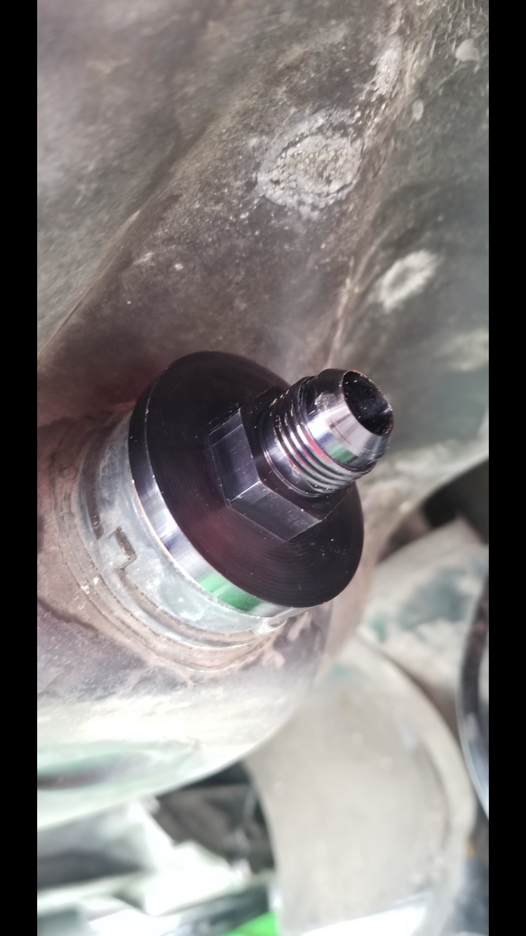

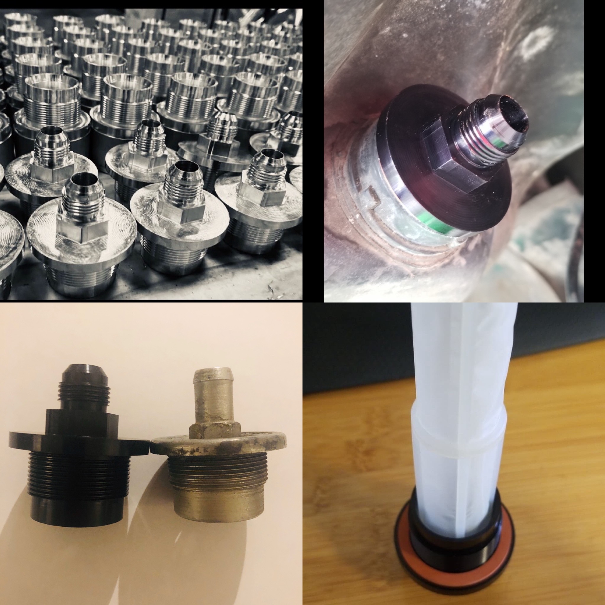

Curious if you ended up making these?DGUN951 wrote: Wed Oct 13, 2021 5:50 am Hey,
Don't know if it helps much, but I'm in the process of designing a new mount, that allows the Nissan unit to bolt on with no modifications or grinding and will retain the AC unit. Product is currently in prototyping
Haven’t yet. Finally found a new CNC guy who’s sending me a test for my fuel fittingso I can see if his quality is good, have a couple CNC projects I need to get to
- 96B71388-E7F7-4921-950F-4C41A3C159B3.png (1.96 MiB) Viewed 5458 times
- Posts: 8955
- Has thanked: 936 times
- Been thanked: 4020 times
Nice. Is than an AN fitting for the gas tank for 044 and similar pumps. I'm in if so. Any way to build the little elbow pipe right into the outlet?DGUN951 wrote: Sat May 14, 2022 8:48 am Haven’t yet. Finally found a new CNC guy who’s sending me a test for my fuel fittingso I can see if his quality is good, have a couple CNC projects I need to get to
Yeah, it converts your tank to an AN fitting allowing the use of full AN lines, and modern filters/pumps. Did a group buy on them a year ago. Sold a bunch and I still have people wanting them so I’ll probably do another. For now the design will stay as is, maybe in the future I will add the bendTom wrote: Sat May 14, 2022 8:55 amNice. Is than an AN fitting for the gas tank for 044 and similar pumps. I'm in if so. Any way to build the little elbow pipe right into the outlet?DGUN951 wrote: Sat May 14, 2022 8:48 am Haven’t yet. Finally found a new CNC guy who’s sending me a test for my fuel fittingso I can see if his quality is good, have a couple CNC projects I need to get to
- B3EC6826-E723-456B-8248-51E78BF47C0E.jpeg (652.83 KiB) Viewed 5450 times
- Posts: 8955
Very nice, if you do another run please consider doing a group buy here on Carpokes. The first (and so far only) group buy we did went really well.
