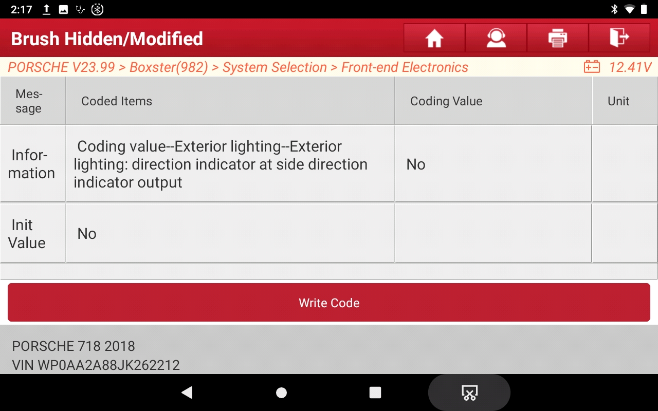

Don't like the side marker lights? Everywhere other than North America the front "marker" lights are used only for side indicators. So turning off the side marker function is simple. But do note, this cryptically named setting defeats all side marker (position) light functions. They only flash with blinkers or hazards if you do this.
Side marker defeat
  • System Selection > Front-end Electronics > Coding value--Exterior lighting--Exterior lighting: direction indicator at side direction indicator output = No
    {Default for North America: Yes}

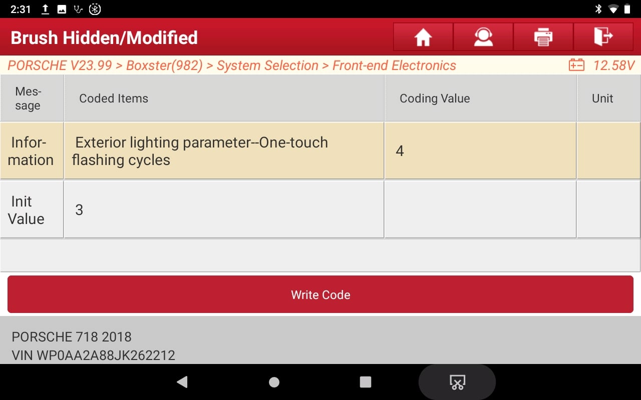

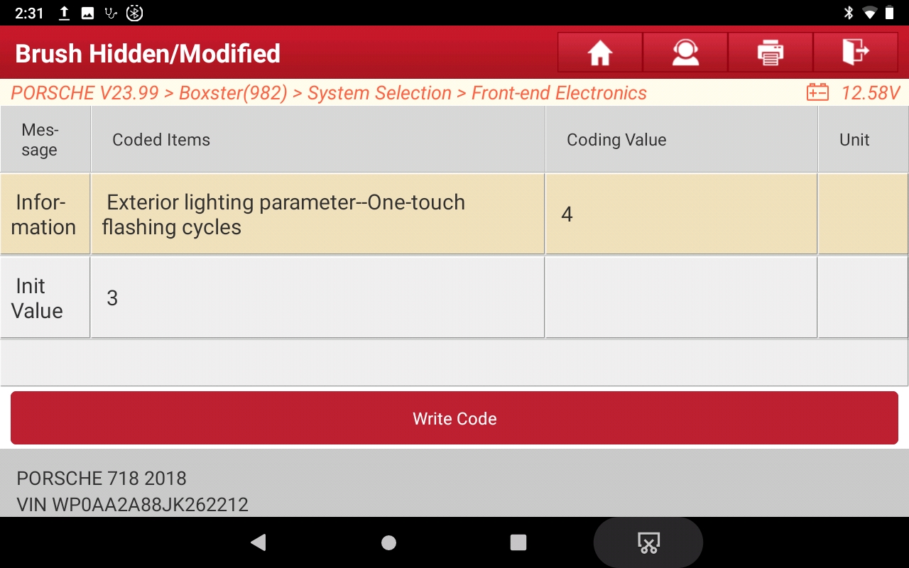

Here's a simple one. (And don't ask me why this one isn't a user choice in the PCM like it is in VWs.) Change your turn signal "One-Touch flashing Cycle" from 3. The valid range is 1-5, I changed mine to 4.
Configure One-Touch flashing Cycle
  • Front End Electronics > Coding > Coding_0 > Exterior Lights Parameters-One touch flashing cycles = [select from 1 to 5]
    {Default: 3}
Comfort blinkers.jpeg (454.85 KiB) Viewed 3682 times

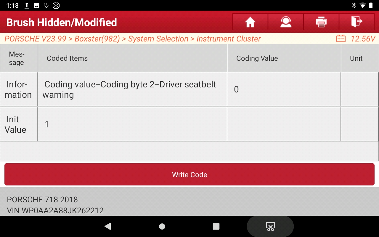

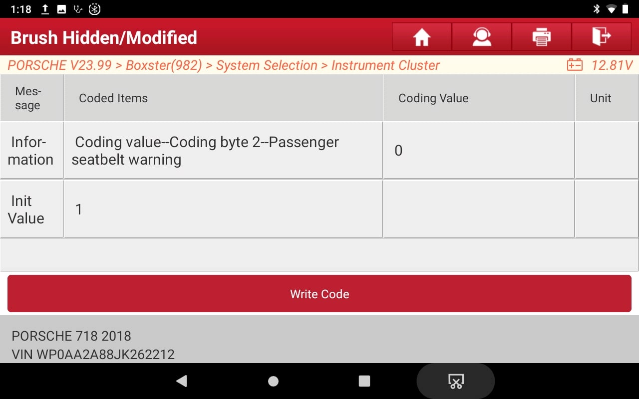

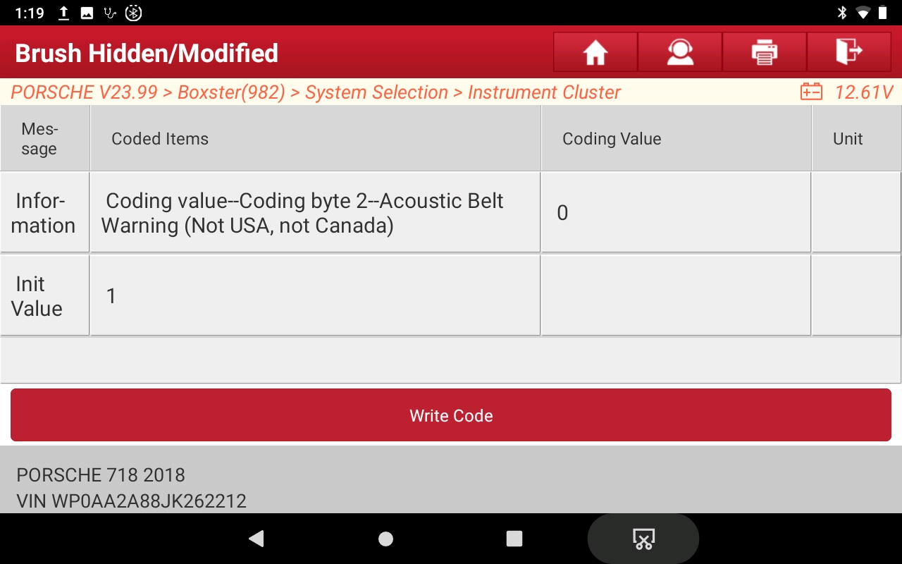

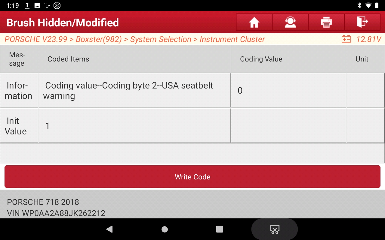

Seatbelt warnings. I never drive without belting up, but I do not need my car to chime and display warnings if I start it to back it out of the garage to wash it (for example). So those chimes and lights and warnings just annoy me.
There are either 1 or 4 params to change, depending on preferences.
Disable seatbelt warnings
Do only the 4th one (Acoustic) to simply kill the chimes without affecting the lights and MFI warnings. Do all 4 to completely disable all belt warnings.
  • Instrument Cluster > Coding value--Coding byte 2--Driver seatbelt warning = 0
    {Default: 1}
Seatbelt warning-1.jpeg (425.15 KiB) Viewed 3676 times
  • Instrument Cluster > Coding value--Coding byte 2--Passenger seatbelt warning = 0
    {Default: 1}
Seatbelt warning-2.jpeg (425.56 KiB) Viewed 3676 times
  • Instrument Cluster > Coding value--Coding byte 2--USA seatbelt warning = 0
    {Default: 1}
Seatbelt warning-3.jpeg (424.49 KiB) Viewed 3676 times
  • Instrument Cluster > Coding value--Coding byte 2--Acoustic belt warning (Not USA, not Canada) = 0
    {Default: 1}
Seatbelt warning-4.jpeg (431.64 KiB) Viewed 3676 times

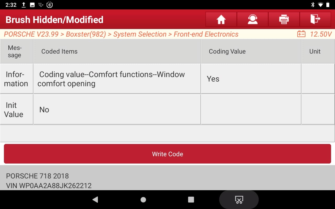

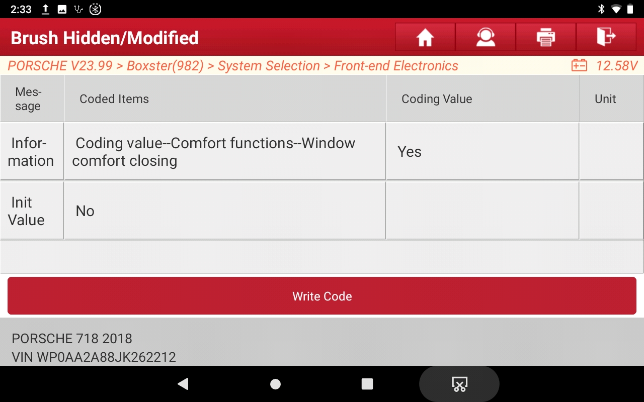

Two codes for the windows, one for opening, the other for closing. Do one, the other or both as you prefer.
Activate window open/close with fob
  • Front End Electronics > Coding value--Comfort functions--Window Comfort Opening = YES
    {Default: No}

  • Front End Electronics > Coding value--Comfort functions--Window Comfort Closing = YES
    {Default: No}

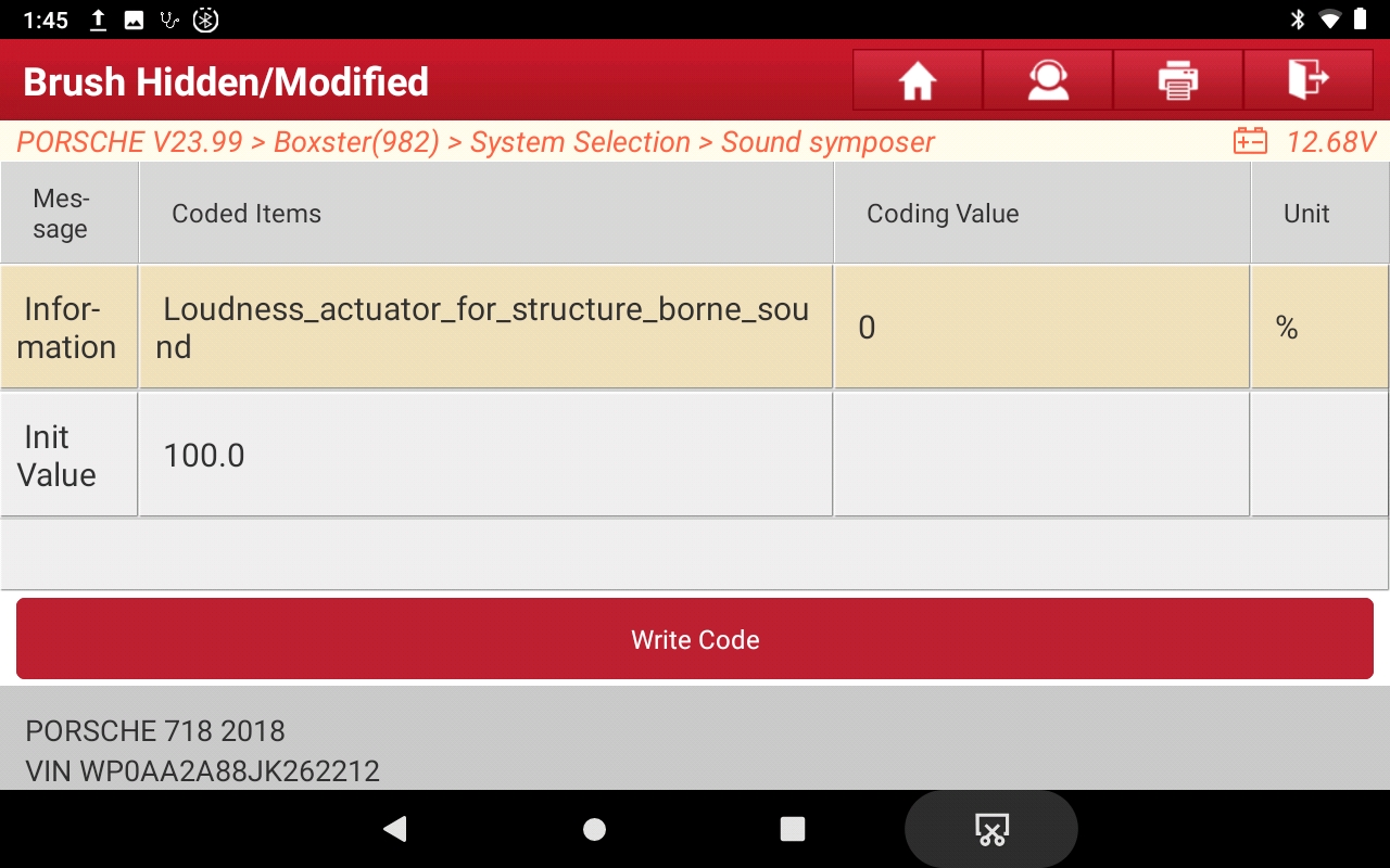

You can change the Sound Symposer (Soundaktor) sound volume, or even turn it off. The soundaktor is a device that produce artificial engine sound to ”enhance“ engine sound in the cabin. (I've found very little difference between 0 and 10%. Mine is set at 10% now.)
Edit or defeat Sound Symposer volume
  • System Selection > Sound symposer > Loudness_actuator_for_structure_borne_sound = [0-100]
    {Default: 100}
