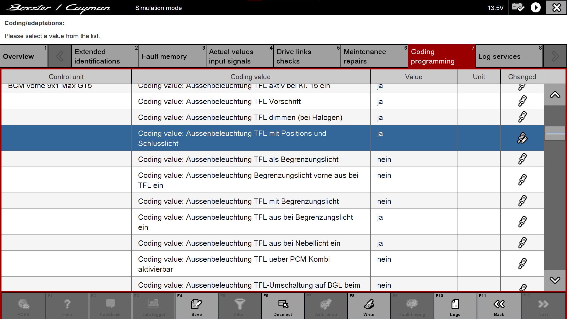

Enable Tail Lights with DRL

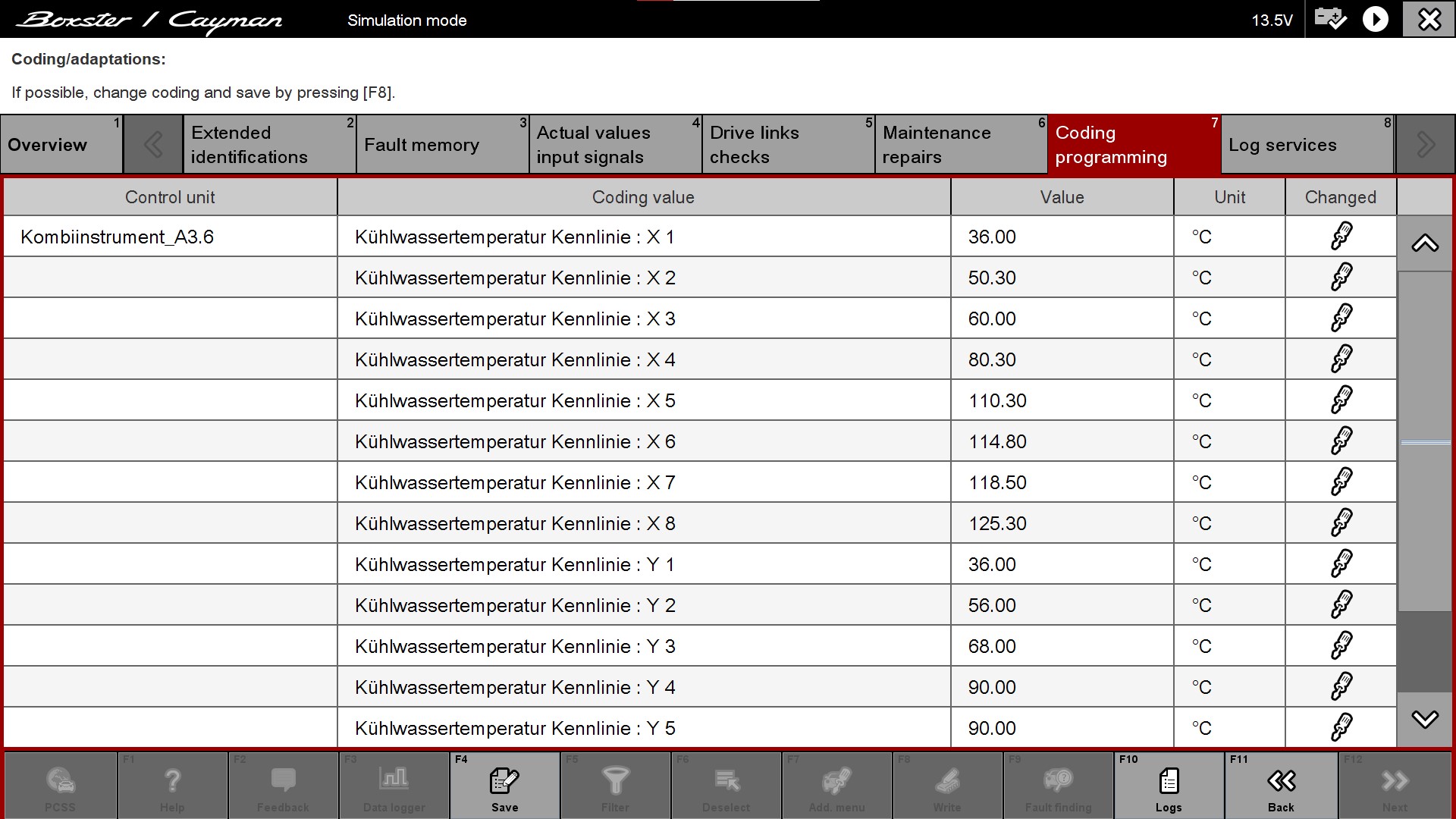

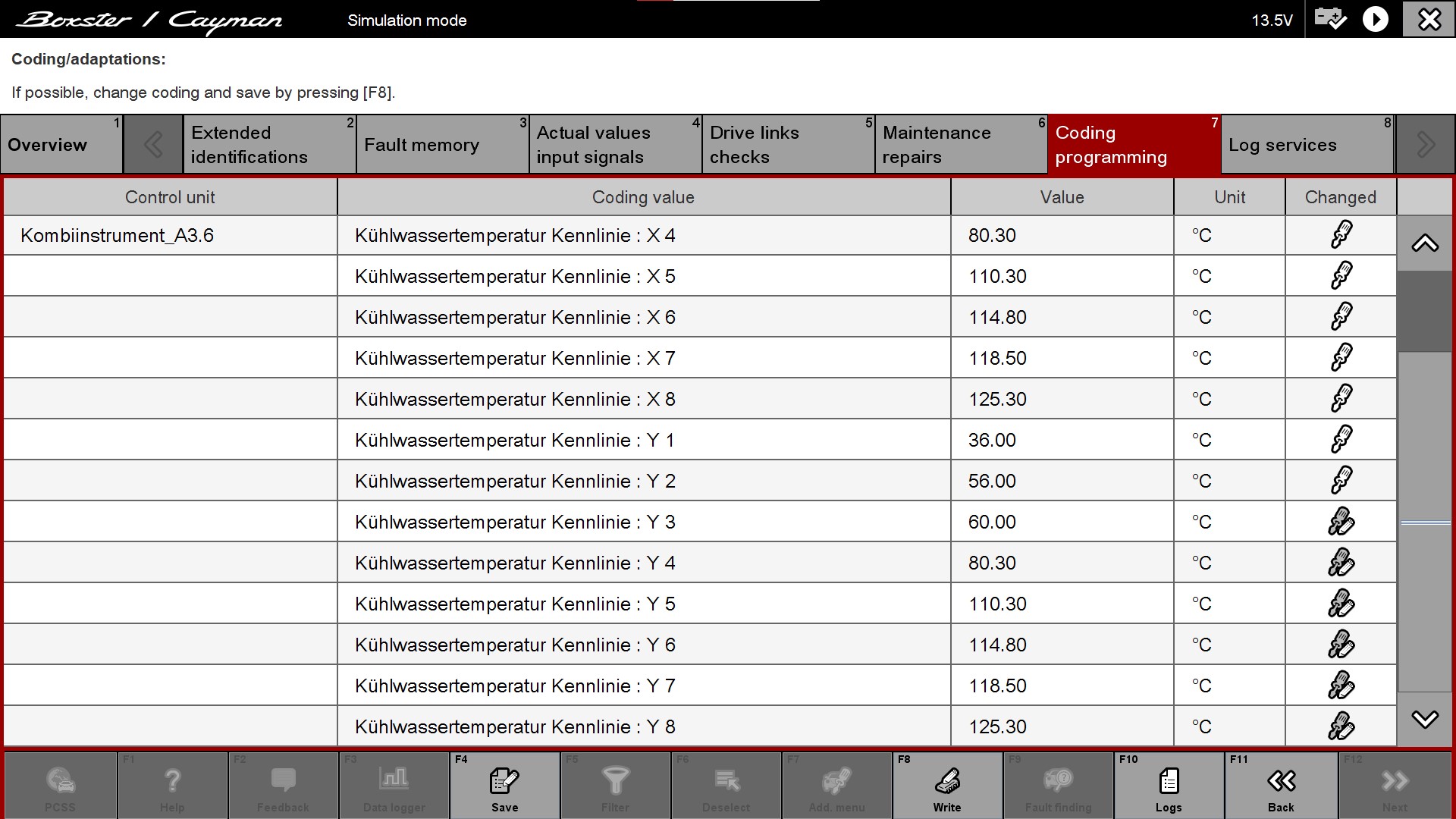

Display Real Coolant Temperature in Cluster (not for GT4 or Spyder)

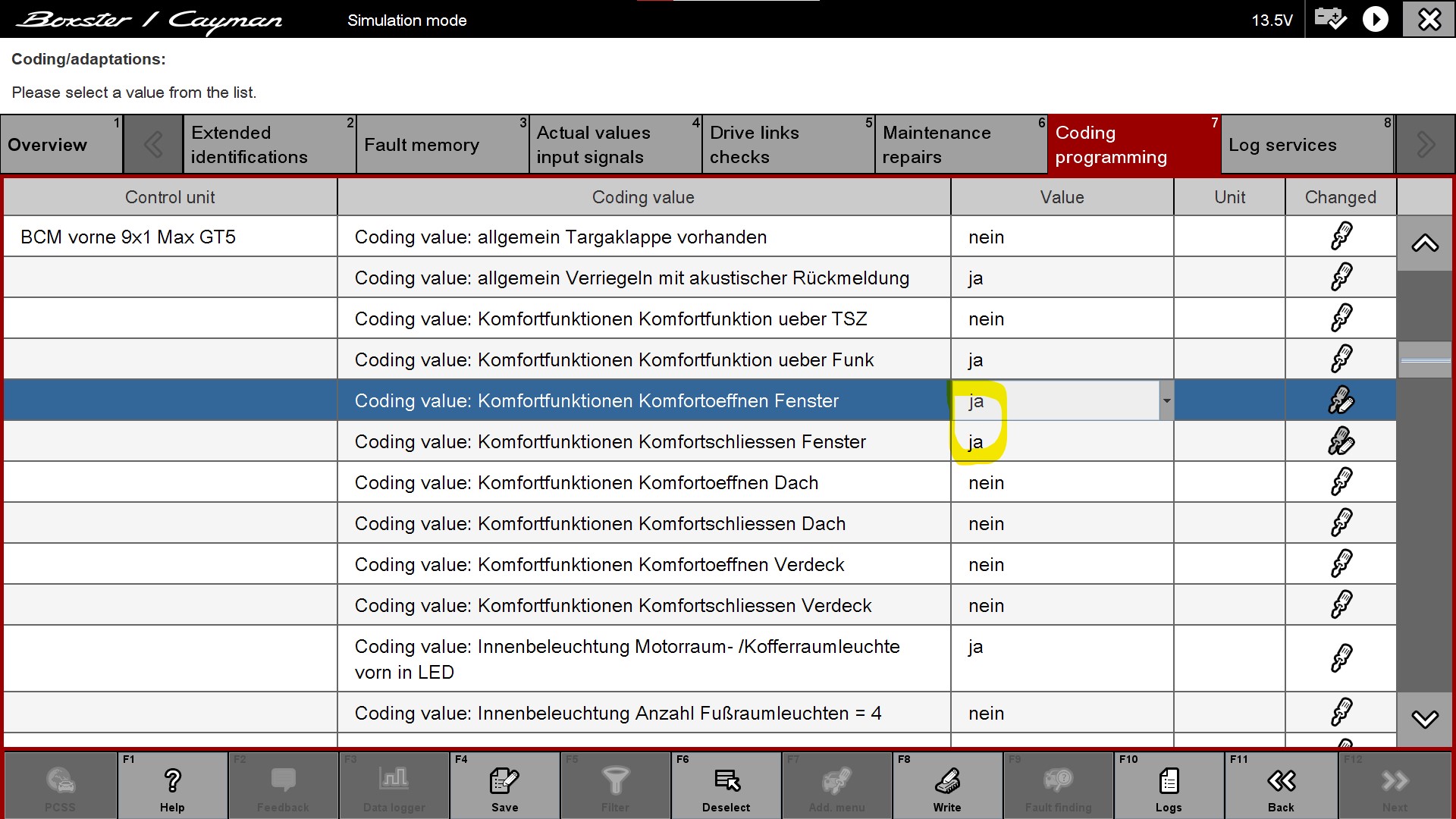

Windows Roll Up/Down with the Keyfob

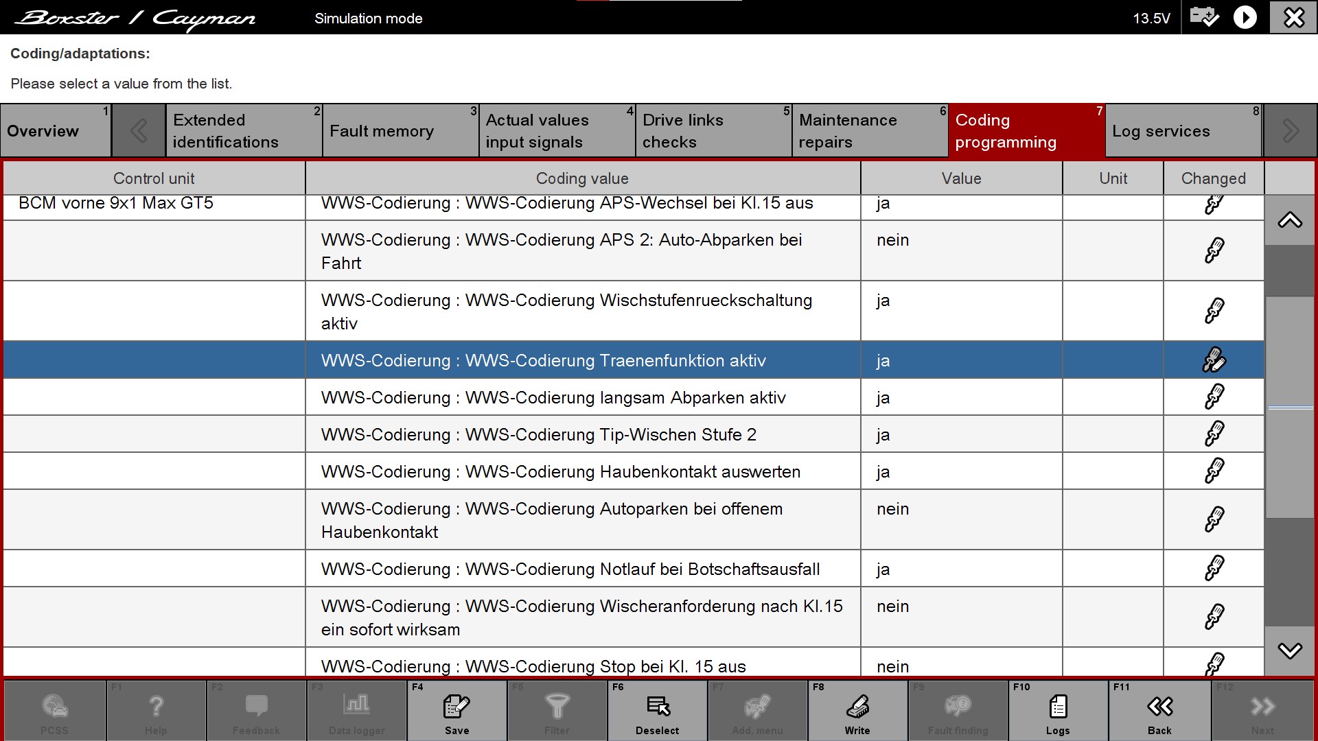

Tear Drop wiping

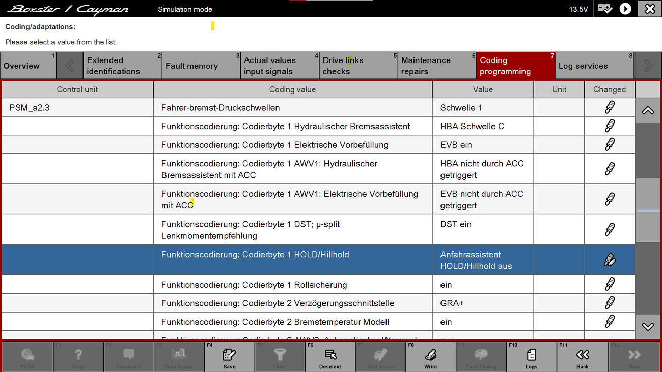

Disable Hill Assist
Hill Assist.png (352.06 KiB) Viewed 6539 times

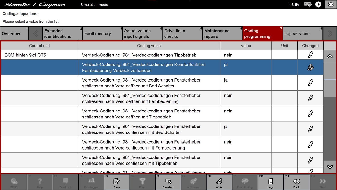

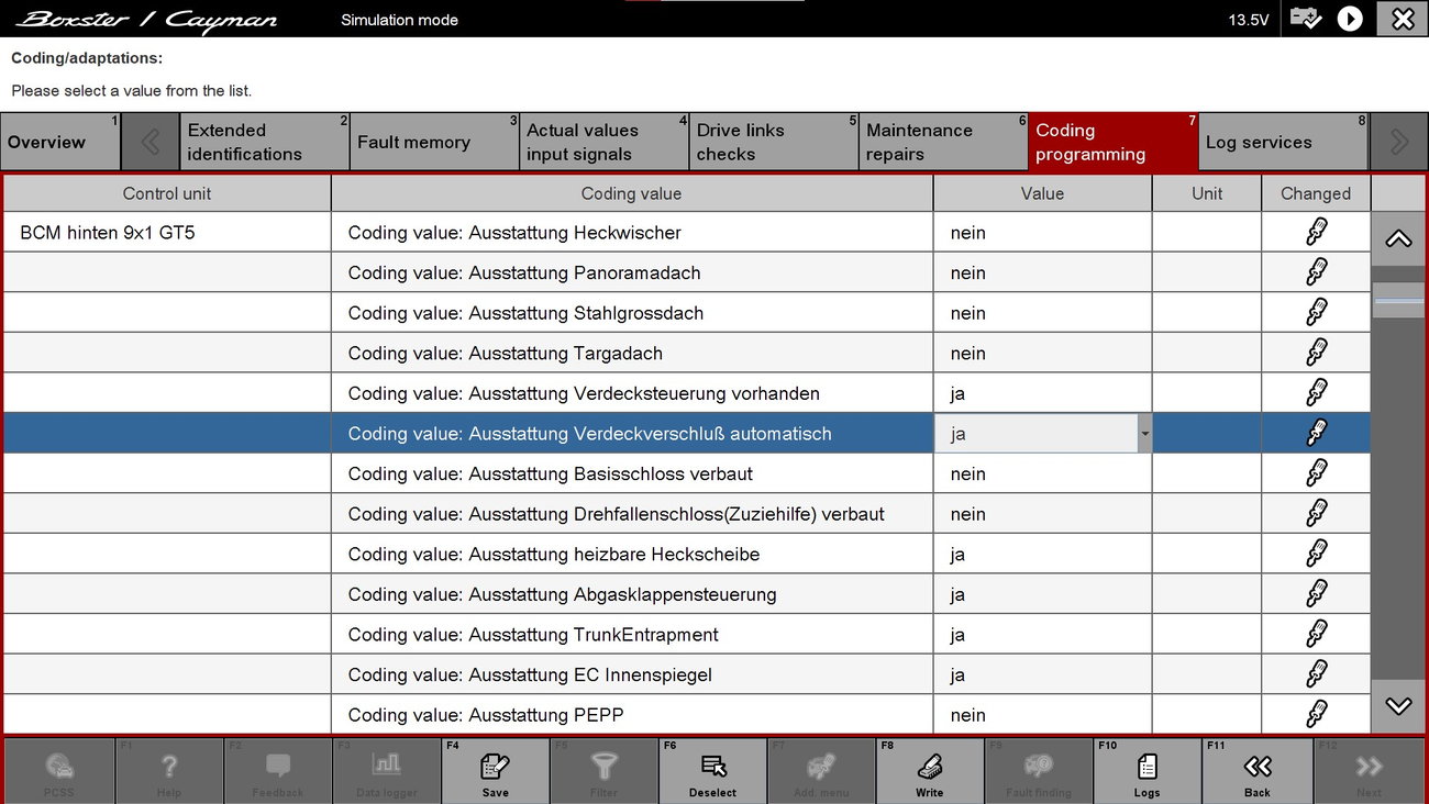

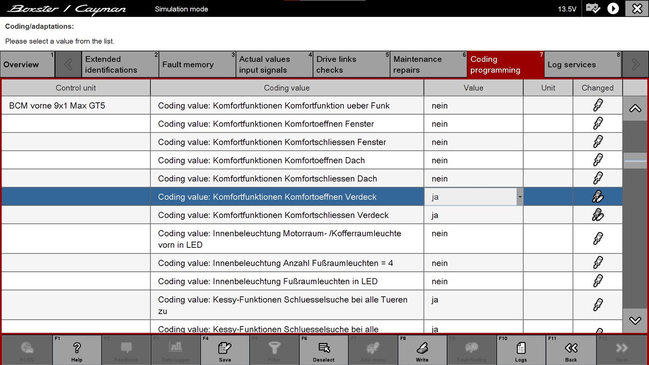

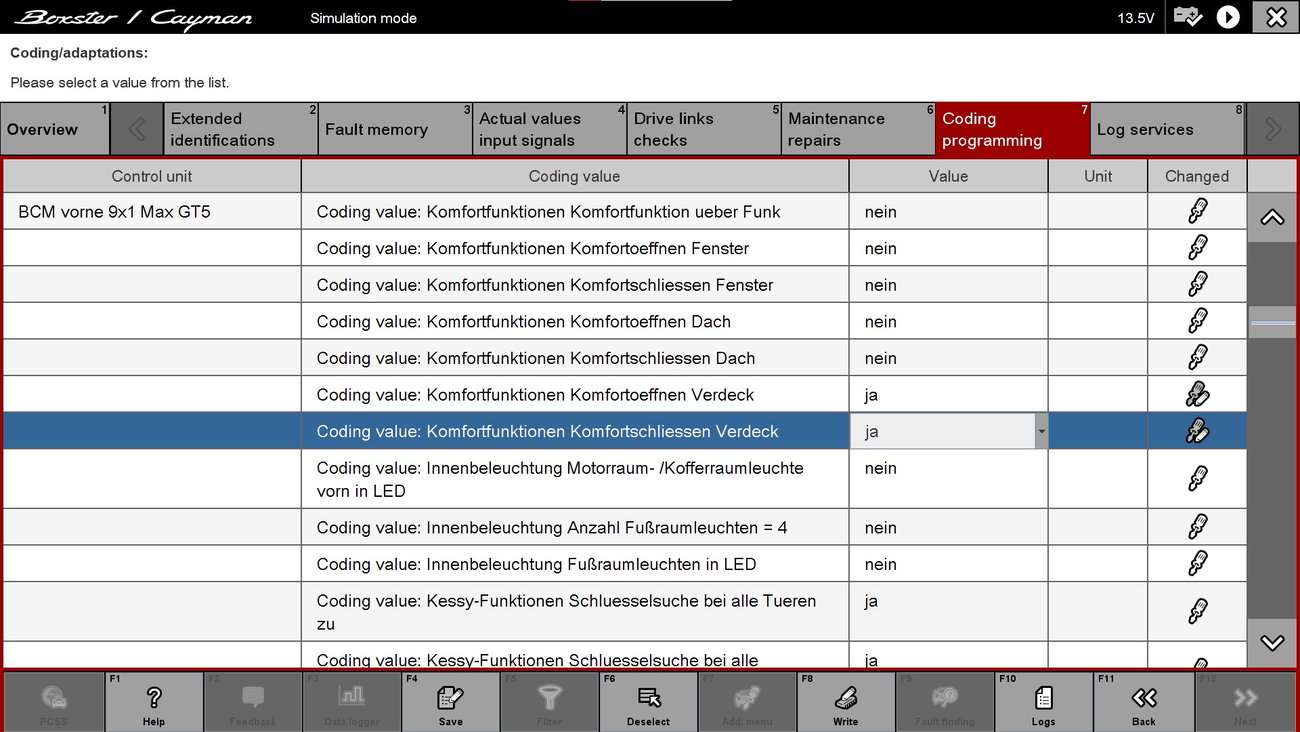

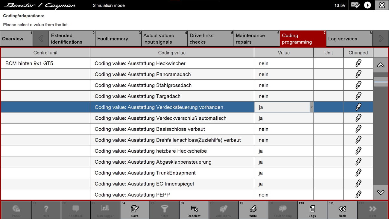

Boxter or Spyder Convertible Top Close with the Keyfob (Manual latch release or close for Spyder)
Top close 1.jpg (151.66 KiB) Viewed 6533 times
Top close 2.jpg (151.98 KiB) Viewed 6533 times
Top close 3 .jpg (148.14 KiB) Viewed 6533 times
Top close 4.jpg (148.47 KiB) Viewed 6533 times
Top close 5.jpg (153.89 KiB) Viewed 6533 times

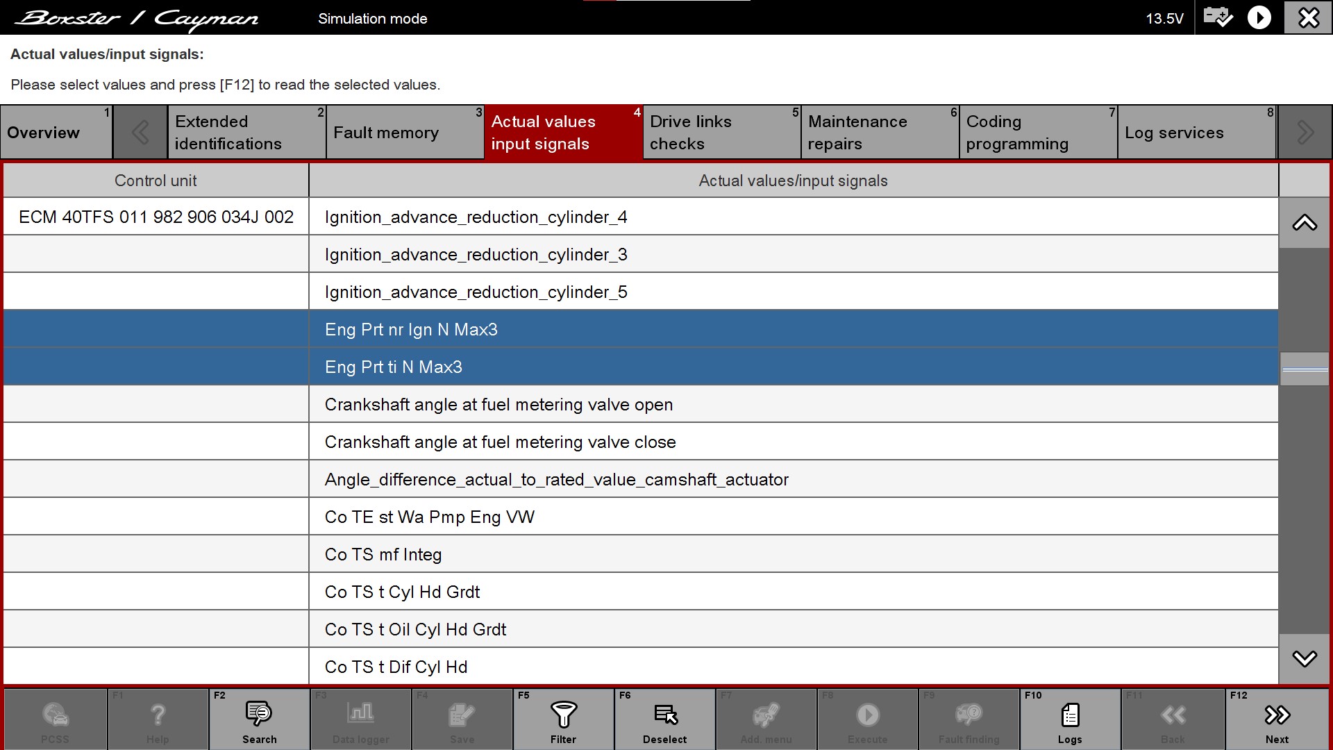

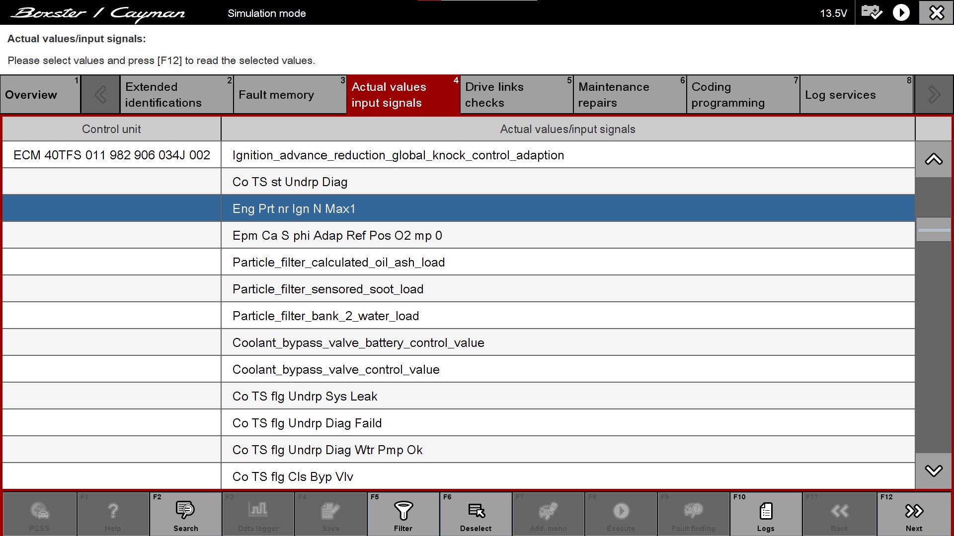

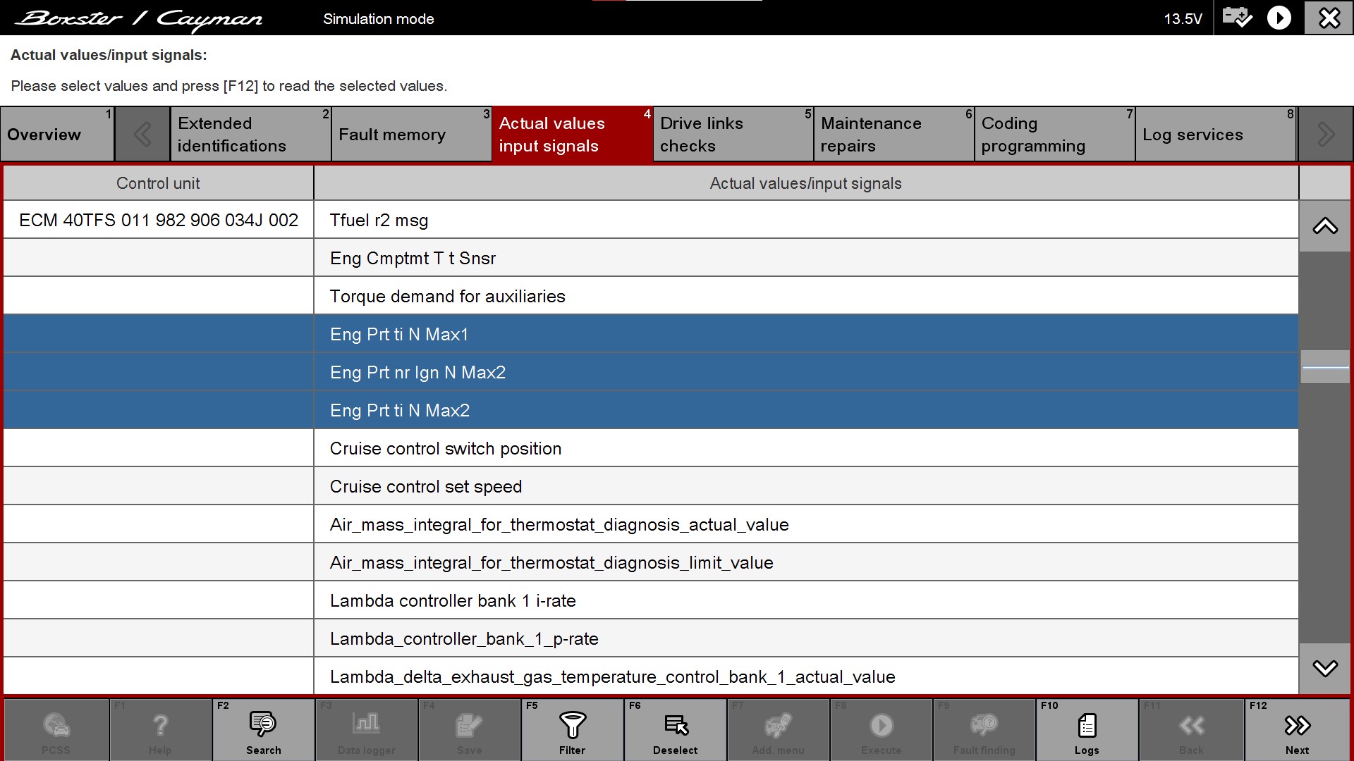

Engine Over Rev Report
