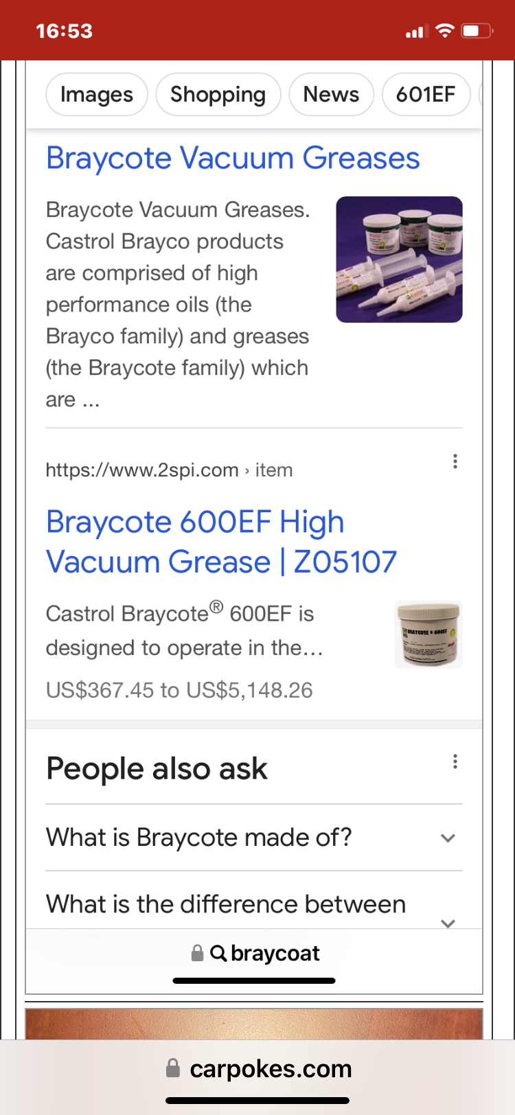

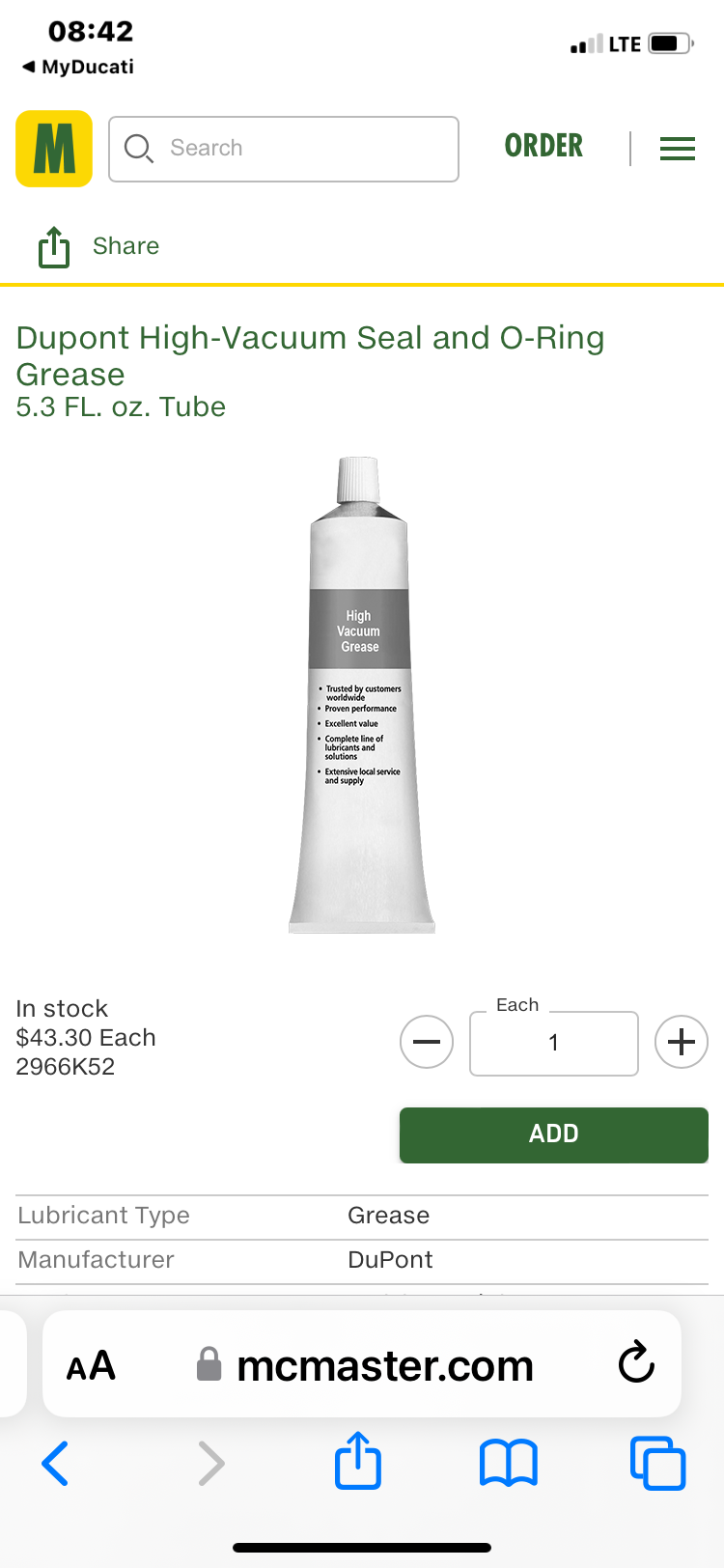

Viton will serve you well
This is also your friend for sealing up the throttle bearings.
Edit: This is lube too
lots of brand options.
https://www.theoringstore.com/store/ind ... &cPath=343
