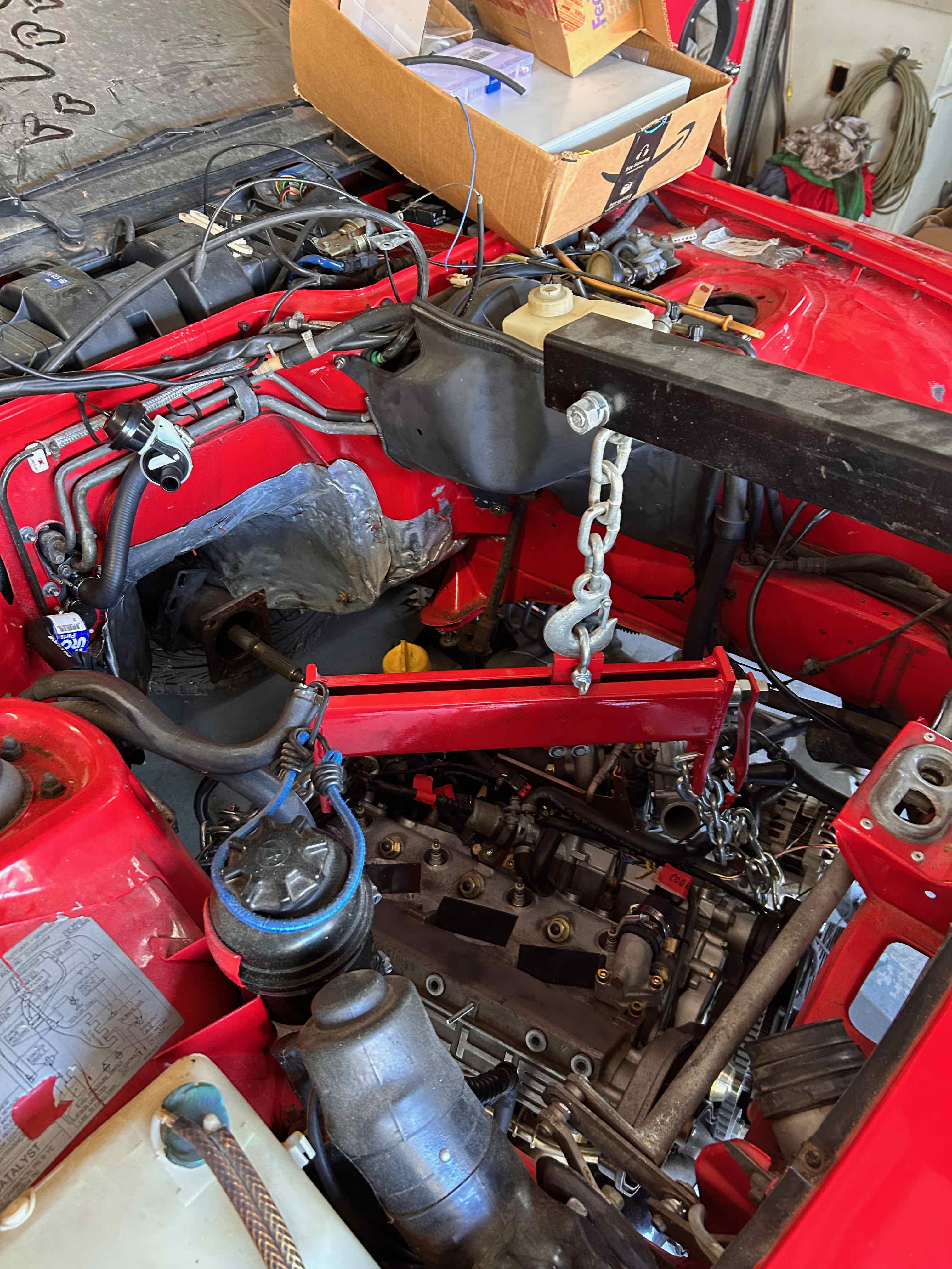

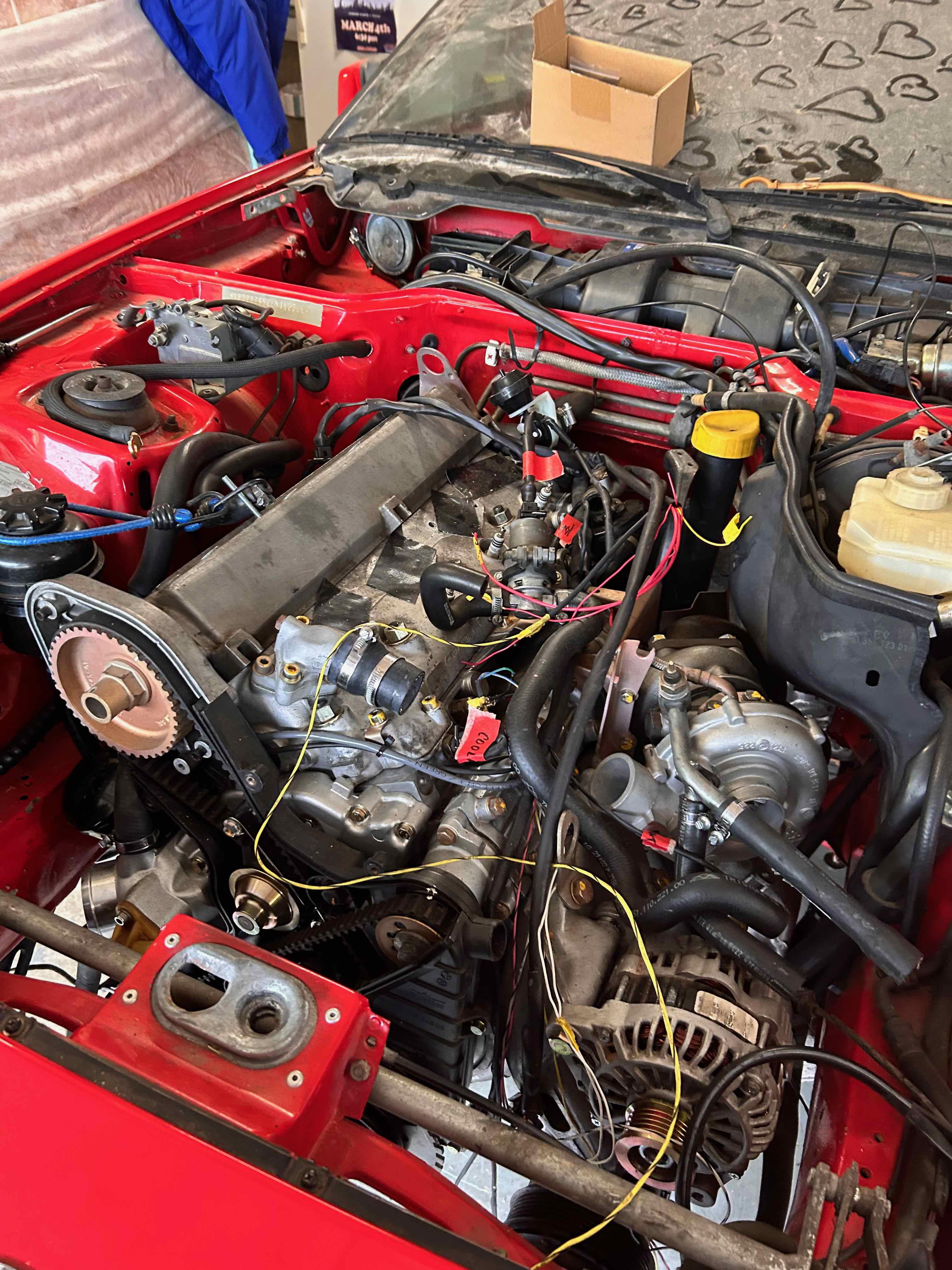

Got the engine back in. What a milestone. Now time to finish wiring and hoses, etc. Here are a few pics (start from the bottom - they loaded backwards) !
Inside shot of the wiring through firewall.
Finally decided on a location for the new fan controller module (PWM controlled from MS via Arduino)
New battery cables in place. Going to have to get new grommets though...!
Freshly rebuilt Mustang High Impedance injectors.
She's in!
Crossmember cleaned up and ready to install.
Engine slid under and in position.
All jacked up and ready to go.
